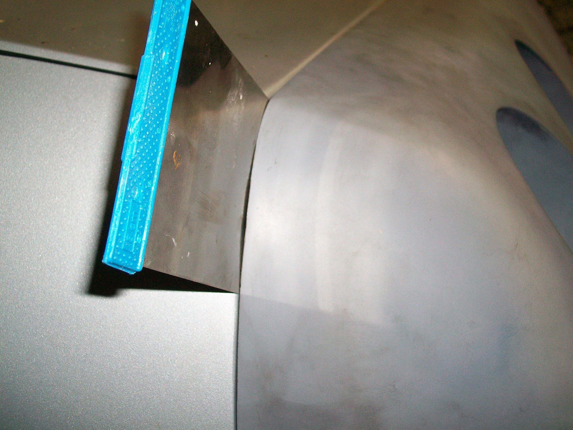

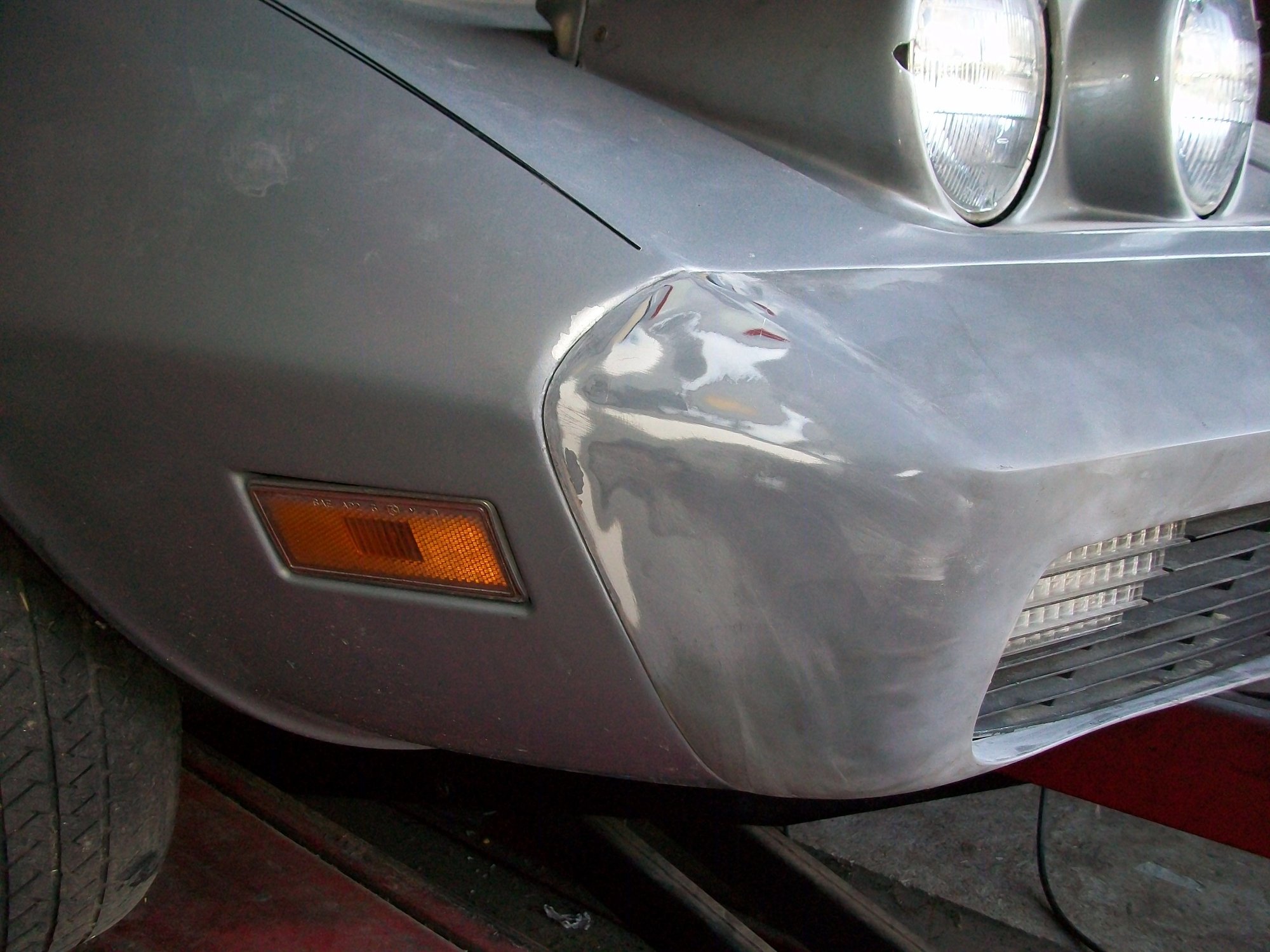

You had this problem for the rear bumper
a lack of fiber on the fender
seems original no repair​​​​​​

What are you asking? French to english translation something is getting lost. Looks like a replacement not original bumper cover.

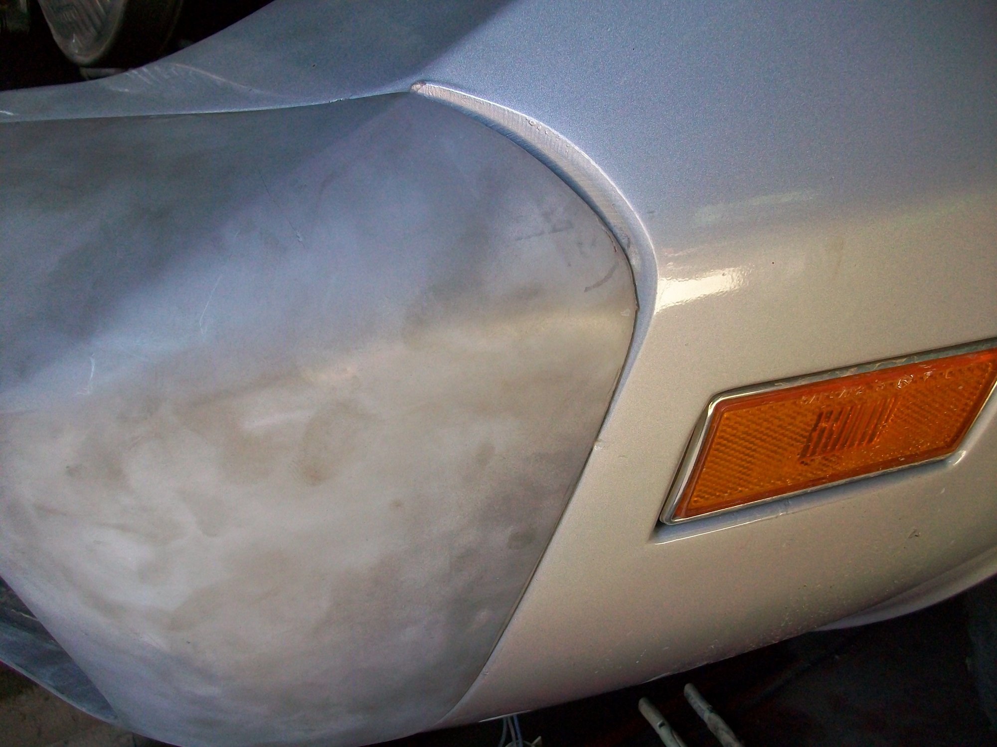

there is a lack of fiberglass on the wing but it seems original I do not see any repairs

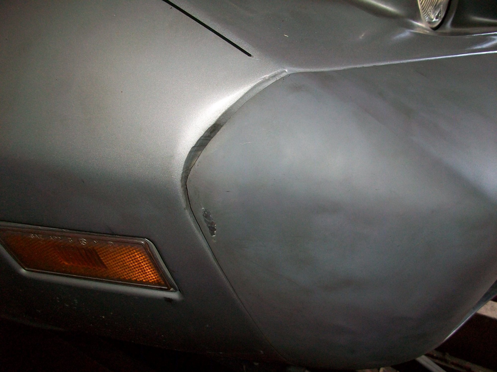

Why is there no paint on your bumper cover? Are you wanting to install a replacement cover? If so, almost all the replacement bumper covers require hand fitting.

yes a replacement bumper. I bought it used.

Think he is pointing out the low spot on the top of the rear quarter

It is the shrinking of the body seam filler adhesive. the original flexible bumper helps fill/hide the inconsistent gap.

I filled it a little while heating

now a little body filler

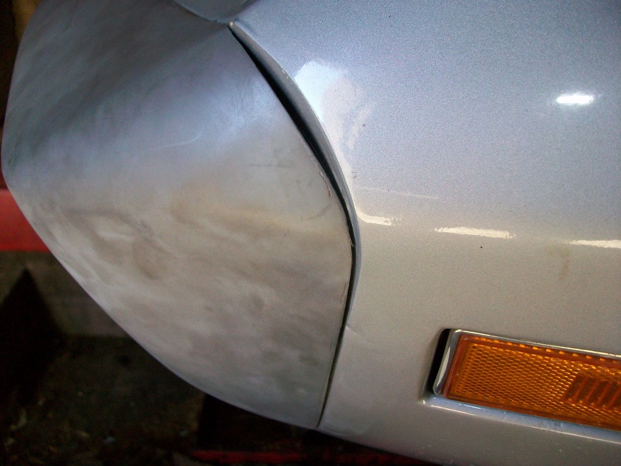

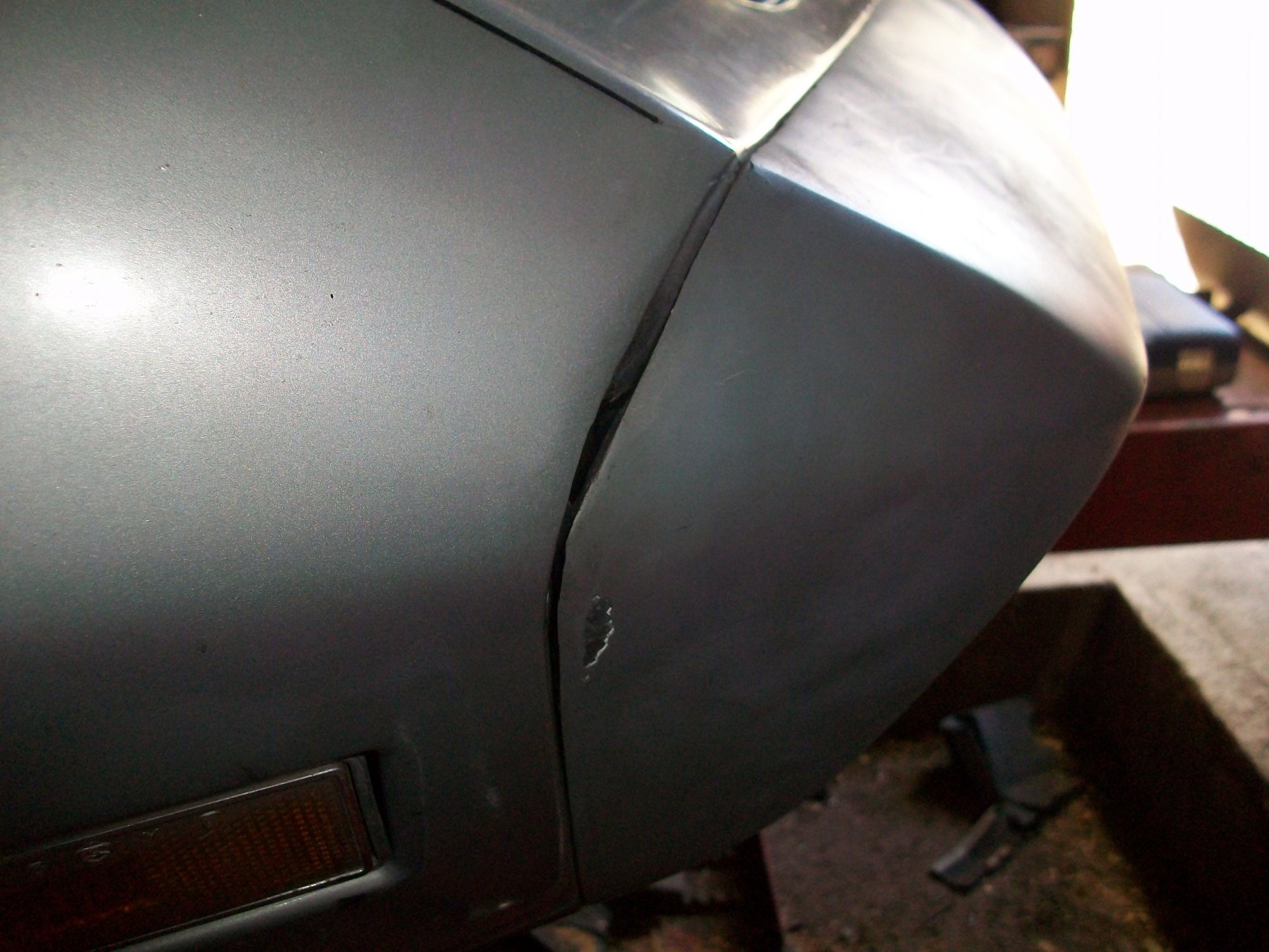

If the replacement bumper is fiberglass, there is some chance that body filler in the gap will not crack...but it is more likely to crack and fall out. If the bumper is flexible like the original part, there is NO chance that you could successfully fill that gap.

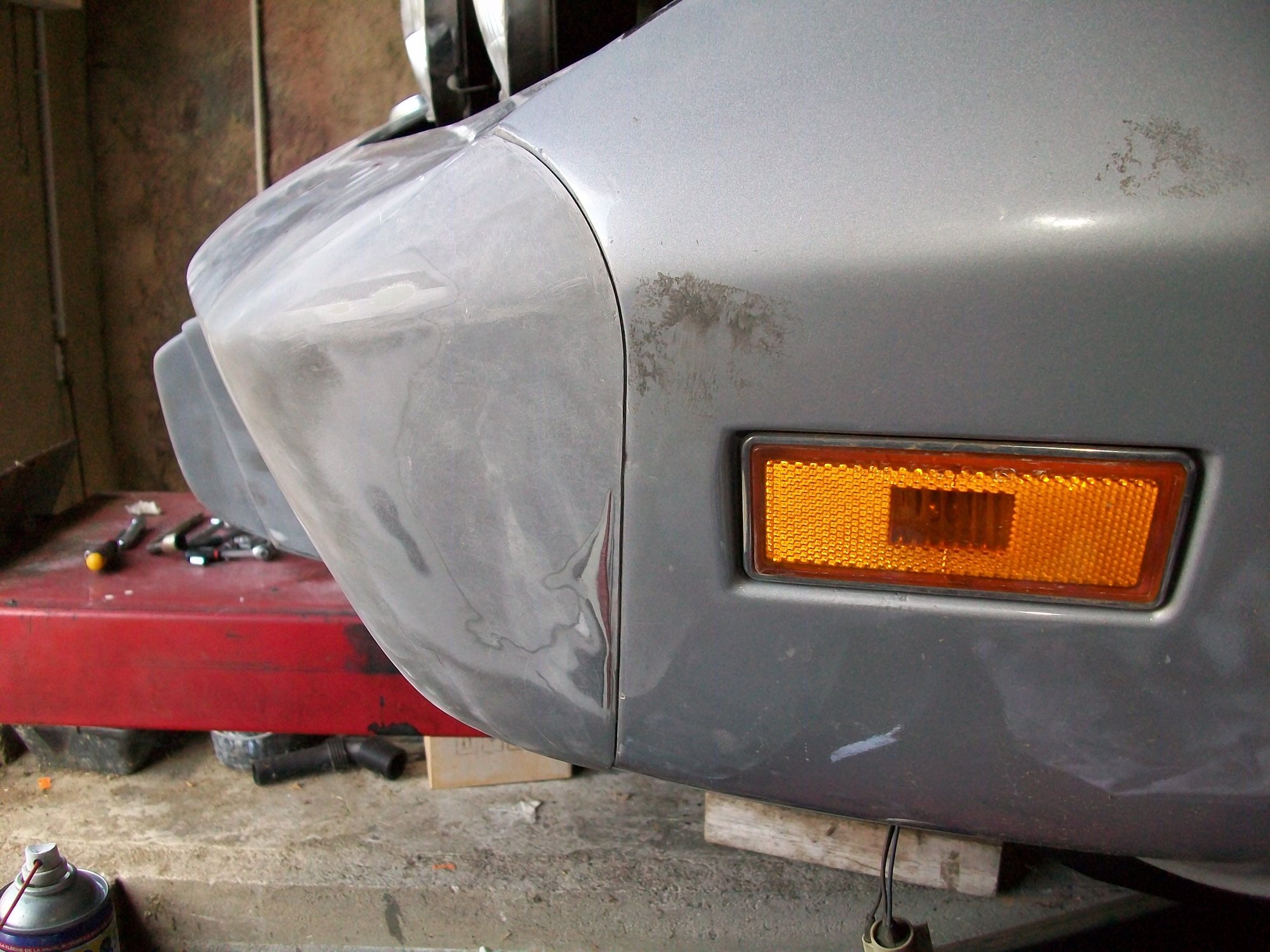

flexible
I'll post pictures when I'm done
front and rear bumper

There may be some 'magic' epoxy stuff that is capable of bonding well to both materials.....but I'm not aware of it. Good luck with your project.

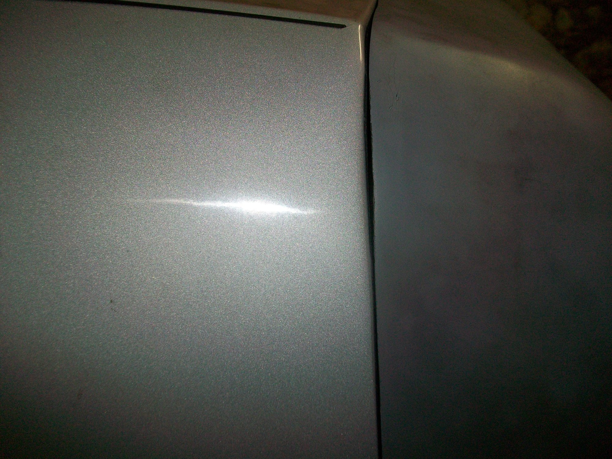

This is how mine left the factory. I bought it new....
The paint & urethane are original. There's always going to be a gap.
It's just how bad!.....

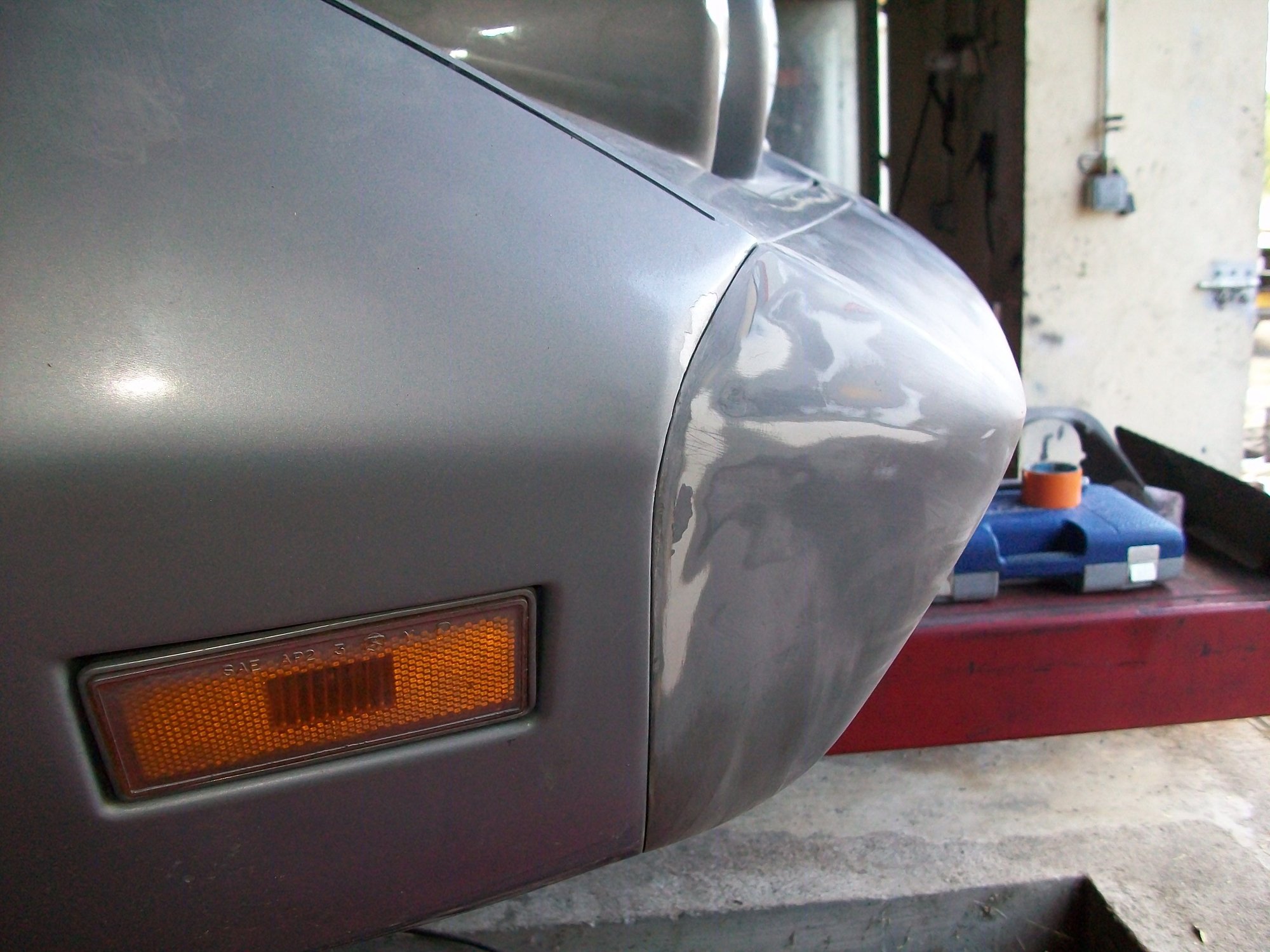

To rear bumper
