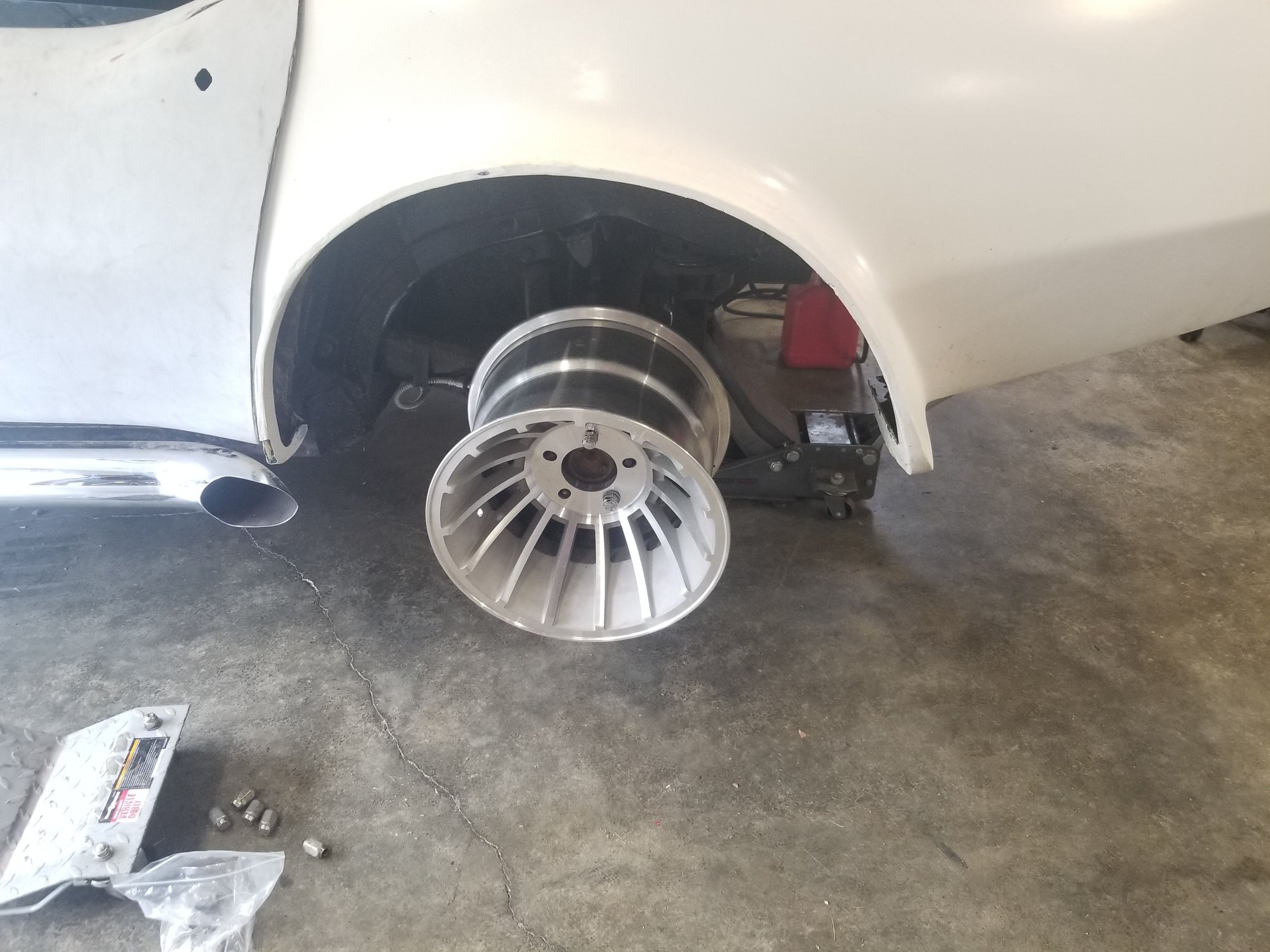

Threw on one of the nos 15x10 Westerns to check fitment. It's close, but nothing touches. I do think I'll have to move the E-brake cable brackets on the trailing arms to the top of the arm. Nothing to hard.

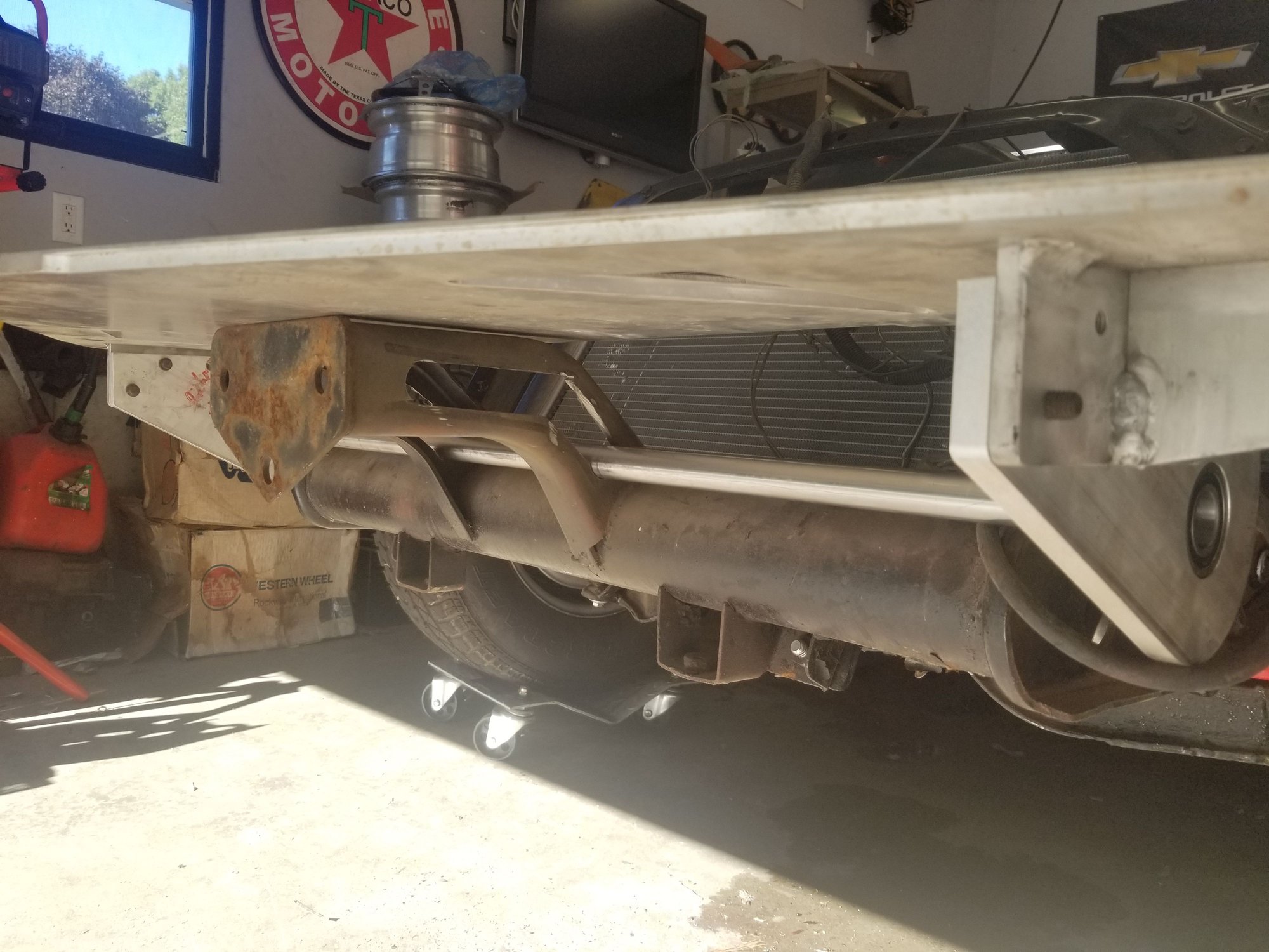

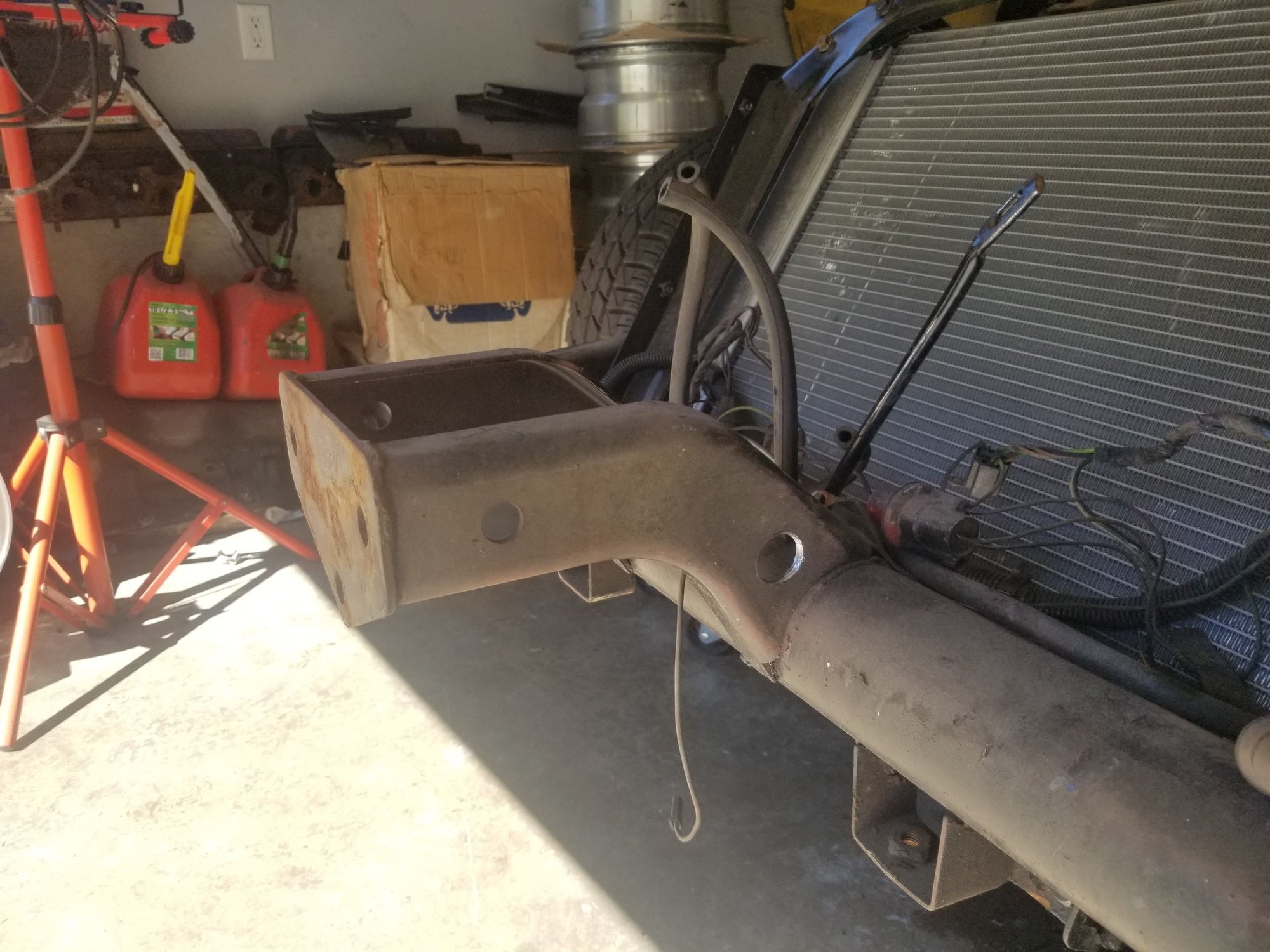

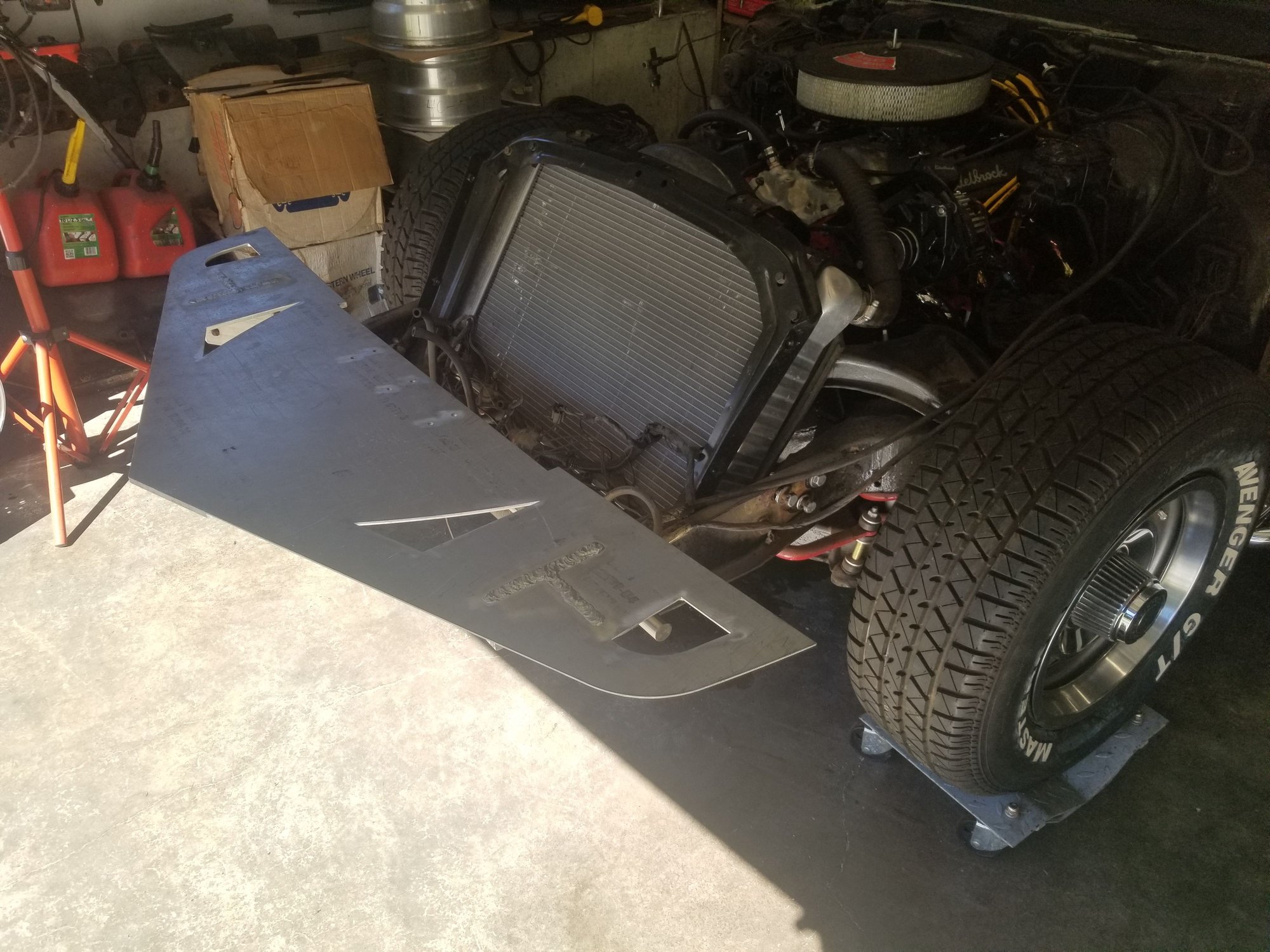

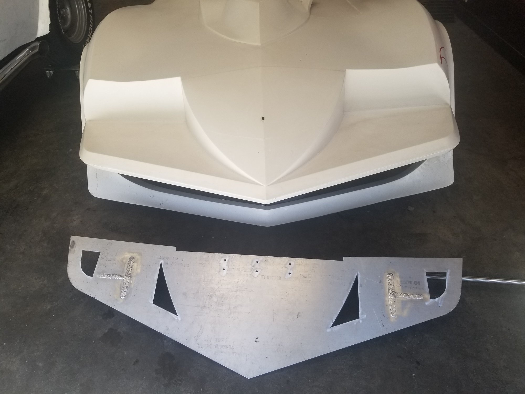

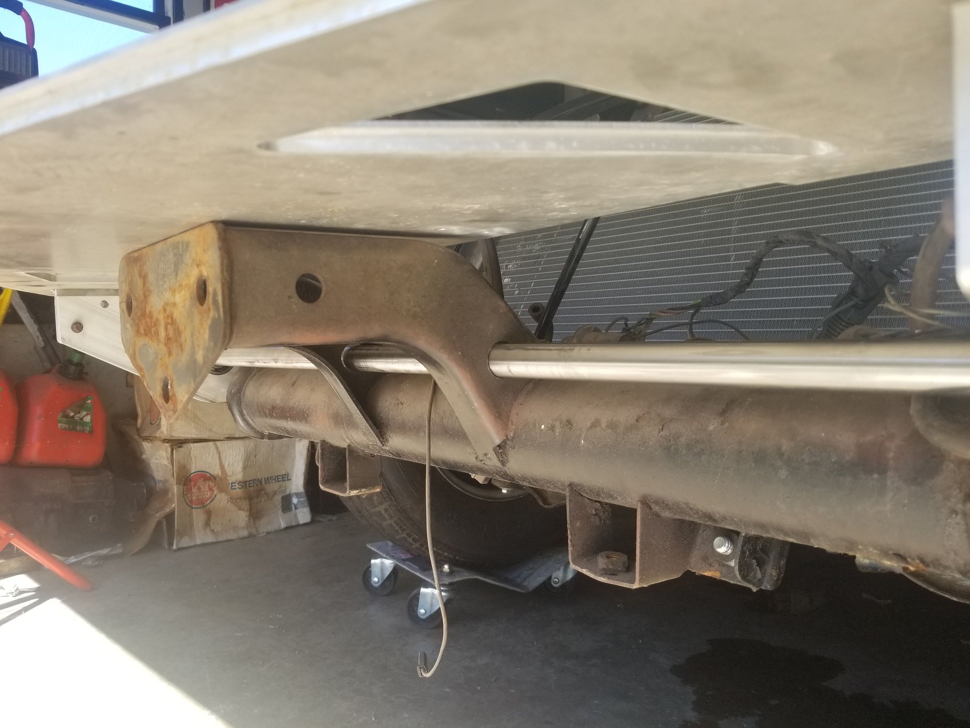

I've been messing with a few other projects, but slowly chipping away at the Vette.
I've begun work on the hood hinge system. It's made out of solid aluminum with pressed in bearings and a solid stainless 1" bar.
Initially I was planning on running the bar thru the factory frame extension thing and trimming the excess off so it could tilt forward. This would work, but it only allowed the hood to open a short amount before the front of the wheel opening would hit the tire, and the front spoiler was on the ground.
To solve this, I cut slots into the factory bracket that now allow the hood to be picked up 2" and go forward 6.5". So now when you open the hood you simply pull it towards you, then lift it up. Kinda like a Viper.

great work!!! Is there enough lateral support to keep it from tipping to the side?
