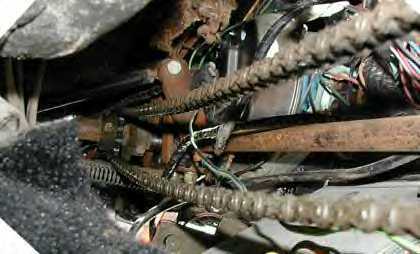

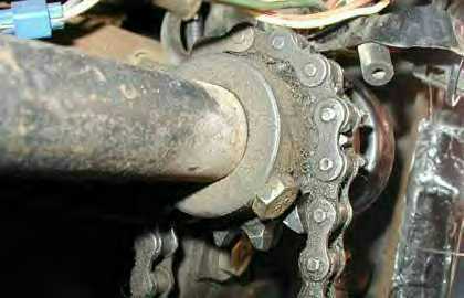

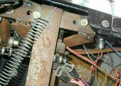

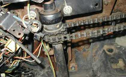

Speaking of the steering column, check out this setup on the original car...
That's a Harley Davidson chain running from one side of the car to the other so they didn't have to move the steering box. That's the right-hand drive!
that’s some sketchy **** right there 😂

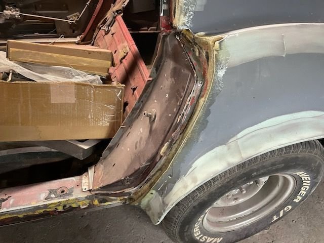

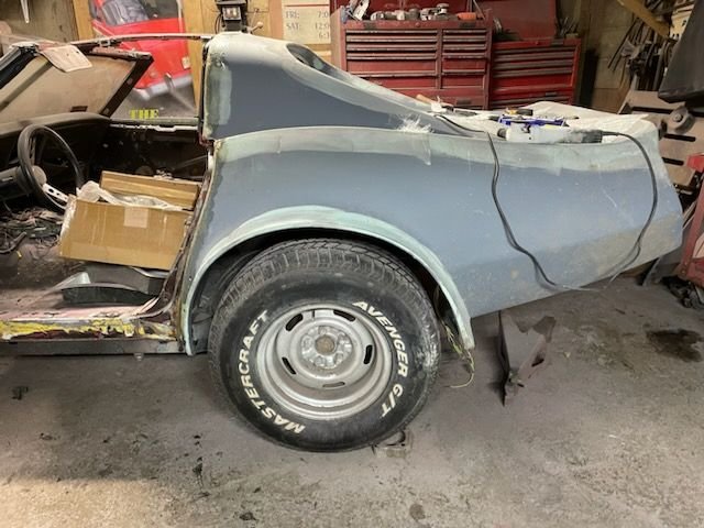

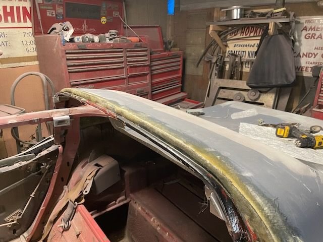

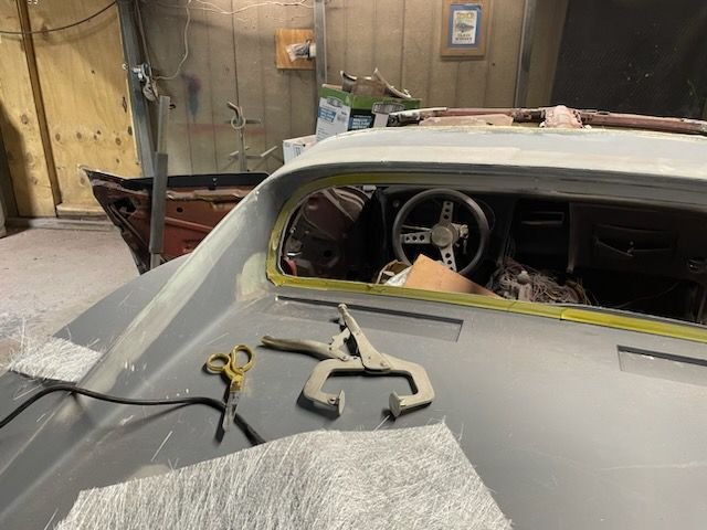

So here's a little update. Bouncing around between multiple projects sure does slow progress down on a build, but the rear clip is finally molded onto the body, and the bodywork has begun. The front clip is already done in rough bodywork, so the car is pretty much complete now. The doors needed a little help along the lower edges where they decided to de-bond from the inner skin. Got that all sorted out.
Up next is getting the rear window back in, figuring out a mounting solution for the tail light lenses, and finalizing the tilt mechanism for the front end. I think I have a plan for that, but wont know 100% until I try it.

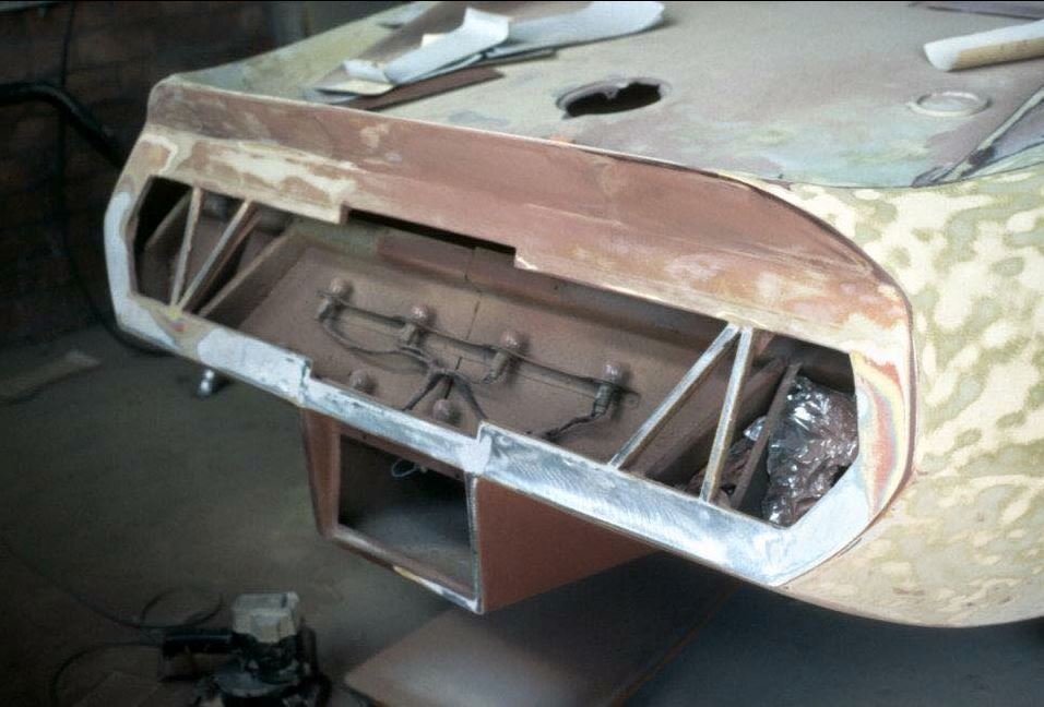

If it helps, I dug up a couple of pics of the tail light lens area from the original cars, snapped when they were restoring/rebuilding the Australian car.

I have a fiberglass tail light bucket that houses the lights. The original is definitely a pretty crude design.
I've been toying with the idea of running an led outline around the entire bowtie as a running light. Similar to what you see on the new Chargers. Should look pretty wild at night.

Yeah, it was pretty crude, but these two cars were made for a movie, so many mods were definitely for the temporary schedule of shooting it. From what I understand, they lined these tail light buckets with paper egg crates and covered those in tinfoil so that they appeared like reflective lenses under the actually smooth plexiglass lenses. When the light hit them, or when lit from within, the effect worked for filming.
Yeah, the original setup was ghetto as hell. Fine for a movie, but not cool for a car that'll see thousands of miles a year.
I'm thinking about experimenting with that chrome paint system to paint the inside of the light bucket. Either that or I'll spray it out in silver base with an *** load of metal flake, which should make light reflect pretty well.
