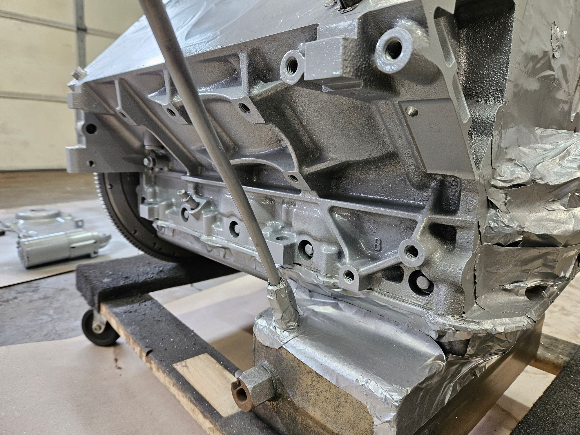

Things are starting to happen with the engine...

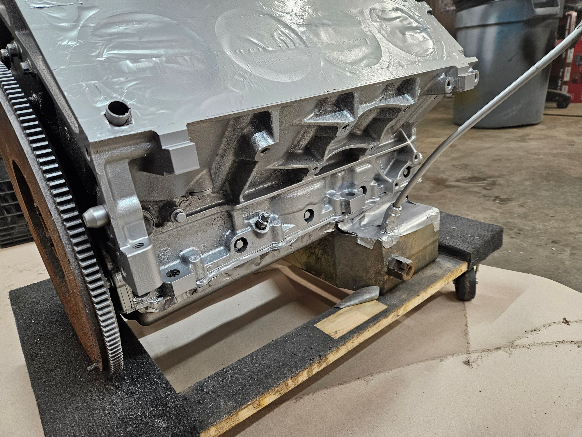

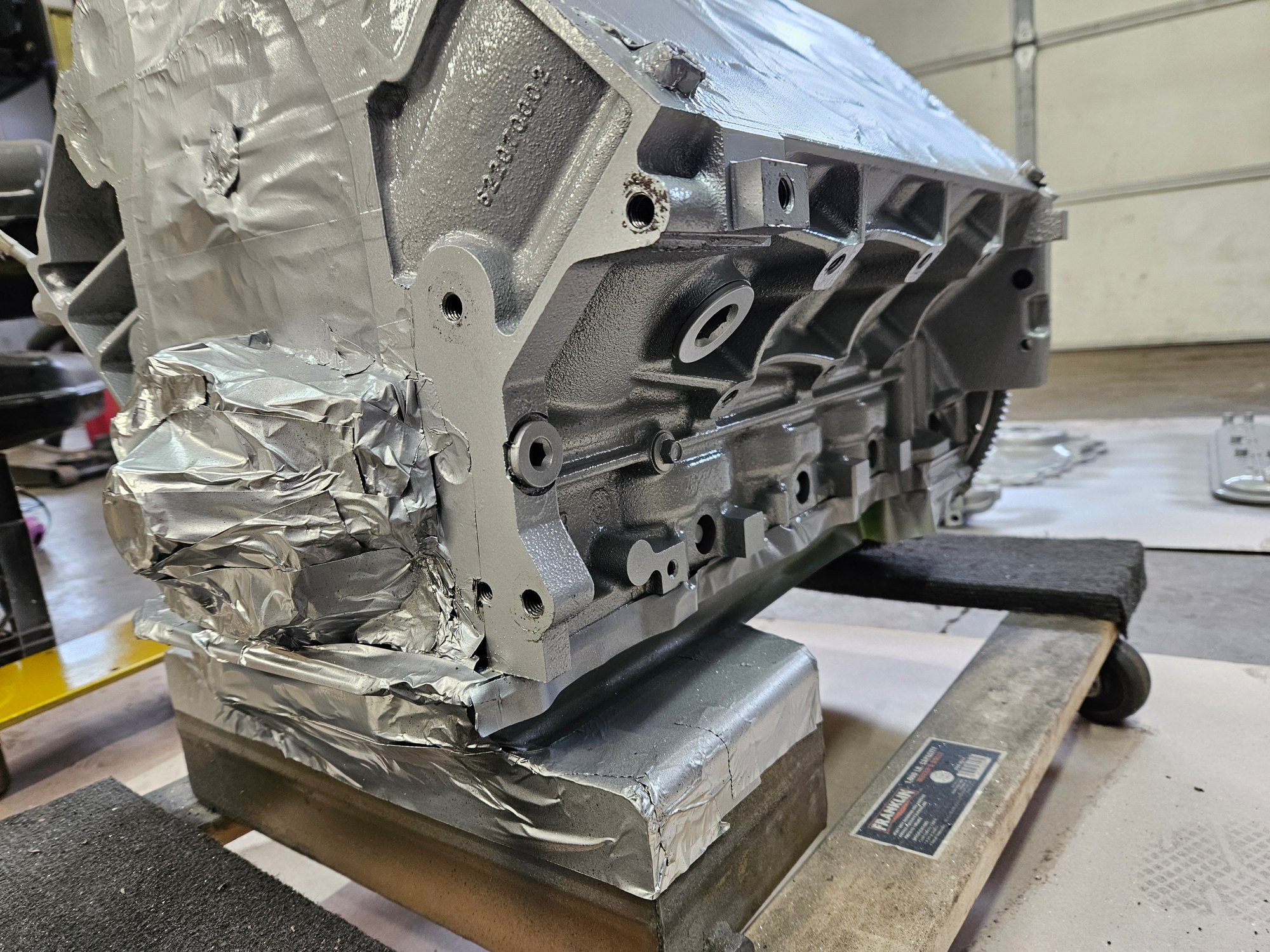

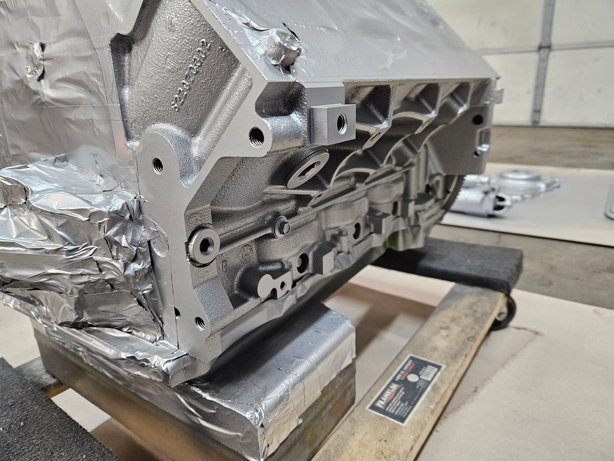

First step of the process done...
Cool stuff coming shortly!

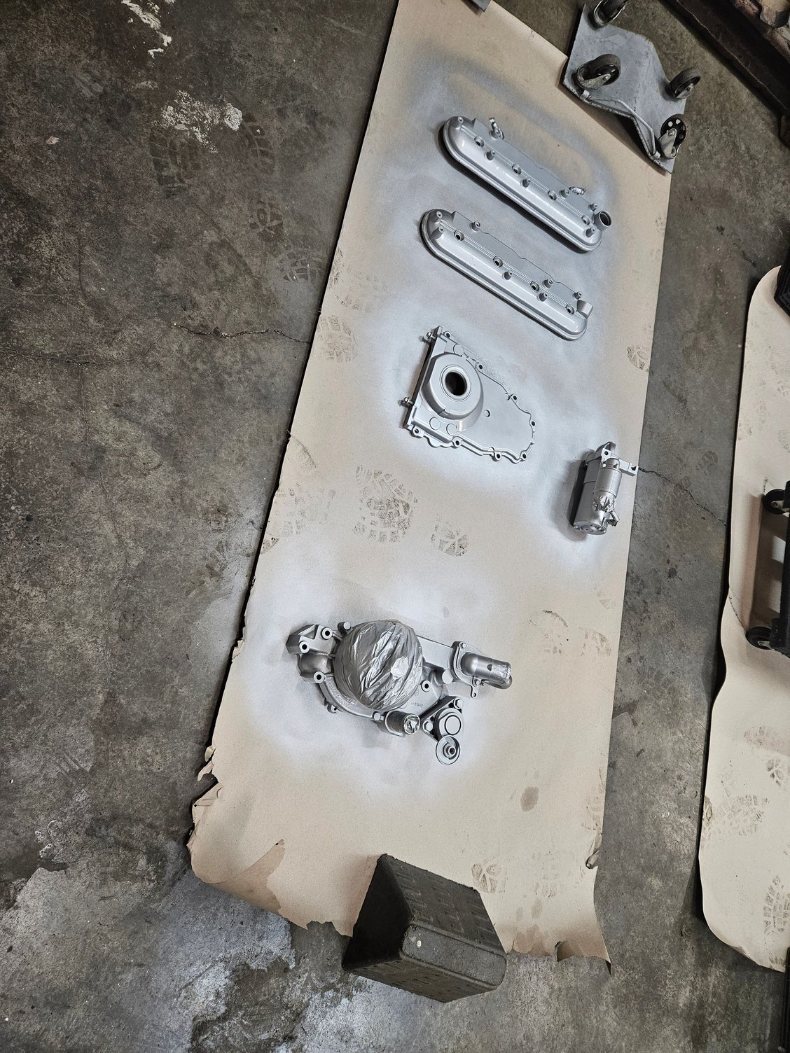

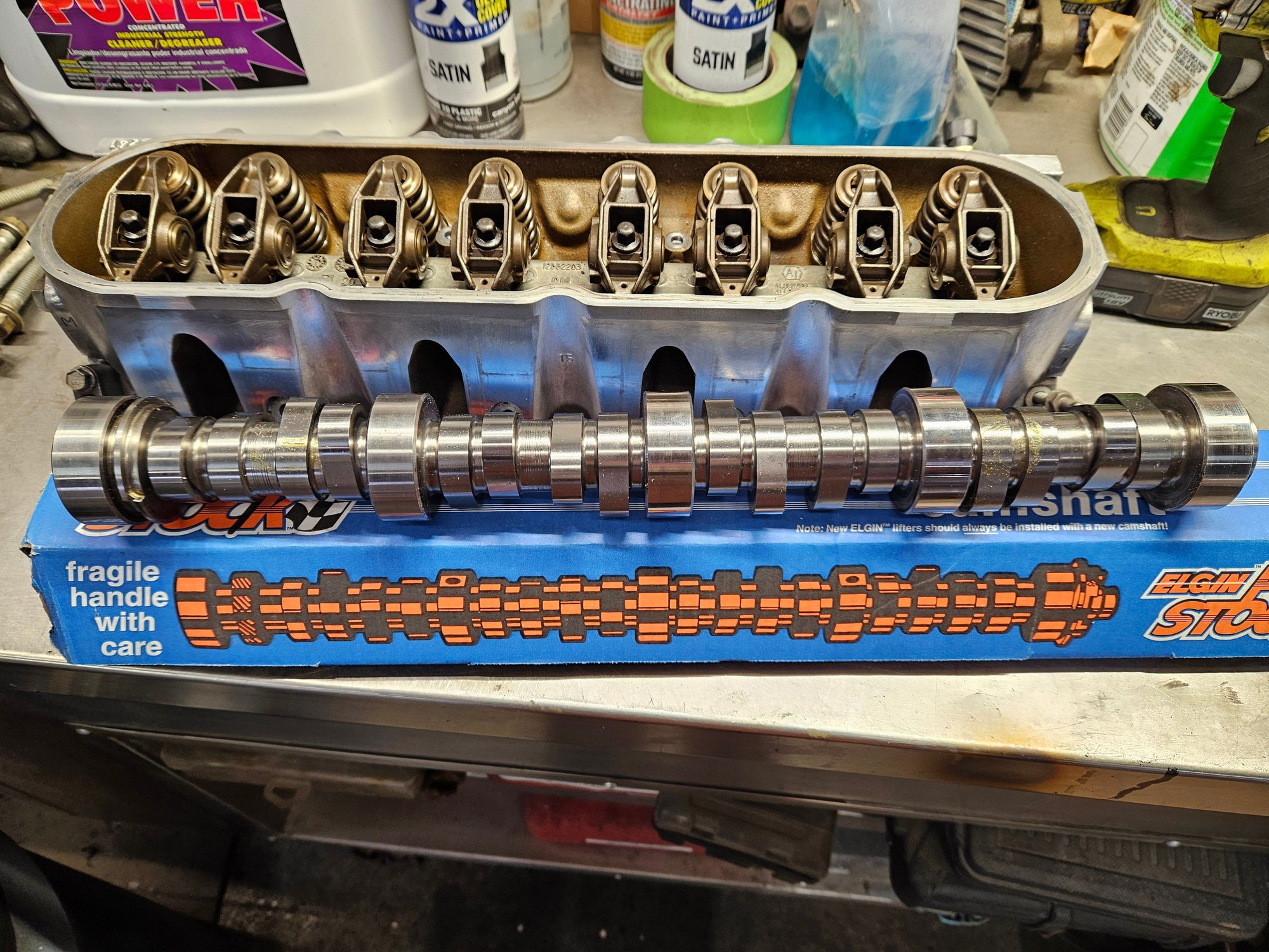

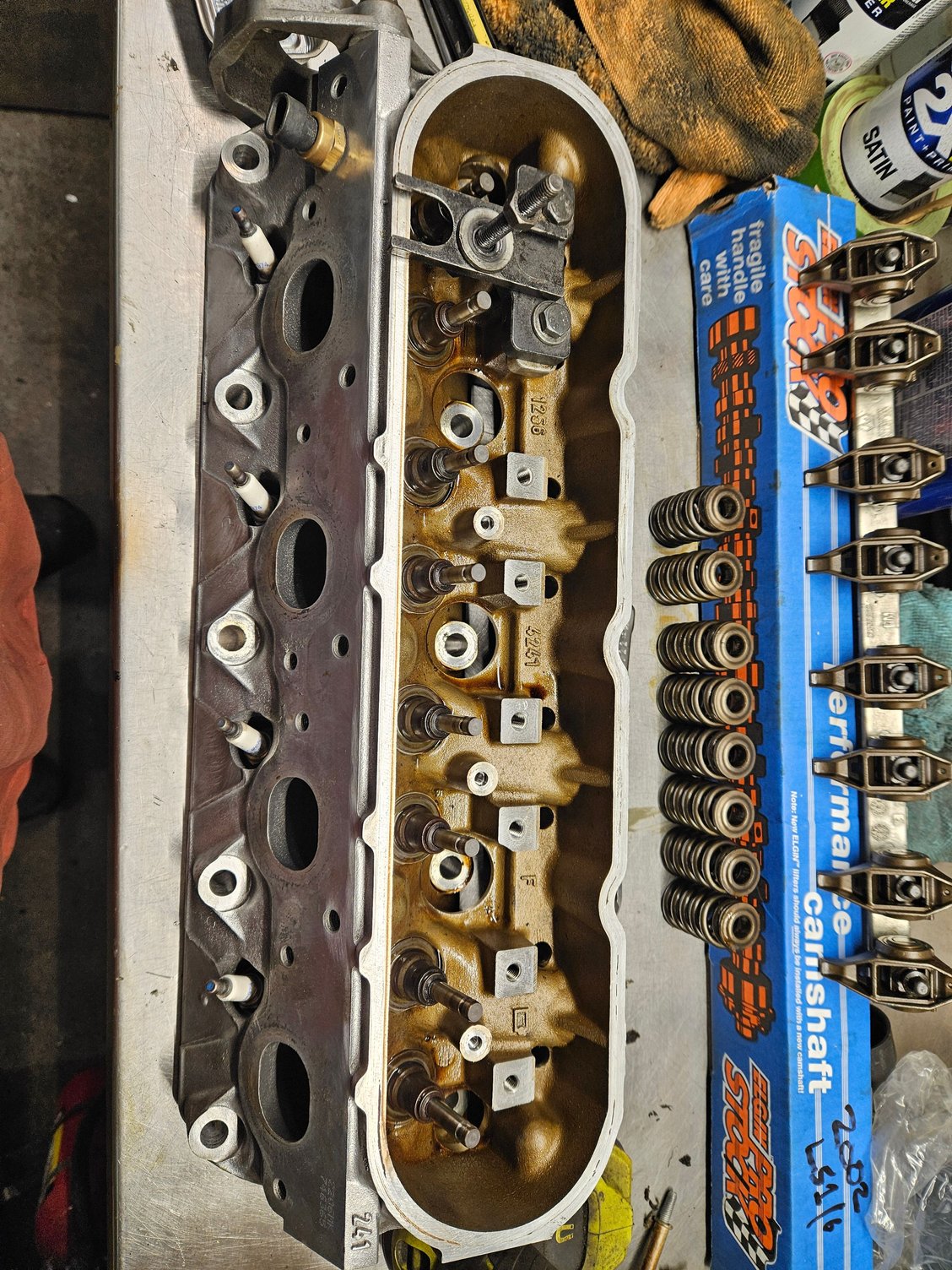

Camshaft arrived. Still waiting on springs.

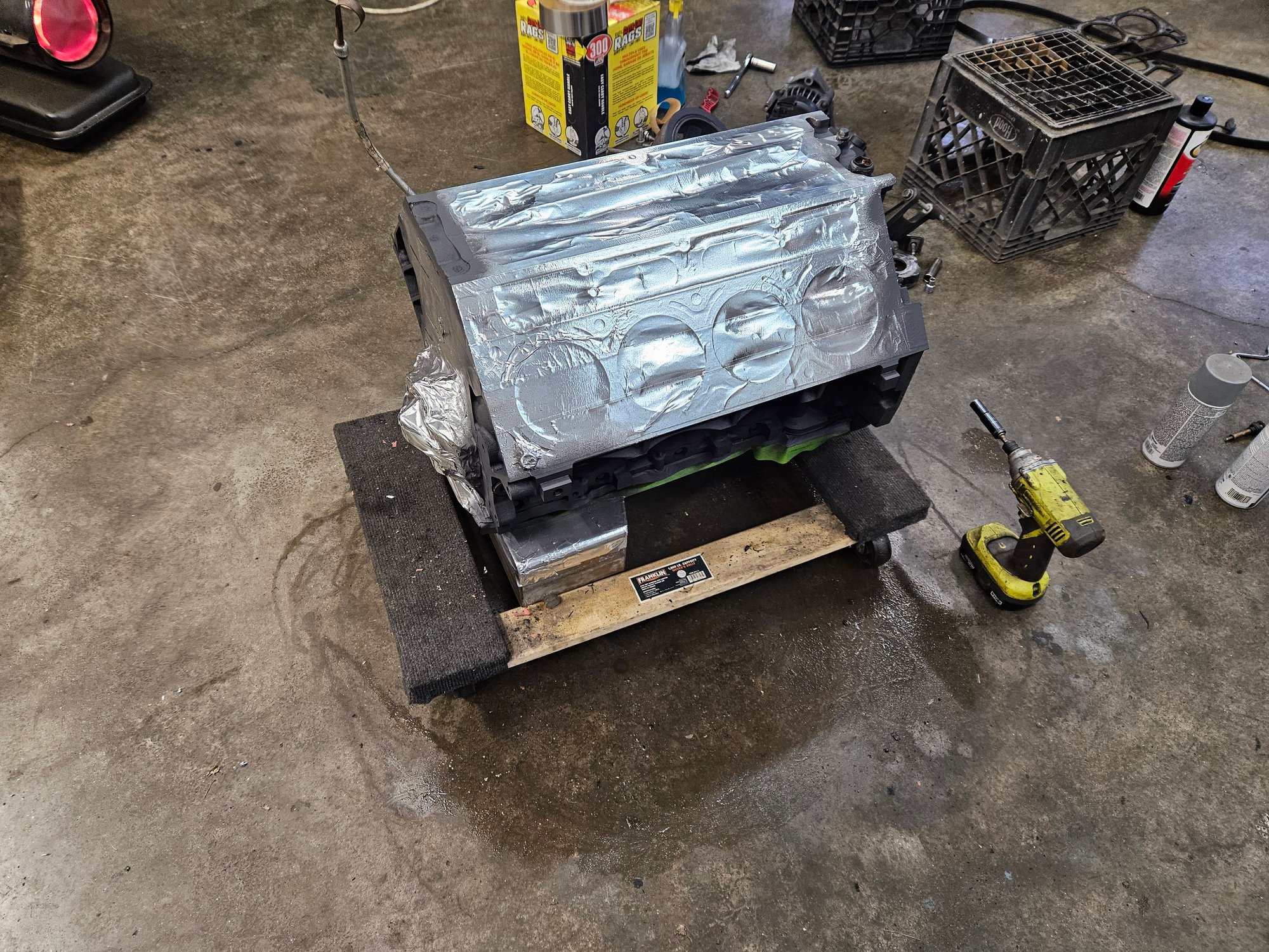

Also still waiting on my metal flake for the intercoat on the block and misc engine pieces. After that is getting the candy treatment...

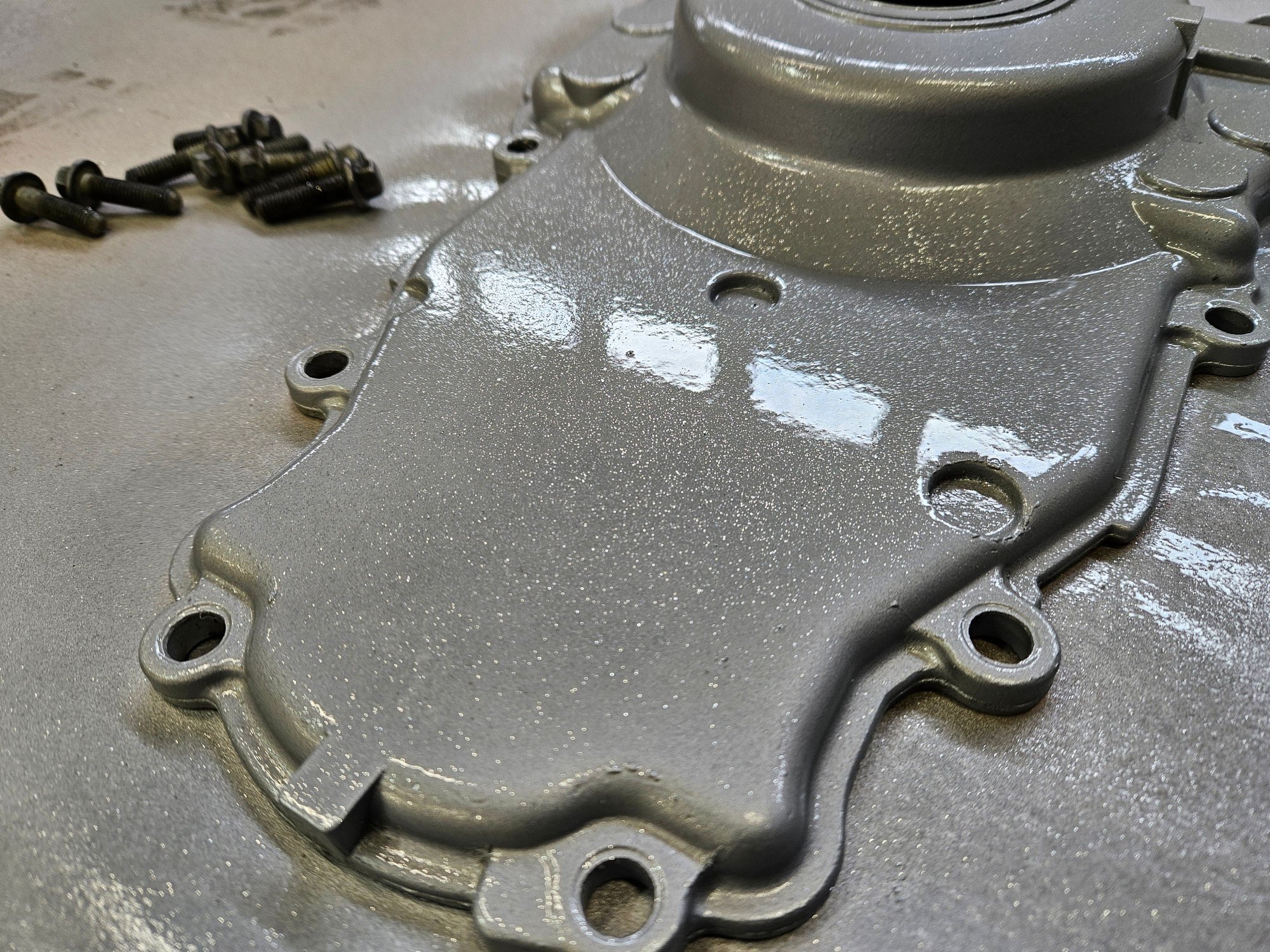

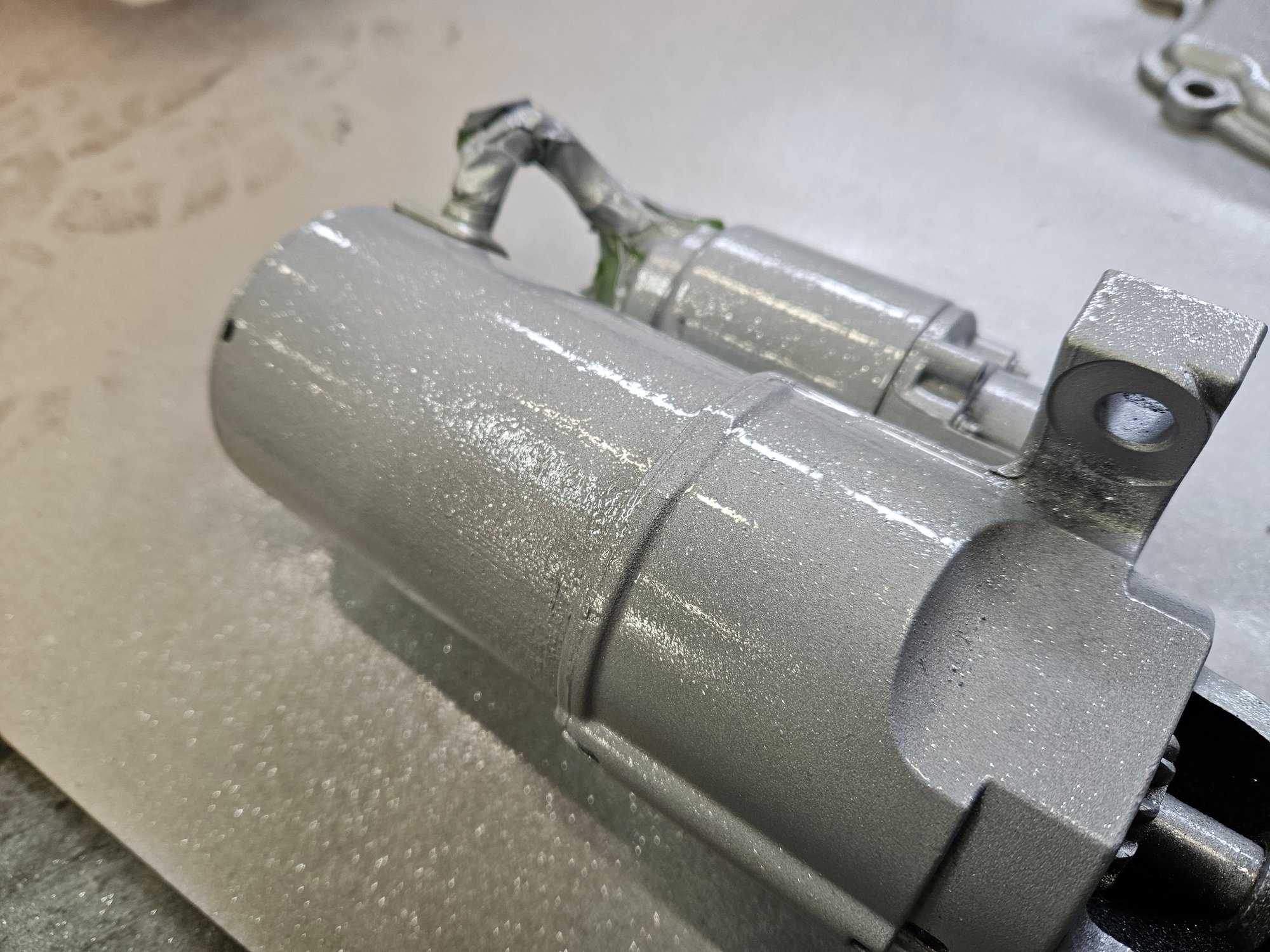

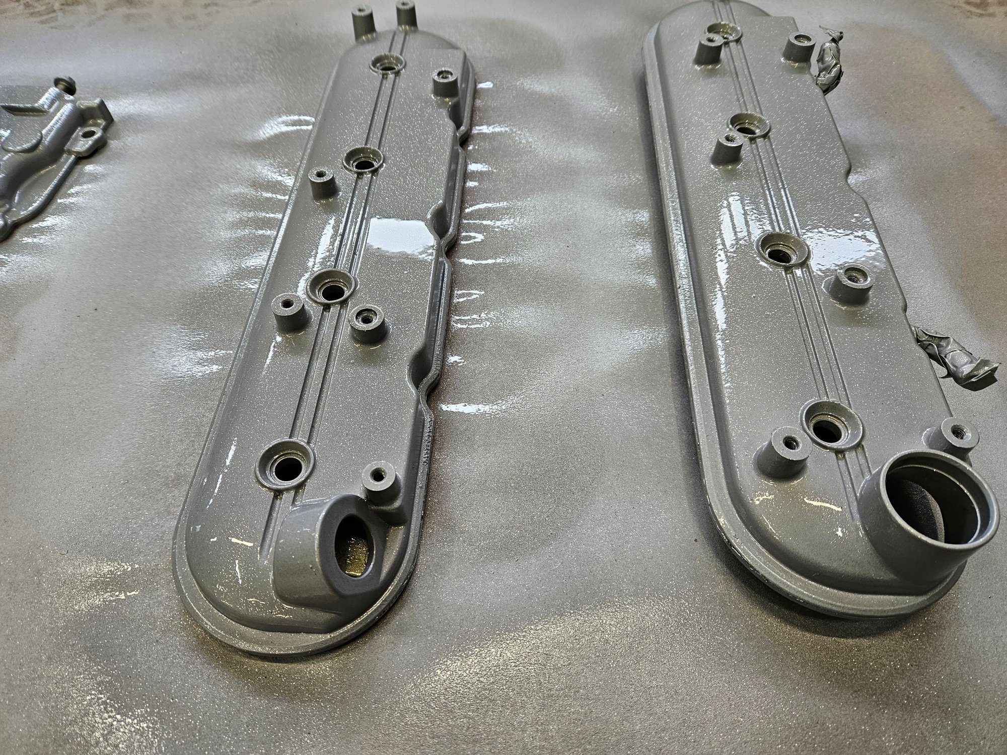

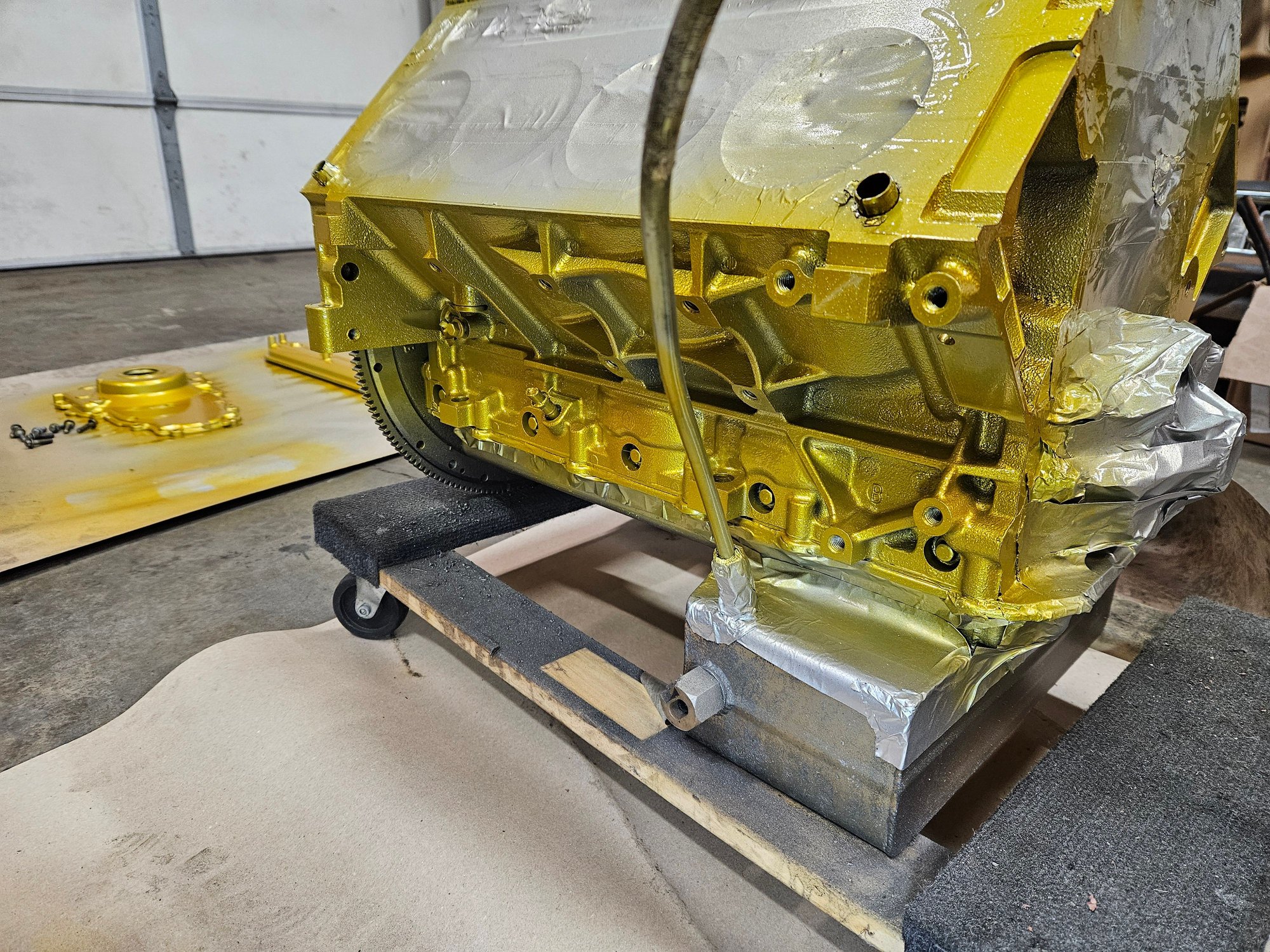

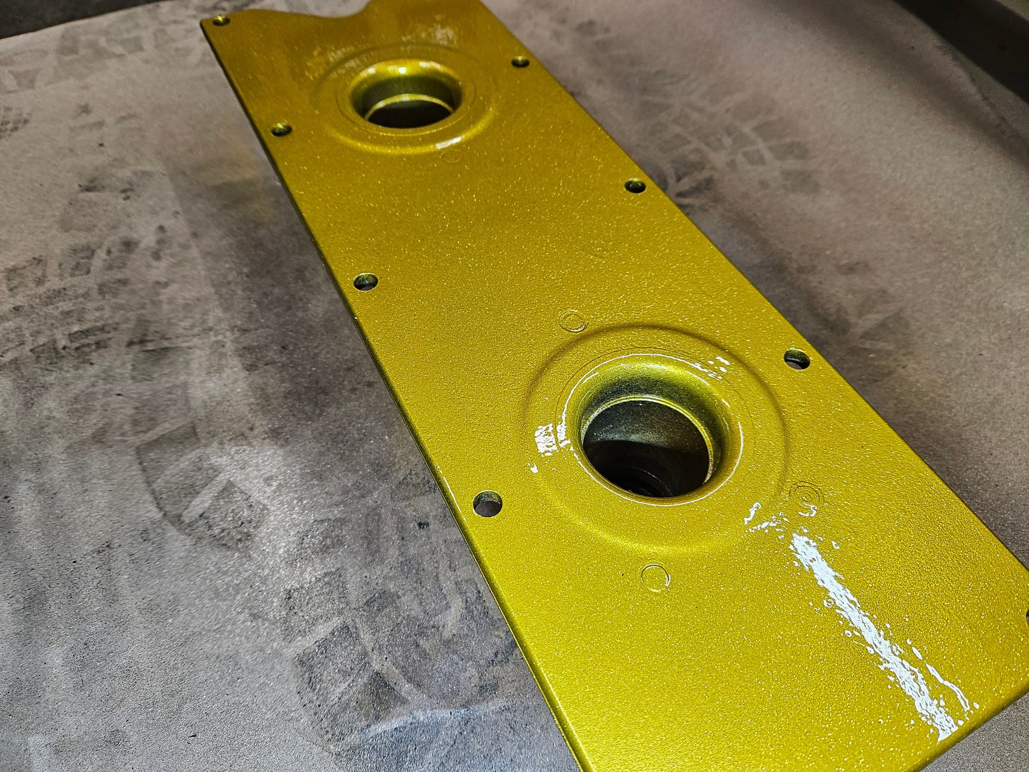

Laid down 3 coats of silver metal flake. She's glistening and gleaming now! My phone kinda struggles to show how much flake there really is.
Up next, candy!

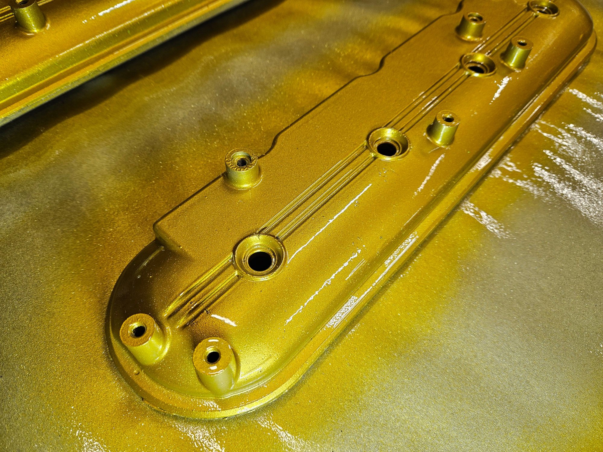

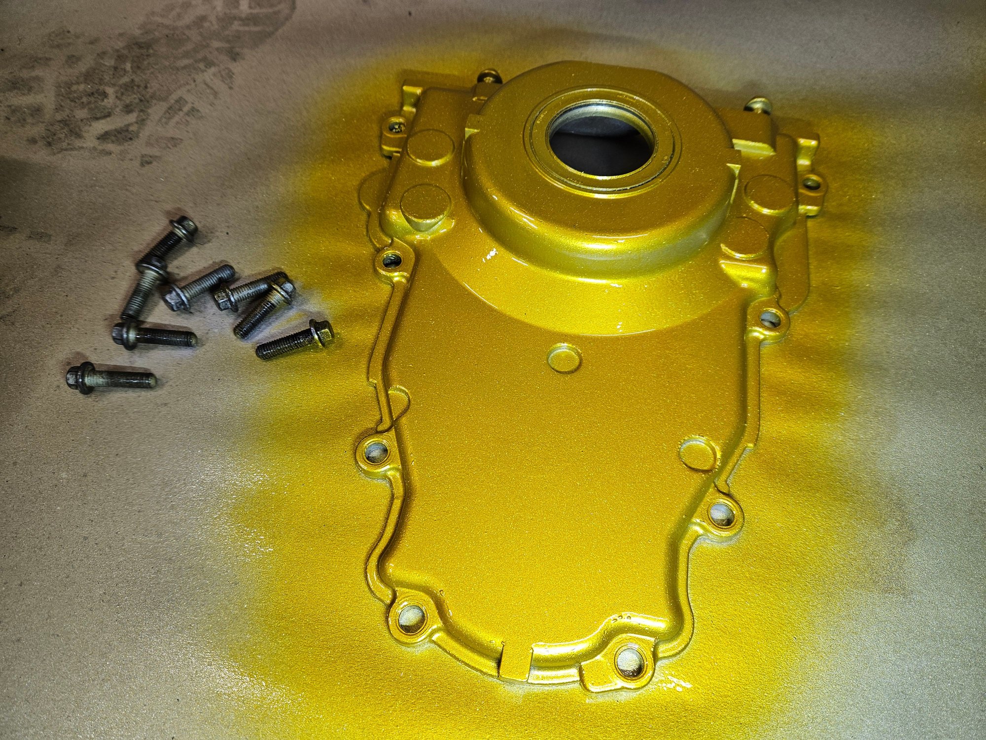

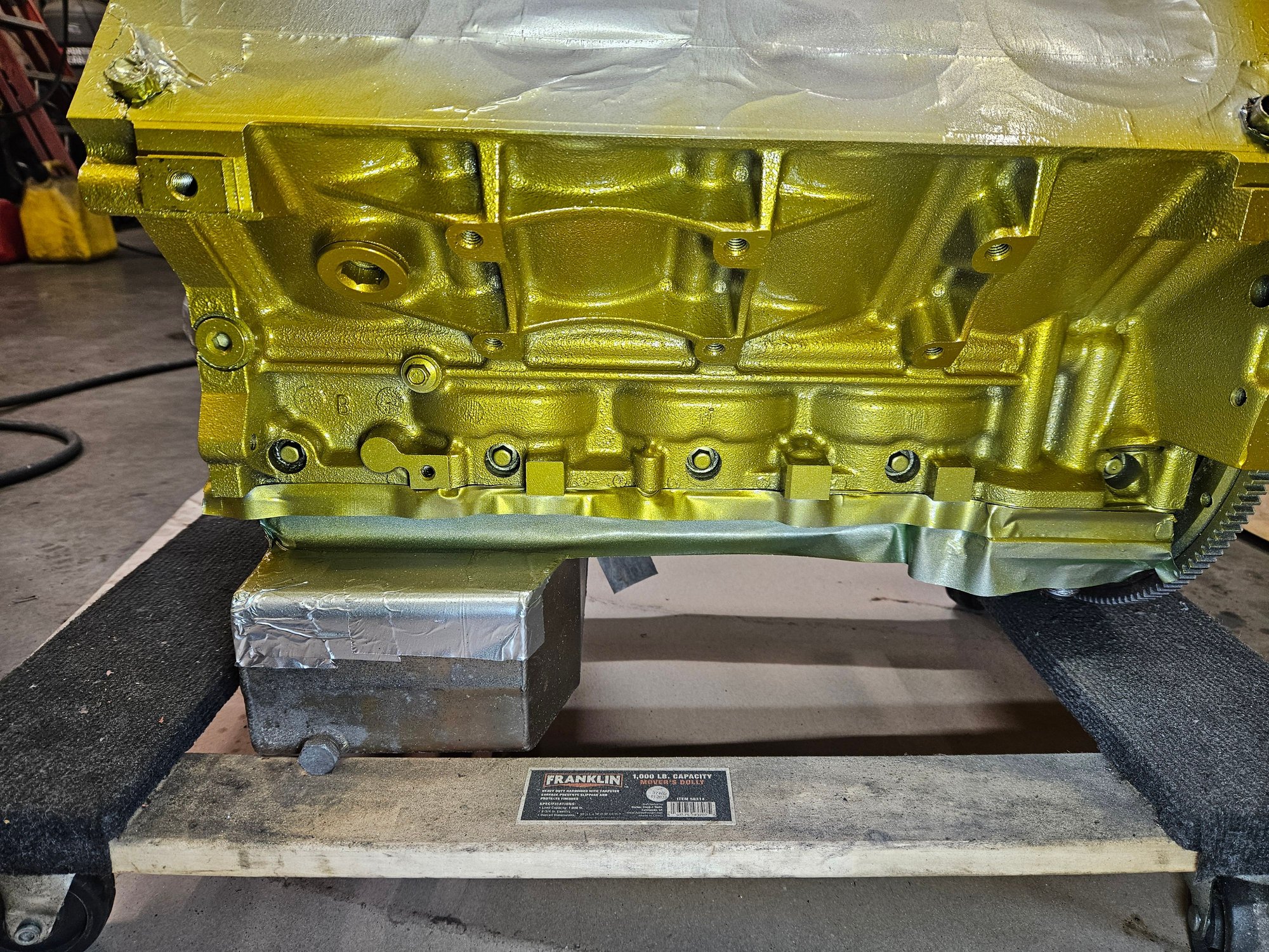

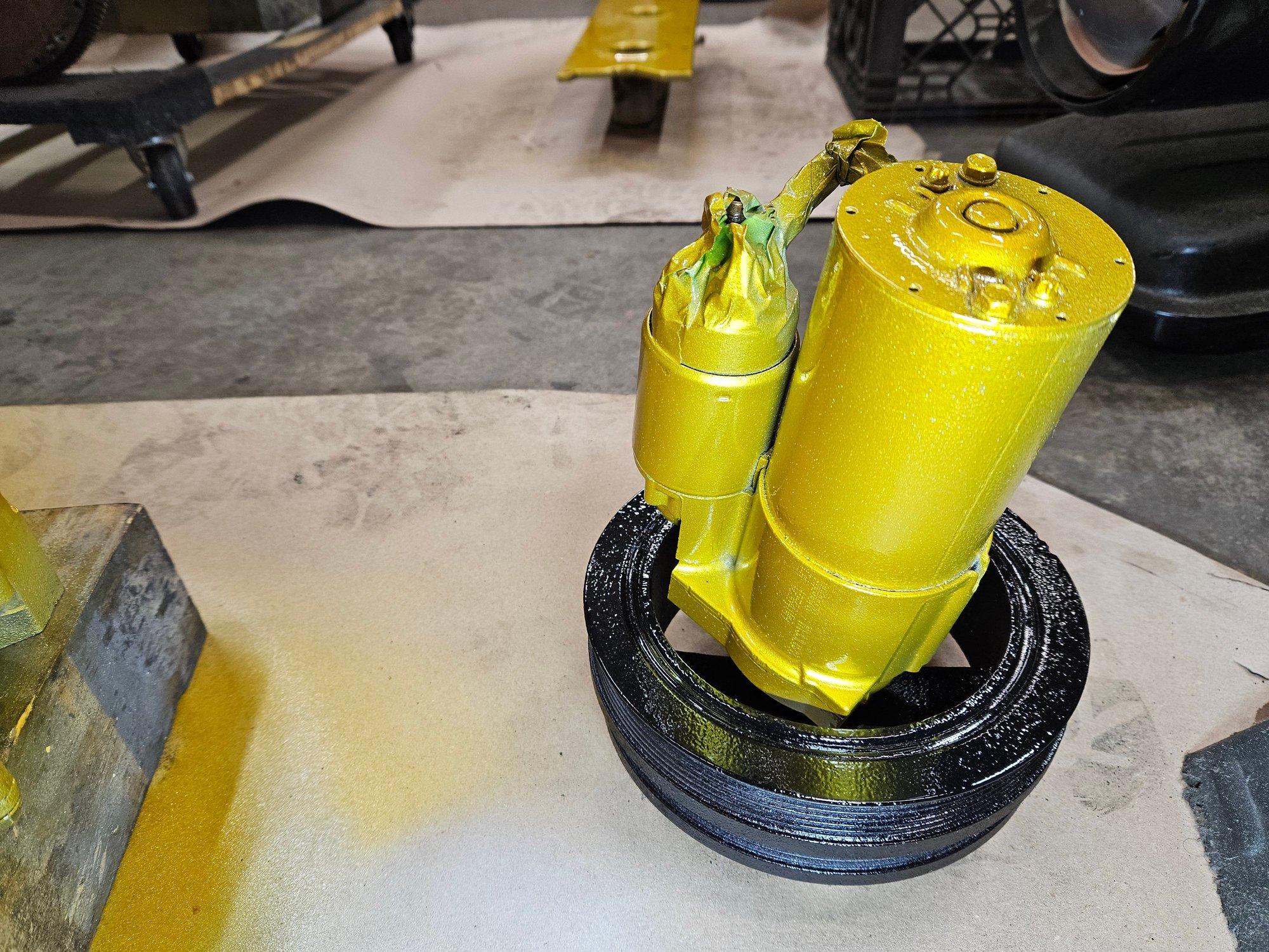

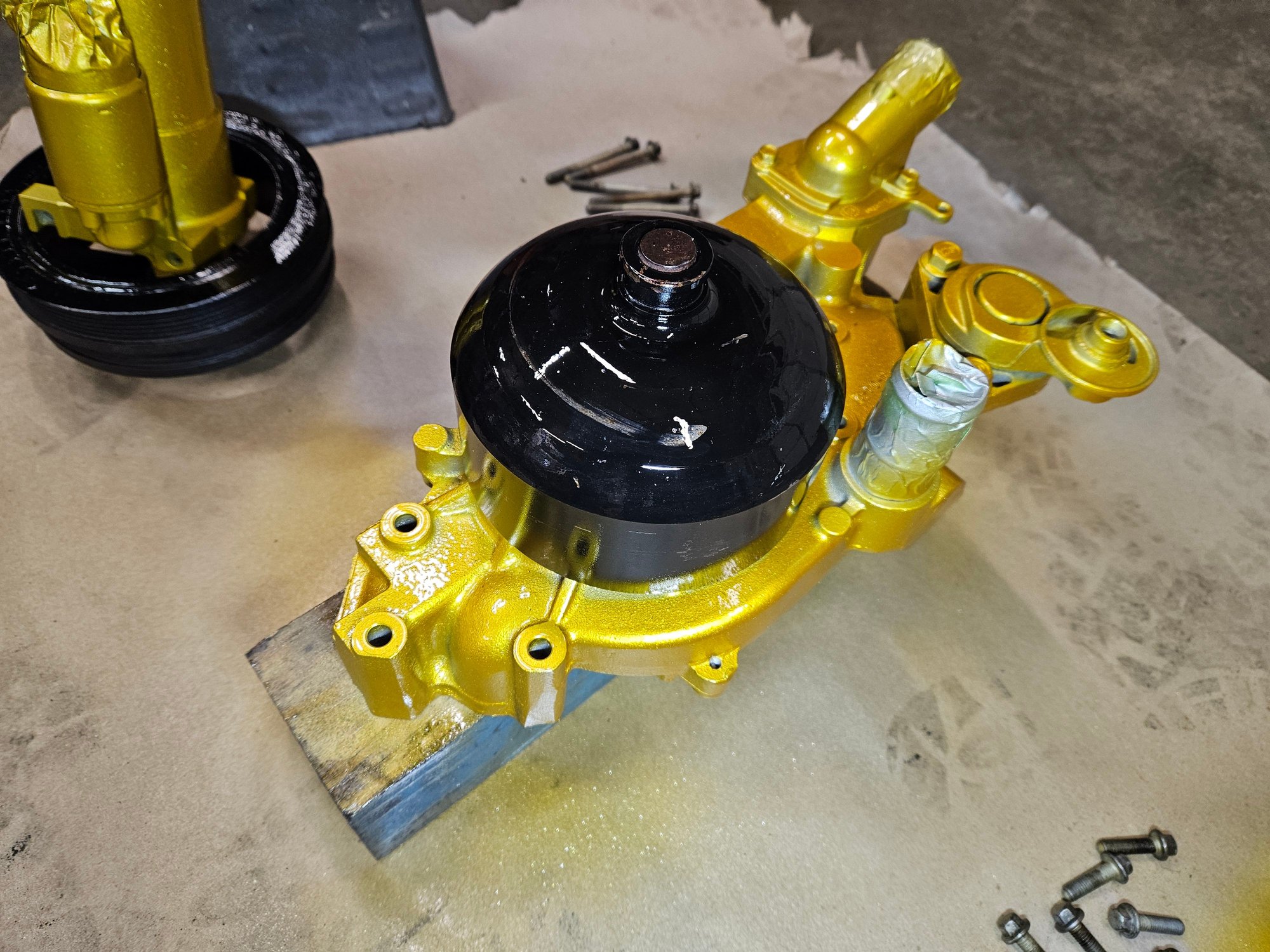

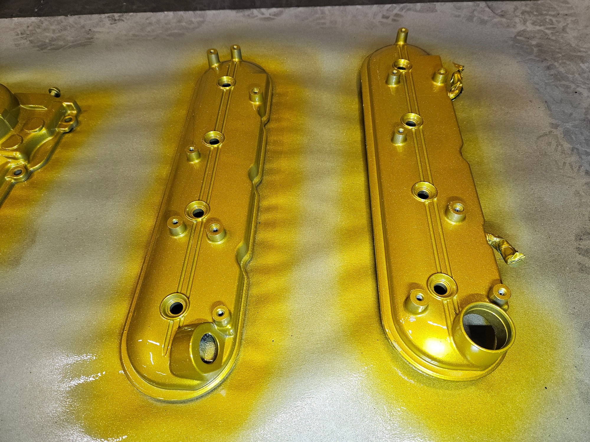

Got the gold candy laid down, along with 3 coats of clear. Pics don't do it justice. It looks like a gold nugget!

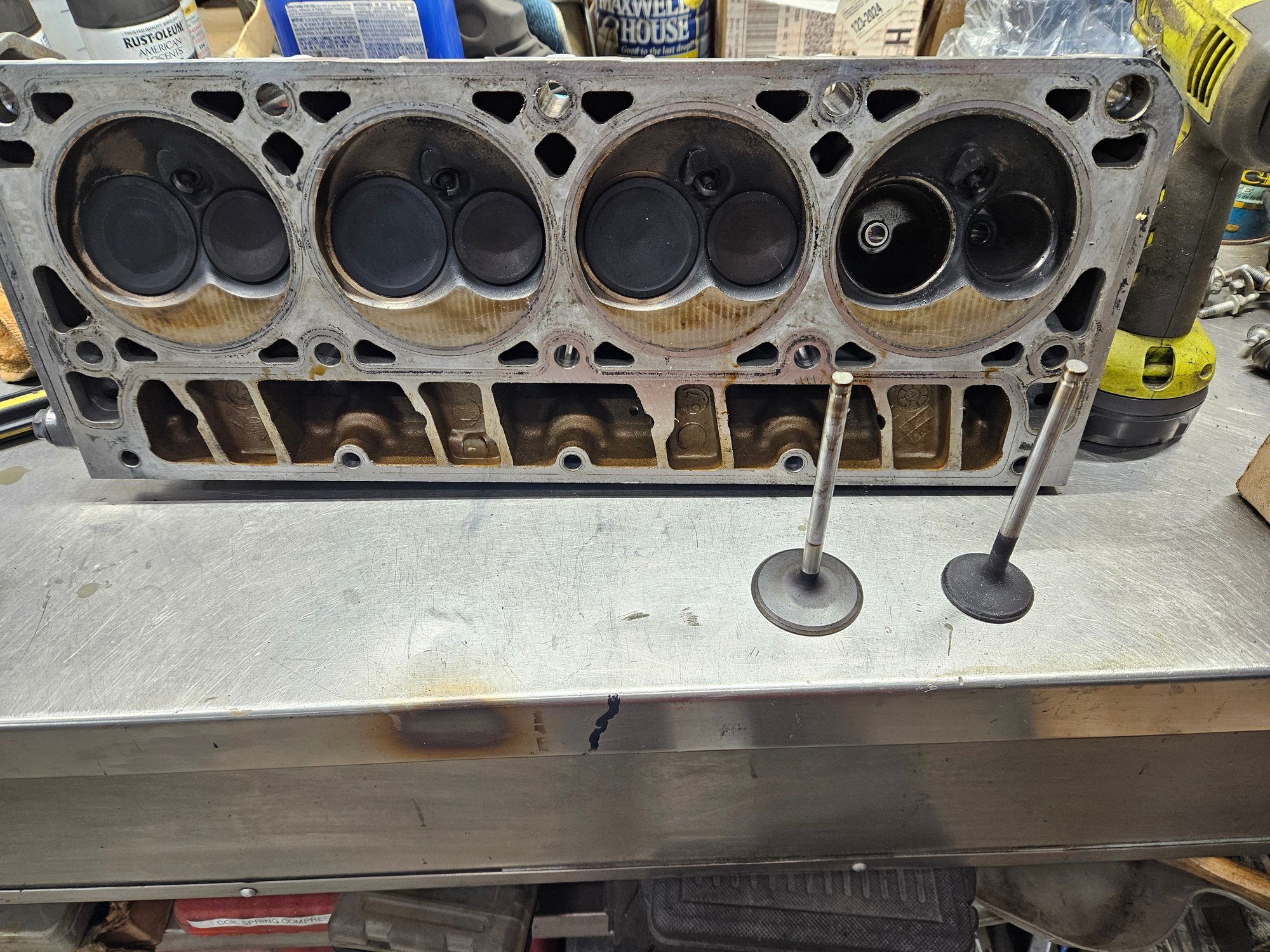

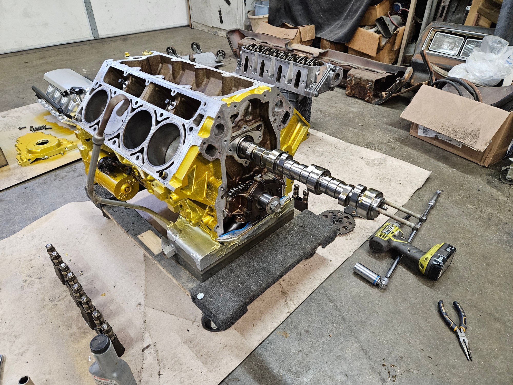

Camshaft and springs going in today. It's a Trick Flow 228/230 .585 112lsa with Pac 1218 springs, along with a sheet metal high rise intake and a Mark Williams 102mm throttle body.
I ran a similar setup on a 6.0 and it made 373hp to the wheels. This having a half point more compression, and better cylinder heads it should make decent power for what it is.
Also ordered my torque converter. Should stall between 3500-3800 in this combo.

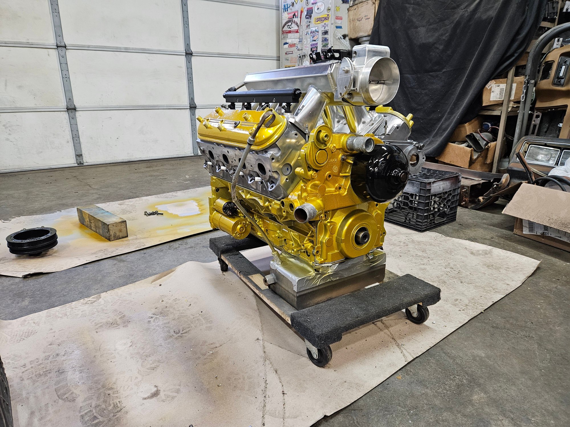

Well I couldn't help myself. I mocked up the engine to see what it looks like. I must say I'm very happy with how it's turning out!

It was fun painting it. Any time I get to play with candy paint, I'm very happy! lol
I picked up a polished oil pan for it, to tie in with the polished intake. I'm thinking about painting the accessory drive black. Originally I was thinking candy red, but after seeing the engine done, I don't want to take away from the gold. Plus, the shaved firewall is going to be red.
Next up is getting back on the bodywork. Finalizing the tilt hood assembly, and shaving the firewall.

New camshaft going in
