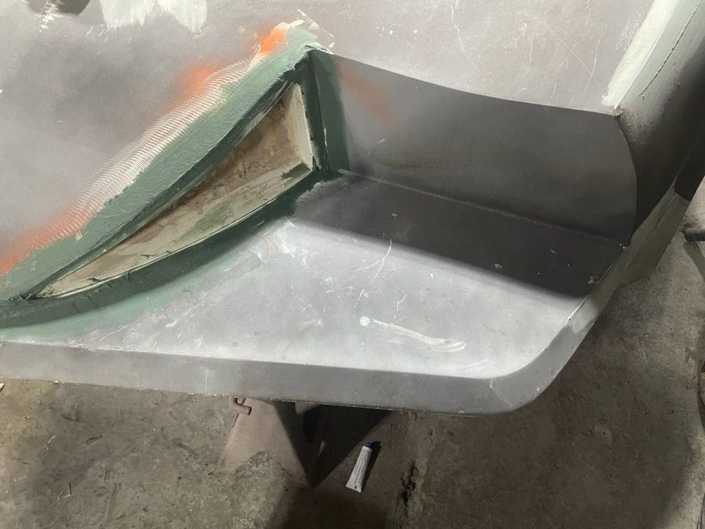

the curve is unique and cool...I would keep it, also gives the passenger some leg room
That's kinda what I figured. I like it. It basically happend by accident, but it's unique.

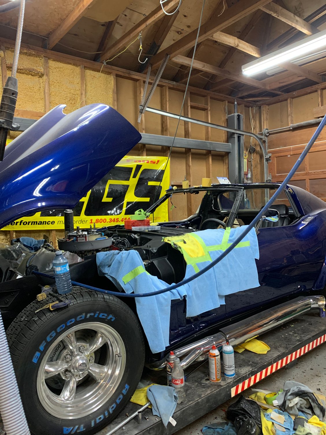

I've been slacking on the Vette, and busy with other cars and just life in general, but here's how it currently sits.

Thats alot of. work youve done

Life things have a habit of slowing projects down, just keep pushing along as time permits and you'll get there, it's LOOOOOOKKKKIIIINNNNGGGG GGGGOOOOOOOOOOOOOOOODDDDDDDDDD!

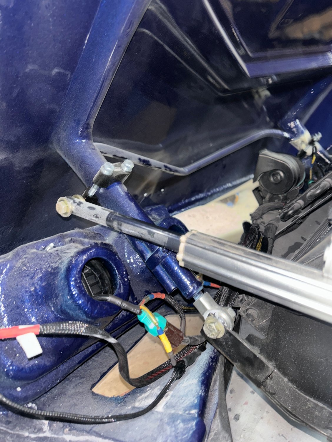

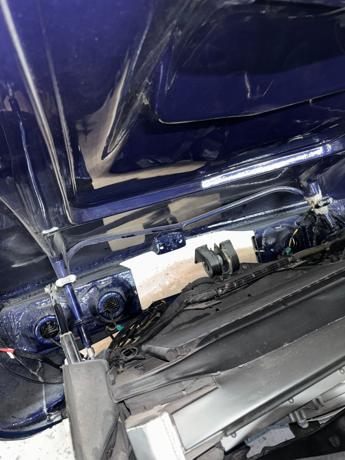

I'm at the point now where I need to mount the hood hinge setup permanently. I have a few ideas for it, but haven't settled on one yet.

The Ecklers setup on mine is so simple, it has a 1/2” conduit that stands it off the frame rails, then has rod ends inserted in the ends that bolt through a couple of angle plates the bolt to the frame horns.
It’s so 70’s uncomplicated and simple and works perfectly. The conduit is glassed into the underside of the hood. I have adapted hydraulic rams to the conduit to open and close it.
Excuse the dust
There is a spreader bar from one side to the other.
Dave
