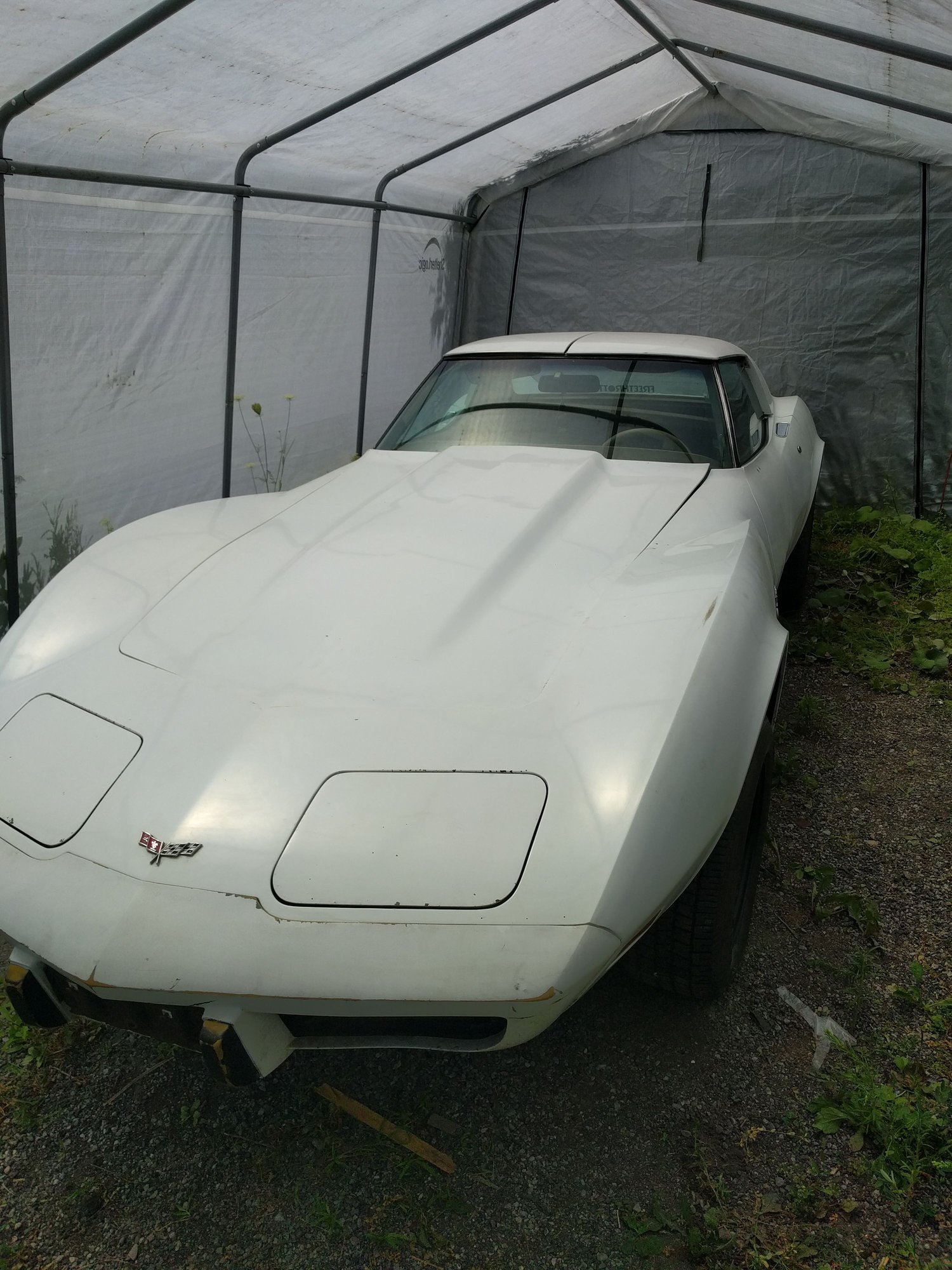

I picked up a 1977 C3 with 4 on the floor last week for a great price...
missing a few little things though
The Engine and interior (seats some trim and carpets)
The dash/cluster had been removed and the wires cut to make it easier for the remover!!!!!!!
Also everything from the dash/cluster was covered in oil residue, so everything is in pieces getting cleaned.

Thanks for adding photos! White C3s are favorite.

Just a FYI when you decide to replace or repair the main dash harness.
It's not 100% clear from the photo of the car but I see the left side fender cross flag emblem but can't see any signs of a alarm key switch near the emblem, If so you have a late build 1977.
All late build (or 2nd design) main dash harnesses are the same auto or manual transmission.
If it's a 1st design build stay with all manual transmission 1st design wiring. There were several changes made from 1st to 2nd design.
I also see the interior courtesy light timer laying on the floor. If your plan is to reuse it make sure you keep the complete timer harness as it is a separate harness connected to the fuse panel and the main dash harness.
Also looking at some over-spray on the Wiper/Washer wires I see the original interior color looks to have been Buckskin.
