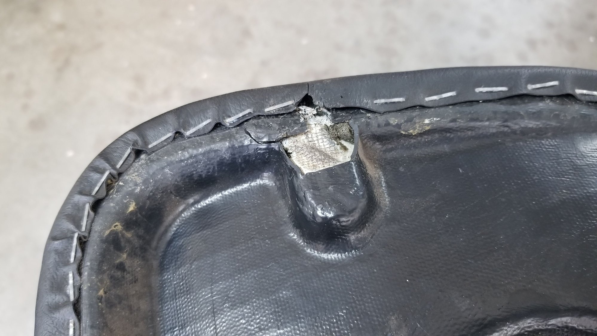

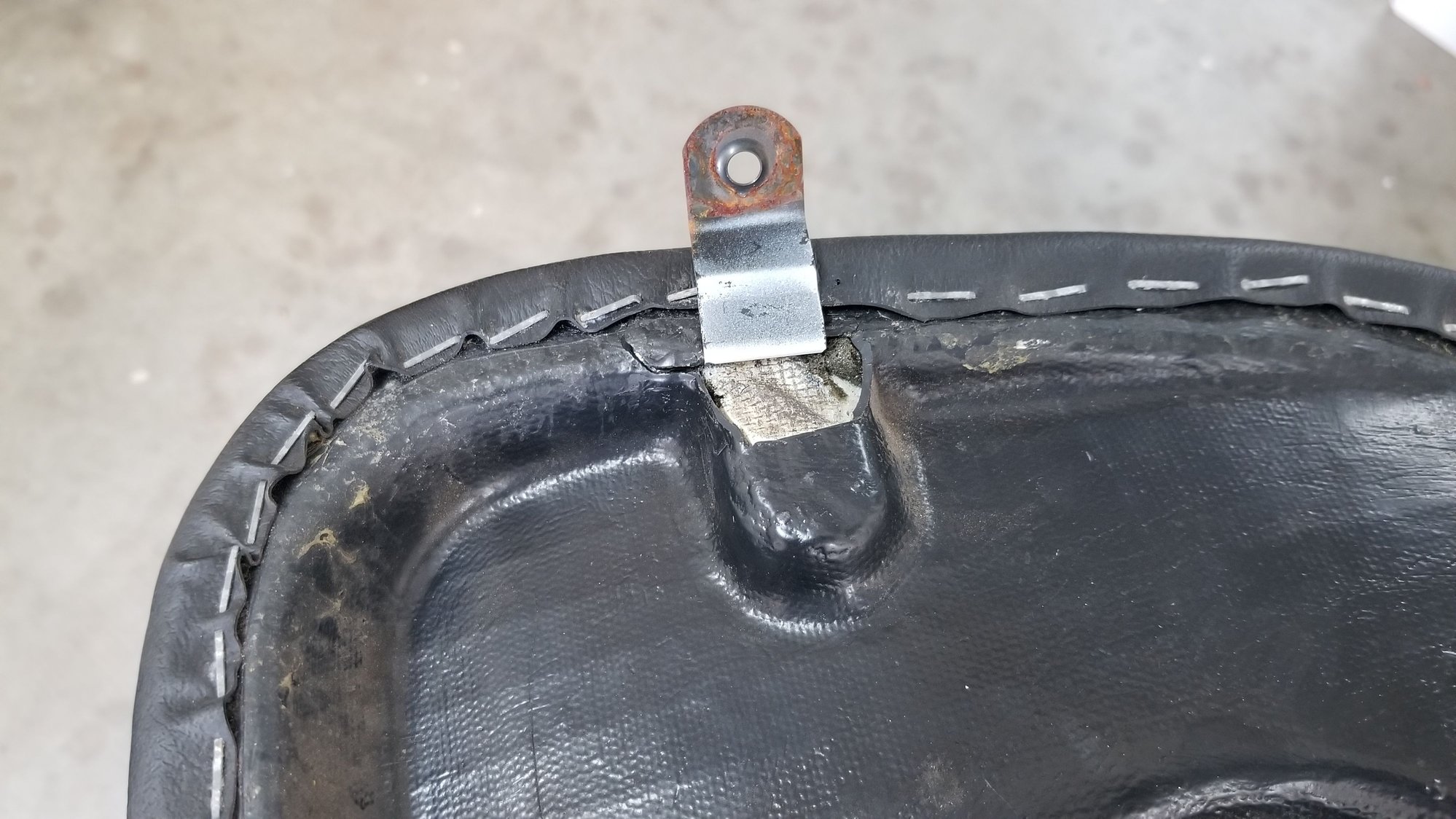

Hello all, my door panels do not fit worth a darn... I pulled them off and it looks like they use some sort of a velcro type connector around the edges accompanied by a few screws. The top fits "ok" but they bottom is flared out 2 inches. The panel is definitely bowed. The two metal clips , one on each side, are detached from the door panel. Is this how the stock door panels were supposed to be attached to the door skin? Any advise on how to repair them would be helpful. I have my own ideas but thought I'd check before I got in there. Thanks, Paul

Yup that’s factory. The metal clips and screw do a decent job of pulling the bottom in. If those are broke that’s why it’s bowing out.

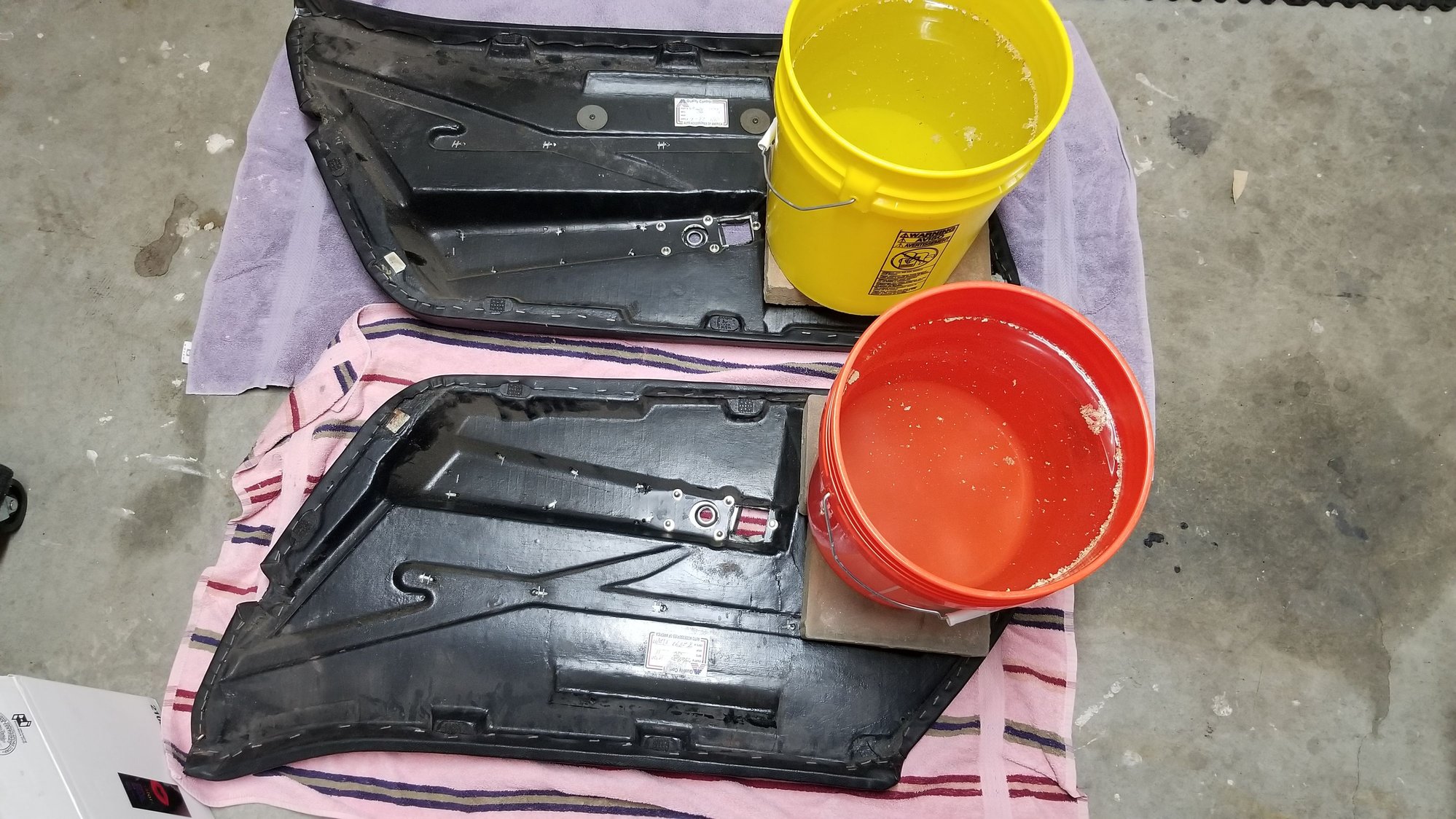

7T1vette,
Thanks! The panels I have are repos with a plastic backing vs cardboard substrate. I ended up doing essentially what you are getting at using a heat gun on the back and applied weight to them as shown in the pic as you also suggested. They cam out pretty darn good after about 30 minutes. I have some other work to do before I put them back on, but I'm sure they will fit much better now.
Thanks again,
Paul
5 gallon buckets filled with water did a nice job holding these heated up panels in place to unbend them.

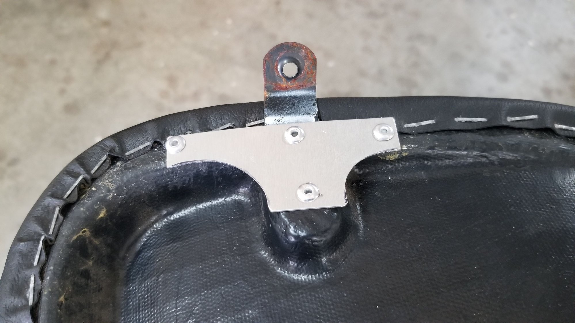

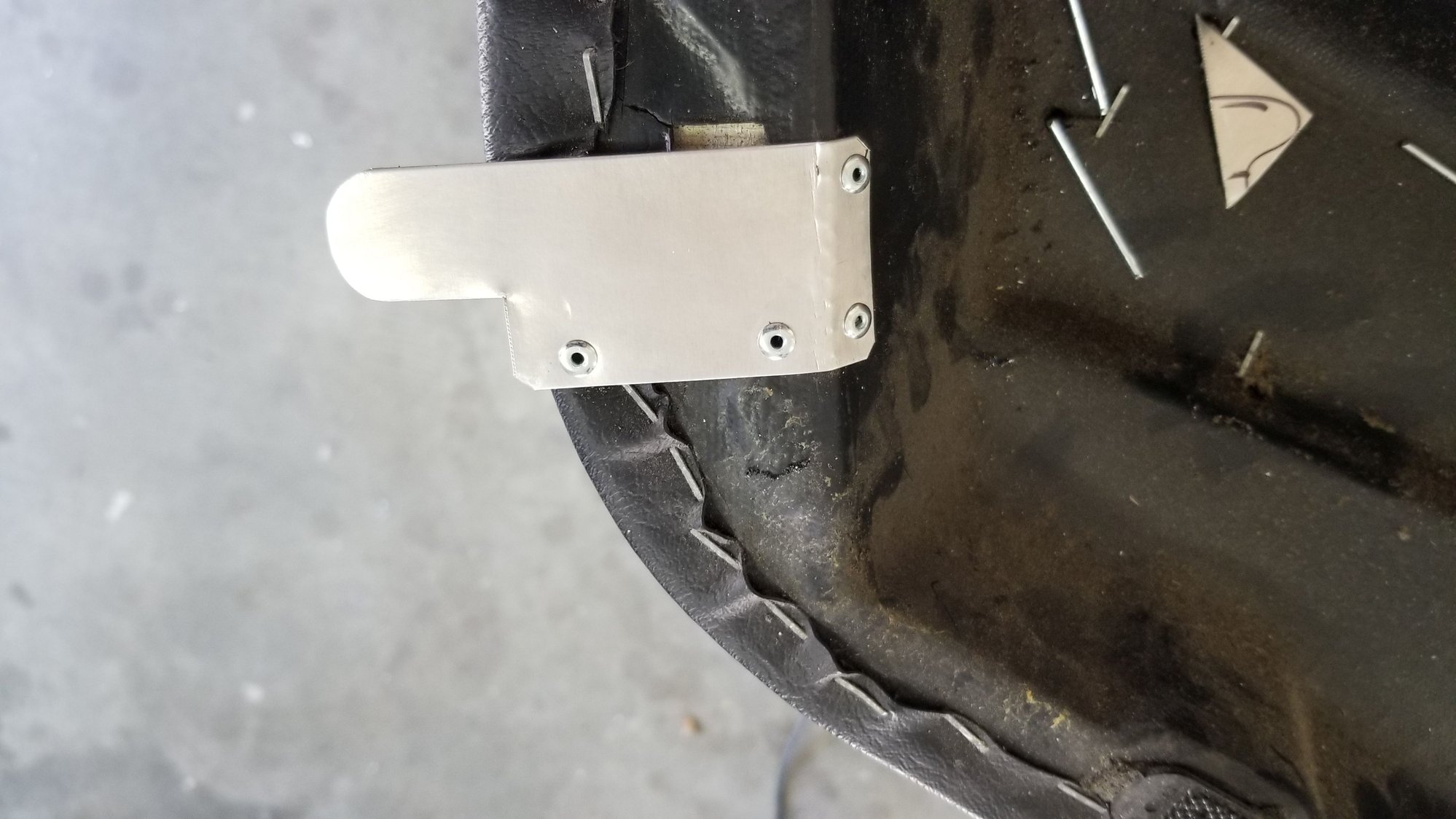

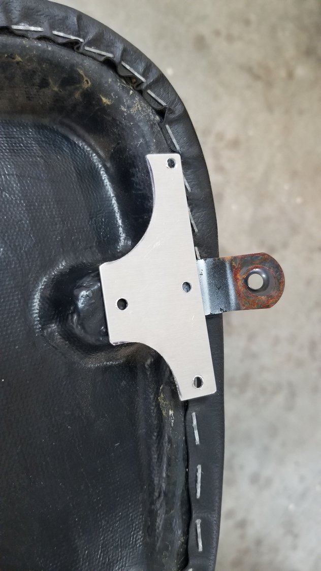

I ended up making some new mounts and reused the oem clips... they worked great. The door panels are rock solid and tight to the door :-)

Thanks for this info, I will be adapting '68 door panels I recently ordered for my '74. My car is far from stock, so I am building it the way I want it. Any more pictures?
Old Jan 1, 2021 | 12:46 PM
Margozzi's Avatar
Margozzi
Joined: May 2019
Posts: 46
Likes: 8
Richard,
See attached pics. In some cases I had to create the new tab vs incorporating the oem tab into the new brace.
Good luck on your 74! I'll be interested to see how it goes putting 68 panels on a 74 :-)
