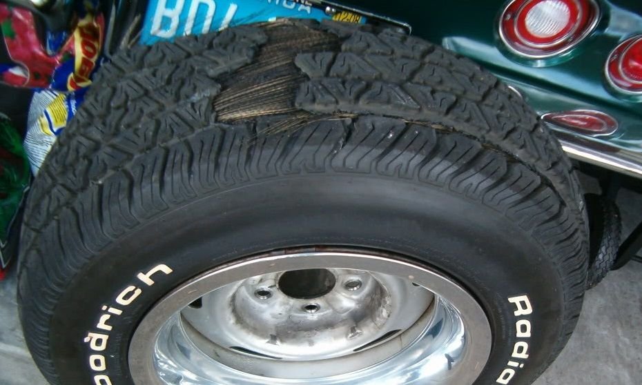

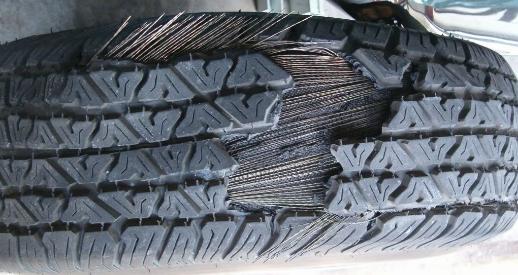

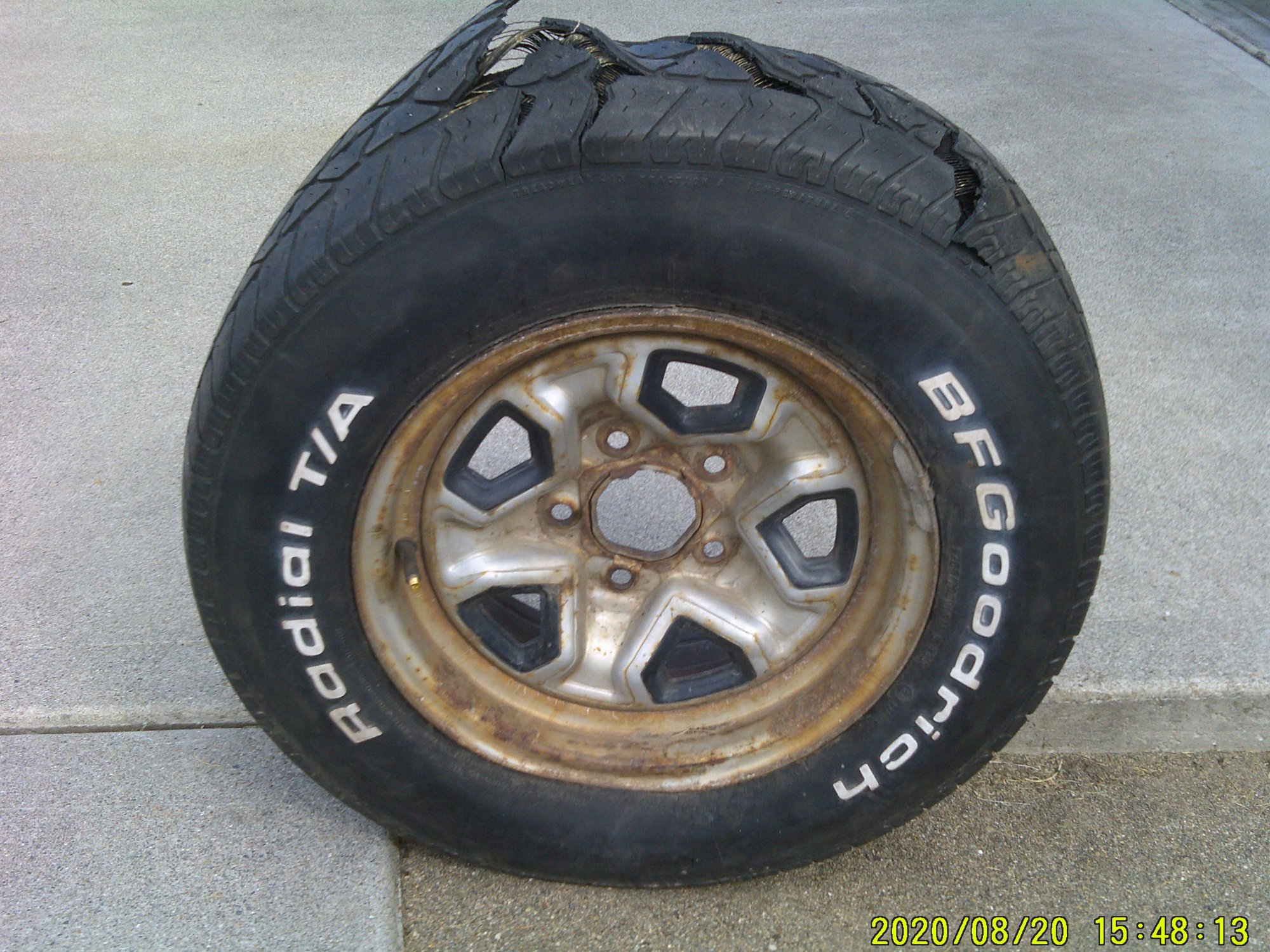

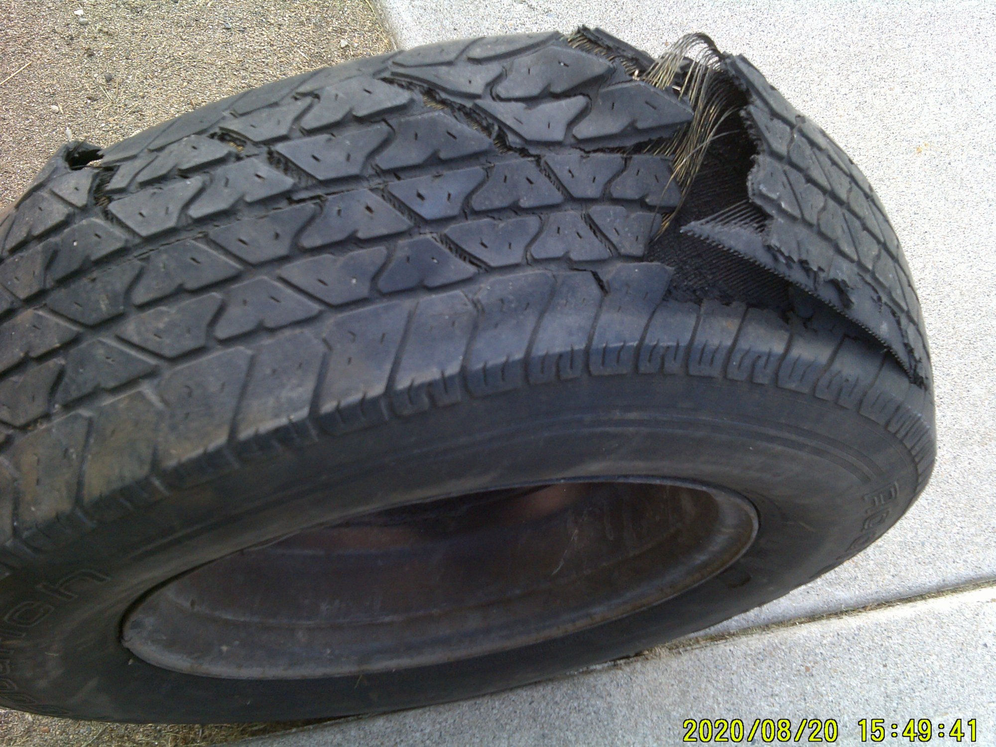

I've heard that running on old tires can be hazardous to both you and your ride. It makes sense to me and while I am using my 30+ year old Goodrich T/As for rolling my '71 project around the garage, I do plan to get new tires before she hits the road. I sold my little '88 p/u 3 years ago to get a newer & larger one and a few weeks ago I came across a wheel & tire from that truck that had been in my shed for years. It looked OK and I left it outside the shed in preparation for posting it on Craig's List as a give-away. Well, earlier this week I finally went to take some pictures of it and this is what I found:
If this can happen just sitting outside, it certainly can happen while being driven!
Tread and steel belts letting loose like this at speed sure could do some damage to fiberglass bodies!
UGLY! Sure glad it wasn't on my vette!
Definitely reinforces my decision to get NEW tires once the vette is ready for the road again after restoration.
Paul

Yeah, I remember the Firestone problems back in the late 70s/early 80s. That;s when & why I switched to BFG for my vette when it was my daily driver. Not sure what I'll go with for the same car once it's "reborn."
The old tires I use to roll the car around the garage are BFGs produced in Nov '85 from what I can determine.
The tire that burst was a BFG that I believe was manufactured in Oct '92.

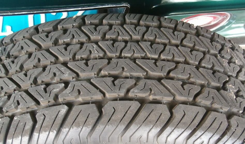

Went out to the garage one morning in 2008 and the Corvette was leaning at the left front. Tires were about 10 years old with less than 100 miles.
Here's why:
(BTW, I removed all 4 wheels, destroyed the other 3 tires so they wouldn't be sold, and bought 4 new tires.)

Yeah, I just hated the thought of those other 3 brand new looking tires being sold at one of those used tires places. Imagine one of them failing on the highway while coming towards you or your family at 70 mph. Tire dates are extremely important to monitor.
