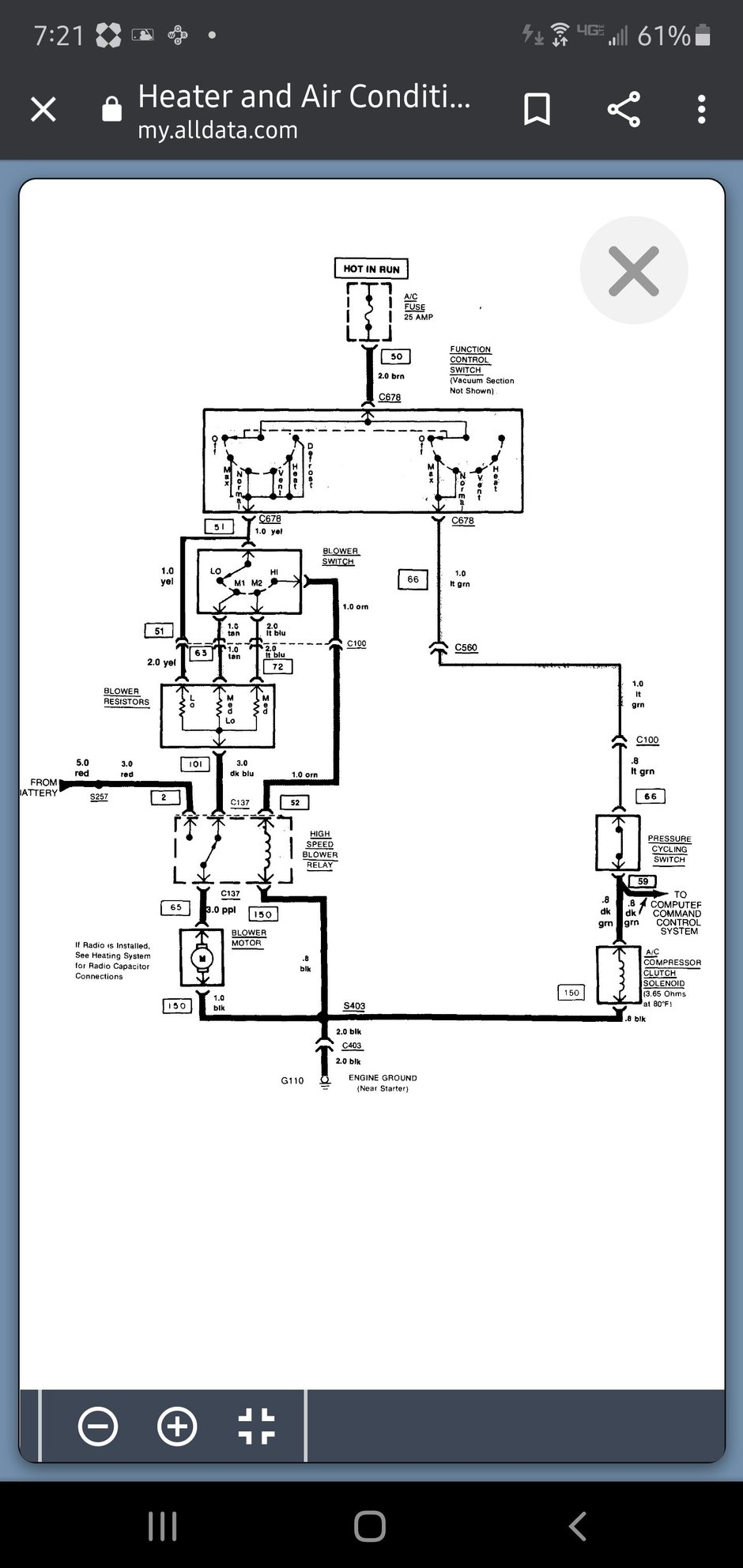

Old Oct 9, 2020 | 07:23 PM
68blvert's Avatar
68blvert
Joined: Jan 2016
Posts: 290
Likes: 78
from a 1982 but should be same if not similar
