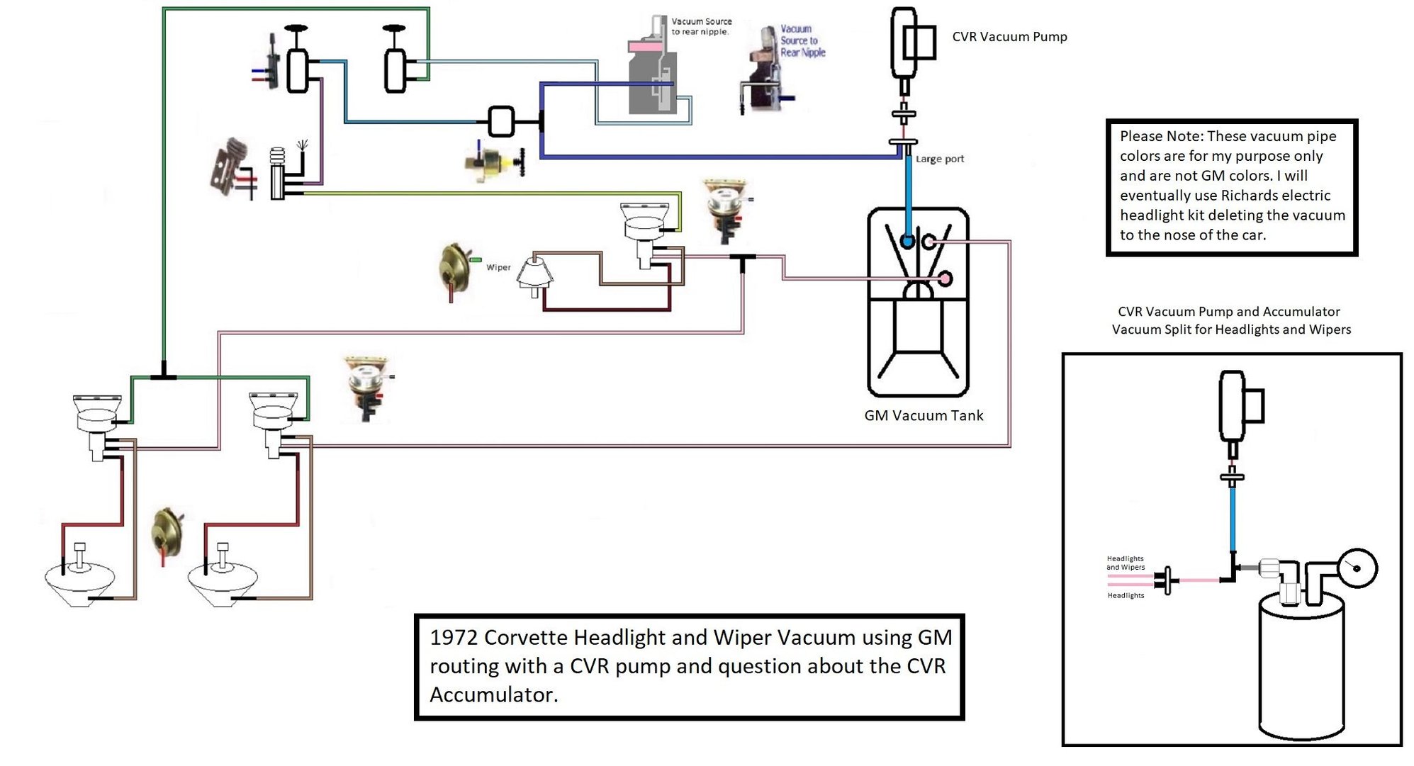

I can offer a little diagram I'm working on for my vacuum setup. I'm using a CVR vacuum pump but the pipe routing would be very similar excluding the vacuum source - you will pull vacuum from your carb or intake manifold. Actually, this would be a very good time to include my question about the CVR accumulator and how it should be piped. Please pardon me if it seems I'm bombing your thread - those are not my intentions. Here is the pic:

That' a great thread!
