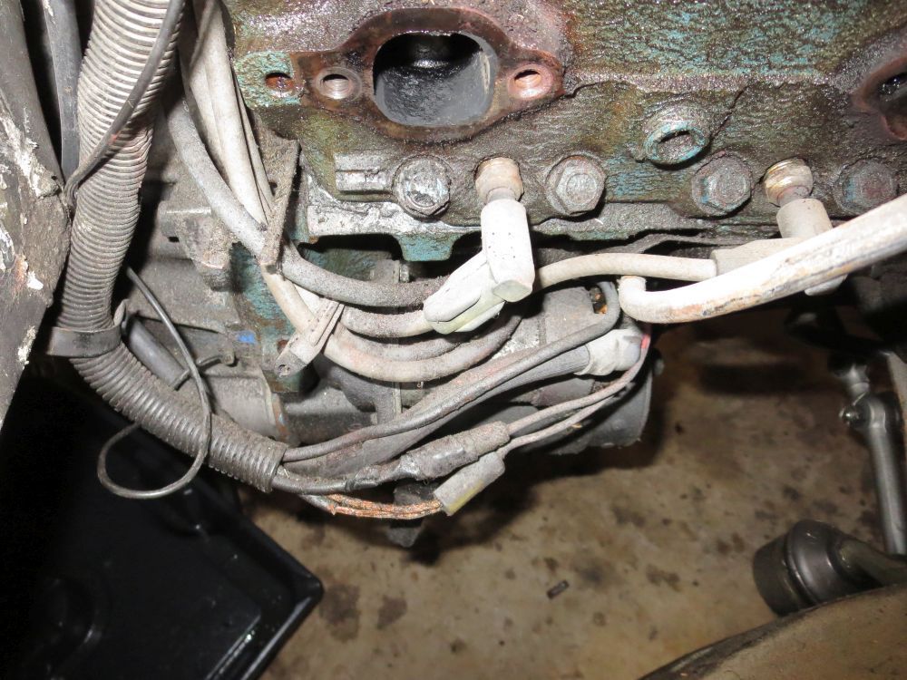

If the solenoid has a bad ground, or power connection, won't it partially engage, and make a horrible sound?
I absolutely agree, turn the engine over by hand and see how that goes.
My 80 had a random no-start gremlin. Here's the likely culprit, the starter extension harness had burned the insulation off of the fusable links, but hadn't visually failed, yet. I bought the L82 replacement, which comes with wiring for a block temperature switch, but costs the same as the L48 version.
https://www.zip-corvette.com/80-l82-...n-harness.html
