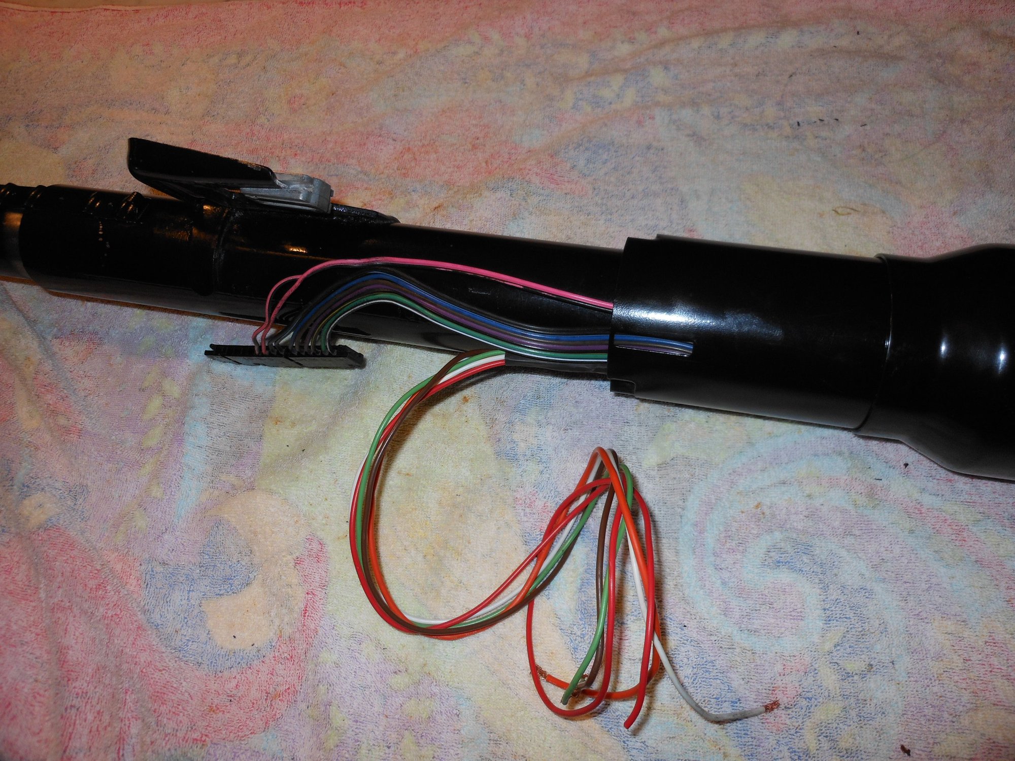

Aftermarket does have collapsible columns- Flaming River
About $500
https://www.flamingriver.com/fr20004...le-mill-finish

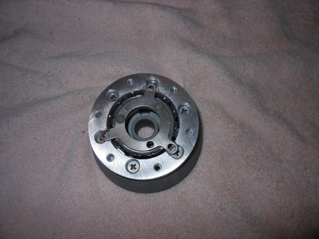

Originally Posted by Old Man in a C
Tell me more. A tilt hub that doesn't require replacing the column? For $150? I'm all ears.

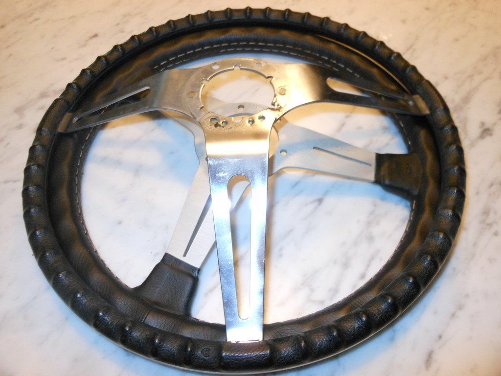

I got the tilt piece on ebay for about $40. The steering wheel was a slightly used Nardi ( Porsche classic) for about $100
https://www.ebay.com/itm/Steering-Wh...gAAOSwpcFfyI20
It's function is to tilt to just get in and out of the car.
I took a little milling to fit as the nut holding the shaft was a bit too big. Not more than a 1/8 "- it's aluminum so it was pretty easy.
For the price - I was surprised at the quality.
It's set up to handle two contact horn- so one wire is not used.
The bolt pattern matches without a problem- but to using the stock wheel won't work with some modding - as it's not set up for the notch.
I'd use one of many aftermarket wheels that don't have a dish- effectively moving the steering wheel in couplel inches.
You can modify if you want to use the stock horn-
