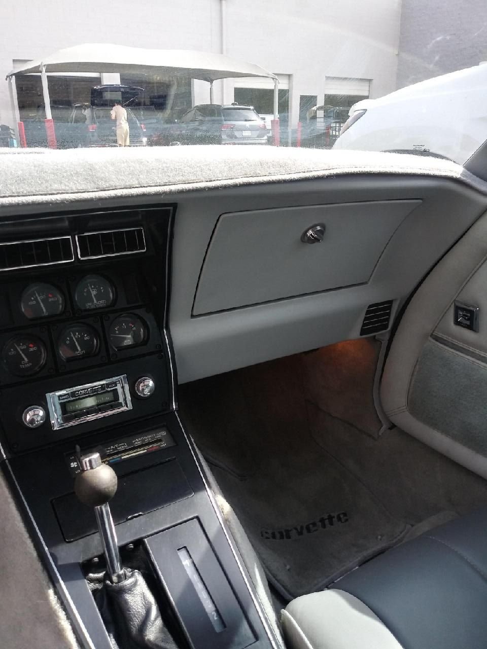

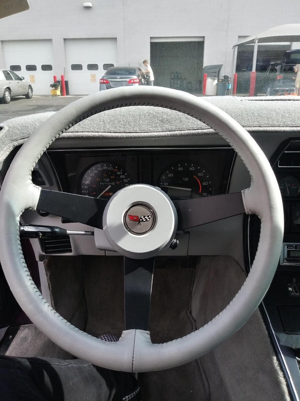

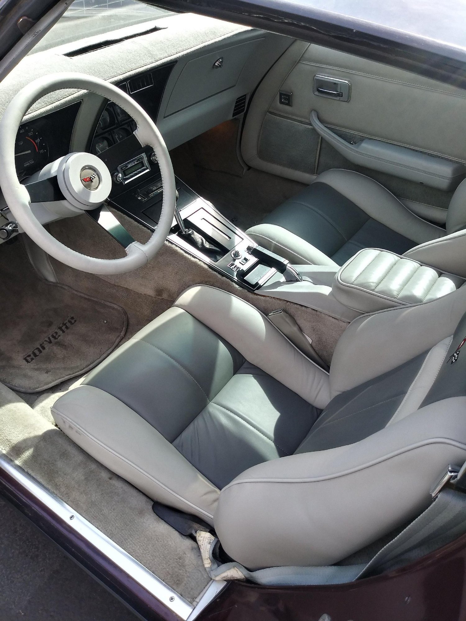

Well, apparently, the 1982 corvette did not sell. No pictures of engine but the interior looks immaculate. I'm assuming the seats are not original

Always be wary of photos with the dash cover ON.....Bwah ha ha...who knows what evil lurks beneath dashcovers!

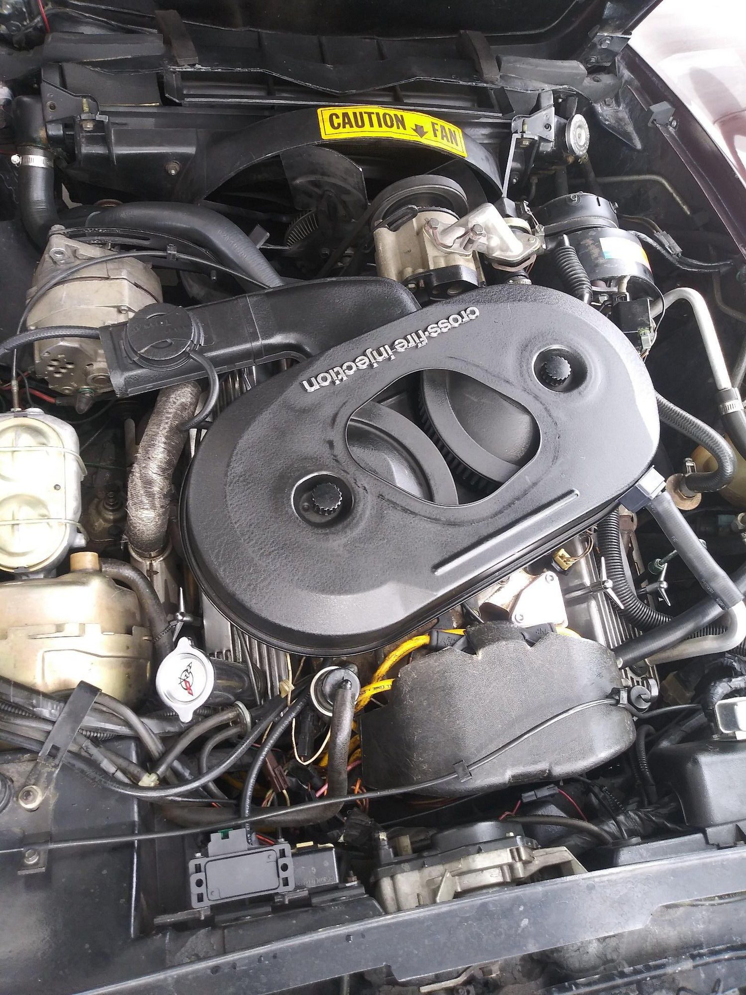

Engine pix from the dealer....car definitely looks dark claret

EGR valve has been removed. Not sure why. The EGR system is not an issue. It kinda sits there and quietly does it’s own thing.
The oil filler cap has a C5 emblem?
It looks like the valve covers may not be original. If not, they may been painted.
I see gunk on the intake between the distributor shield and air breather. Definitely want to lift that air breather and take a look.
AC looks like it was probably converted given the red cap. Need to confirm that though. If the conversion to 134 was done properly that is a plus.
Based on what I see here, I don’t see anything alarming, but surely needs a better look because someone has been under the hood.

ENGINE COMPARTMENT IS (mostly) ALL PRESENT AND ACCOUNTED FOR. The air cleaner assy has been painted incorrectly...should be FLAT crinkle finish....the only Corvette to have this.
The ram air system is missing...this is mounted on the hood. DEDUCT!

The ram air system....thats a plastic piece that's attached to the underside of the hood? What affect does it have on performance if it isn't there?
