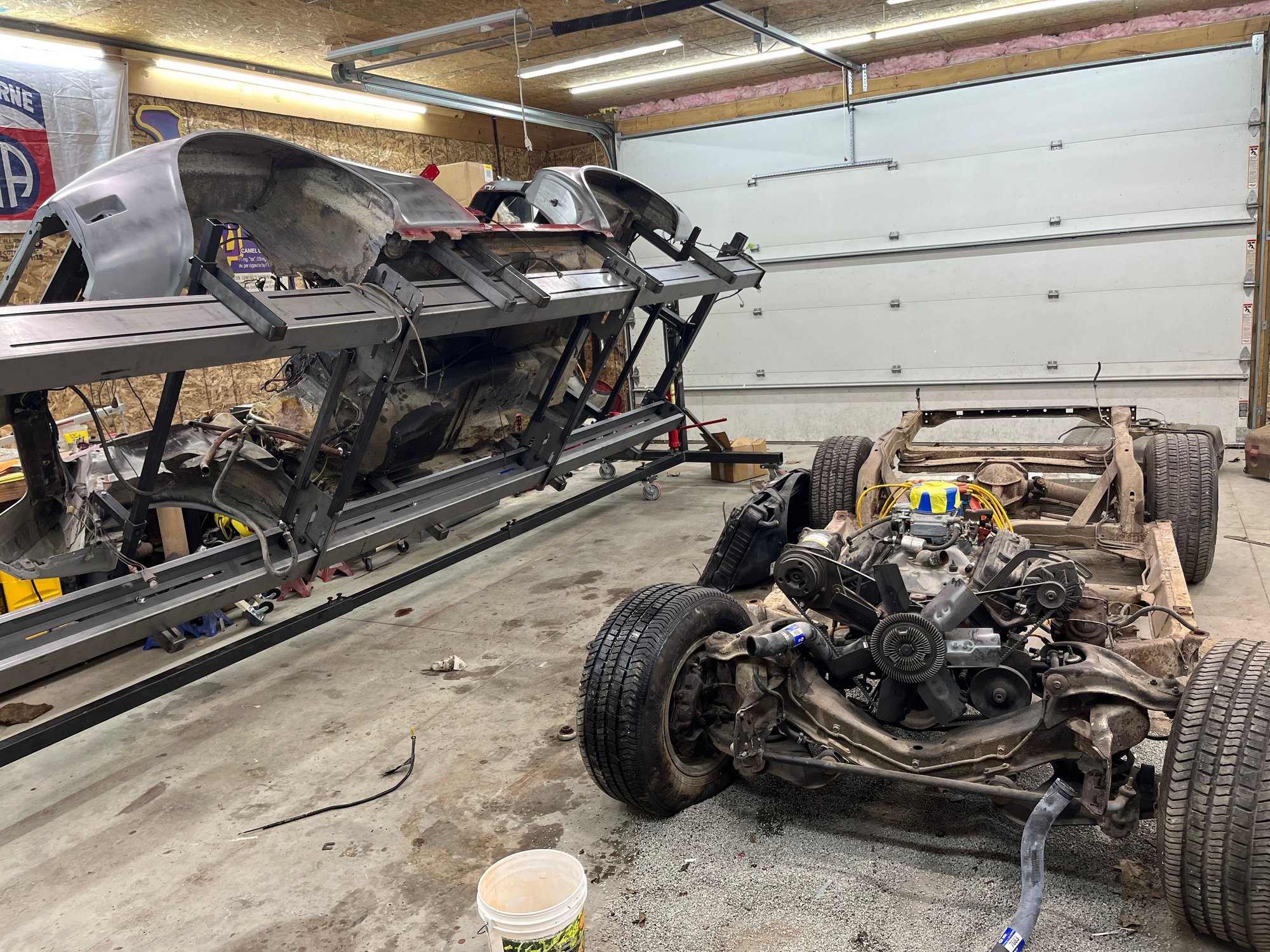

Well this morning brought snow and wind to Northern Michigan. So my next completion will be chassis and under body. I have most of the parts sourced that are needed to get the chassis done and body back on the frame. I’m a long way from that though. Here is my to do list before I can get the body back on the frame
1. Frame repair and paint
2. brake and fuel lines, fuel tank
3. Suspension and brakes
4. Repair both #4 body mounts on body
5. replace all metal reinforcements on body
6. sand blast and paint inner rocker
7. paint underside of body
8.install floor insulation and heat shields
9.set motor, and drive line
I think that is a pretty accurate list. Chime in if anyone has any other suggestions. Customer wants to do a 383 with five speed fuel injected. Gonna run Detroit speed front and rear suspension,
Anyone have any idea what size fuel lines I should run I’m running hard line since it’s easy and way better then a floppy braided line my thoughts are 3/8 fuel line with 5/16 return? I’m open to suggestions.

The crate motor arrived today from Blueprint engines. 383 stroker 438hp. The transmission will be a few more weeks. An American Power TKX 5 speed.
Jumping over to the frame this weekend. New issue arises. I want to put kick up braces from the inside like the 69 and such had only issue I see is not having clearance for the rear compartment on the body? Anyone done this or have any experience? Thanks again

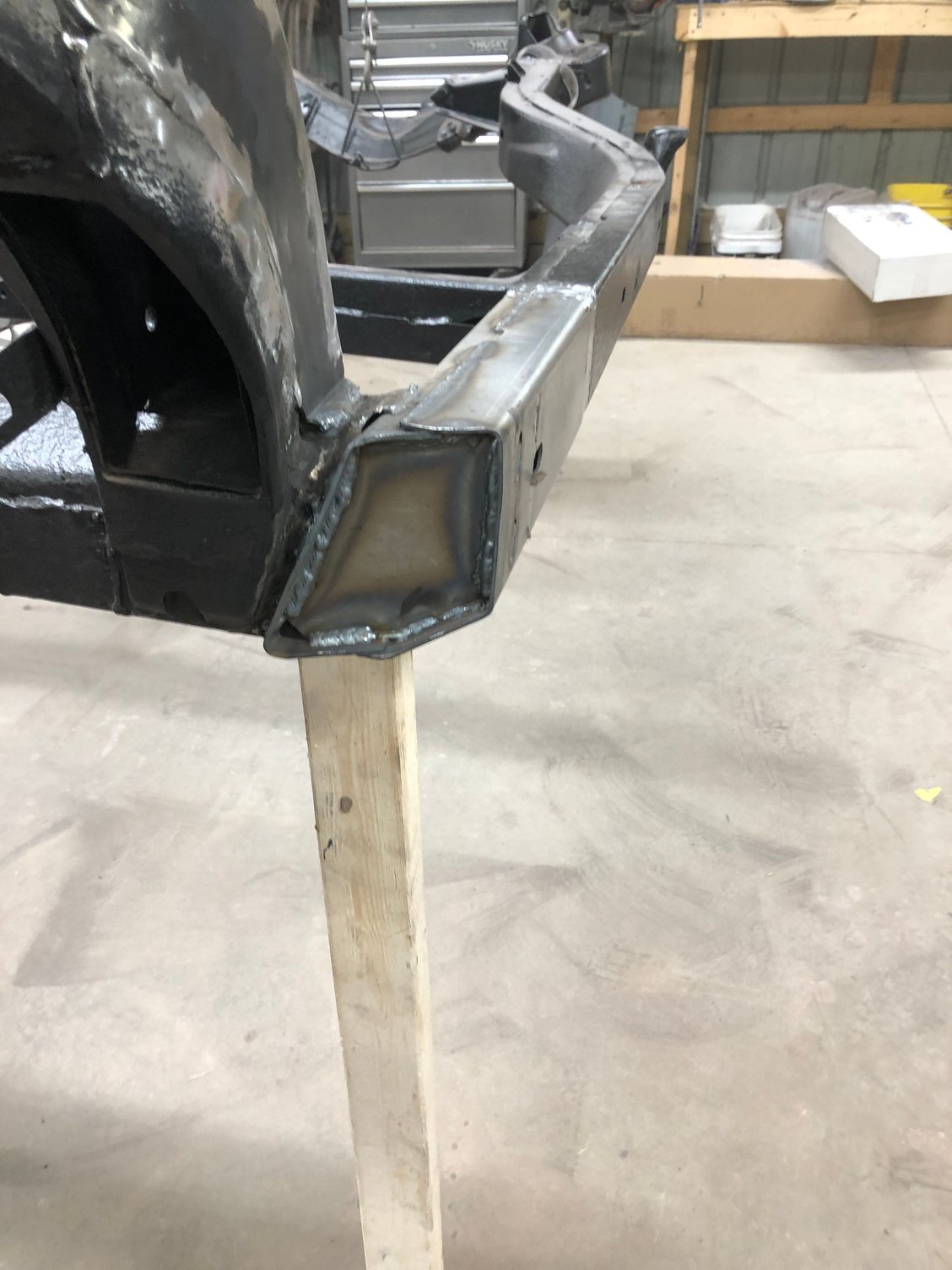

Im making progress, inner rockers are done engine compartment needs another coat of pain and so does one wheel well. ( I ran out of paint) new doors showed up Friday, have some work to do on them. I picked up my first batch of items from the powder coater and dropped off the second batch,. The interior is cleaned up and quick coat of rust oleum has been done.

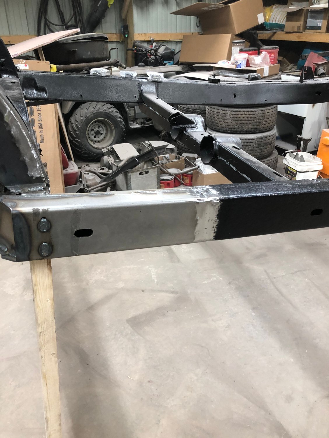

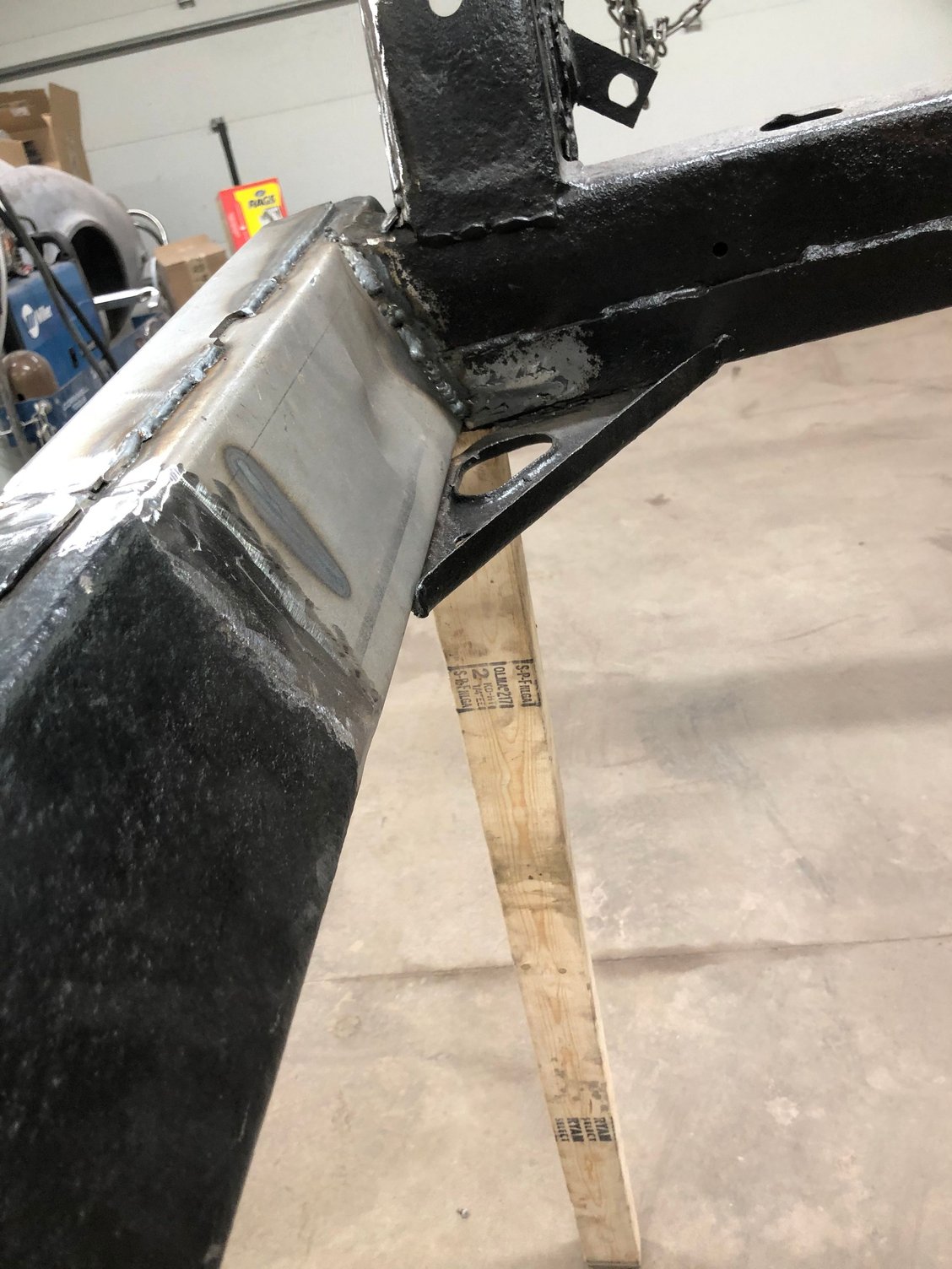

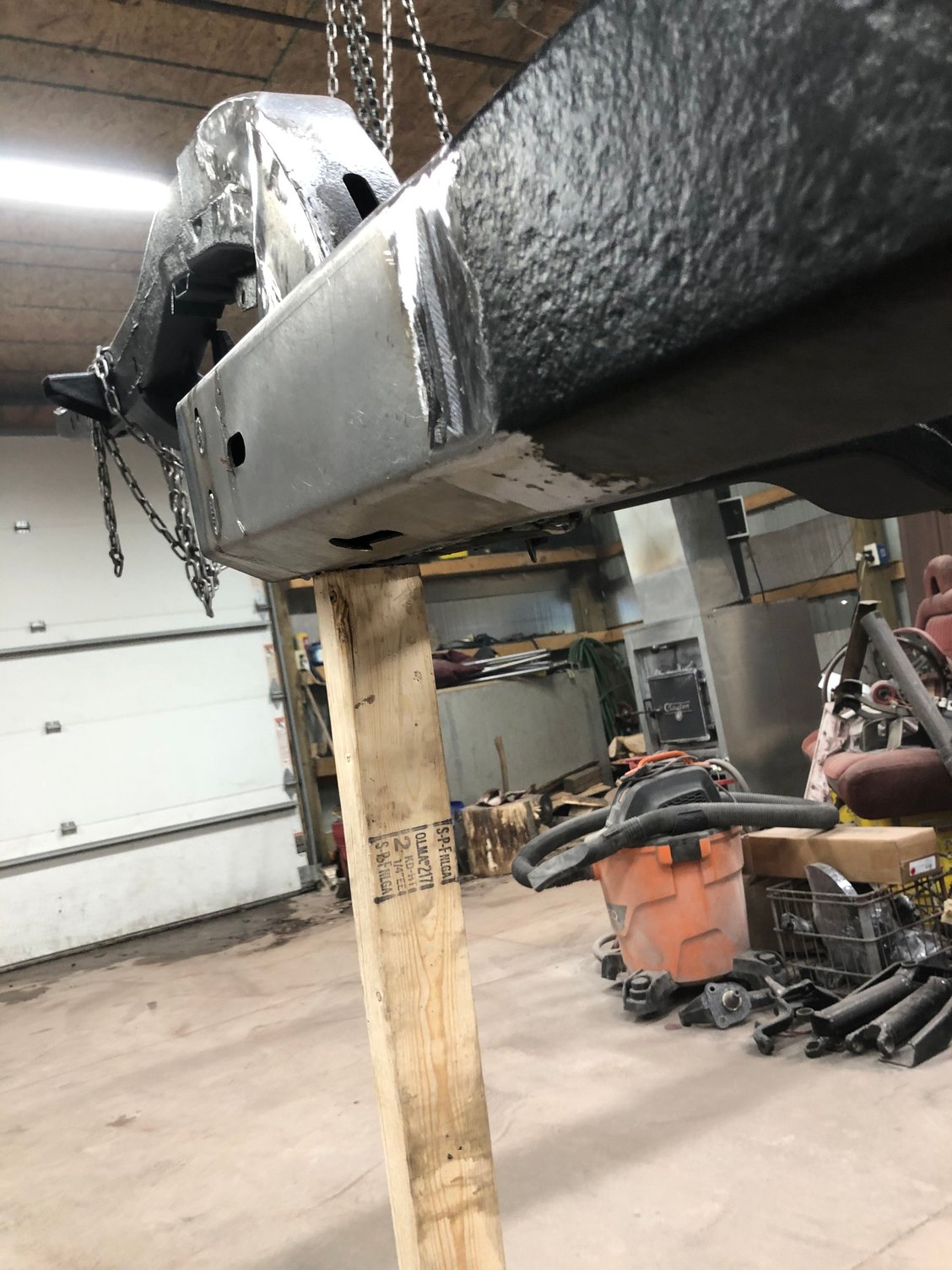

The frame is done!!!! ready for reassembly as soon as my van steel front and rear suspension arrive. New inner frame horns, new frame section right perimeter frame, kick up braces, and a little rot repair and stiffener braces, new body mounts at #2&3. I think that’s it oh yeah and I started cleaning up bolts for reassembly. I am using my sons rock tumbler with medium sand.

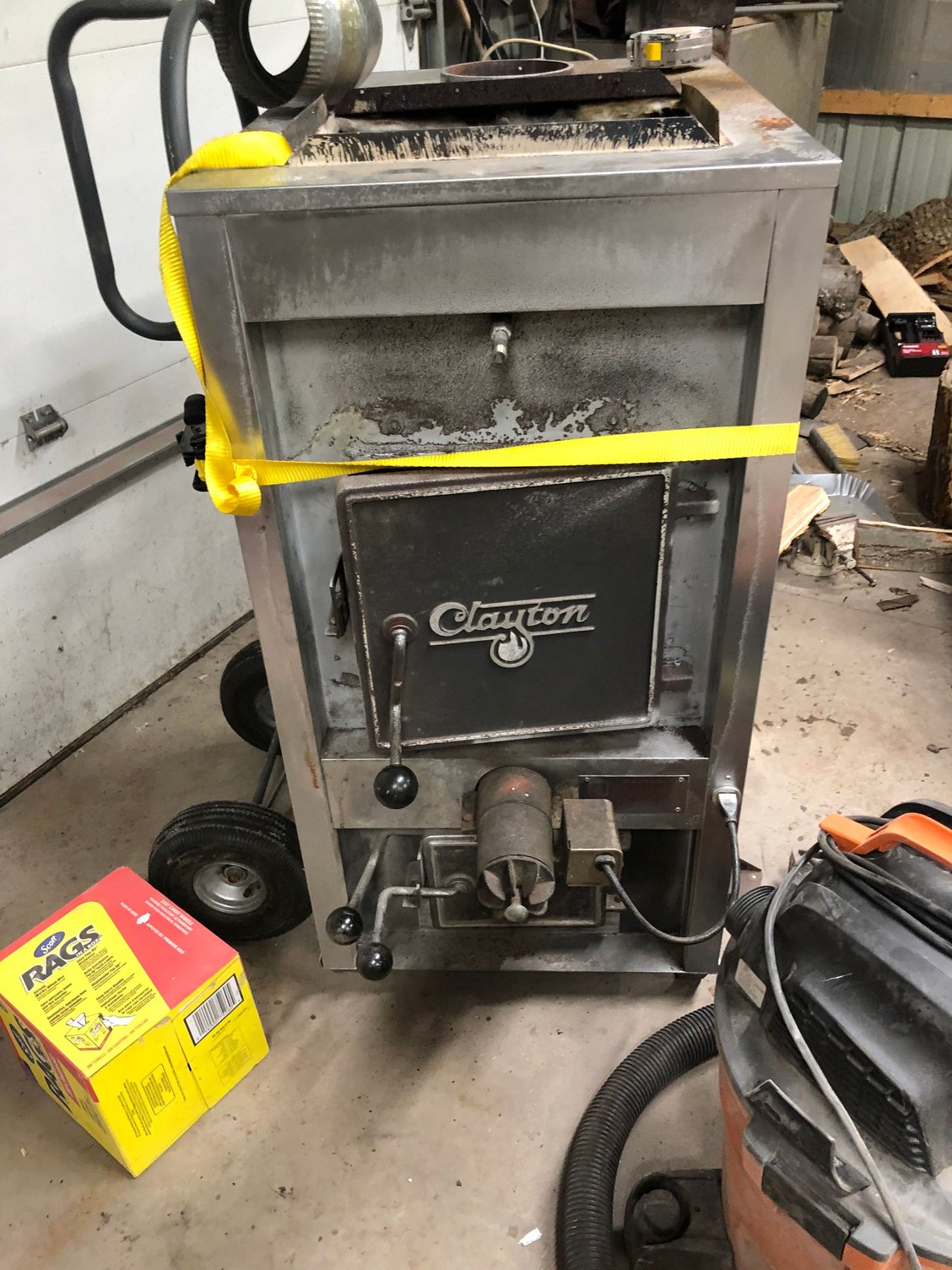

On another note I upgraded my wood stove in the shop. Found a nice used wood furnace from a friend of a friend. Such a wonderful improvement to my old one. Having a comfortable and tidy work area make the job so much easier and enjoyable.

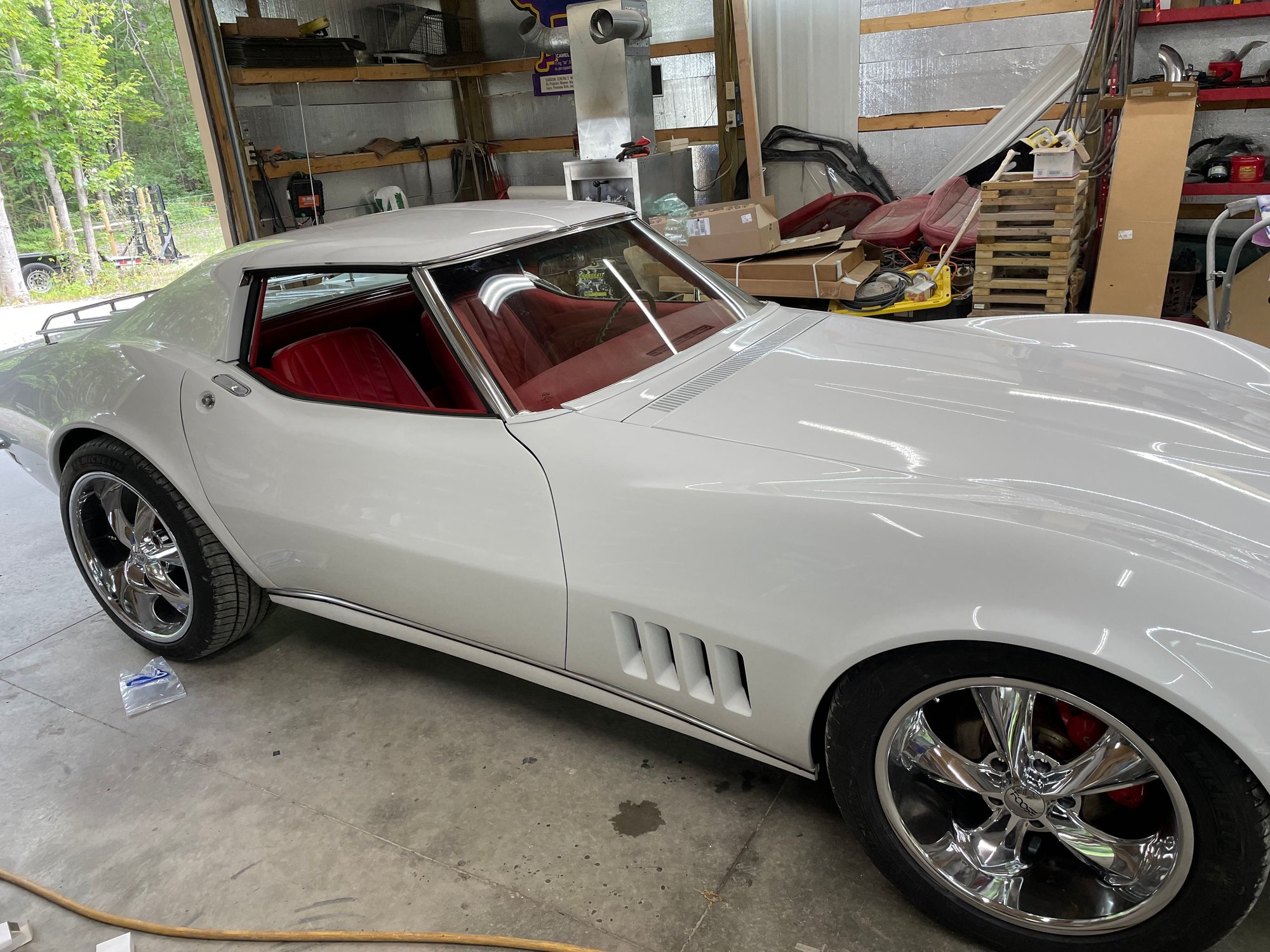

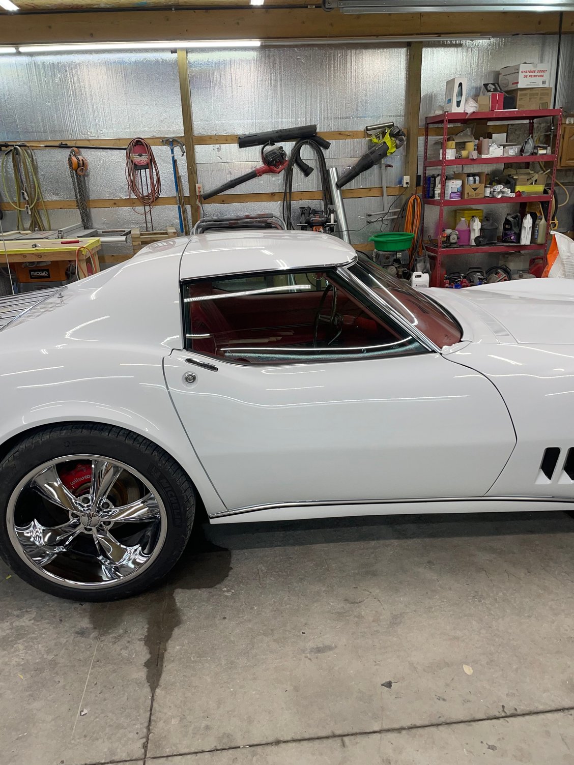

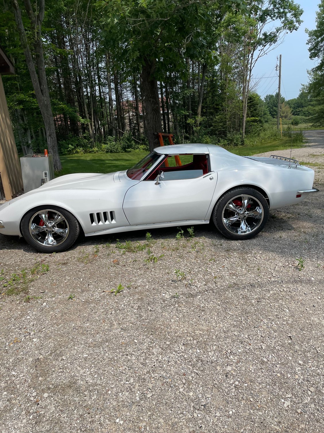

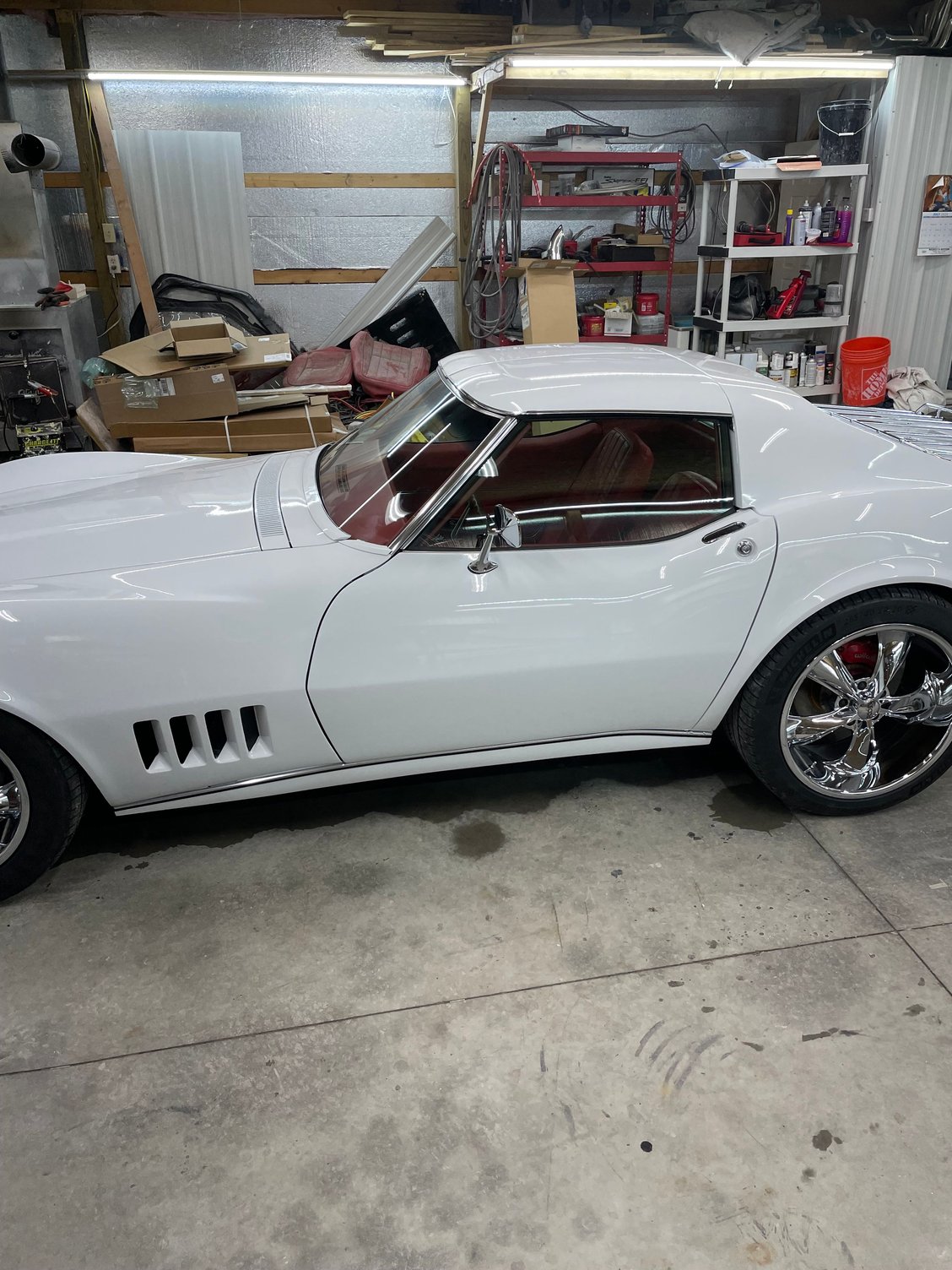

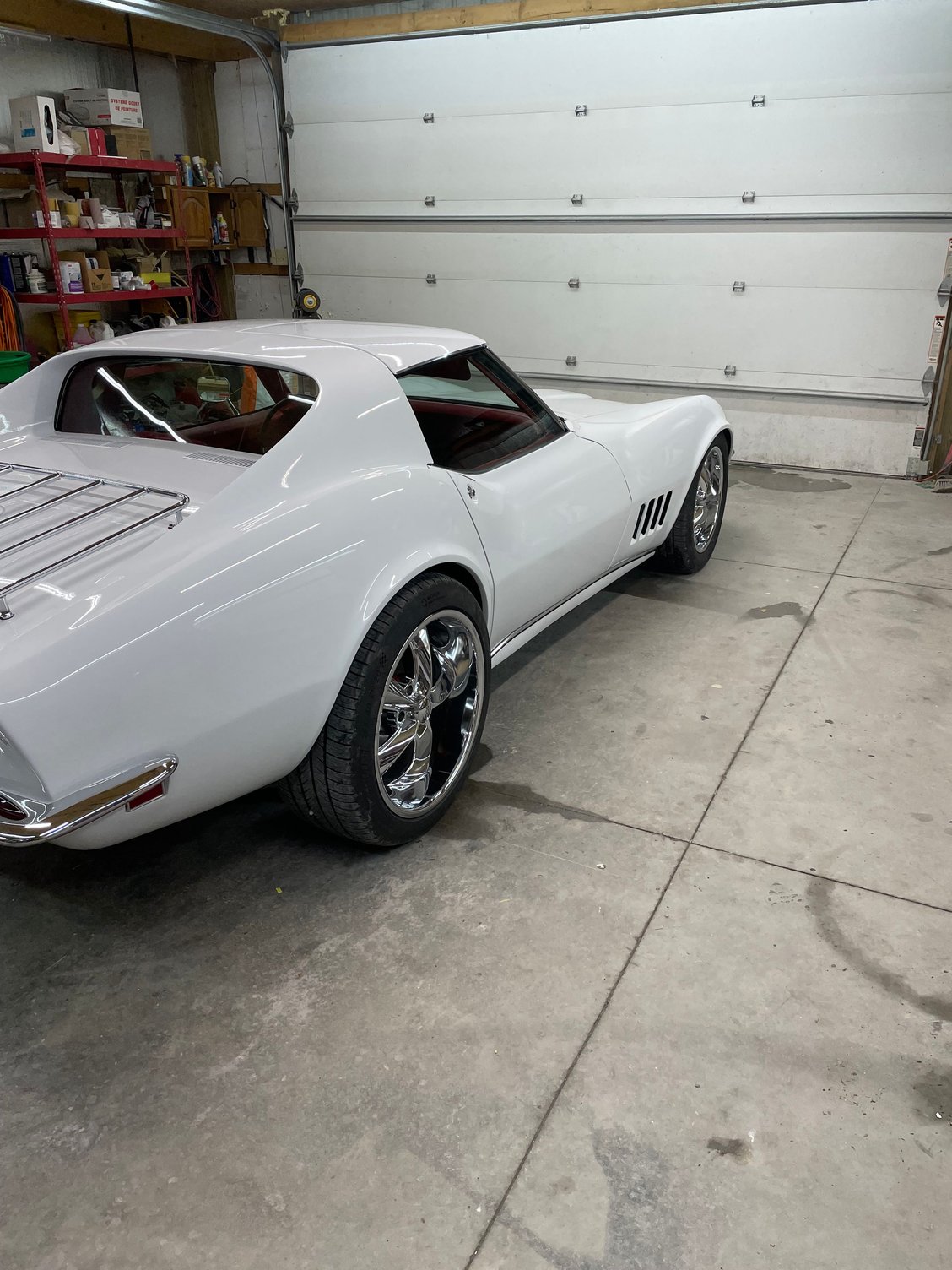

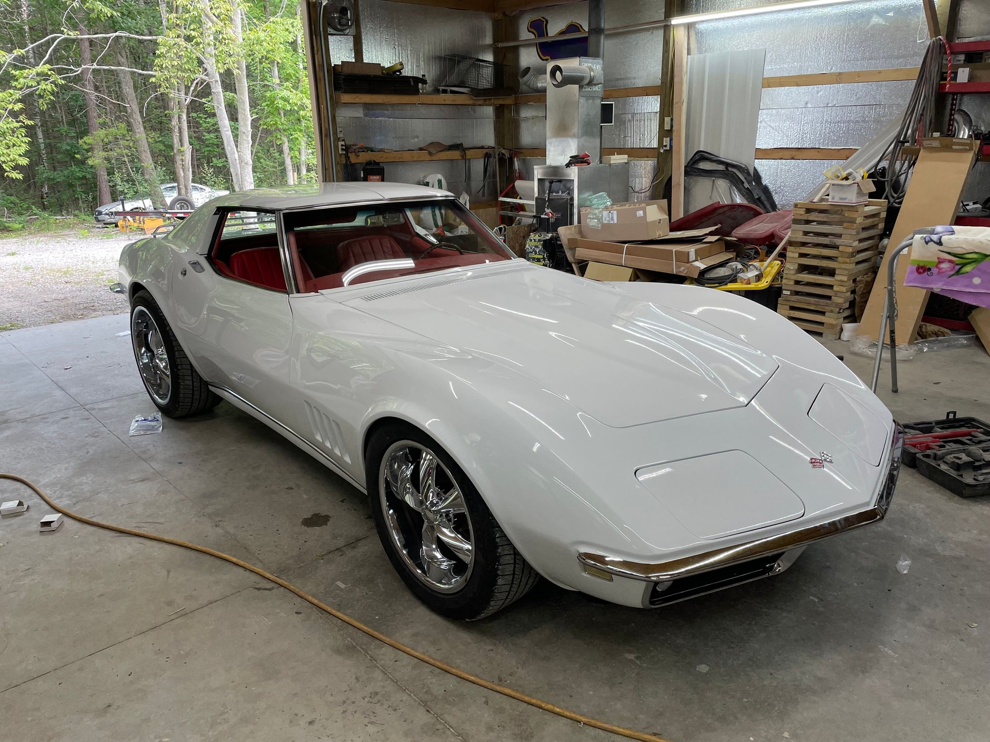

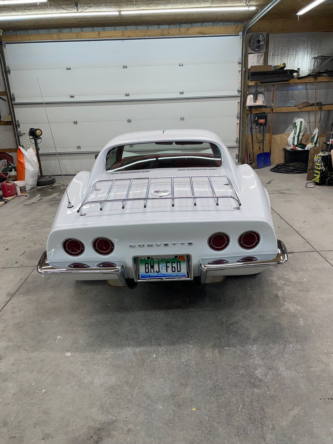

Default Finished July 19, 2023

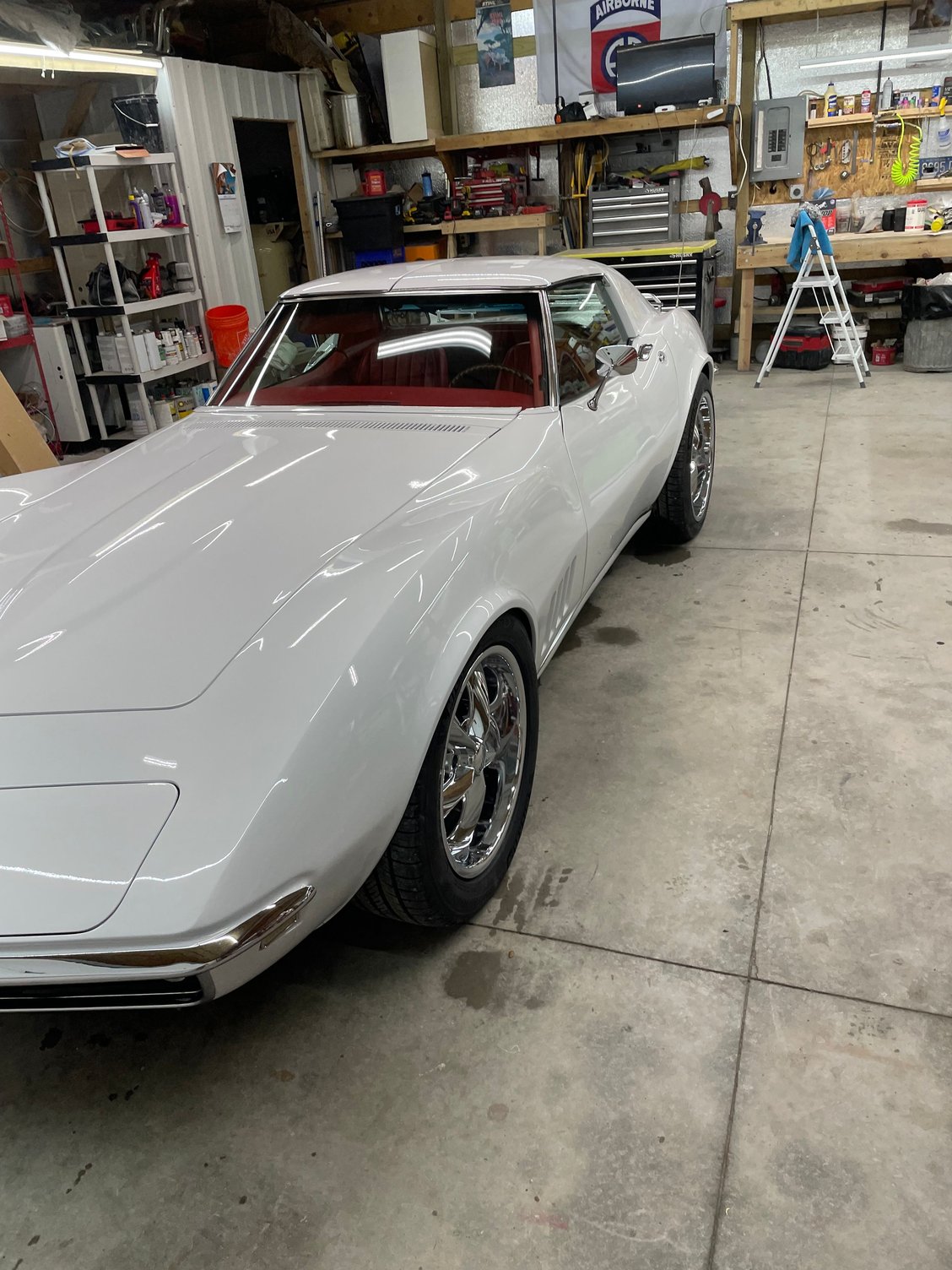

Default On to the next 1976!

Turned out super nice. You did an amazing job. Always a big fan of the red interior!

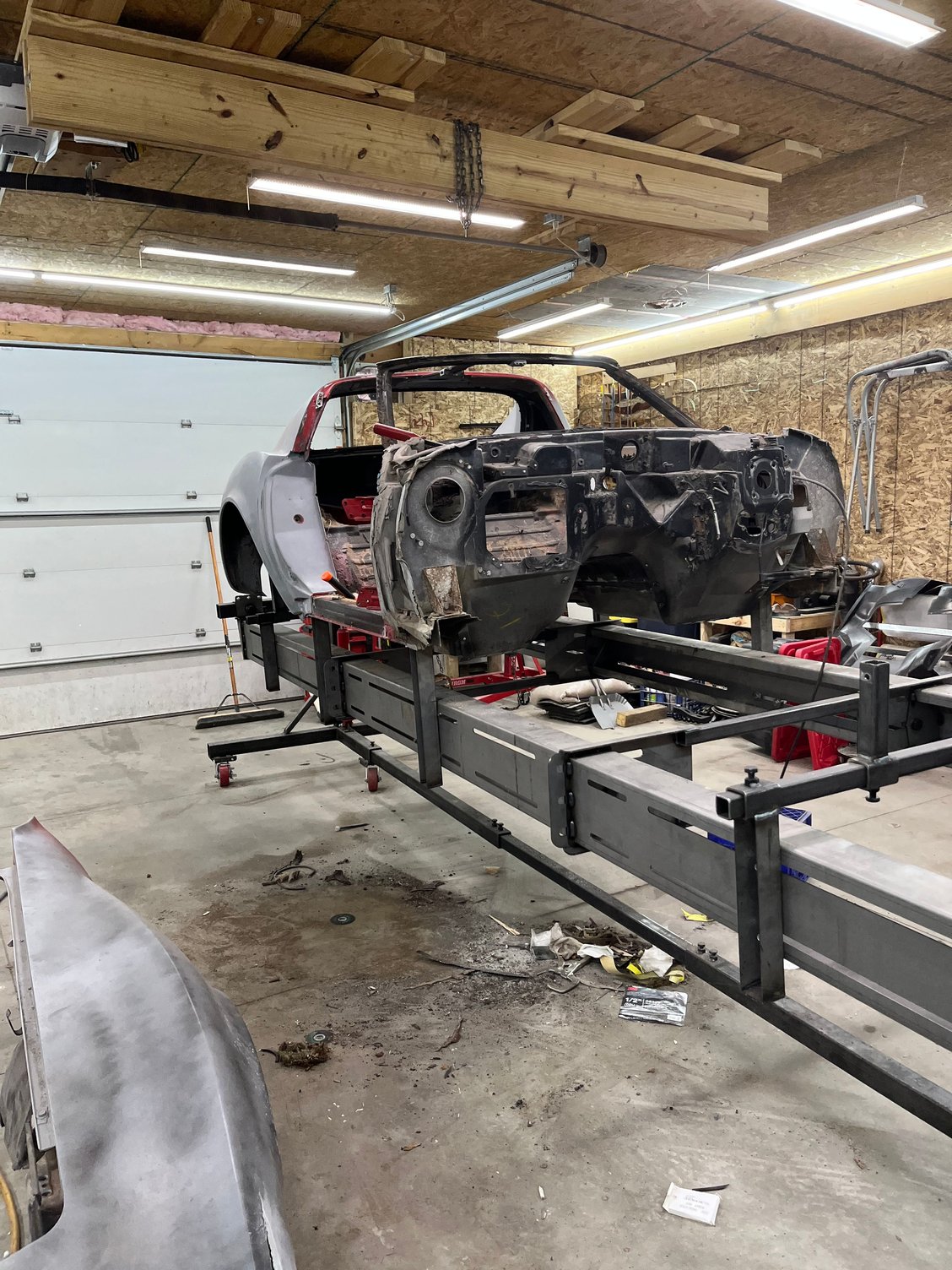

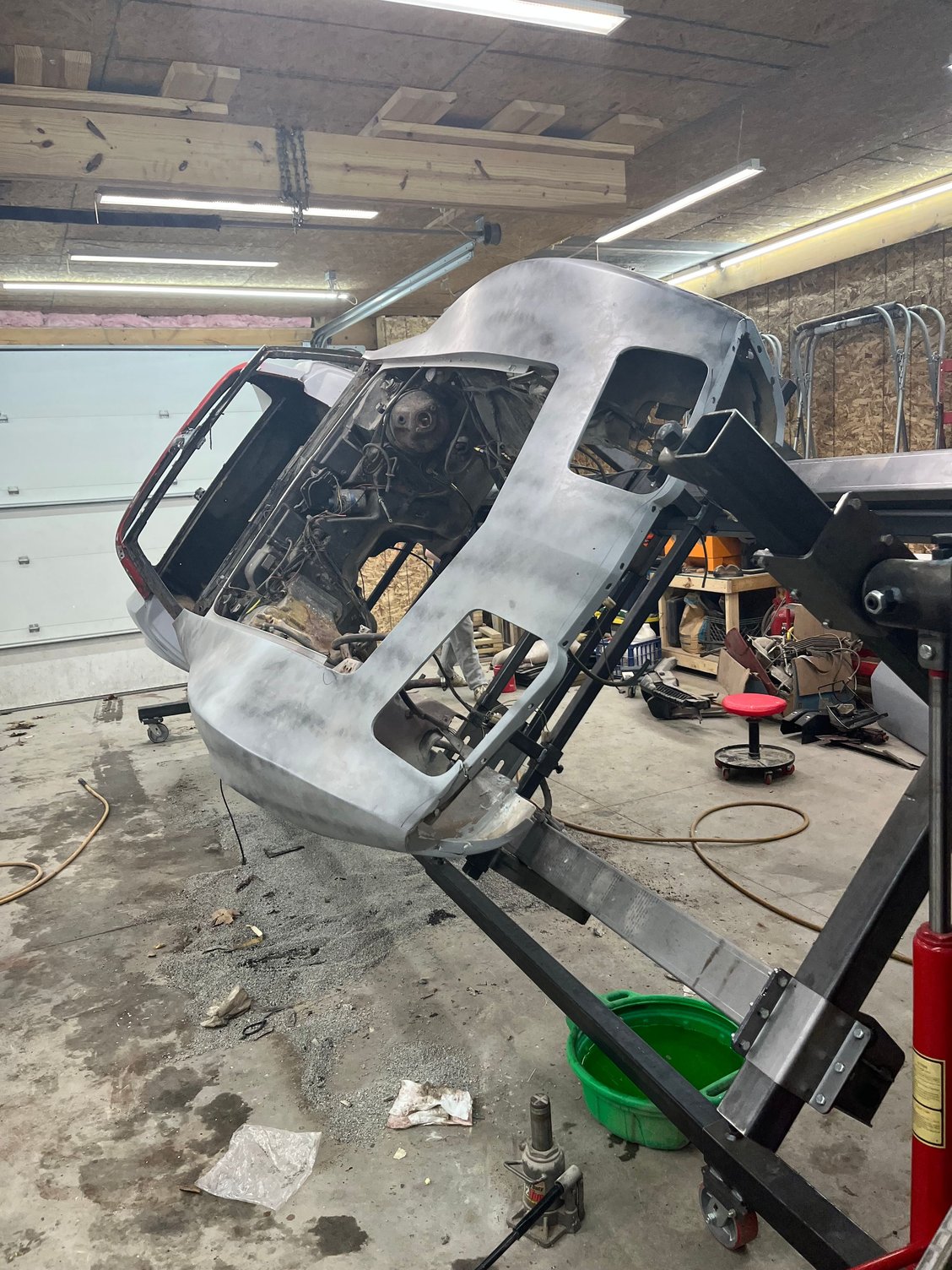

Wow, fast forward 4 years to a really nice ‘68. It looks awesome. There are sooo many cars taken apart by excited owners but they never go back together again. It’s special to see a restoration followed through into a really nice ride.
Your body jig looks unbelievably useful. Did you build it?
