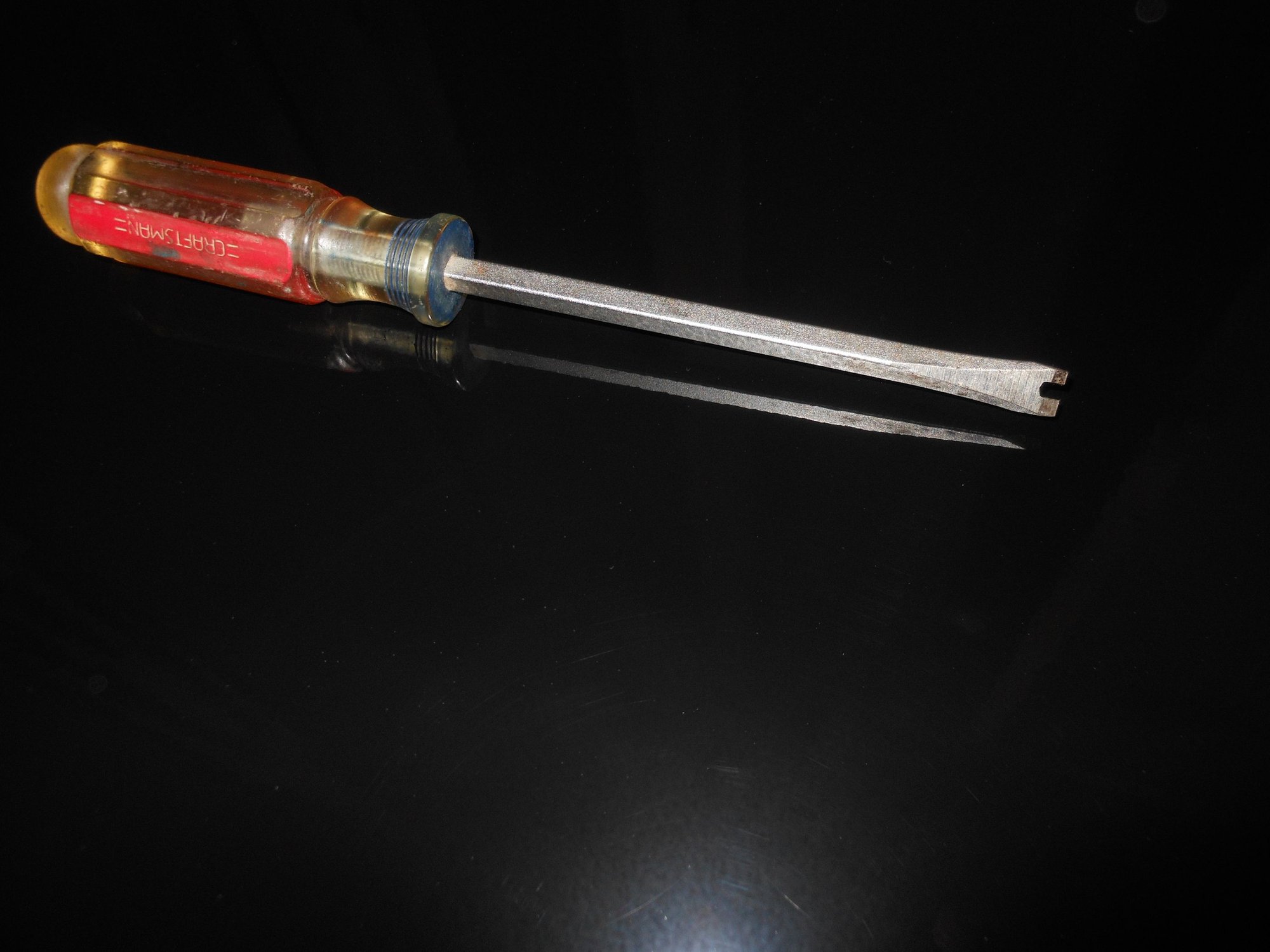

$7? I'm cheaper than that!!! After using my screwdriver for something it wasn't intended to do-
I re-purposed it!!!
