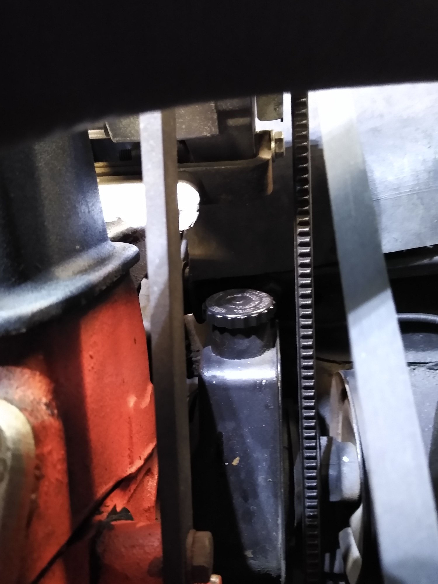

Default Power steering pump dipstick
Is it just me or is it normal for the alternator to block the dipstick for the power steering pump? There is a bolt missing from the PS bracket that allows it to move around. However, even when it is pushed into position the cap is still blocked. Wondering if the belt is too short or some other issue. (Edit: 1975 l48)

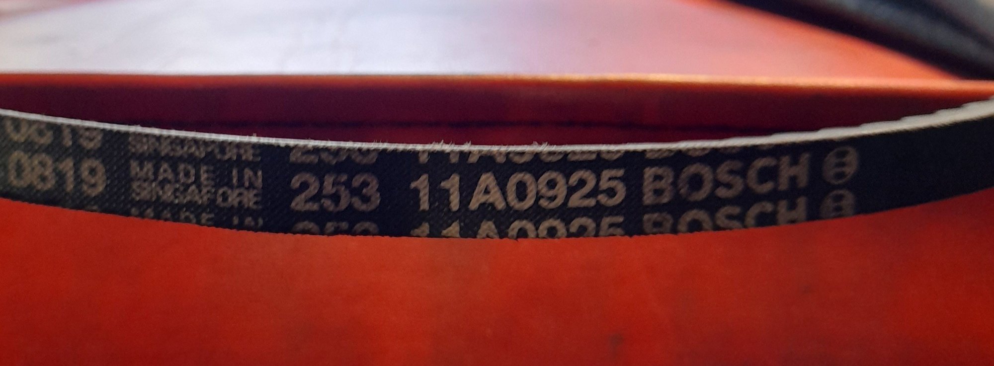

on my 77 I am running this belt which puts it in a good position to get the cap off and not hit the frame.

It's simple, with the correct belt it swings out from underneath that Alternator bracket, but not quite so far as to hit the frame. I have no trouble removing my cap. I posted the belt that works for this above.

My 73 SB, Manual, AC, PB, is mostly all OEM. I just looked to make sure and the PS Pump bracket has a cast metal bracket has a large chunk/hole take out, so the top dip stick can be removed. Guessing your car had a new pump installed with a different bracket to accommodate new belt/pulley. I will attach a few photos so you can see.
The chunk or hole in the bracket allows for the dip stick to be removed.

I've had my car since dirt was new. all original I assure you. you just need to get the pump out from underneath the Alternator bracket. no notching needed. just the correct belt.
Really guys, it's that simple. listen.

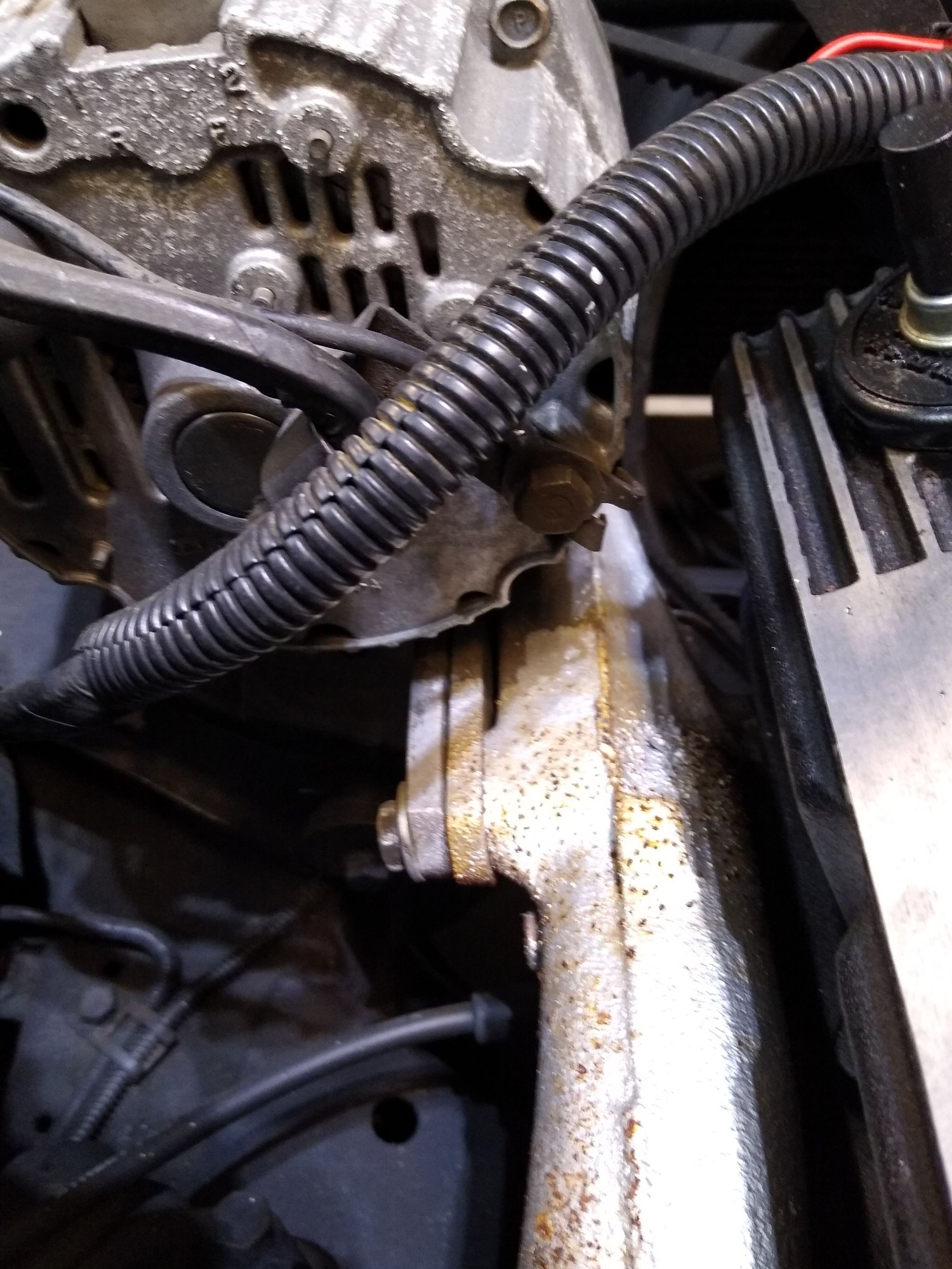

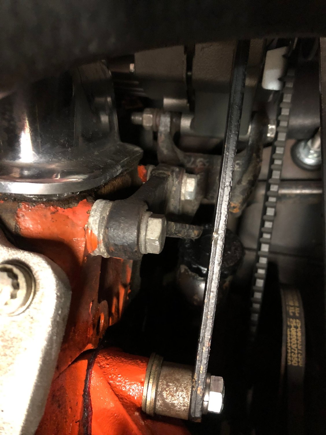

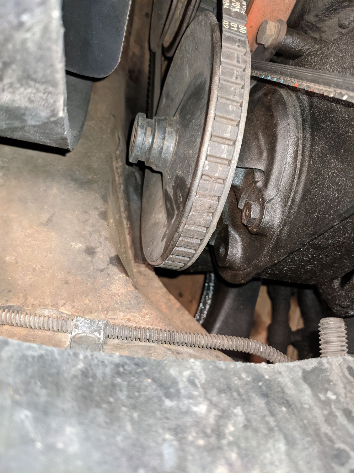

Here are a couple pics from the other side. The bracket is surely stock/original. There seems to be plenty of room for a longer belt but the pic isn't the greatest.
