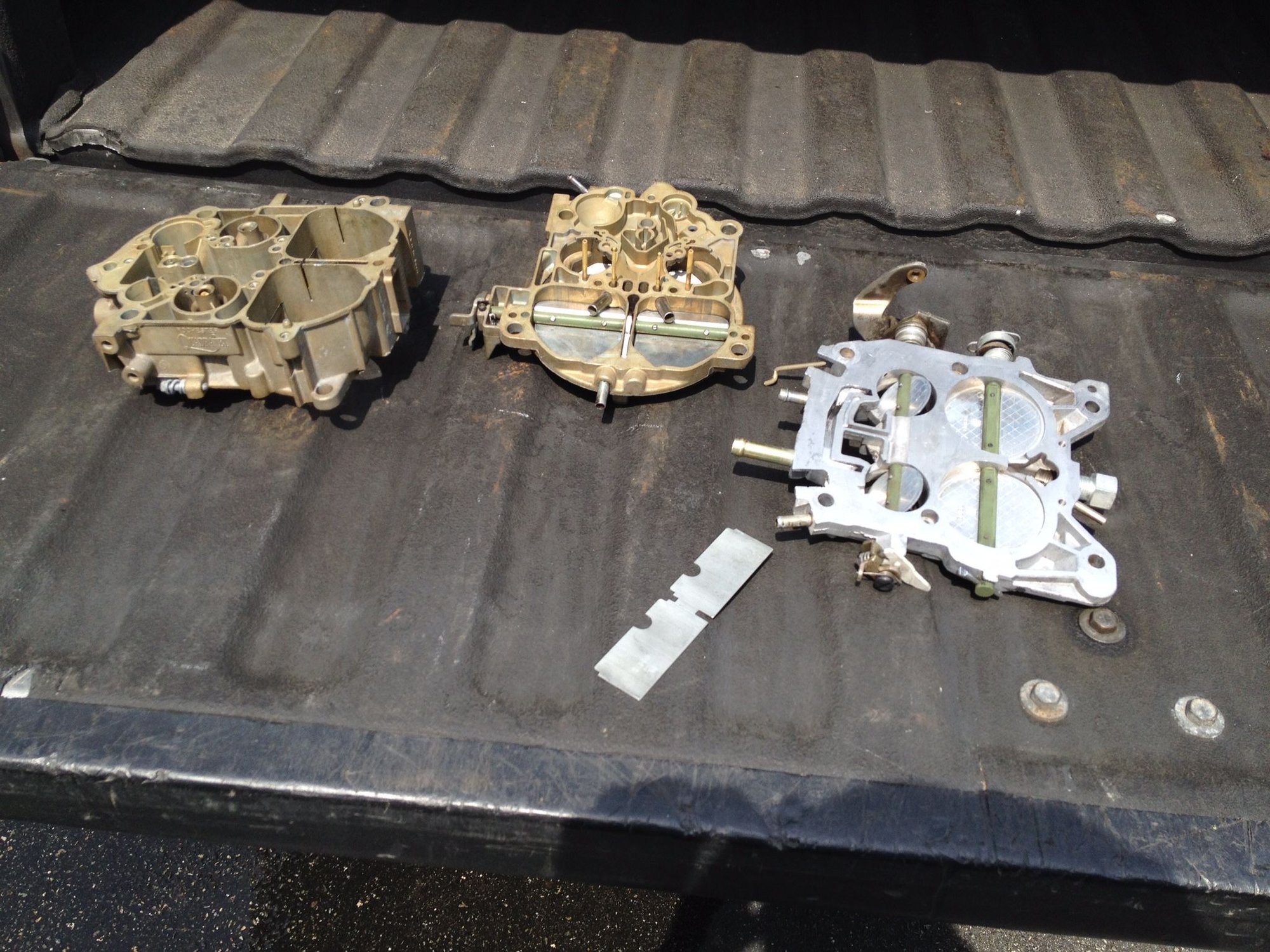

I used Berryman carb cleaner. Disassemble completely and let soak a couple hours. Works great. Use solvent gloves and eye protection.
Pretty much available at most auto parts store.
Cleaned and drying in the sun.

Yes.....Berryman will not remove the finish as long as you do not leave it in there forever.
