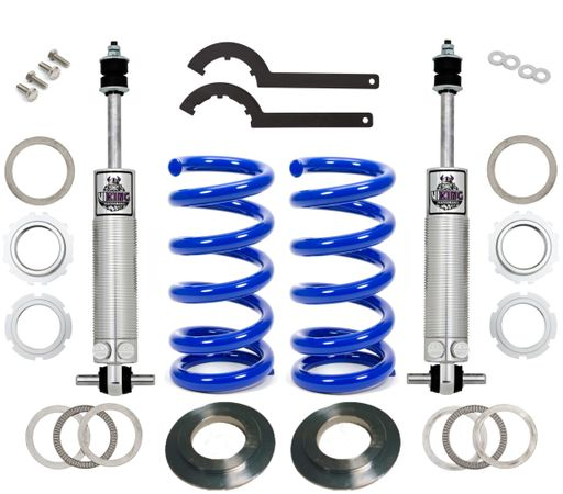

Our semi-coil kit is a direct bolt-in requiring no modifications and has adjustability to lower the front up to 2". $1016.80 and we offer a forum discount of 10% for members.
Front coil-over kit

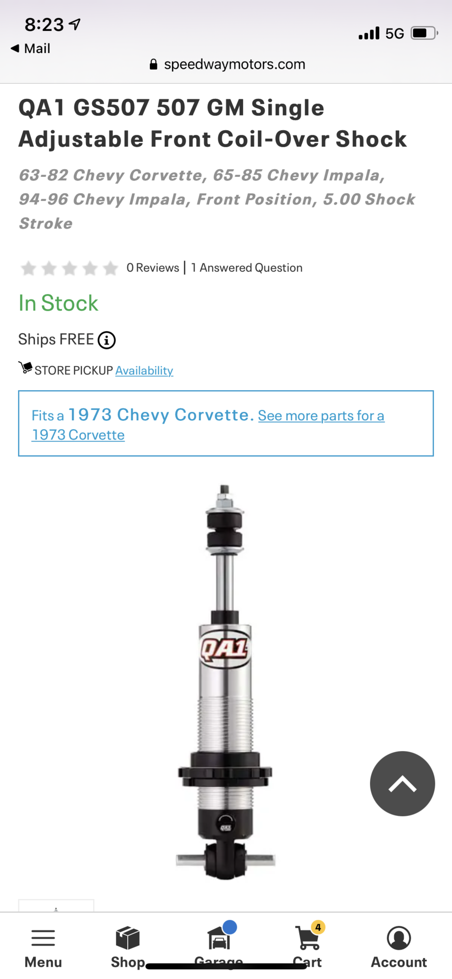

These are the coil overs for the front. They bolt right in with the factory lower a-arms. For the rear I just bought the single adjustable QA1 shocks to complement the Vansteel composite spring I've been waiting on since January.

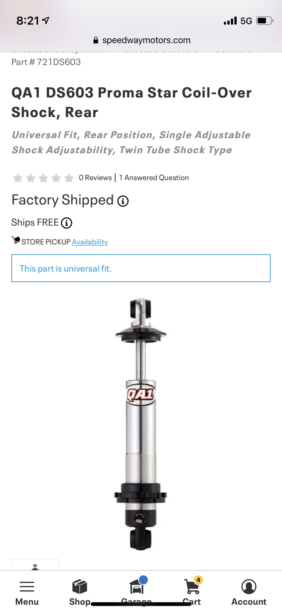

Thanks for all the reply’s, im looking at the front and rear coil overs I put the pictures of the front and rear I’m talking about and it looks like they don’t have springs does that means they don’t need springs would I need to buy springs for the front seprate and the rear doesn’t need them this may sound really stupid but I’m just a little confused

Those will need springs for sure.

back and the front or?they don’t even give any recommendation for weight and size and everything??
