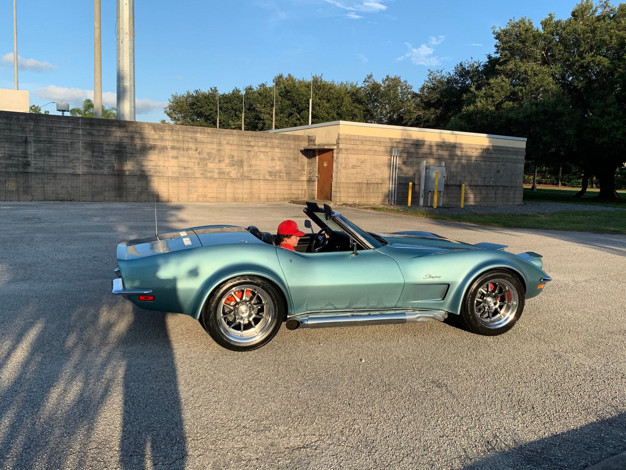

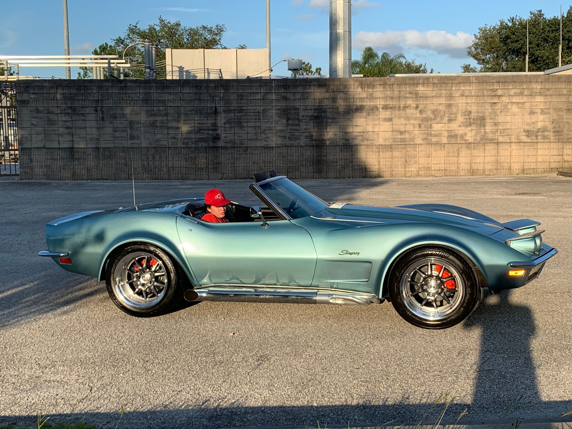

I’m looking for slightly lower in the front. I’m happy with the rear height. Just not sure if o should cut coils to finish the front. Can I get some opinions from those that have or want the look I’m looking for?

Measure the front wheel well arch from the driveway. The rear wheel well arch should be the same or slighty higher from the driveway. your stance looks pretty good.

I would cut 1/2 a coil and see how it sits. A full coil will lower the front approximately 2" for a stock spring.

I think the front does need dropped, never looks right when higher in the front unless your stomping on it.
Agree with the 1/2 coil cut should do it if your after the level look.
i always did like the rear to be a tad higher than the front but I'm old school.

That is a nice C3!! I agree with others that it's not quite level - choices are: do nothing - it's really nice; crank the rear up just a bit (any tire rub with it riding as low as it is now?); lower the front an inch. No matter what you choose, you have a great looking car.

you are thinking what I’m thinking. Hyperco coils. Cut half coil. Thanks for your input.

thanks. It’s becoming more clear to me I should cut. And I do want a slight tilt to the front.

I appreciate the compliment. I actually have been raising the rear some to get rid of rubbing. I still need to do a little more raising and from there I’ll decide on any coil cutting.
I’m after perfect ride height. I could tell lately I was kind of talking myself out of doing anything to it because it looked good, but not perfect. You all have helped bring my expectations back up for something that’s really important to me.

Compared to the rear, the front looks a little too high. But, if anything, I think the rear is too low. It looks good; but unless you have really stiff spring in back with B8 Bilsteins on it, you may bottom out on an 'above-average' bump in the road. If the rear is not bottoming out, leave it alone. If it is, put shorter bolts between ends of spring and T/A's. If all is well in back, you might want to lower the front about 1".

A smaller front tire would drop it as well.

I dunno, kinda hard to tell with those low profile tires & custom wheel well flares ?

I'd either raise the rear slightly or of course lower the front. Cutting the front coils (in small increments) will take a few times to get right but once done you're good! i prefer a little more suspension travel these days because of all the interstate work in my area. But man I'm a sucker for a low c3 with a good stance. i was ridin the rear bump stops with the half shaft saftey loops on.
Sharp lookin c3! that's my 2 cents.

IF you cut ONE coil off the TIGHTLY WOUND END of the coil spring, the drop will be easier to determine ahead of time. The front end will drop approximately the thickness of the removed coil and the small gap between the next coil that will rest in the "cup" of the control arm.
You can also determine exactly where the cut should be made so the coil spring rest against the "stop" in the control arm cup. This will help eliminate one side of the front end from sitting higher (or lower....think about it) than the other side...the shortened coil spring will be able to "find it's upper and lower natural resting spots against the stops in the upper and lower control arms (think about it)
On the other hand.............
Cutting the end of the coil spring with the large gaps between the coils will cause a reallly big drop (thickness of the coil plus the gap between the next coil) on the front end compared to cutting a coil on the opposite end of the spring (But...I repeat myself)
