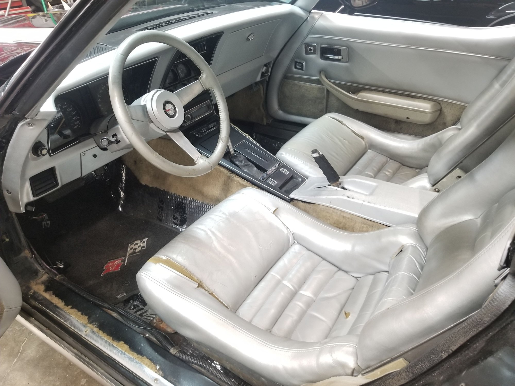

Got the dash back in. The gauges and radio wired up, and the power antenna working. Refurbished the hvac controls as well. I need to order a new rug. Tossed the old junk out aside from the console pieces. Same with the seat covers.
Also got the rear window installed and trim back on. Looks 100x better than before.

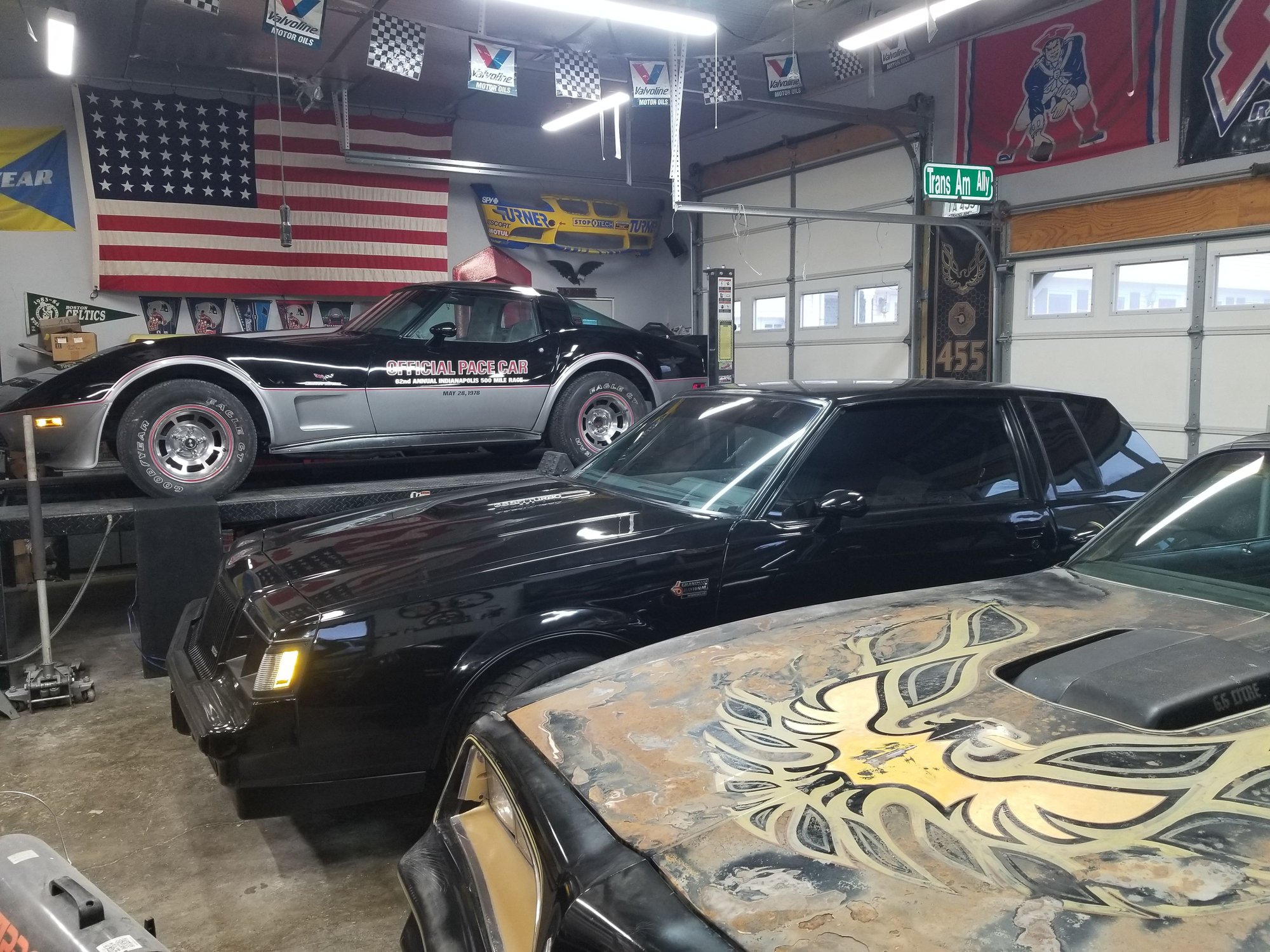

Got the rest of the decals on. Went with the door lettering this time around. I owned a 78PC a few years ago without them, so I figured I'd switch it up.
Everything laid down nicely, but holy hell the transfer material Phoenix Graphics uses is a giant pain in the *** to work with. Way too strong, too much adhesive to comfortably remove from the decals one their applied. The lettering took a long time just to separate from the backing before I could put them on the car.
I'll grab a pic of it outside later, but here it is on the lift. I'm buttoning up the exhaust now.

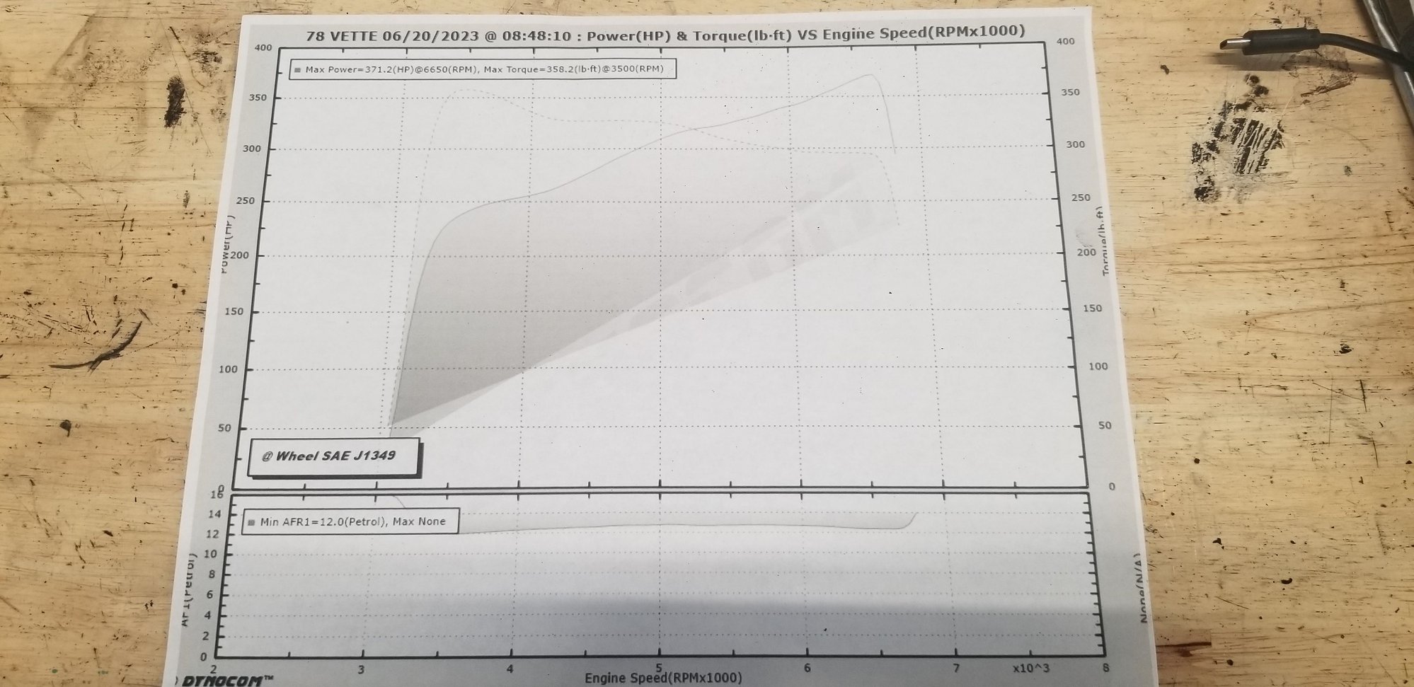

Car is back from the dyno. Put down some pretty respectable numbers for a stock 6.0 with a camshaft on the smaller side. If I ran a tighter converter it probably would've put down a little more, but I like the driveability of the looser converter in it, and it should really work well on the highway.
Made 371HP and 358FT/LB at the tires. The goal wasn't to build a max effort setup, just something that has some decent power and has excellent street manners.
