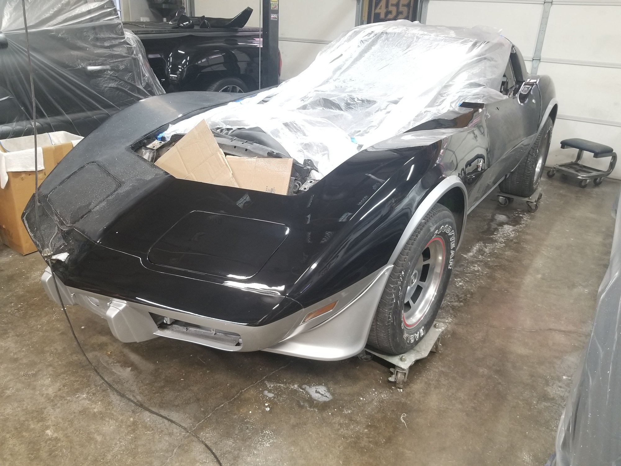

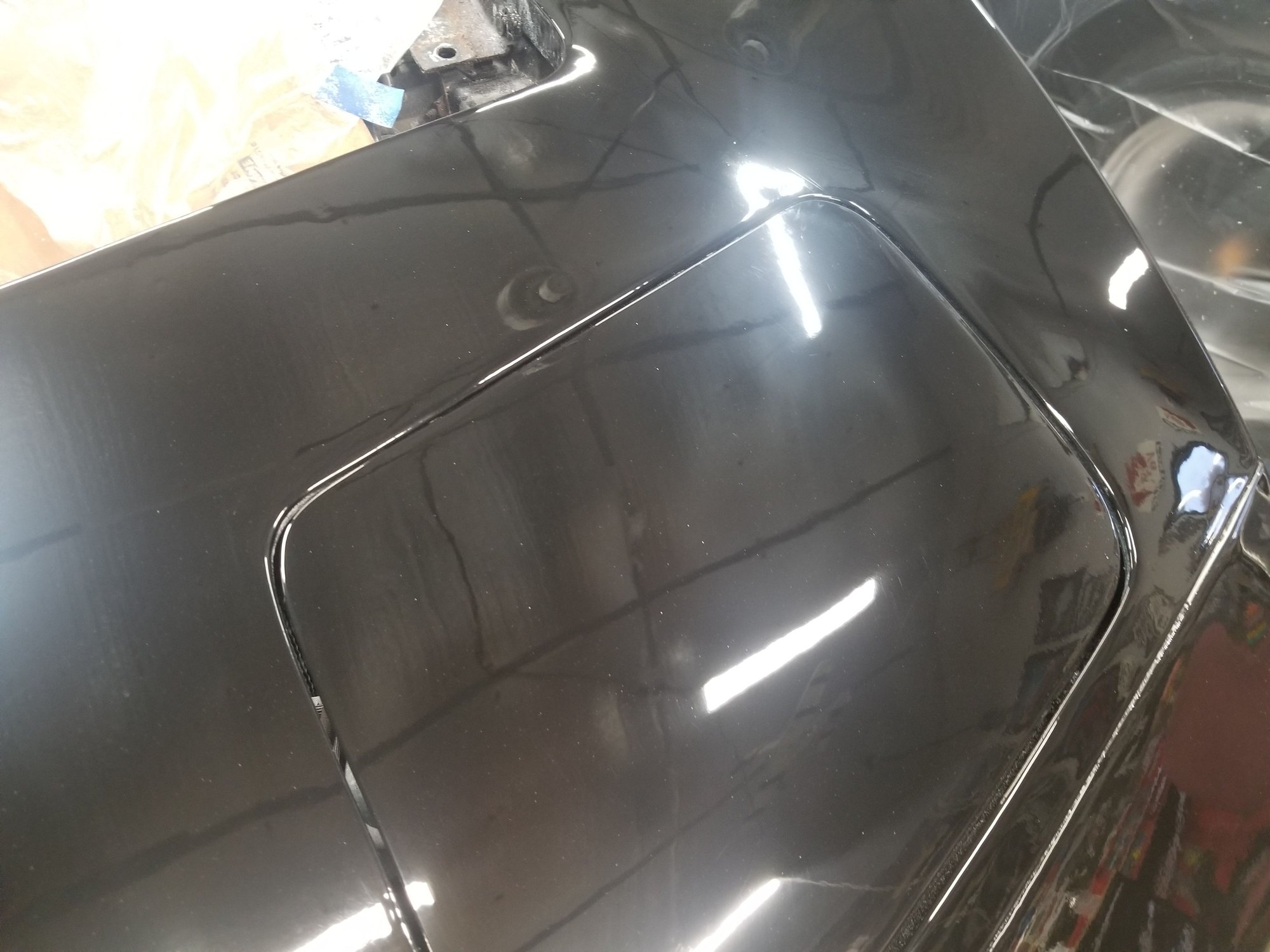

Cut and buffed the front fender today just to get an idea on what the final product will look like.
Wet sanded from 1000 to 3000 and hit it with some Meguiars heavy cut compound, followed up with their finishing polish. It's looking pretty flat and slick.

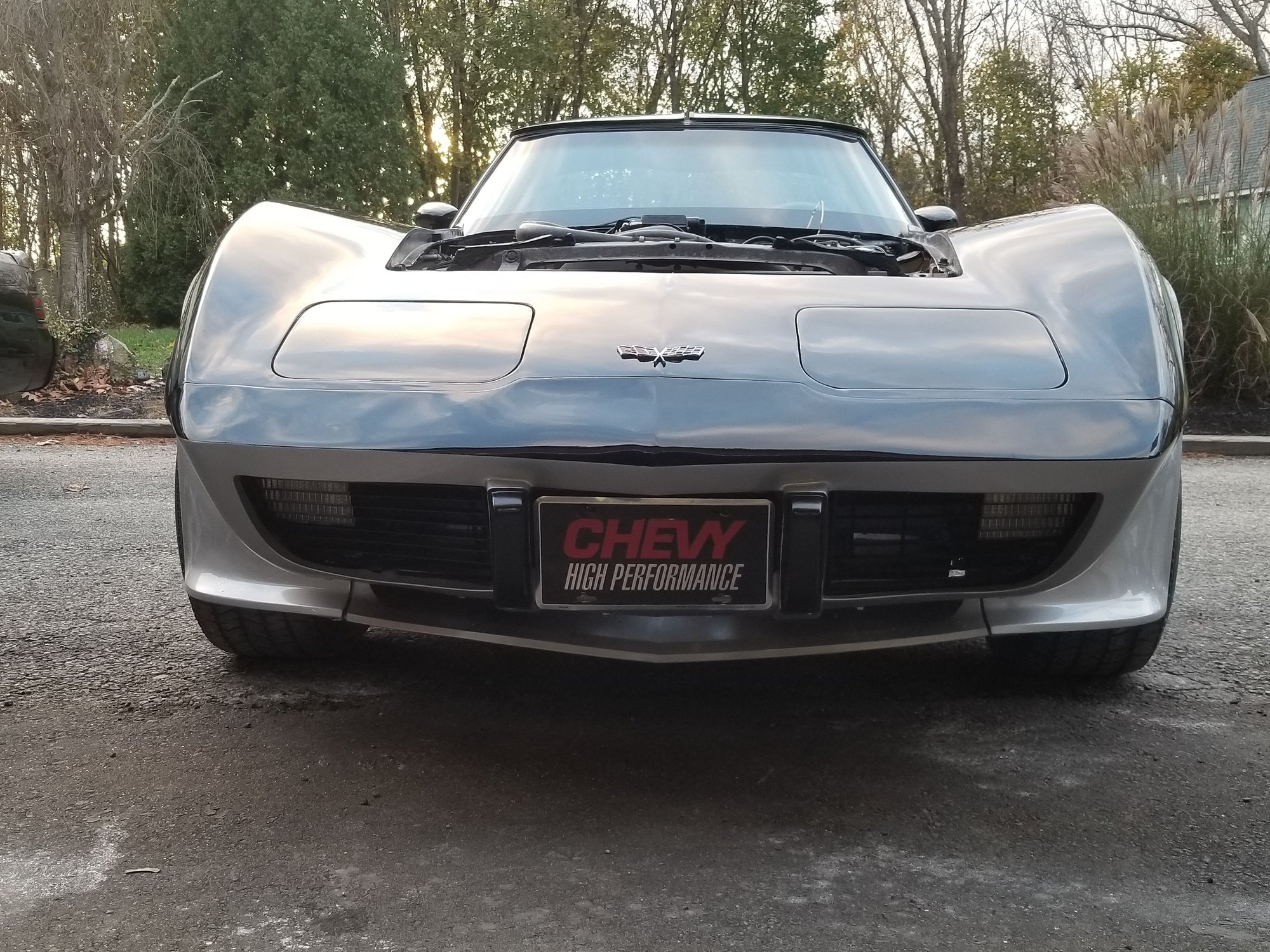

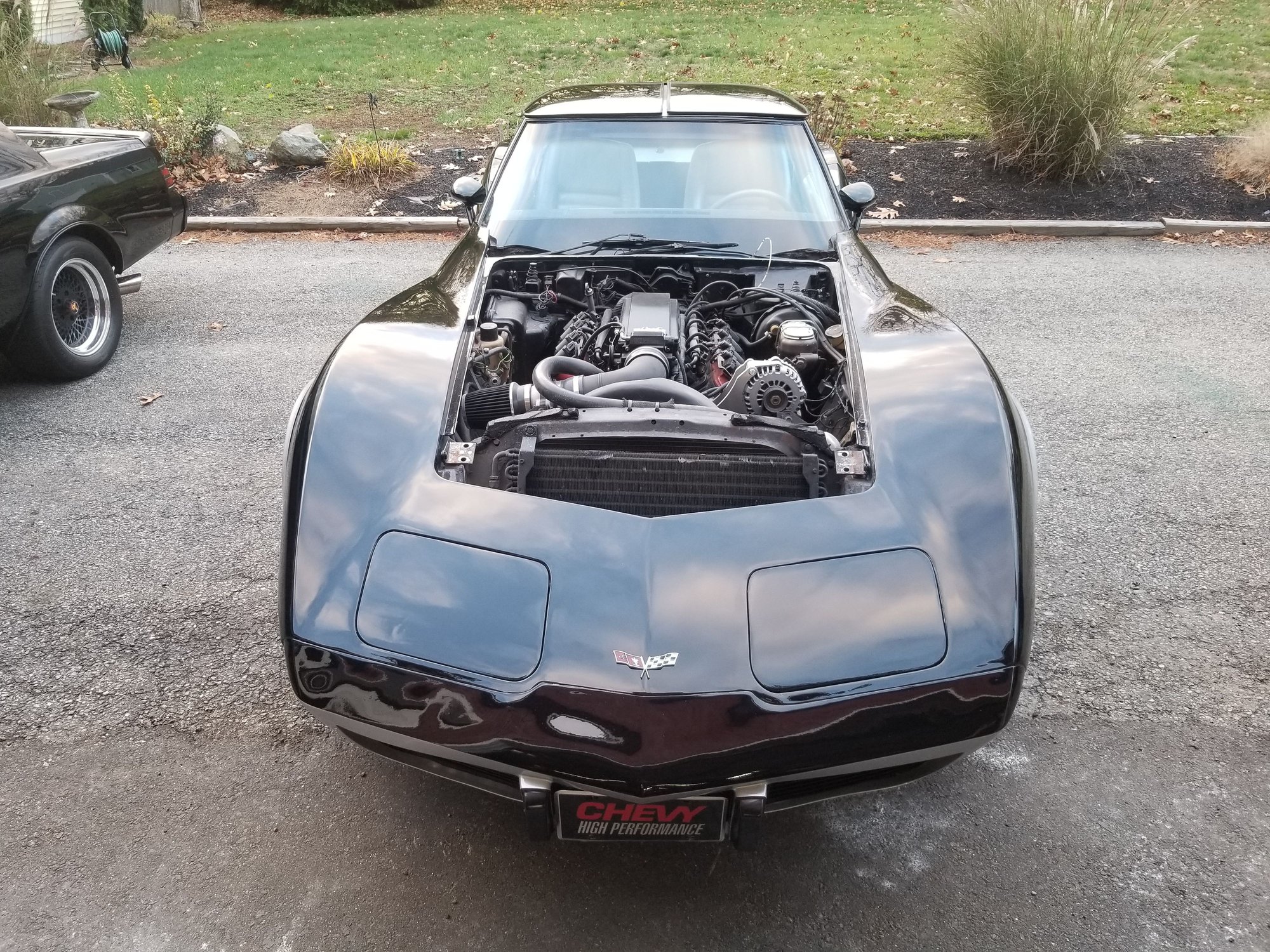

Got the car out in the sun today. I'm really liking the 79 nose emblem!
Also got the bumperettes painted, the other emblems installed, front grills painted and installed, and buffed the tail lights and side markers. Mirrors are also back on, and door glass installed and adjusted.

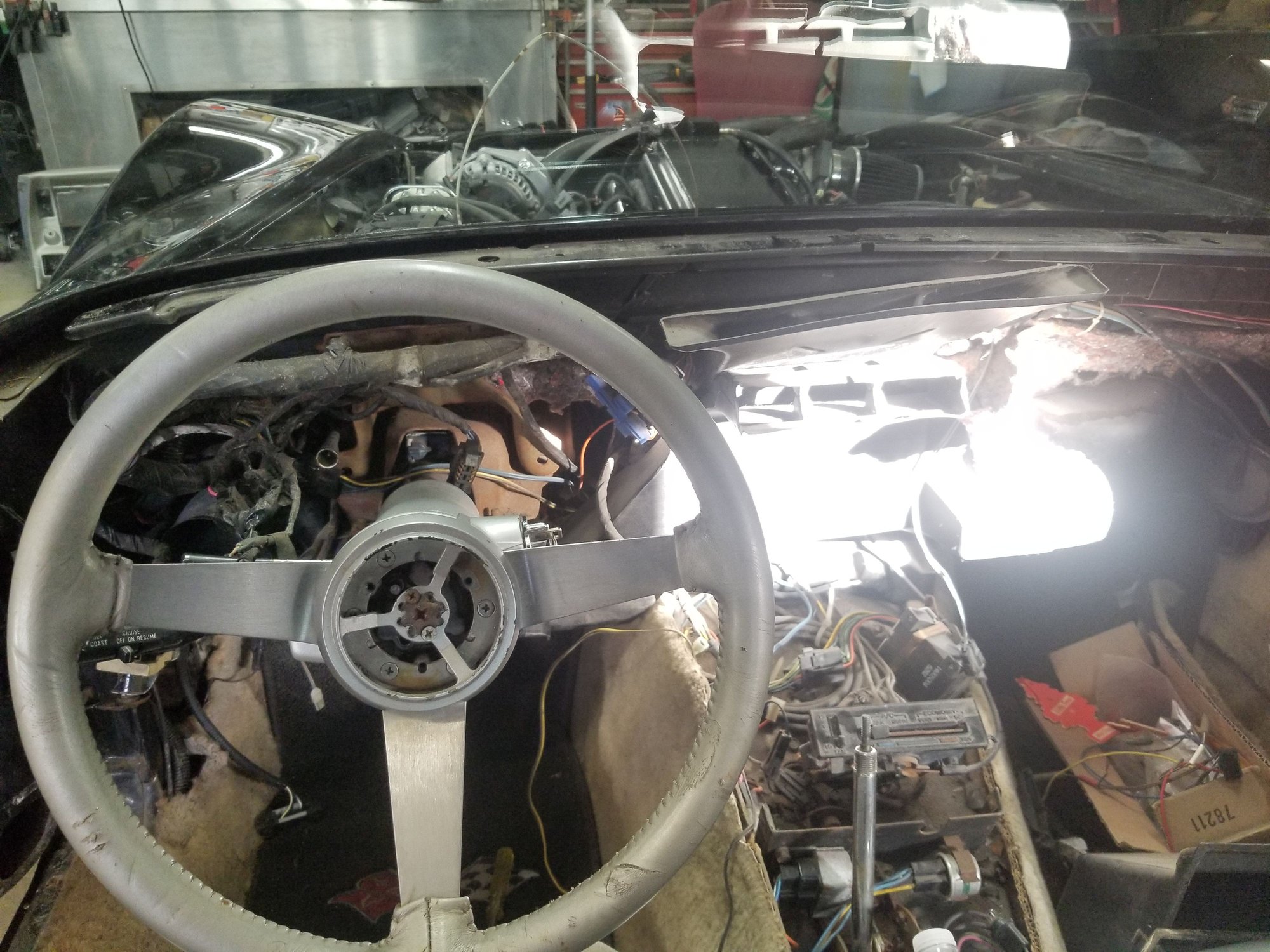

While I'm waiting for the decals to come in, I decided to pull the dash and center console to clean some things up. Took all the duct work out and soaked it in purple power, followed by a pressure washing. Diagnosed the window switches not working, and installed all LED bulbs in the cluster while it's out. Also running all new speaker wiring front to back.
Pulling the dash also allowed me to check out all the vacuum lines for the HVAC, and lubricate all the moving parts for the system.
Here's a pic before any real cleaning. It was a mess, but everything is in tact and not a spec of rust in the birdcage!

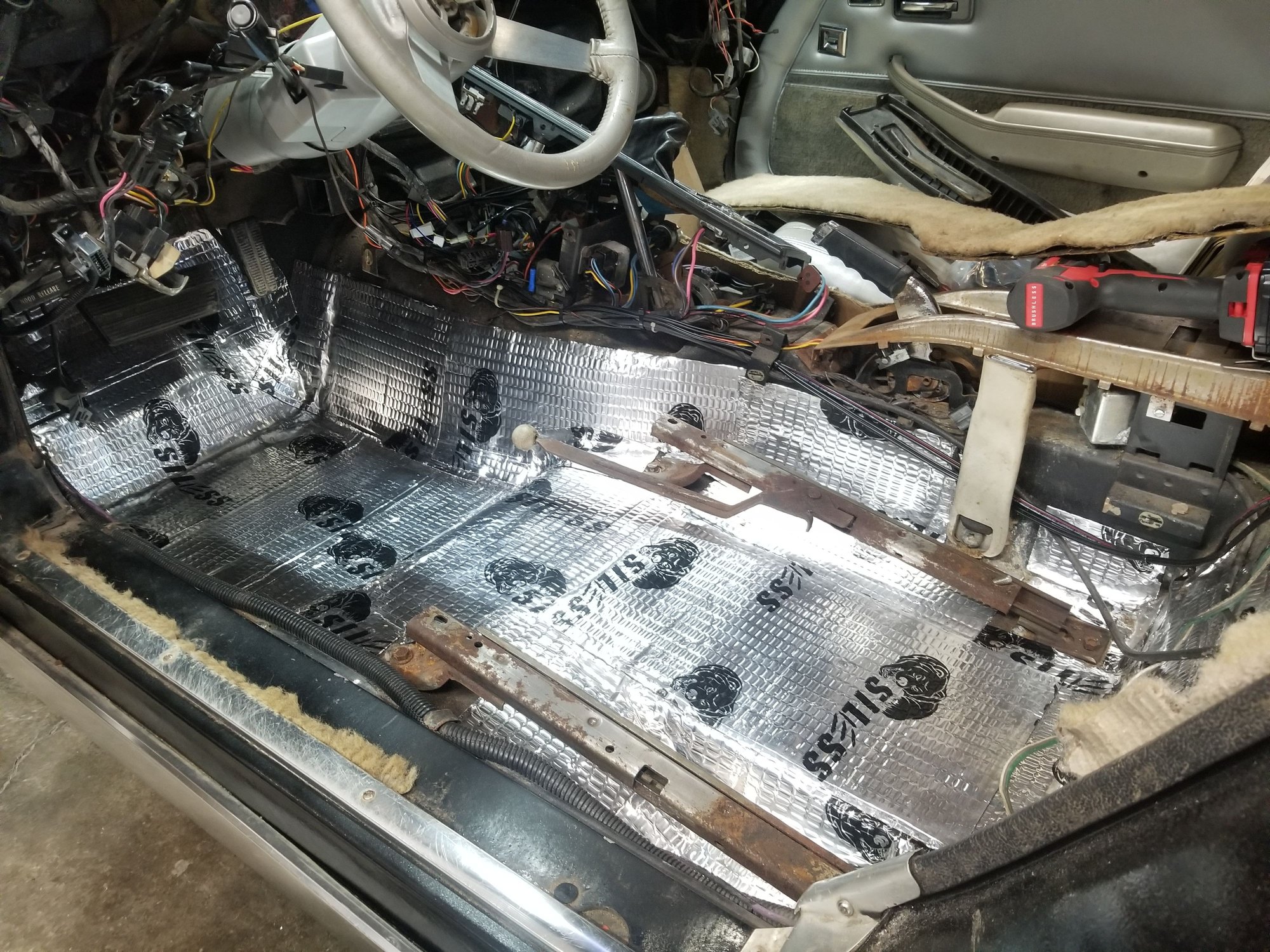

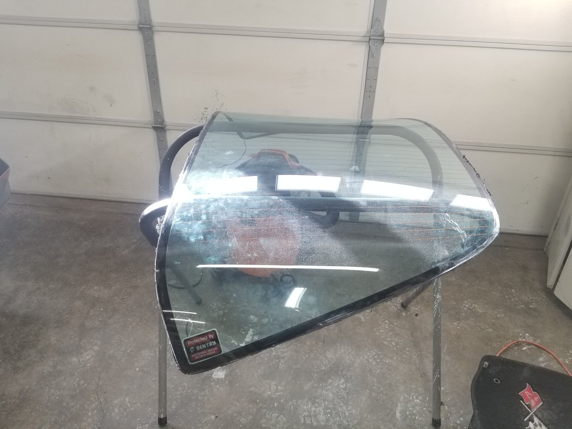

Things have escalated slightly. I wanted to replace the rear window trim clips, but they were covered and buried in window sealant and rtv. Instead of fighting with them, I removed the rear window to clean everything up. I'll also be tinting the glass while it's out.
I also have the interior pretty much gutted, and have been sound deadening everything.
