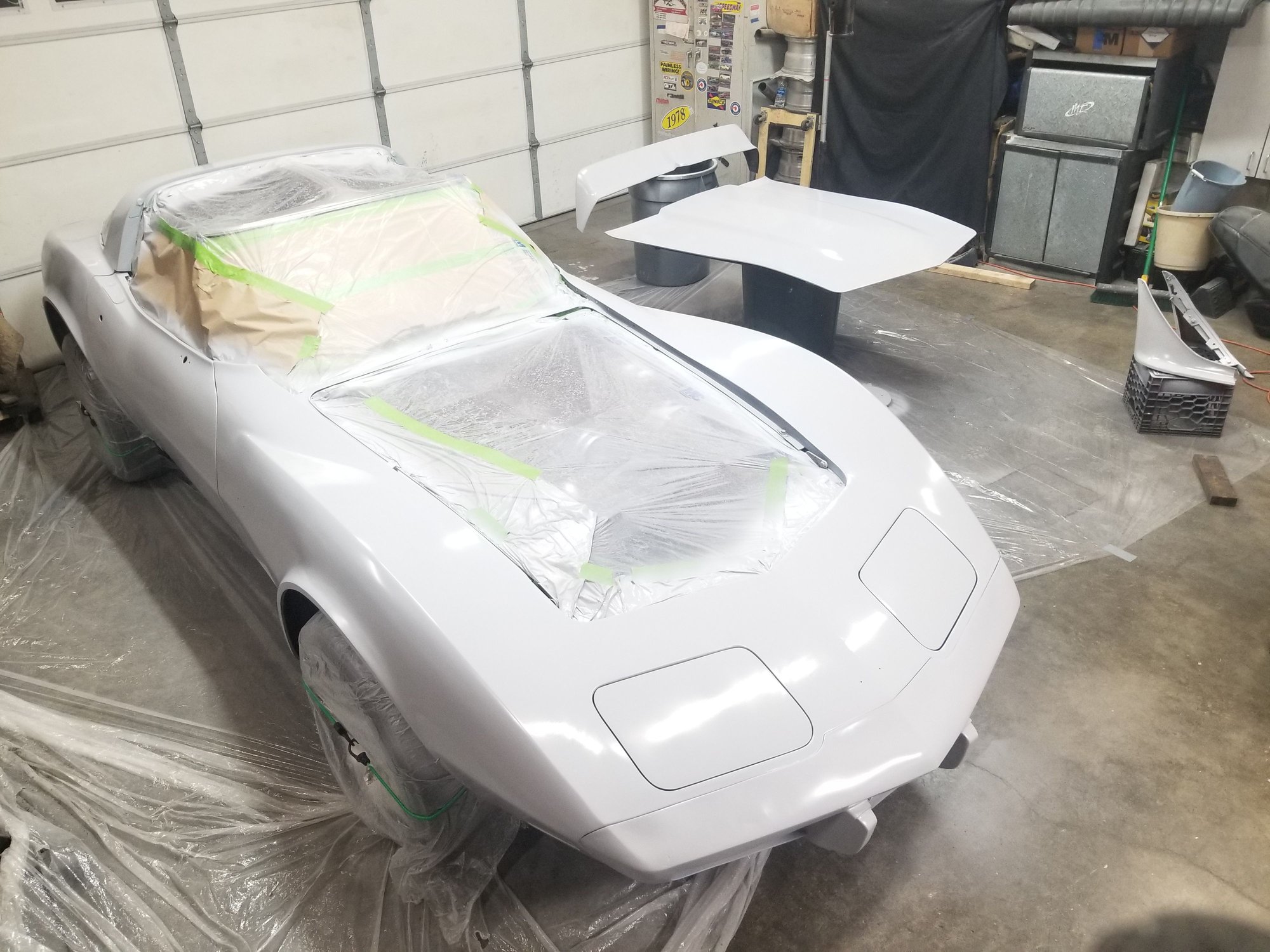

Old Oct 7, 2022 | 06:52 PM
  #57
Tranz Zam's Avatar
Tranz Zam
Joined: Jul 2019
Posts: 2,294
Likes: 2,016
From: MA/NH Seacoast
Got 2 coats of high build primer down. I thought I had more primer in the cabinet, but nope. I ordered another gallon, but wont come in till next week.
I'll knock down the first 2 coats with 400 grit on blocks, fix any low spots, and do 3 more coats when the new gallon comes in.

Old Oct 8, 2022 | 11:56 AM
  #60
Tranz Zam's Avatar
Tranz Zam
Joined: Jul 2019
Posts: 2,294
Likes: 2,016
I plan to do a light tint on mine as well, but I’ll probably wait to get them tinted until after everything is assembled.
I could see myself scratching the tint while I’m doing the assembly or adjustments.
I do worry about scratching the tint during installation. I've done it before in other cars, but not a C3. The glass on these cars dont like to come out or go in easy.
Doing a quick walk around the car this morning, looks like the primer laid down nicely. I can see a few low spots that'll need some attention, but nothing crazy.
