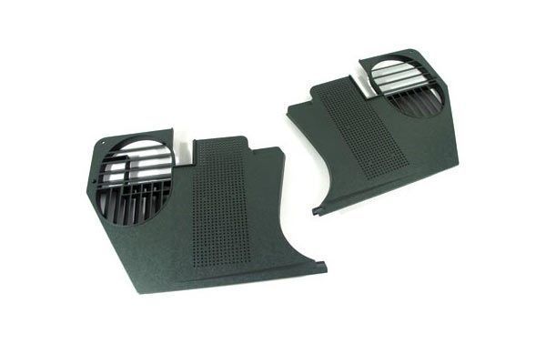

Part of the right-side panel is cut-out from the factory. It is in that 'oval' area toward the upper-front of the piece (as it sits in the car). Those are 'meant' for A/C cars; but if that's what the line had available, that's what would be installed.

Here are the two configurations for the passenger panel. You can see where the panel is trimmed away for A/C cars.
To kick panels slightly different
