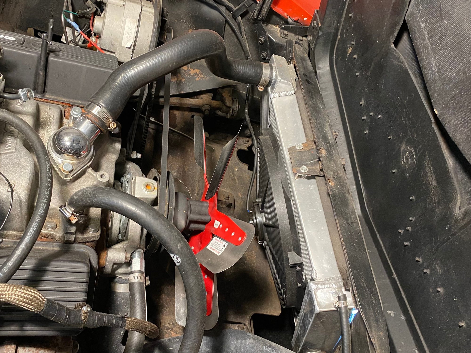

My ‘69 350 4spd coupe as purchased has the engine mounted fan and the pictured radiator mounted fan that is currently wired hot off the alternator with a console switch. I don’t like manually switching the fan on/off. As it is now, it cools fine. No problems other than I think it looks dumb with 2 fans and possibly forgetting to turn fan on especially if someone is driving my car.
My question is do I need the engine mounted fan on a Tennessee car? Any suggestions on electric fan operation? Ignition only, ignition with thermostat, or just thermostat?

Just an opinion..and welcome..
but post up details..year, engine, tranny, any issues etc..what radiator u have..
i think you need shrouding in either direction you go…others are more knowledgeable..
post pics of how wired in..not a fan …..of flex fans..do you have any of the original parts like fan and clutc and shrouding?
edit i see its a 69..you also need bushings in a arm..post up lots of pics! Especially how wired near alternator

I wouldn't trust that flex fan.
But I wouldn't trust that unshrouded, radiator-mounted fan either.
There are much better solutions for either one, and if your car is timed properly, you shouldn't need both.

Spal sells a proper wiring kit with 2 choices of on/off temp for 40ish give/take
If you put a shroud on the mech fan you should never have a heat issue
With no shroud that flex fan is doing little to no cooling. The kit for the electric is sold by Jegs and Summit
Once s yr I like to flush the fins out with a garden hose from the backside of course. Makes a huge difference in airflow

With no shroud that engine fan is not doing much of anything except making noise. The flex fans are also known to come apart at higher rpms. I would ditch that fan. The one mounted on the radiator is better but still has no shrouding around it. They do sell kits that run the fans off a thermostat so they go on only when the temps hit a range than back off at a lower temp. Pretty easy to wire in also.

Ditch the salad cutter and fine a dual fan setup with shroud.......that fan in its current state is doing nothing but making noise.....
Vette's need a shroud for airflow along the whole radiator rather than a 14" circle........

Yes,
1.But NOT that fan...flex fans SUCK.
2.Additionally, someone mounted an electric fan totally improperly, without a air gap plenum. (nor ram-air, at-speed flappers. which Chevy actually provides for. 30% of the cooling flow is BYPASSING the fan.
3. Someone has been throwing 'I give up' bandaids at this car...they removed the fan clutch!
4.Someone made a half-assed ATTEMPT at gasketing the radiator but FORGOT the entire section across the top of the radiator core support. So that's another 25% of available cooling air BYPASSING the radiator. Let alone what we can't see in the photo.
5. Someone REMOVED the FAN SHROUD, so the fan is mostly INEFFECTIVE ANYWAY. (extremely effective at pouring mixed hot air into the open element air cleaner!)
I'm saving this picture of 'WHAT NOT TO DO'
I have a 69 4 spd L-46...which does PERFECTLY WELL in blazing hot Phoenix Arizona....here is the formula;
1.CHEVY big block 7 bladed fan.
2.CHEVY big block 180 degree (early lock up) fan clutch.
3. Chevy fan shroud. STOCK RADIATOR,
4. 180 degree thermostat.
5. Spring in the lower radiator hose.
6. Foam surrounds (super anally) all around the radiator. EVERY molecule of air HAS TO go through the CORE of the radiator!!!!!
You cannot overheat my car even at 115 degrees.
As an Aerothermodynamic Engineer...all I see is horrorshow!
Best of luck and start again. Unkahal

Cant help but wonder if (as one poster said) he may have a timing/tuning issue causing warmer temps. Many overlook that
I like the idea of having both types on there so if a belt or the electric fan fails you are still getting home.

I don't have any cooling issues or I wouldn't be wanting to lose the flex fan. I think it looks ridiculous to have 2 different fan systems and would
like to lose the spinning death wheel and have the ability to lower temperature once the engine is shut off (without it running and draining the battery).

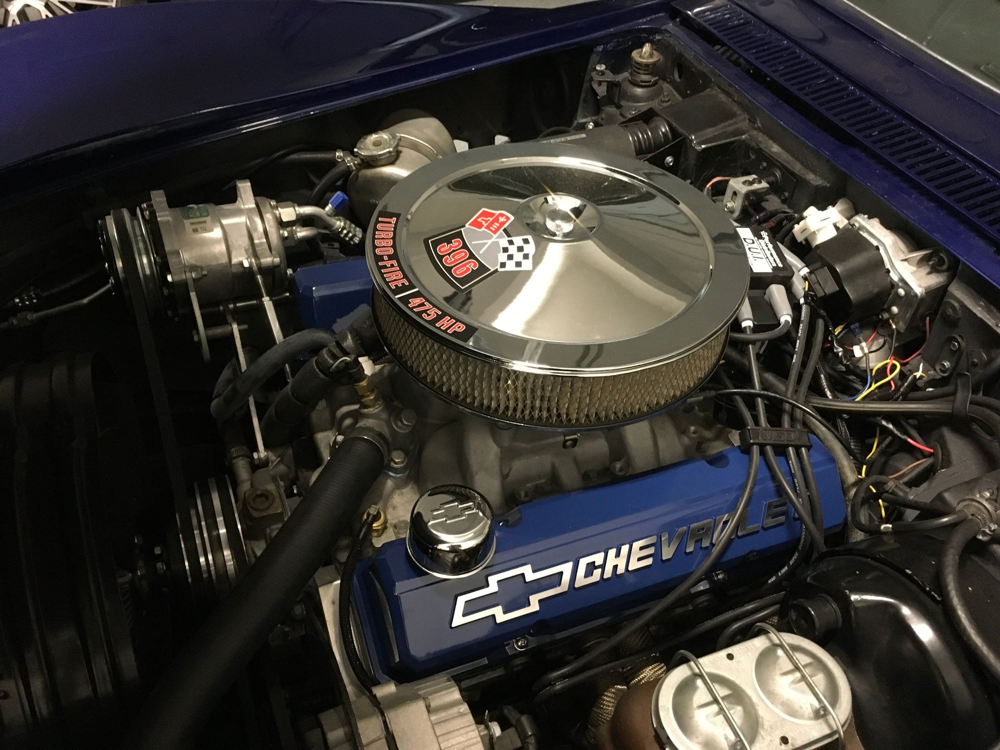

Factoid, get any comments about the 396 decal being a small block? Nice clean engine compartment.
