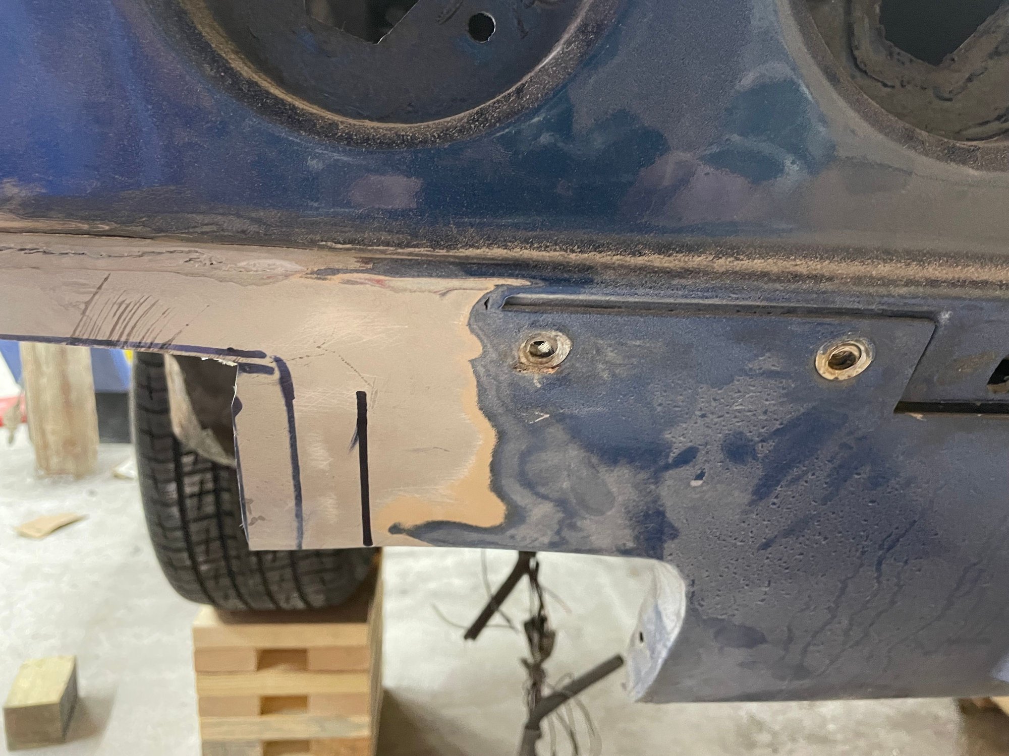

Well I did my homework and thinking last night, then went into my shop and did enough staring that I decided to remove the rest of the quarter panel to install the full piece of the new one I bought. This would give me fresh fiberglass and get rid of the hacked up pieces I had covered in body in filler. What could go wrong? You can fix anything with fiberglass!
This last section of the quarter was factory and had never been removed, and it took a lot more hit and force to break free from the factory bonding strips. I then took my 3" grinder with 36 grit to clean down all the bonding strips. then hand sanded the quarter above it to get rid of all the filler.
I clamped my new quarter on to start lining things up and taking measurements on trimming it on the rear. This is where I started marking it up to decided where I would trim.
First round of trimming complete and clamped back in place: we're pretty close!
Next step is to put the wheels back on and ensure it's centered, then make my final marks and adjustments. Getting really close to being able to bond it in, and this is going a lot smoother than expected!

I think you made the best choice.
It looks good, nice work!

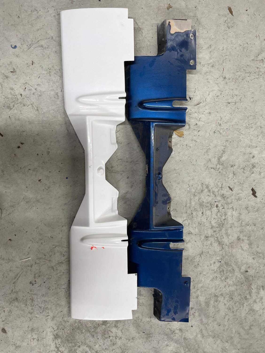

Next work was removing the exhaust valance and fitting the new one to fill the exhaust holes. As you can see, Bubba the Bondo Artist , put bondo on the edges here. I had to make a cut and work it all loose.
The other side as even worse, Bubba put Bondo over the bolts!!! Easy to fix and cut through though.
Here's the ne valance from ACI that fills the exhaust holes. I later realized that this panel is for a factory side pipe car, but since I'm changing the quarters, they don't have the exhaust cut out and they'll fit well.
After some fighting with the new panel, it was quite obvious fiberglass work is required to MAKE it fit correctly. Pretty disappointed in this piece, and wouldn't recommend getting one since I'll have to hack this up to make it work.. You can see below that each side on the license frame in the middle is off by 1/4" , not to mention the curves don't fit together well. I have two options:
  1. Cut the new valance don the middle and make it fit from there. Will have to add a 1/2" strip in the middle, but it's hidden and no big deal.
  2. Use the middle portion of the old valance that fits perfectly , but cut off the ends and put on the ends from the new valance to blow off the exhaust holes.
Both options require lite fiberglass work, but will be easy. Might try 1 first then switch to 2 if I can't get it to line up!

That make a rear valence panel like that that has "ears" on the side, to fill the rest of the factory exhaust hole on the quarter panels.
Wouldn't that be easier?

That is the correct valance, but the replacement quarters are filling the exhaust cut outs so the one I have works perfectly to fill the cut outs on the valance end. Basically I accidentally ordered the correct part! lol

Okay, I was wrong, I do need the one with the ears as expected! I looked at returning this thing previously and it as $100 to ship it back! Looks like I might be doing some more fiberglass work..
