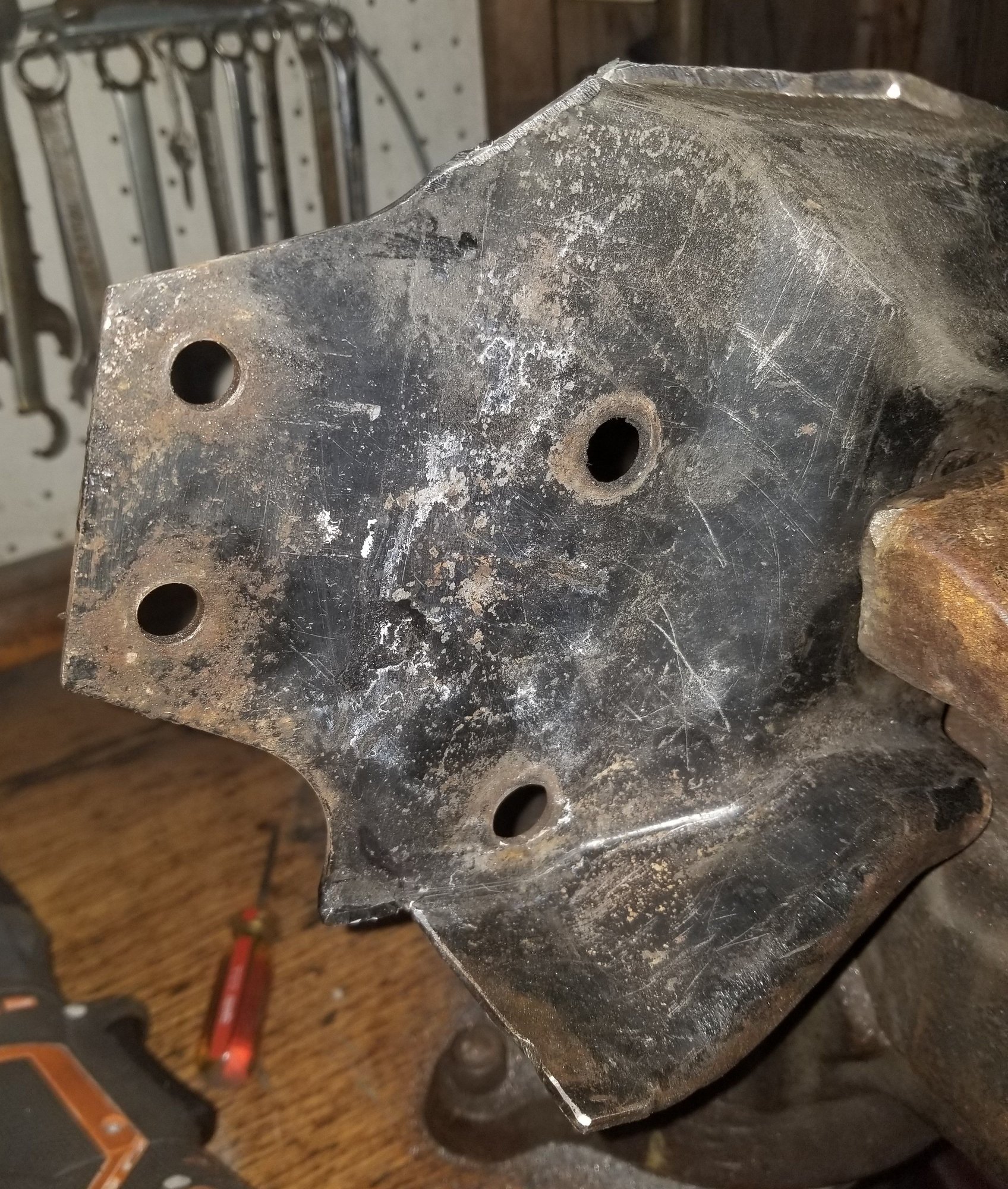

The mounting bracket mod
stock side mounting hole..i trimmed right along the hole
on the mount I trimmed off enough to get it to fit back until it hit the stock mount on the crossmember, in a later pic I trimmed the crossmemeber bracket a hair to get more room
that slope needs a pocket
the mount hit the front of the bracket so I had to trim a hair off. It hit the angle on the side

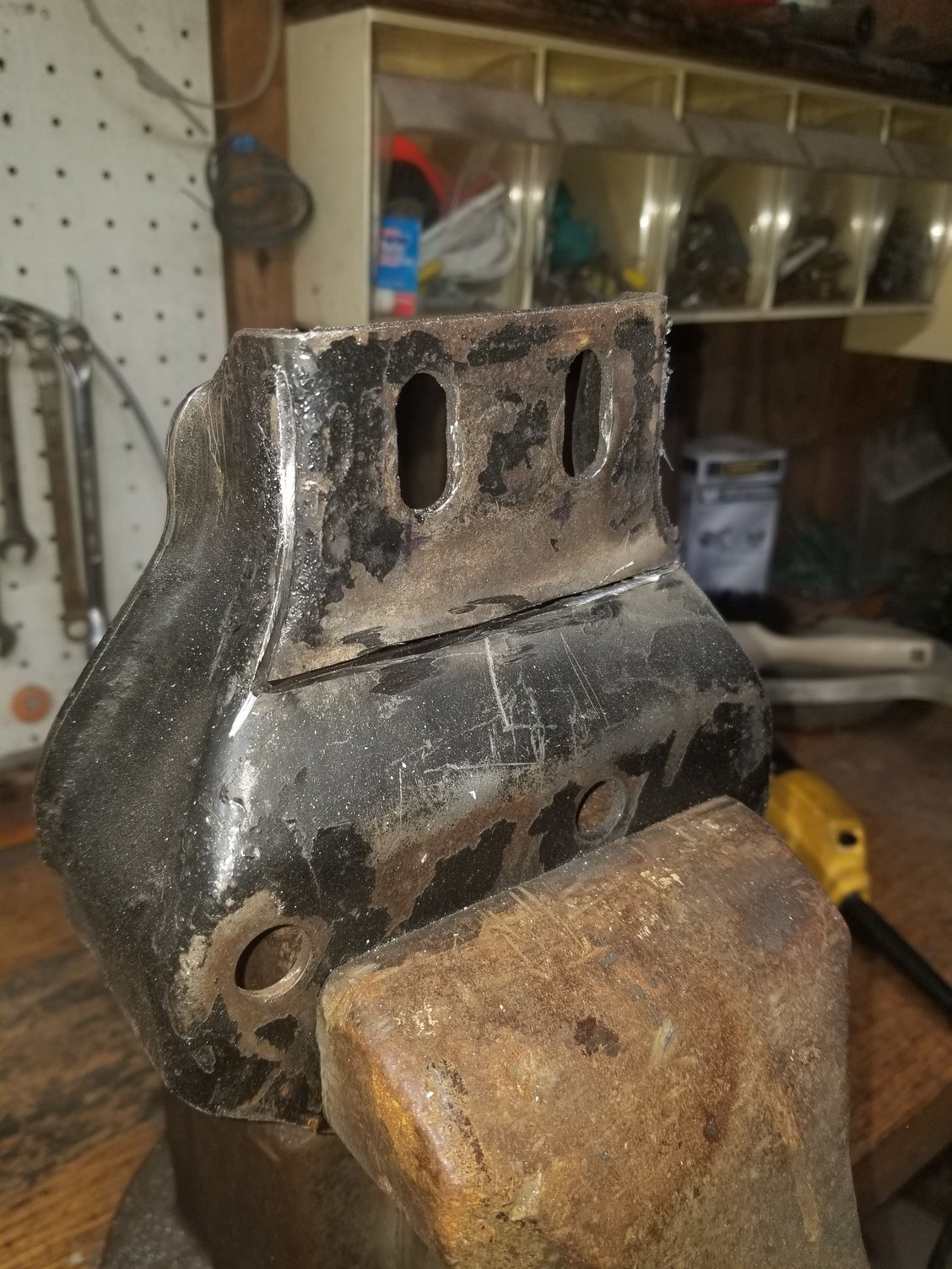

trimmed off the roundness on the top so it would sit flat. I dont have a pic but those two top holes but You will have to trim off some metal and redrill the holes
slotting the top so i can bend it flat to make the pocket
I welded a channel around the back to make the pocket solid

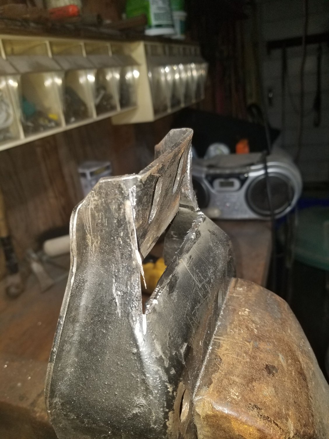

cut up the shift bracket that cam with my Tranny to shift it to the left. It worked great,. third and 5th need the very back of the new bracket angled down so it wouldnt hit the console...no pics of that

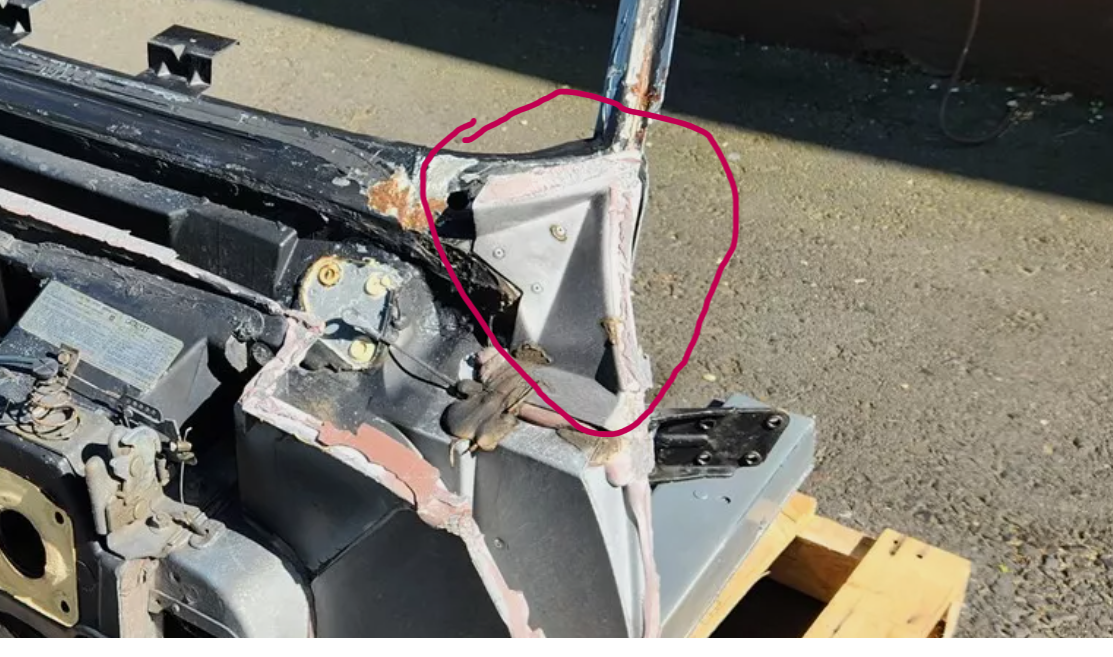

Does the circled in red give you any concern. I would think no space will be better. Great project you are doing.

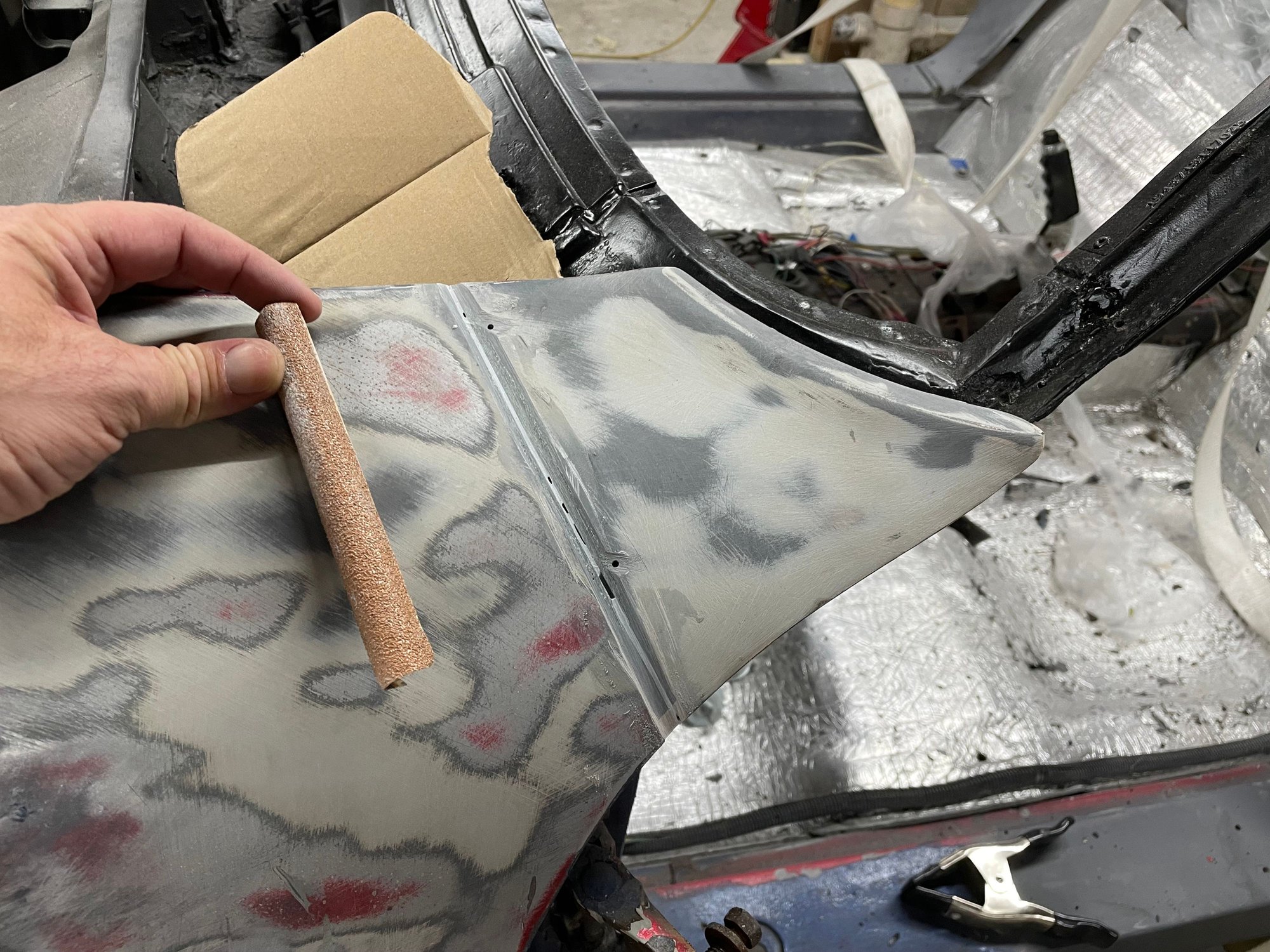

Last night I was able to bond in one of my fender corners after getting some good instruction and strategy from Mercury 20:
I used a wooden dowel wrapped in 60 grit to carefully sand in a trench to lay my glass into the seam
I then cut little strips of glass to lay dow​​​​​​​n and put down some tape on and strategic cardboard behind under the fender and other places to control the resin mess
The trench w​​​​​​​as sized perfectly w​​​​​​​ith the glass strips and I was successfull at laying the glass with no air:

I have heard of fixing the windshield frame this way, by cutting the corner off.
But there is an inner piece that attaches with 3 rivits here:
How do you cut or fix that piece?
Your pic. There were 3 rivits here
How do you deal with this inner piece?
Another view of the inner piece
