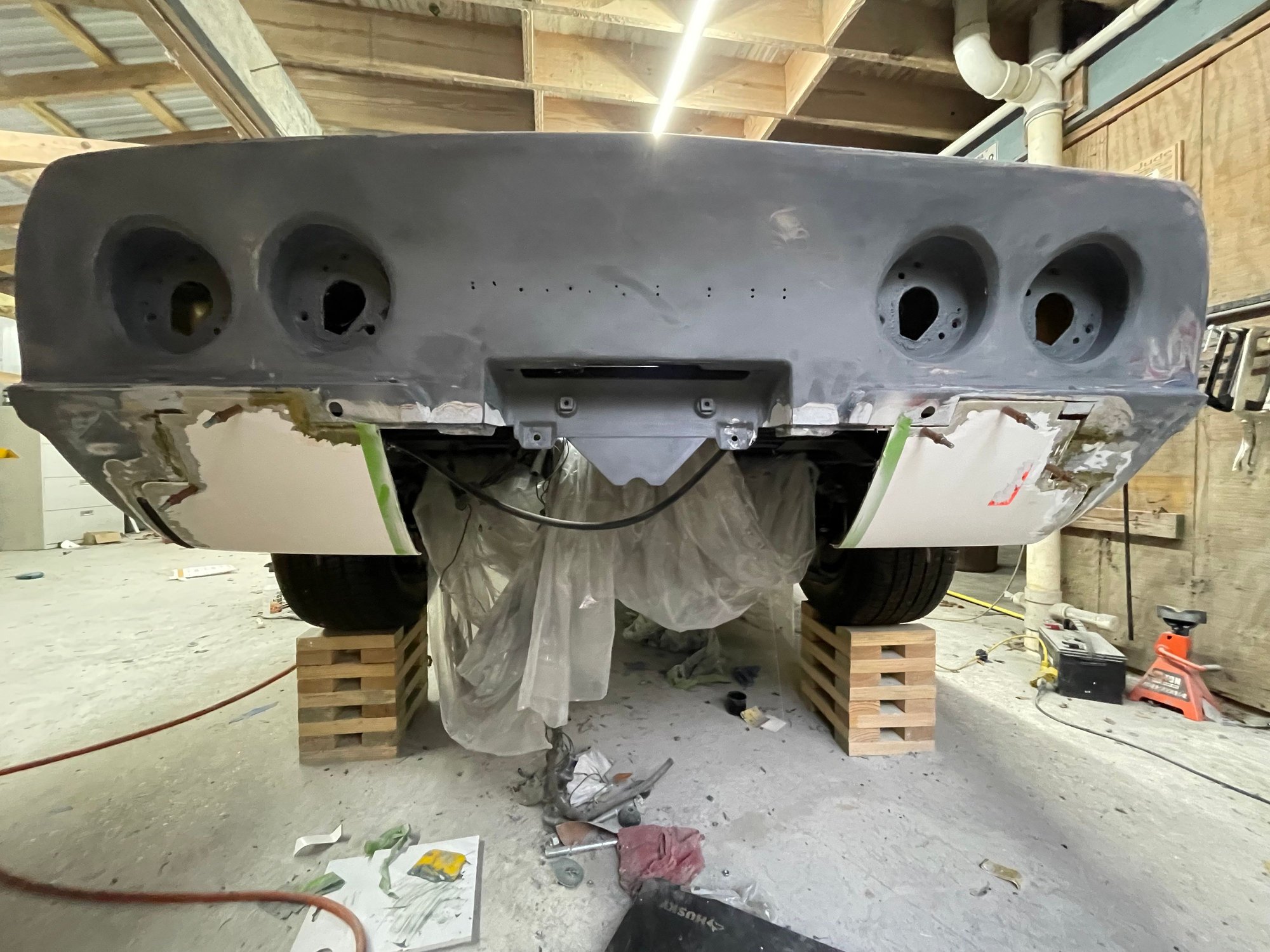

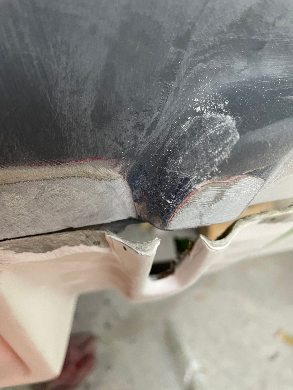

Flipped a coin tofday: TAILS = time to tackle the valance on the back!
Strategy here was to gfit it best possible and get it in alignment to glass it in, then finish over with filler .
Since I was glassing it in, I had to remove the tabs and grind it flat on the back so I could put bonding strips in:
Grinded back the gel coat for glass then started manipulating it in place and holding it in Vith Cleco Clips:
I then bonded in some small bonding strips with VPA, clamped them on the quarters on each side and alloved them to cure before I clipped them to the valance:
Did the same to the other side and put some fiberglass on the back side to hold it in place:
Of course, there were fitment issues I couldn't resolve.....
And even with the bumper on it was noticeable.. I stopped and thought about it for a fews hours..
Maybe I got carried away, but decided to go ahead and splice in the original middle piece to resolve this fitment issue:
Here we go!!!
And then I made more bonding strips with the original valance and created one piece with the valance:
All of this to go from this:
To this :
It appears I'll be able to make this work and the bottom is aligned pretty well. Hopefully I'm not chasing my tail here!!!!
