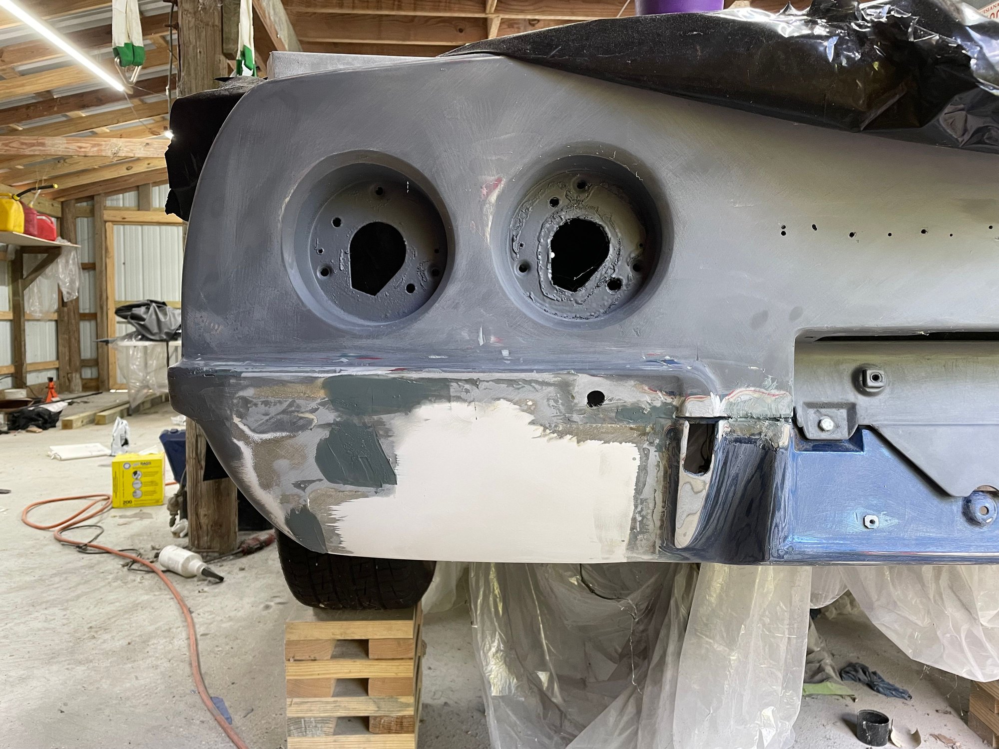

I was dragging after work this afternoon , but rallied myseld to get into the shop to get a round of filler and blocking done on my rear valance. First round came out good, it's not going to be bad getting this panel straight!

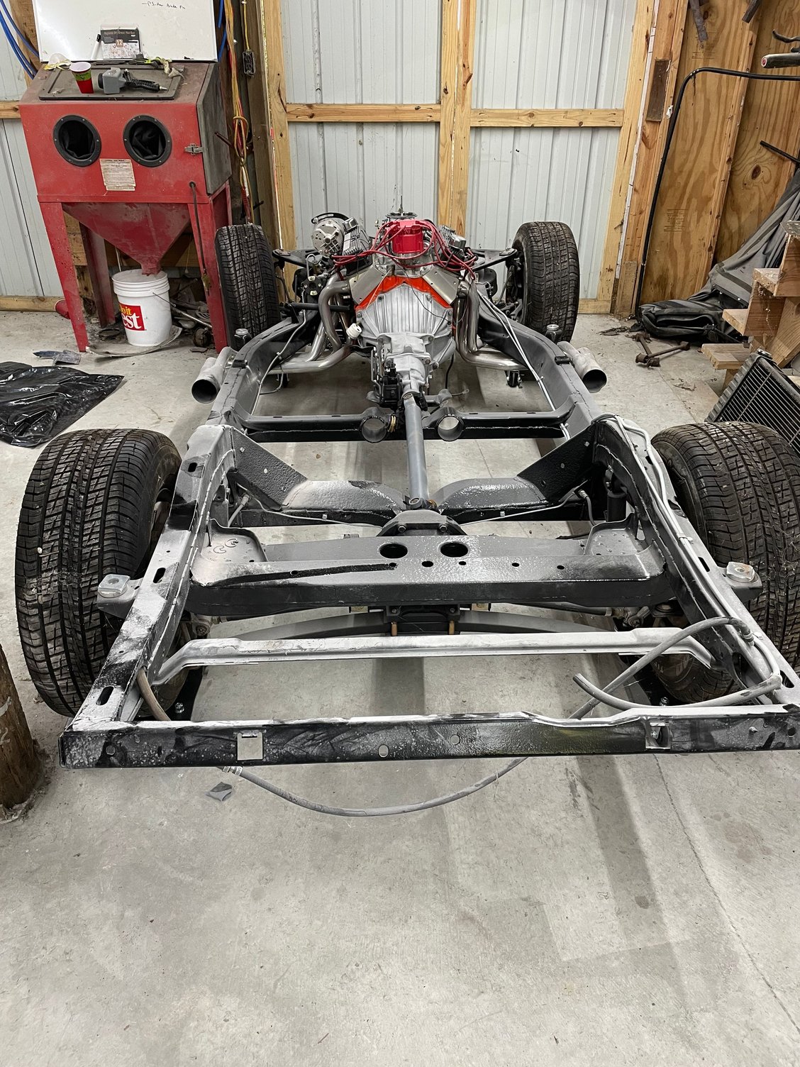

I spent Sunday pulling the body back off the frame, it's too easy at this point for the trans install and to finish the body work to not do it. I used the winch from my Jeep again and had my buddy spot me so we could slowly lift the body off and then slide the chassis back out from under it. This will be a nice opportunity to keep the frame from getting further dirty and spray Feather Fill without worrying about a mess. Next step this week is to get the T10 out and see how the new 5 speed fits!

I got the wheels back on the car and put the wheel dollies under them so i could move the chassis around and start work on the 5 speed.
I removed the T10 that was intstalled out my car and had the opportunity to compare it to the ne McLeod 5 speed: pretty close!
I then wrestled the new trans in without too much drama
After lots of measuring, thinking, and configurations, this was the best I found on the trans/crossmember mount. So i have two choices it appears currently:
1) drills holes and use a lowpro trans mount on currect OEM crossemember bracket it's resting on
2) Make a newbracket and bolt it in where the current OEM one is
