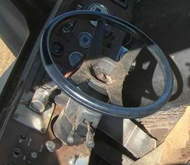

Hello, as I said in my intro, I don't own a Corvette, but I own a few Big Bud tractors that have the tilt-telescopic steering column from Corvettes, the dealer/factory said "go to a GM dealer", the GM dealer basically said "Go away", and a few months of googling(and finding conflicting information) and a week of disassembling a well worn steering column later, I am here.
As of right now, the questions I have on them are:
1. What parts are specific only to a corvette on the steering column?
2. On the blinker assembly: are the wires soldered on or are they removable connectors? (with 40 years of dust build up, I can't tell).
3. What is the second smaller rod operated switch, next to the ignition switch?(towards the bottom of the column)
4. What are the numbers for those mentioned in #3? Googling is bringing up multiple numbers.
5. Why do the keys say "Briggs & Stratton"? (edit: as in they do not say GM or anything, Just B&S)
Thank you.

Originally Posted by 4-vettes
Have no Bloody idea about tractors. What year Corvette column do you have? Might help.
Is there a way to tell? Or I should say how does one tell? I figured they would all be reasonably the same for that time.
Originally Posted by Bikespace
Photos always help! Someone might recognize the year from the photo, or recognize what is different.
Jim Shea's papers might help you, if you dive in. Corvettes are "Y-Bodies".
http://jimshea.corvettefaq.com/
If you find something interesting, please let us know!

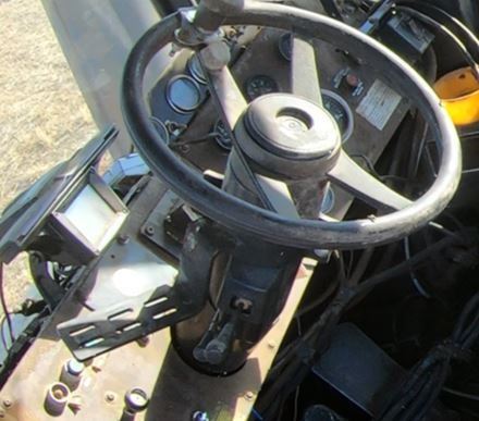

These are the only photos I have of any of them currently, unless pictures of a disassembled one would help. I can take a few pictures of the various assemblies. The key cylinder/tumbler doesn't have the bolt notch if that means anything, just the spring tab.
buy ebay aftermarket columns and send the corvette ones back to people with corvettes!
I'm not sure you would want it back, with all the welding, modifications, and 40 years worth of dirt, and I don't want to re-engineer a 40 year old tractor with the front half of the cab designed around it, not to mention a great deal of the electrical system. If it makes it any better, they were sold with that as a sales point, not to mention they are still considered the "top of the top", the "best of the best". I will say it was a better idea than most of the time, using a somewhat common part, instead of some odd obscure proprietary obsolete system.

The placement of the wiper/dimmer switch pictured is 1977 and later column but the steering wheel and telescopic mechanism is 1976.
No idea why this column would have a Briggs & Stratton key.
Cheers, Greg
So I should look for parts from a '77 then?

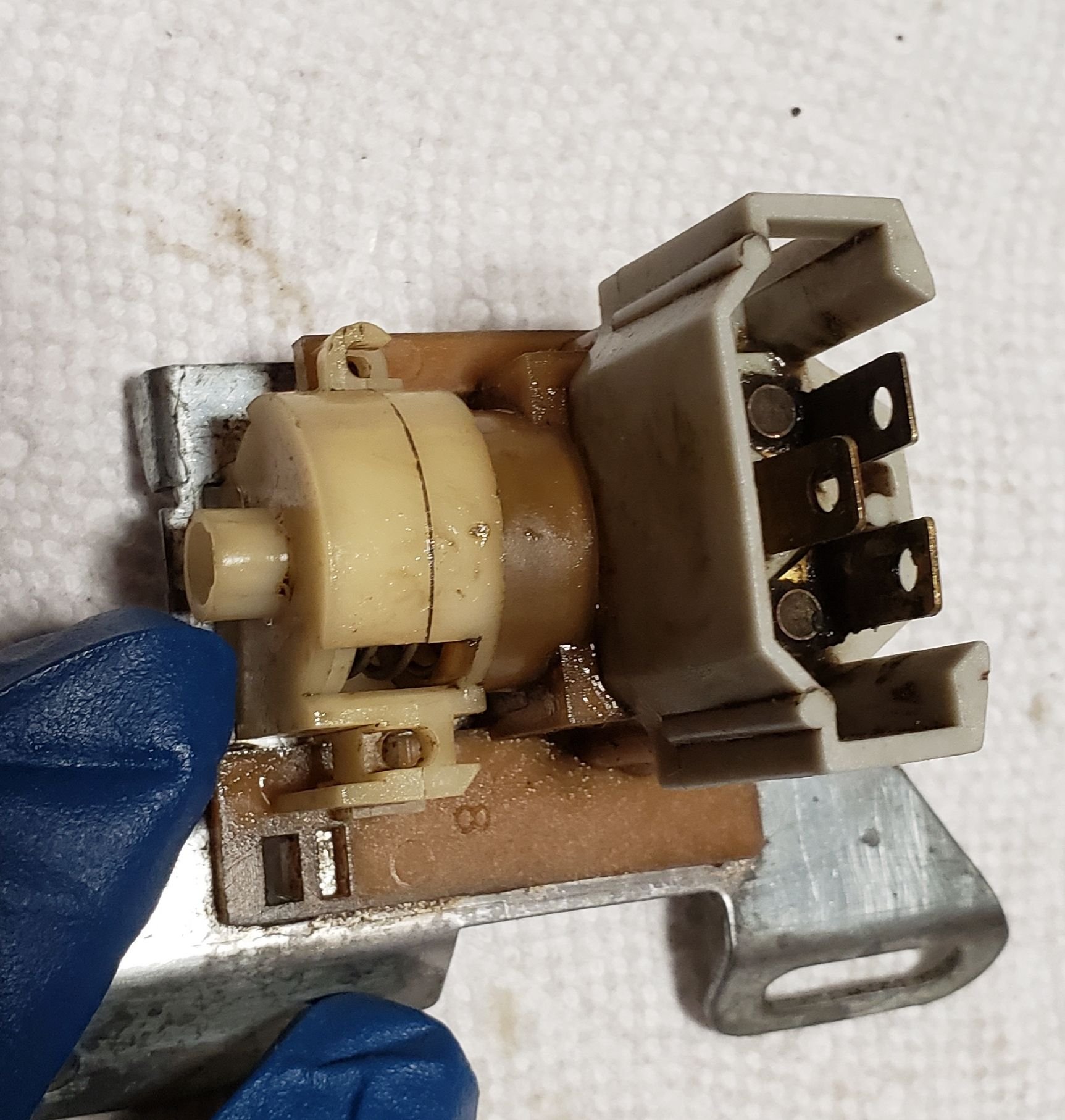

The other rod in Question went to this after it fell out of wherever it was connected to.
A question about the starting switch(the actual sliding switch): WD-40 "good enough" to lubricate the rollers inside it? I took it apart, cleaned itx and put it back together, but when I did take it apart, it appears there was some type of grease long ago inside it. Or I should say, what should be used to lubricate it?

The “other” rod is for the high beam switch. The ignition and high beam switches are mounted side by side on the bottom of the column and are connected to the controls via rods. You can confirm this by pulling the turn signal switch toward you and watching the rod move.
I concur that it looks like a 77 column with the 76 “Vega” style wheel. 77 was a one year only column - you’ll find some parts, but not others. Good luck on your hunt!
