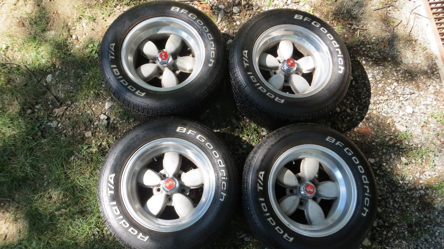

Ran across some wheels the other day. (4) 8.5 X 15 American Torque thrust with 3.75 backspace. They also came with 3/8" spacers if necessary. It's old school but so am I. I like the look.
I've searched the forum but can't seem to find those wheel dimensions with 265/50 R15's on a car. I don't see why this combination won't fit but before I pulled the trigger on new tires I was hoping for some experience from the experts. Photos would be great if possible.

If they are Torque Thrust Originals you will need wheel spacers for the spokes to clear calipers.275/60-245/60

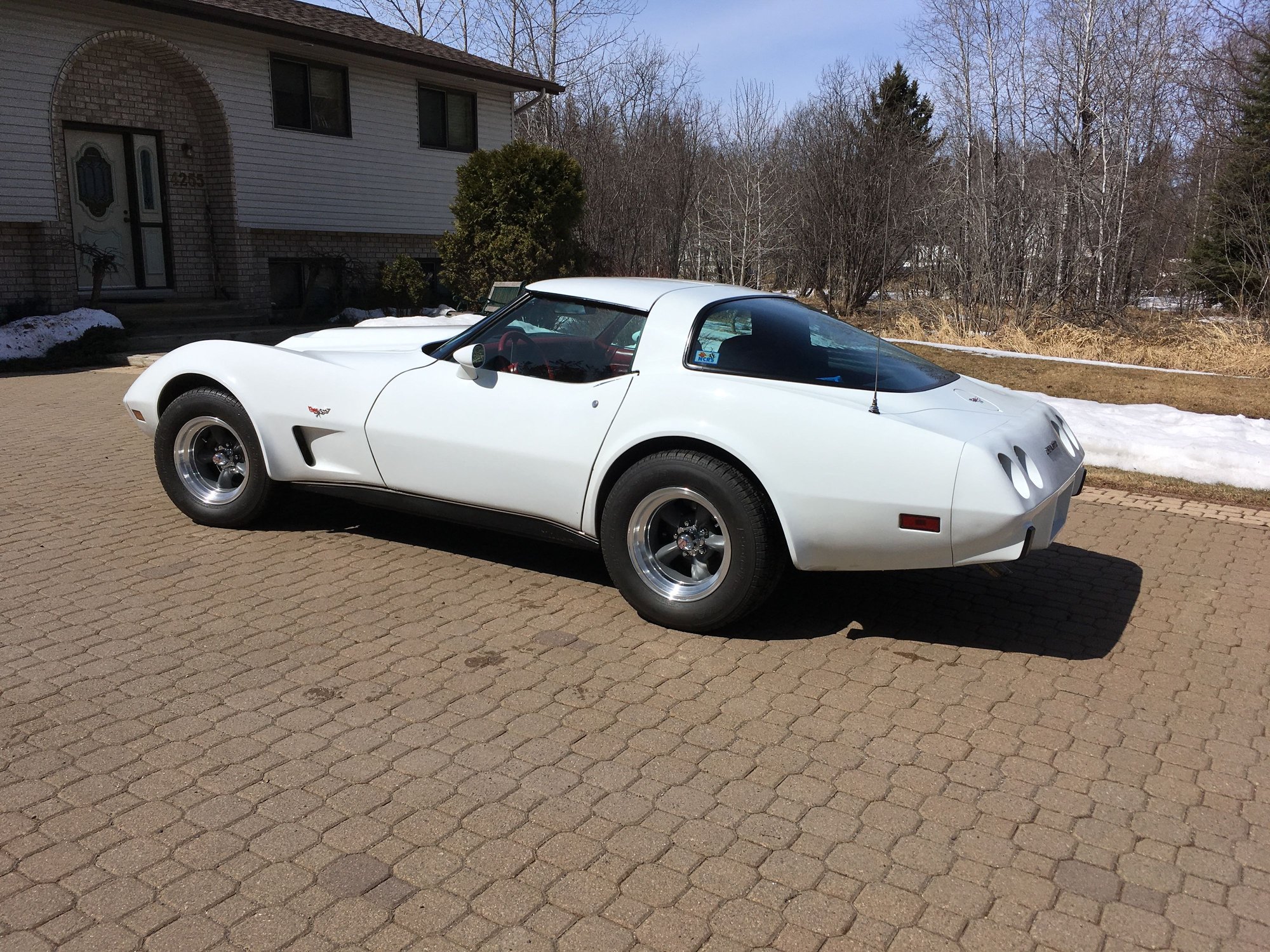

For a few years Corvette Central was having these wheels specially made to fit Corvettes. I bought a set which are on the car in the photo above. They fit perfectly without any spacers. Unfortunately the only way to find out if the wheels you are looking at are the right ones is to try one on the car. gjohnson is quite correct. The regular Torque Thrusts will not clear the calipers on a Corvette. BTW the tires are 255/60R15s.

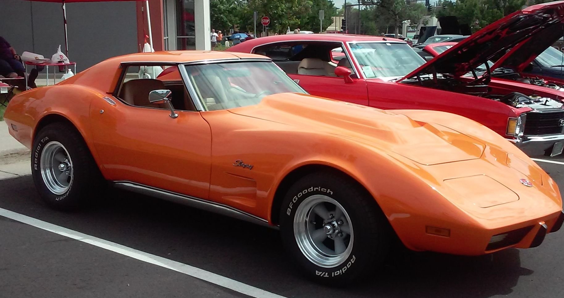

265/50x15 on AR 200s 15x8 4" BS fitted a 69
