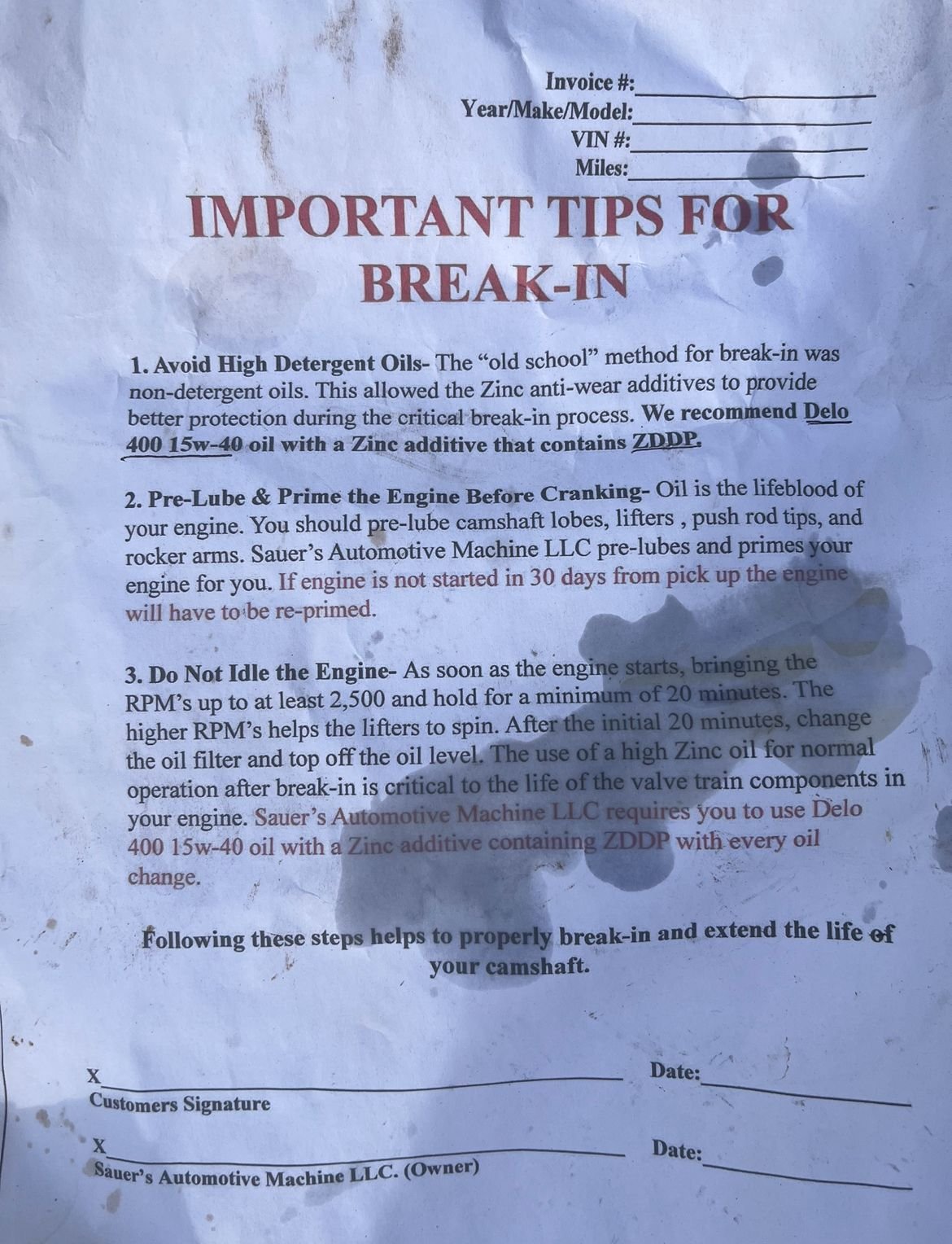

I drained the engine break-in oil, switched out the oil filter, added ZDDP & Delo 15-40
I’m glad to finally have real oil in the crankcase as per recommendation of the engine builder.
Sauer’s in Medford built the engine & are very specific about the oil.

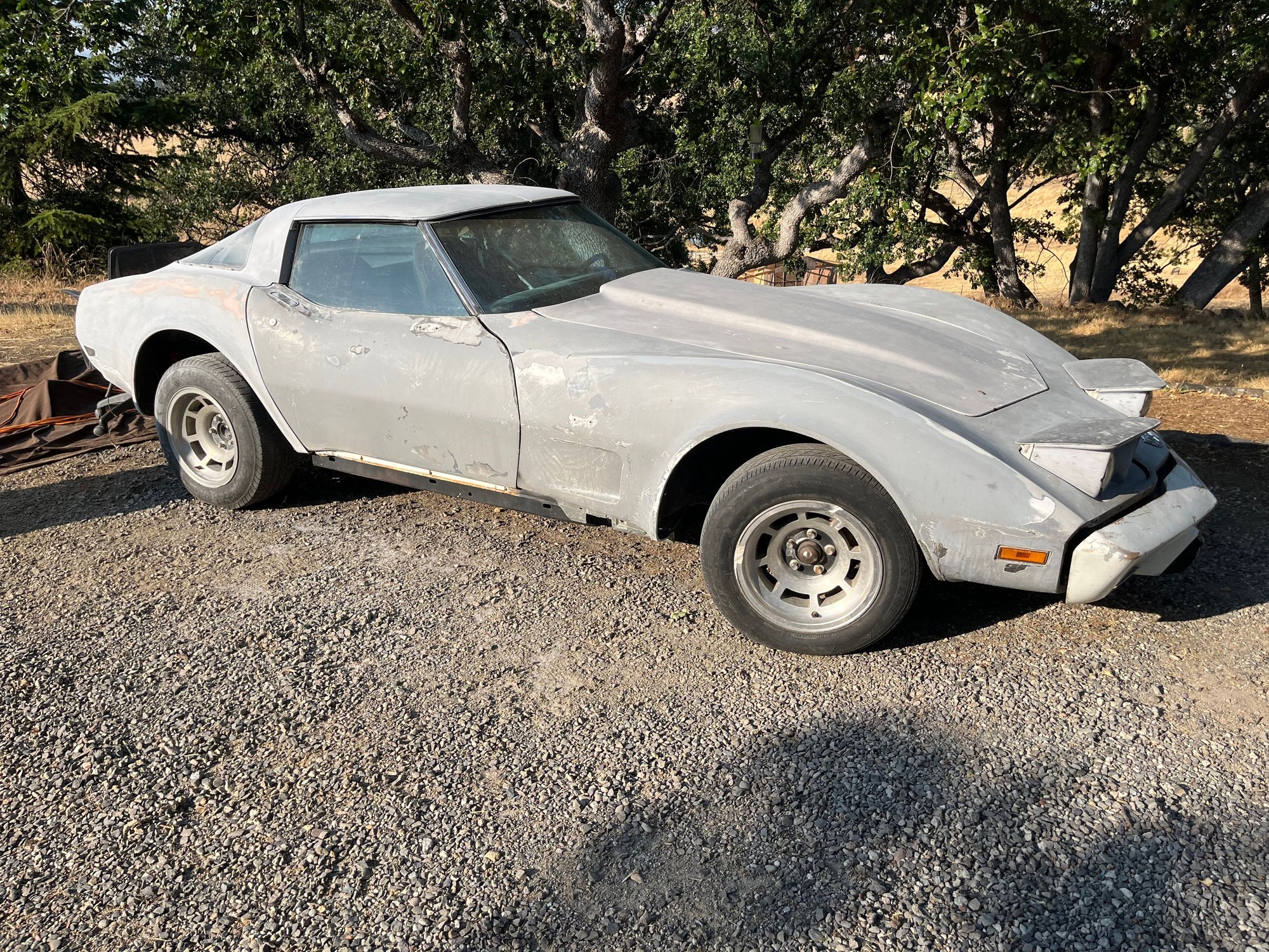

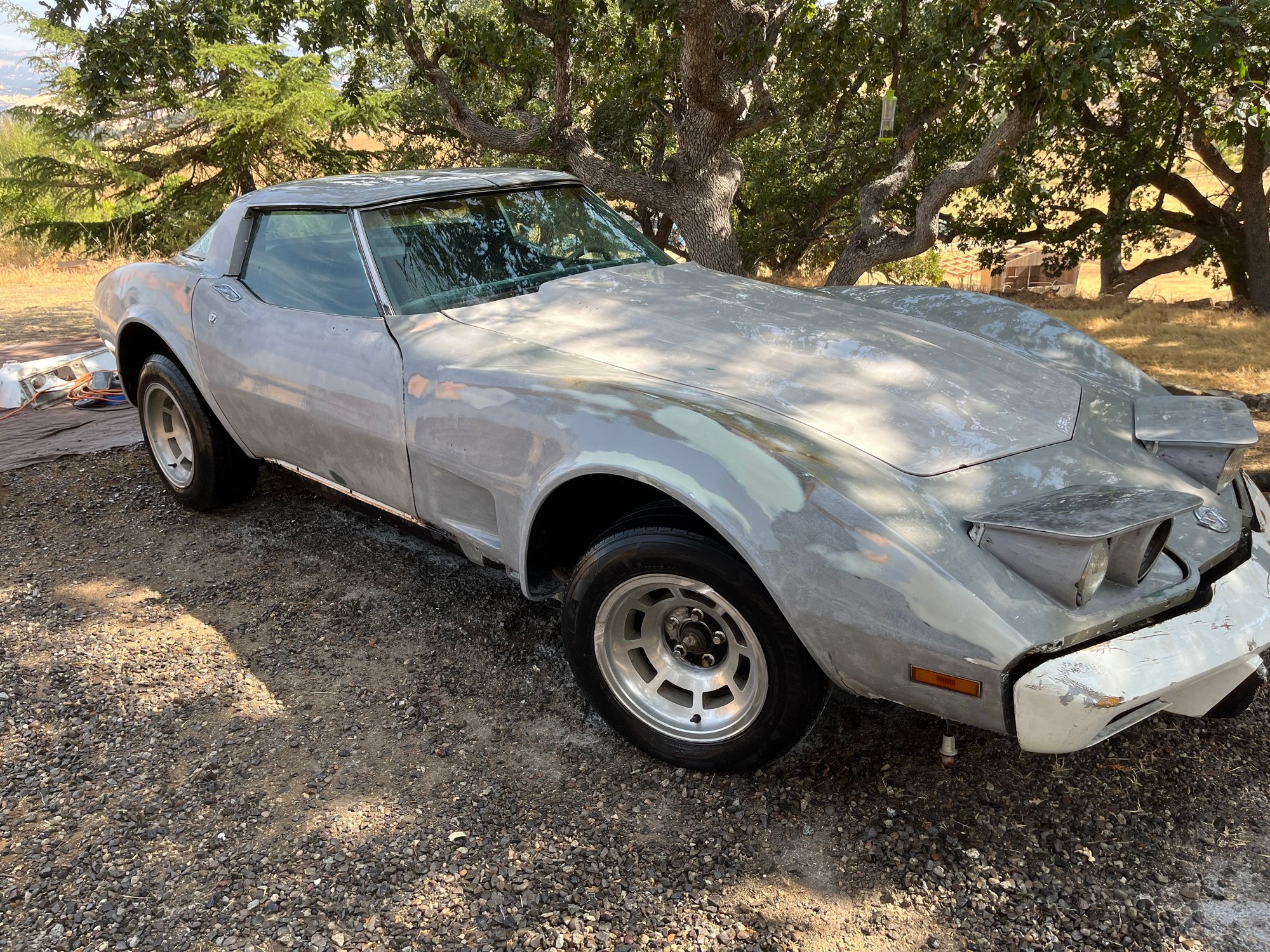

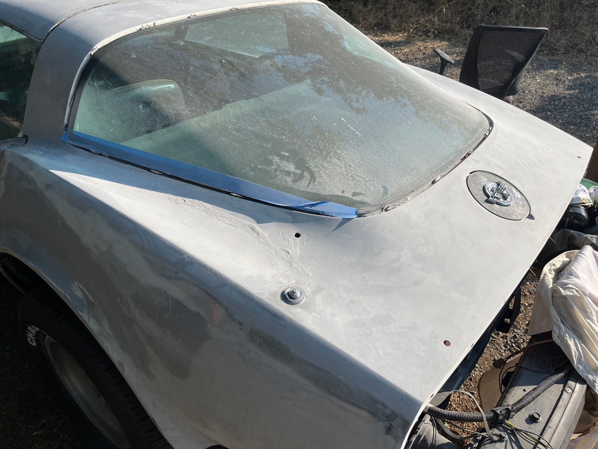

I realized that sanding the last of the old paint off would be the most satisfying milestone, something I’ve been wanting to get done for a long time.
The deck around the rear window & right rear fender look a lot better after several hours of 60 grit.
Passenger door & right front fender are all that’s left to do before I start on the door jams, front & rear bumpers, & a few minor fiberglas repairs.

Five hours & a 5 pack of 60 grit later, paint removal from body is done. It seemed like a bigger job than it was. Still to be done are the nose & rear pieces & door jams.
Before priming I’ll have to remove the antenna, door locks & handles to prep those areas. I’ll go over the car again with 150 grit, then keep it wiped down with acetone & covered until it’s time to prime.

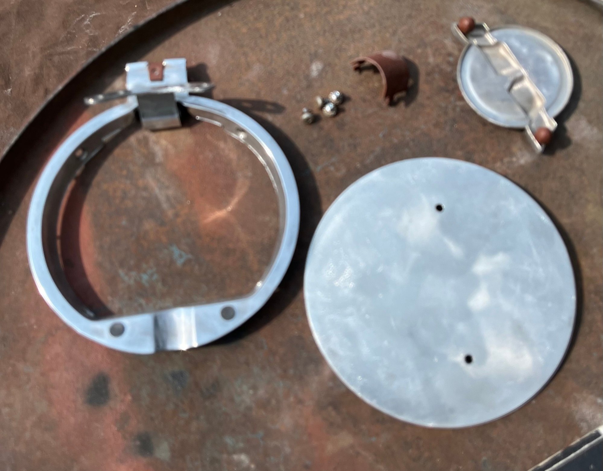

Disassembled & wire brushed the gas cap cover, painted the rusty parts with metal primer

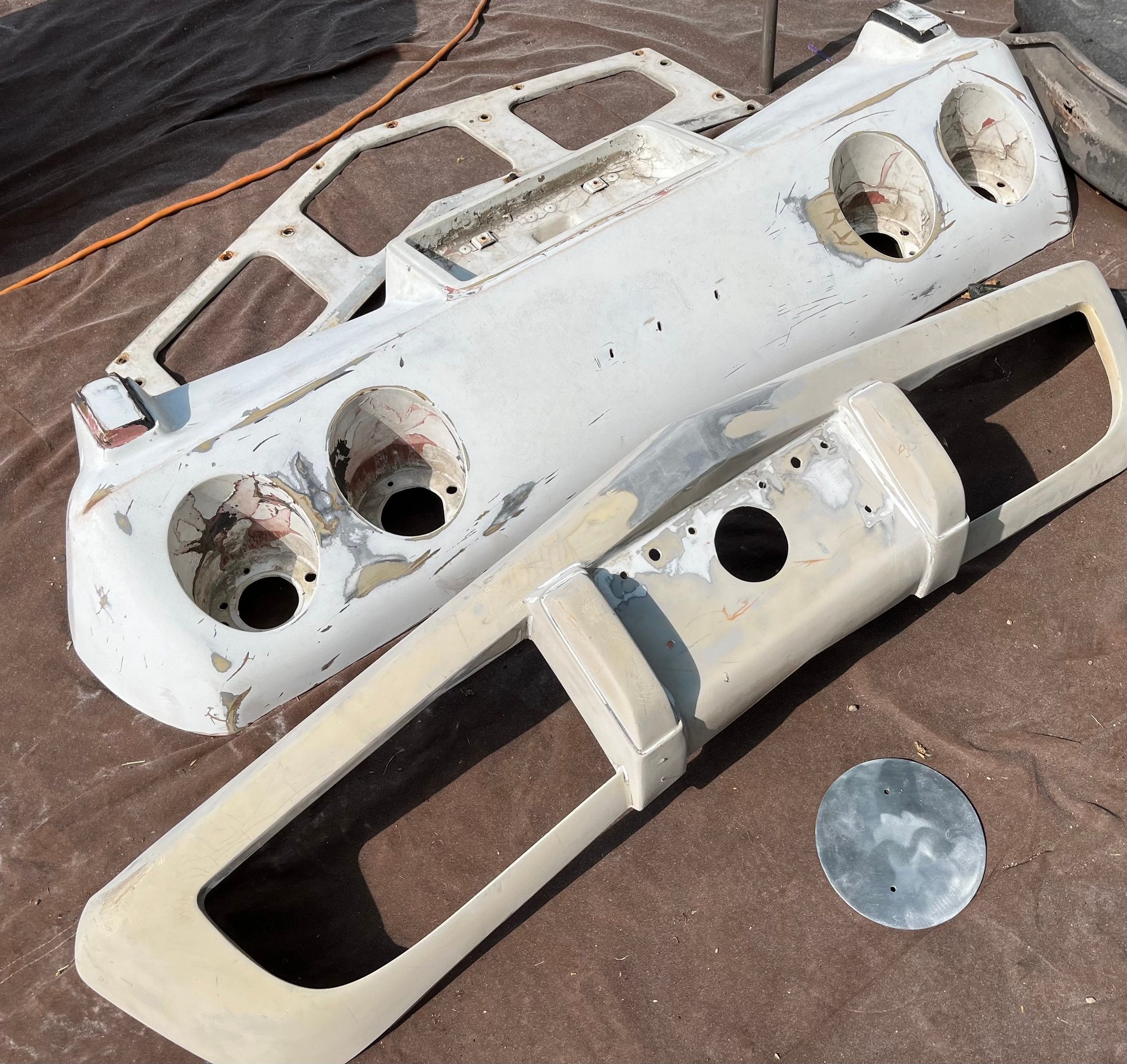

It took several hours with a pack of 150 grit & a vibrating sander to remove the paint off of the plastic nose piece. Tomorrow I’ll tackle the rear cover & get the rest of the small pieces ready for primer.

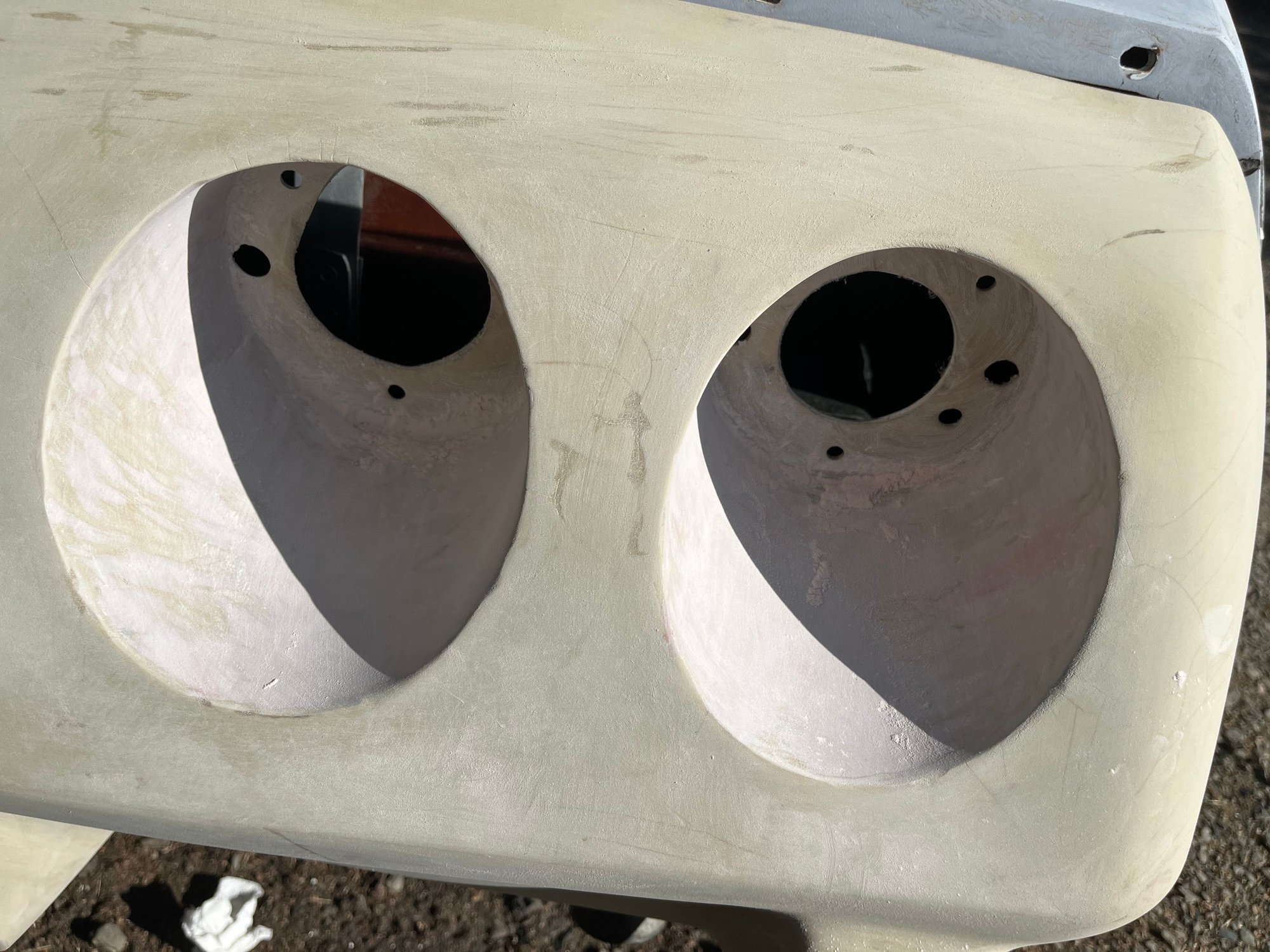

Before sanding, the front bumper cover looked pretty bad, with deep cracks in the paint all the way down to the plastic.

Rear bumper cover took all day to sand down to bare plastic. I used a wire brush on a drill to strip the paint out of the recessed tail lights.

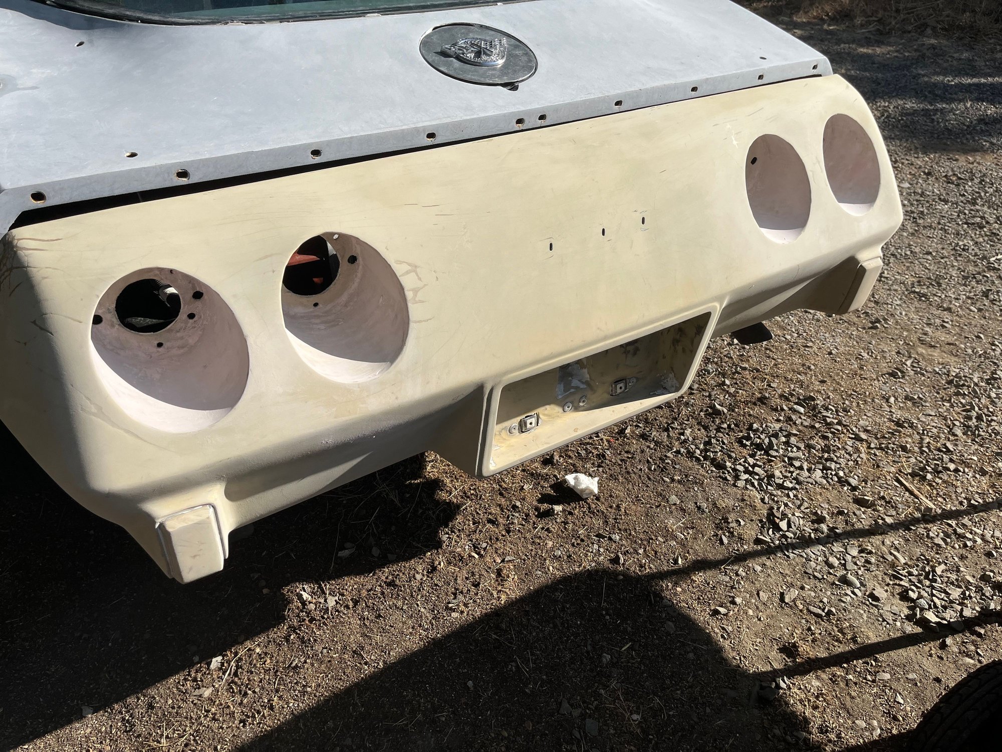

Cracks & unevenness in the bumper covers gets fixed with Bondo.
Sanding the tail light recesses was impossible so I used a wire brush on a drill to remove layers of paint.
Unevenness in the plastic caused by the wire brush took Bondo & hours of hand sanding to smooth out.
Front cover needs another Bondo & sanding session before priming.

Will Bondo hold on those flexible bumper covers?
Yep, that’s the question…🤔
I figured that since the surface cracks looked so bad, I had no choice & nothing to lose. Worst case scenario, if I screwed up, I’d have to buy new ones. 😱
I’ve been flexing & vibrating both covers a lot while sanding them the past two days & so far none of the Bondo has let go.
Once they’re bolted onto the car, there will be a lot less movement. Several layers of paint will help with adhesion too.
This is what the front cover looked like when I started. Pretty ugly...
The rear cover was even more challenging with the recessed taillights. It was impossible to hand-sand the layers of paint so I used a wire brush on a drill.
I tried to be careful, but still wound up gouging the plastic. I used Bondo to smooth out cracks & unevenness thinking that it would be easier to hand-sand Bondo in the recessed taillights.
It is, but still a chore using 150 grit. I’m working on it some more today & will post photos when it’s finished.
At this point they’re looking good. I’m thinking this is going to work out. Definitely worth a try.

It’s not a question of adhesion of Bondo. Bondo cures rigid-zero flex. So it will likely crack in short order. There are many flexible bumper sand able filler options out there, why not use one of those?

I bet there are a lot of used fiberglass bumpers for sale out there, too. They always need work, even when new, but they won't crack until you hit something.

Thanks for valued input guys. Having progressed beyond the point of no return at this point, I’m committed to following through using what I’ve got to work with & what I’ve already started.
So far so good…will let y’all know how it works out!
