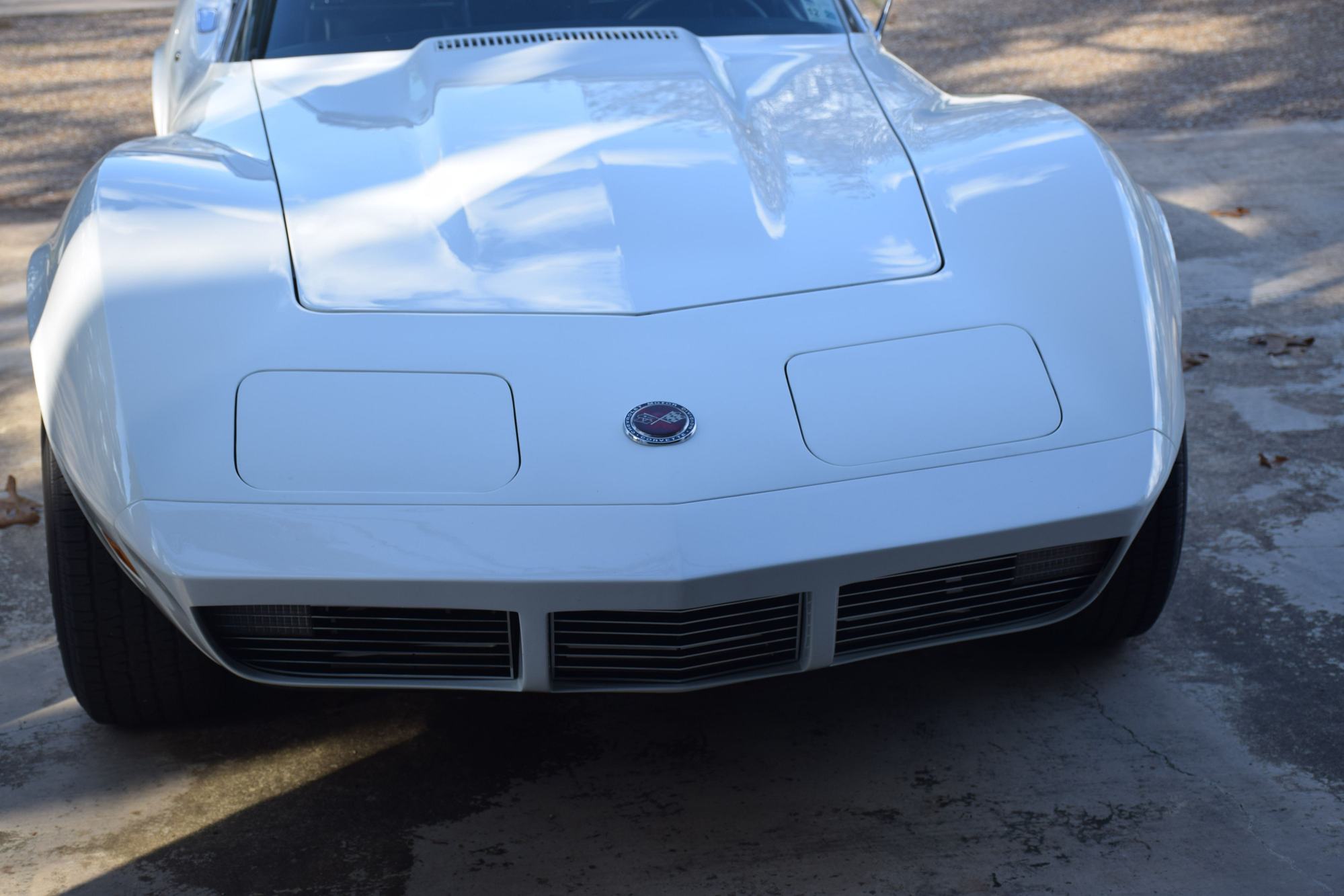

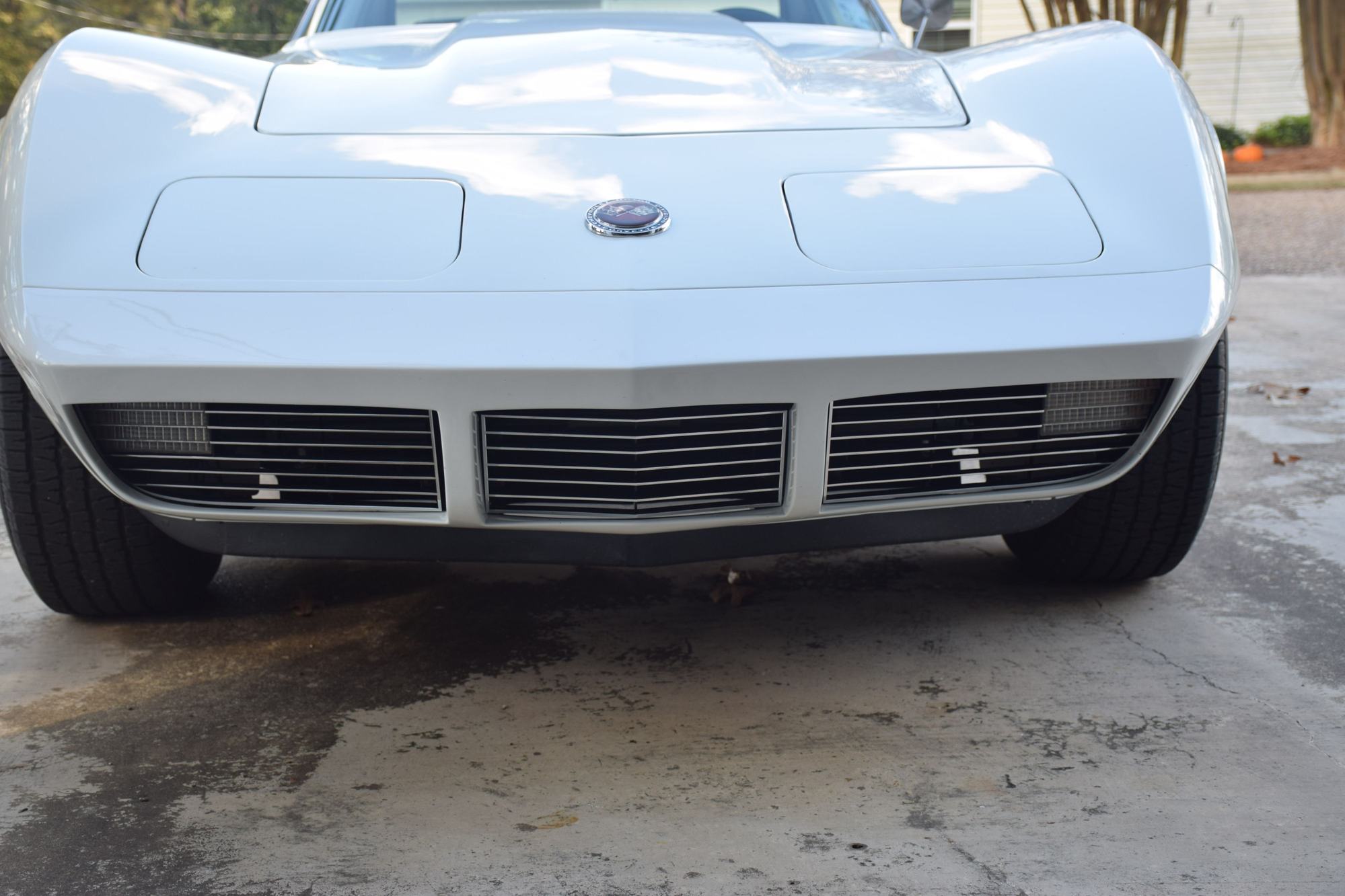

I replaced my wife's 73 with TRU-FLEX and as mentioned above, you have to fit to the body. This has been on for about 7 years and I haven't had any waves on mine.

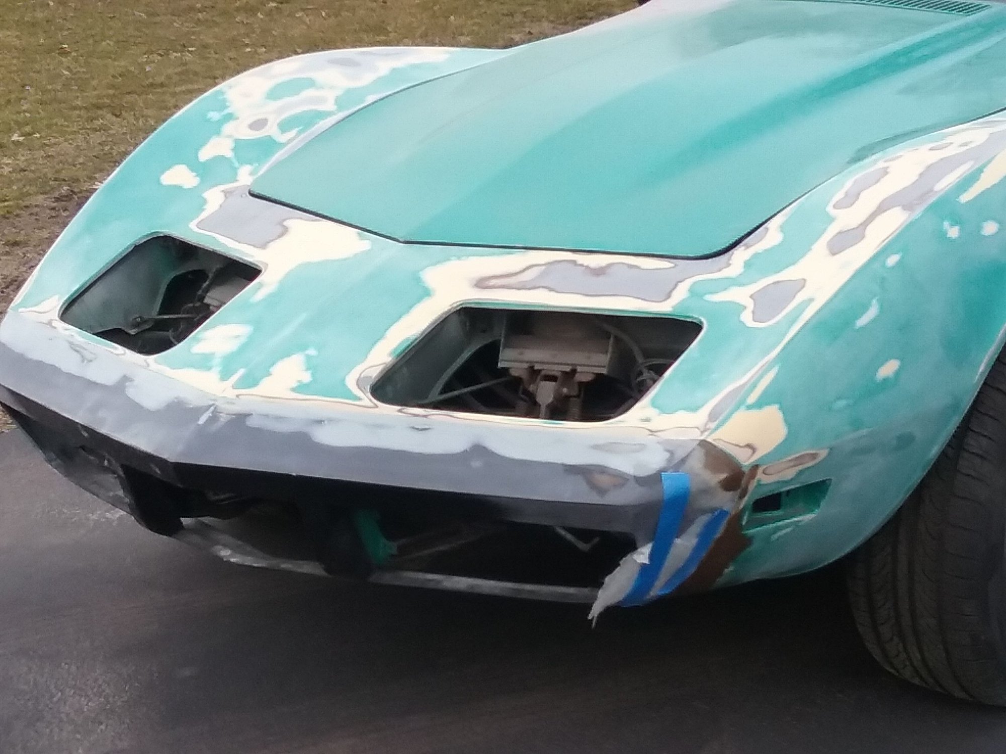

That was a very nice summary. Pretty much hits all the points. I have a replacement urethane up front on mine. Not too many waves, mine is pretty flat. I am happy with mine. Takes a lot to fit. Don't think by going urethane it'll be an easy slap-on and go fit. Even a urethane one isn't flexible enough to fit 100% perfect on the edges. You'll probably still need to install the bumper, then sculpt bondo (on the front fenders) to match the curve of the new urethane bumper. If you're lucky, a new urethane bumper will fit 85% good on the edges and be 'good enough' w/o extra bodywork and paint work on the fenders.
One thing to note is, if a driver has a minor infraction with a fiberglass front bumper (flex or solid), it can potentially lead to somewhat greater downstream damage to the front surround and fenders moreso than a urethane bumper cover might. Depends on the circumstances.
I would avoid the temptation to 'glass-in' a fiberglass front bumper to the upper surround. I know you didn't ask that question, but a lot of guys consider it, try it and it inevitably the seems crack given enough time. Just throwing it out there....
