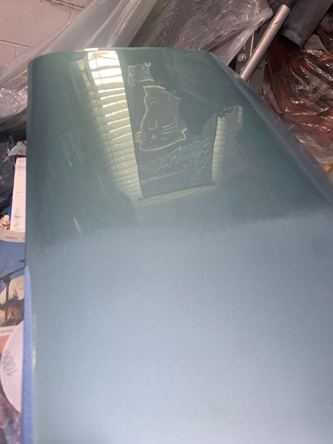

Wet sanding, buffing, and polishing hood. Front clip next. Cheers!

Sorry. Had to wipe off my lense. Guess I had too many.
wipe off my lense.
Old Jun 23, 2023 | 09:14 AM
  #164
BigBlock77's Avatar
BigBlock77
Joined: Jul 2007
Posts: 200
Likes: 87
From: College Station Texas
What an amazing job! the clarity in that reflection says it all. Great work!!!

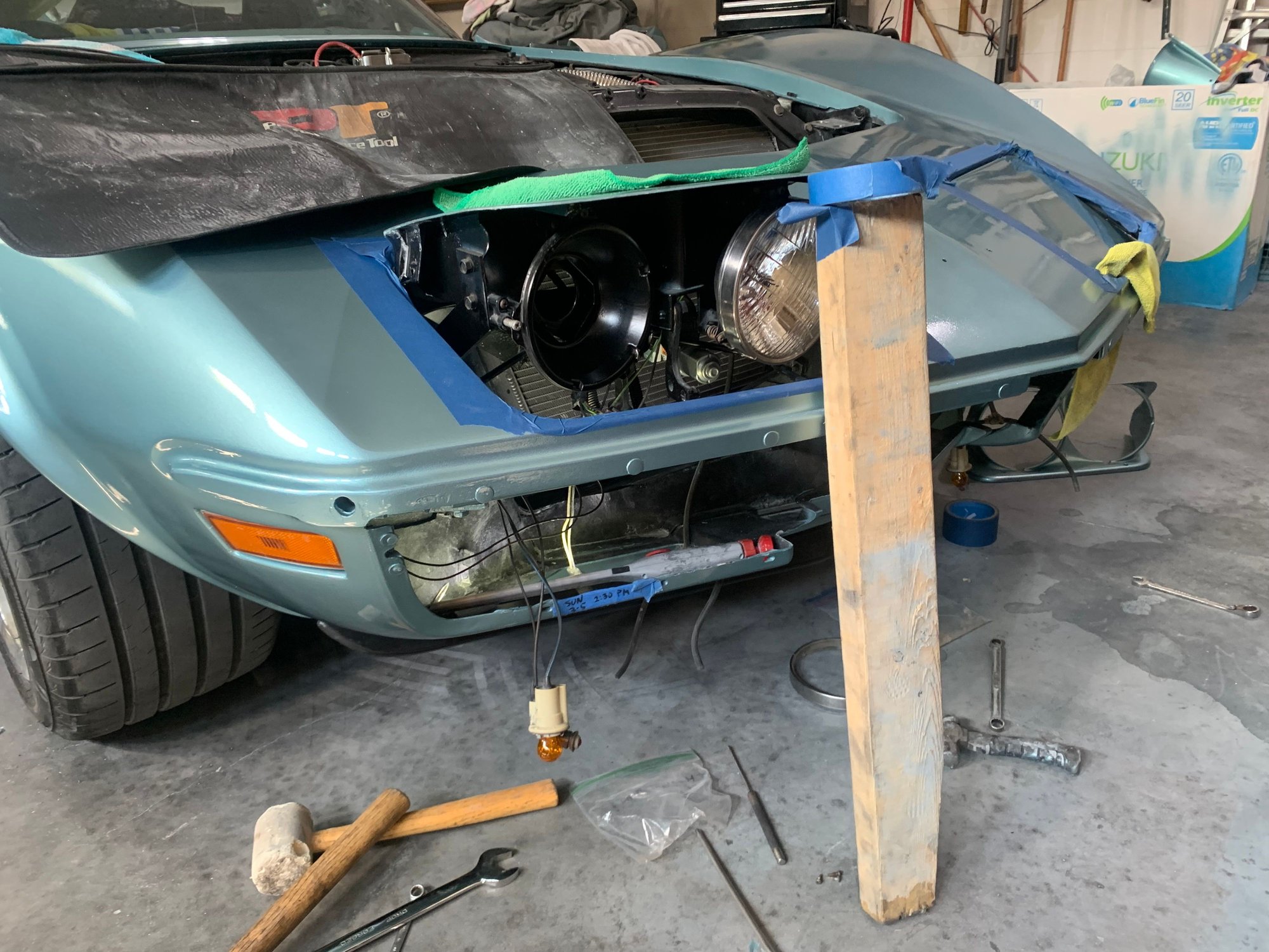

Getting the headlights back in. Not fun and trying to not scratch the new paint. For some reason every time I turn the on the fuse blows. Didn’t do that when I pulled them out.

got the headlights on without too much issue. Spent hours hunting down an electrical short. Turns out I pinched off some wires installing the driver side headlight bucket and had to mend them. All good now then started wet sanding the front clip. Got a head light buffed to see if I could get away with just a 1500 grit sand. Looks like it might work with my compound.

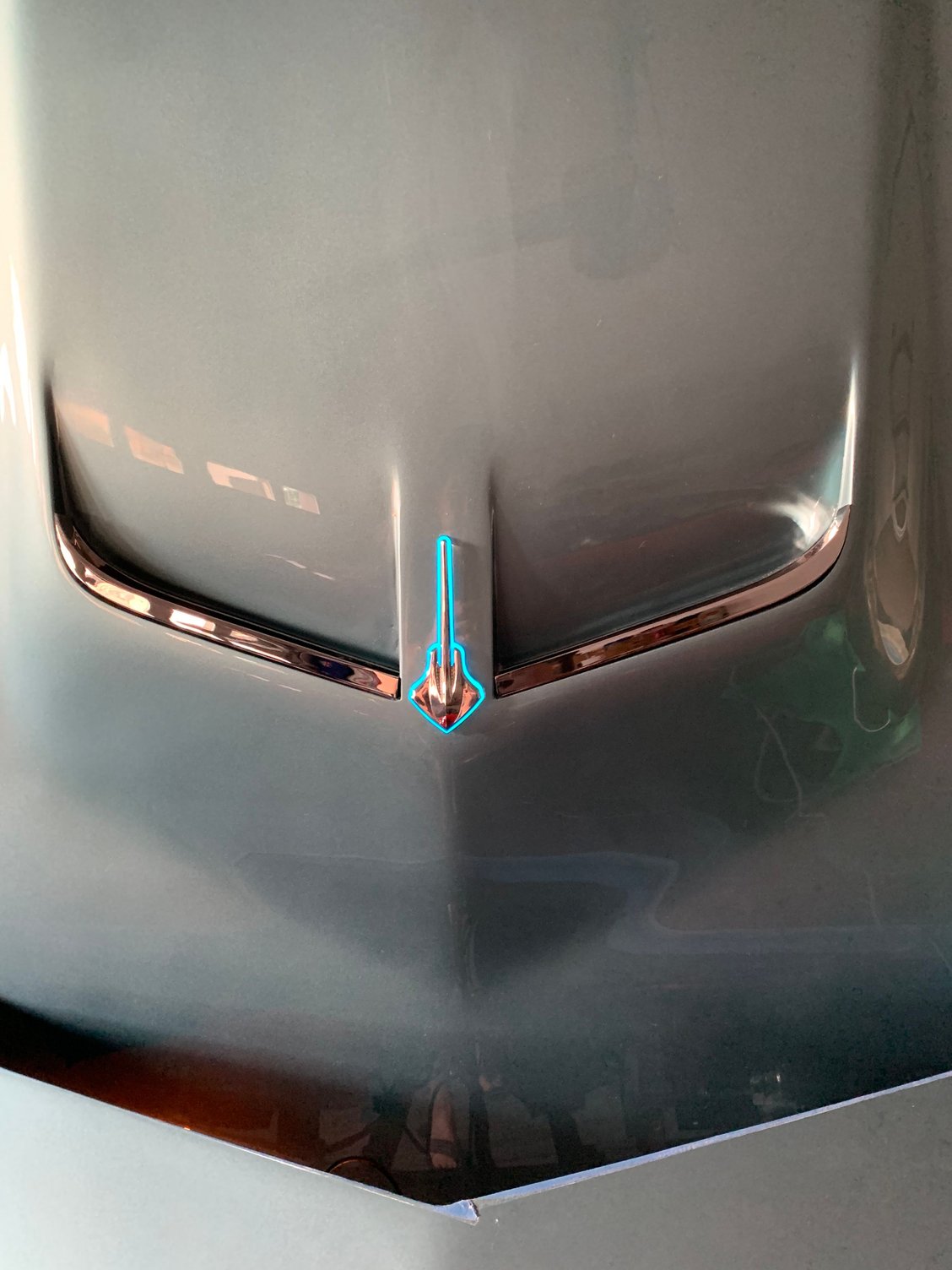

Toggle activated engine leds for night shows I plan on doing.

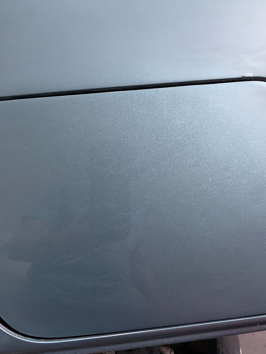

Wet sanding and polish journey. Straight shot of the rear deck here.
Rear deck for reference.

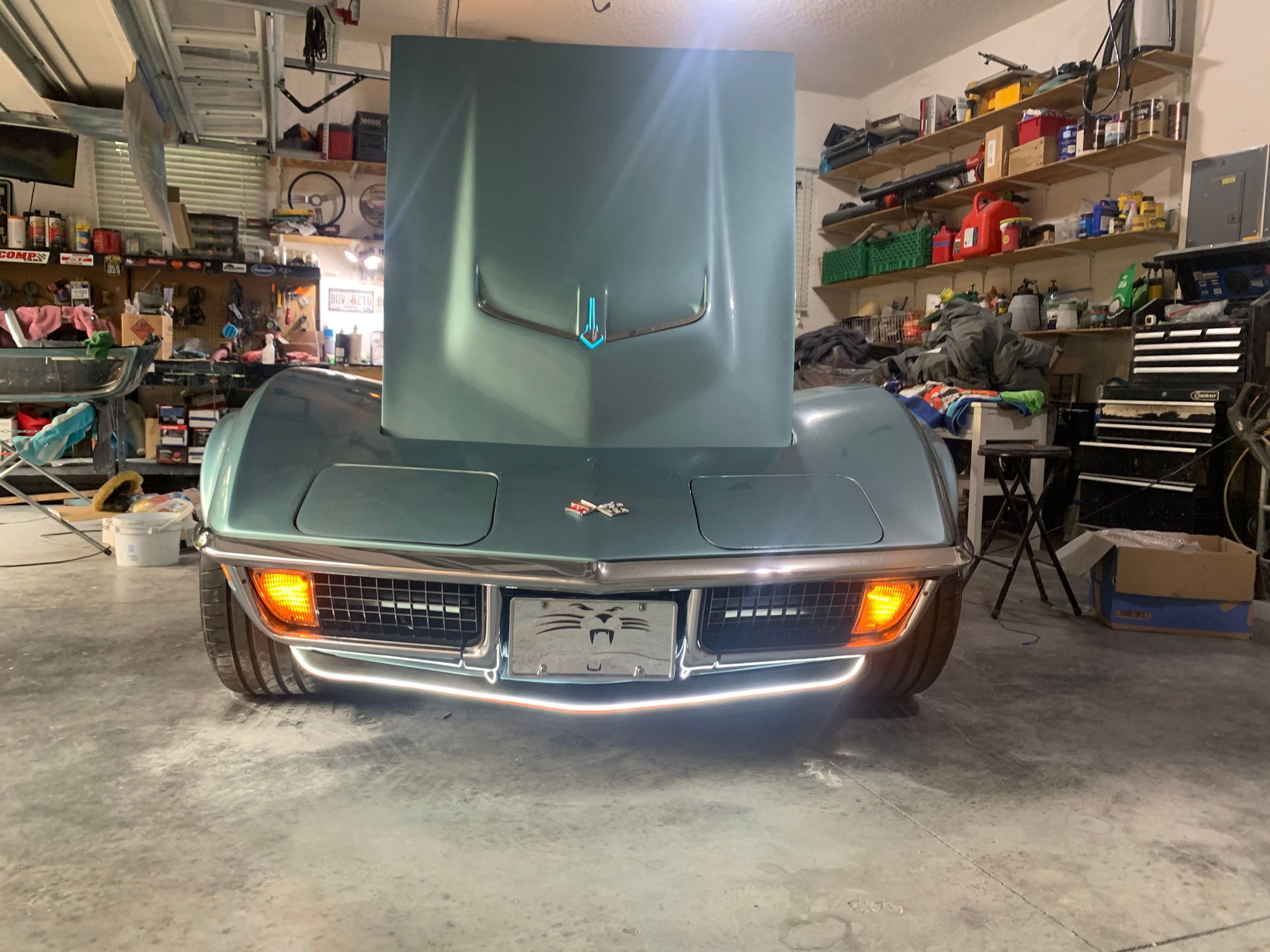

Putting the front end back together after wet sand and polishing the front clip. Those bumpers were a lot easier to remove. Lol
Lt1 hood upgrade with the led shark to match gas cap.
