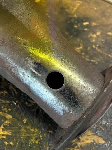

A nice FedEx delivery came today and I punched a hole in the collector for the O2 bung.

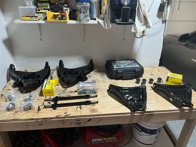

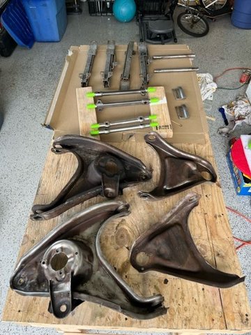

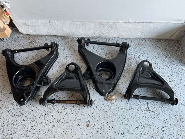

Control arms are cleaning up nicely but I still have more work to do.

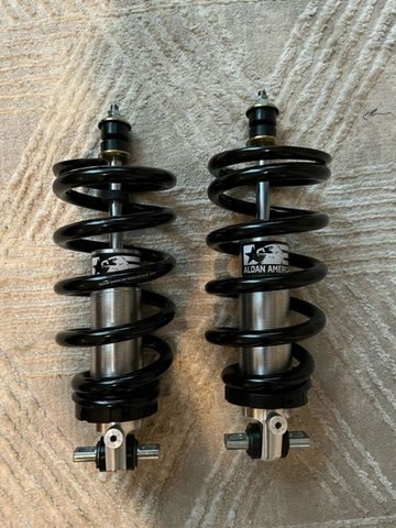

Went with the Aldan American semi coilovers for the front. 550# springs and likely a bit beefier sway bar to tighten up the front even more.

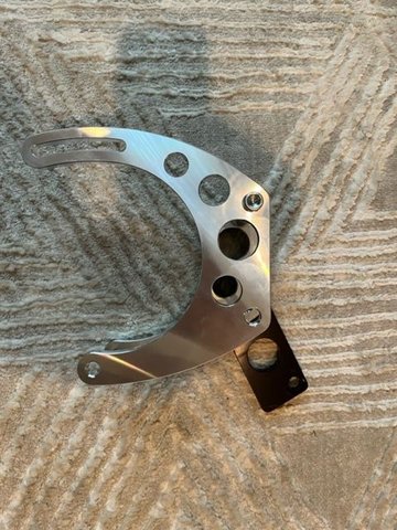

Finally found a passenger side alternator bracket on eBay I THINK i can get to clear the control arms. Initial mock fitting happened after the control arms were already removed but I may have to clearance the slightest amount off the bottom on of the bracket to clear.

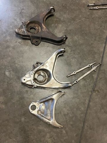

POR15 has been applied

Several months later....new bushings pressed in.

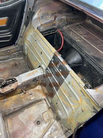

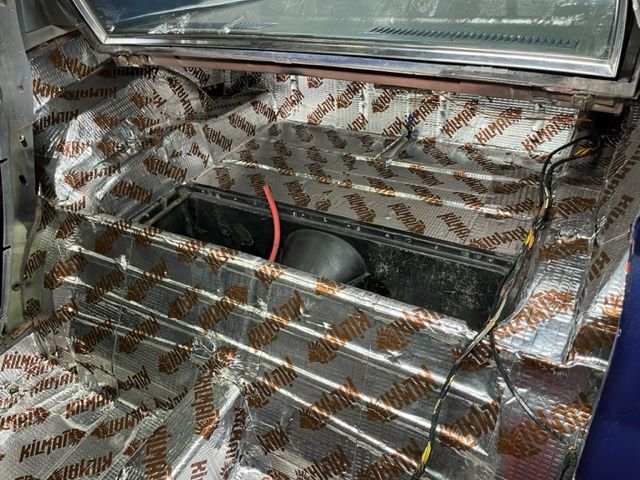

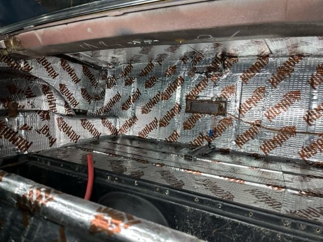

Got the Killmat laid down....took about 6 hours not counting any interior removal and prep. Adding a second layer of Thermotec Supressor mat too on all the main areas. The Killmat stuff is nice for the price and geared towards sound reduction. This Thermotec stuff is much more robust and aimed at heat insulation.
Also, checked out the aluminum body mounts and determined they are good enough for the girls I date so thankfully not touching those.

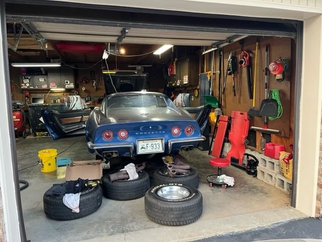

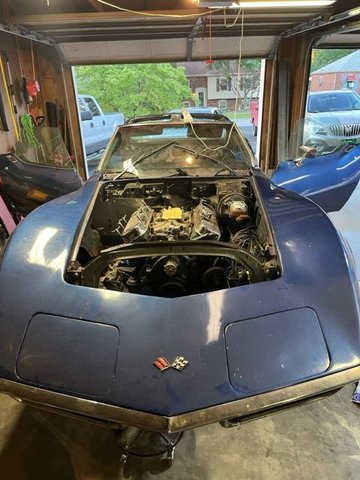

Hood is off!

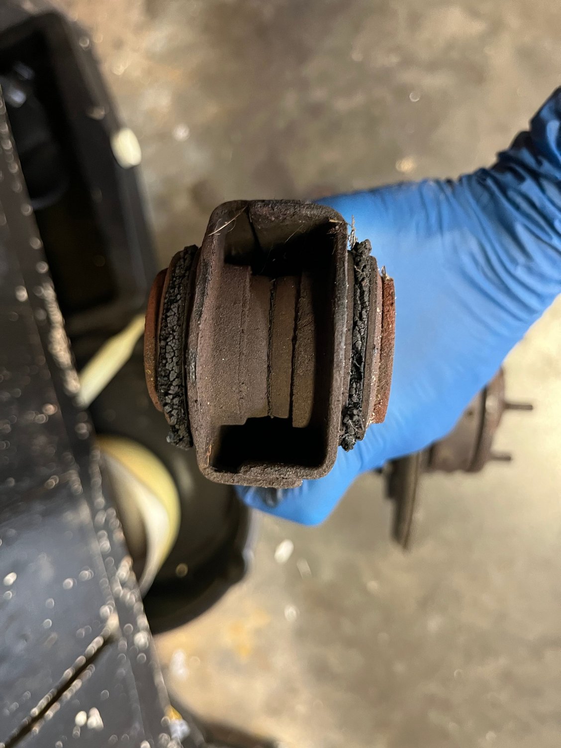

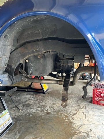

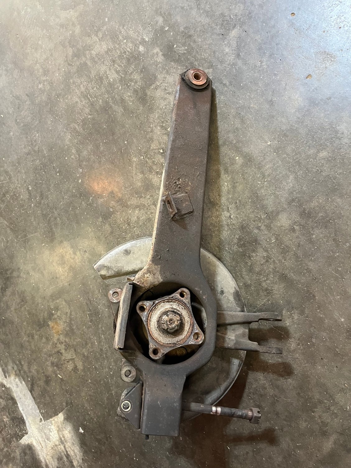

Pulled the trailing arms to make room for my rebuilt units from Top Flight Automotive. I am blessed at the lack of appreciable rust on this car.
Several items purchased over the 20% off holiday weekend and found adjustable strut rods with rubber bushings for $108 shipped. Nice.

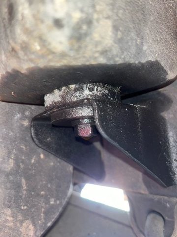

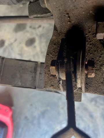

Take a look at the previous shady tree work on the sway bar bushing or lack thereof...just add a thick washer!

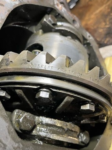

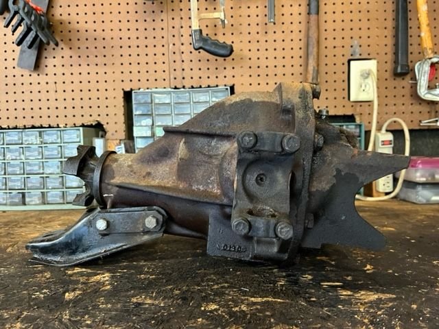

Got into the differential and thanks to the incredibly detailed information on here I'm blueprinting the diff; first time in a differential. The rest of the car is going on pause while I rebuild this.
Check out its dedicated thread here:
https://www.corvetteforum.com/forums...ld-thread.html

Much of the rear suspension has to be unbolted and likely the exhaust dropped. Not the end of the world but some of the parts can be a bear depending on rust. Do some searching so you know what you’re getting into. That crossmember can really be stuck in place.

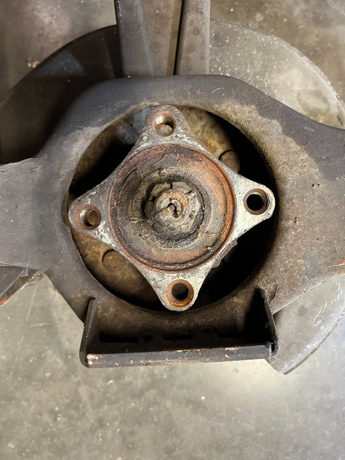

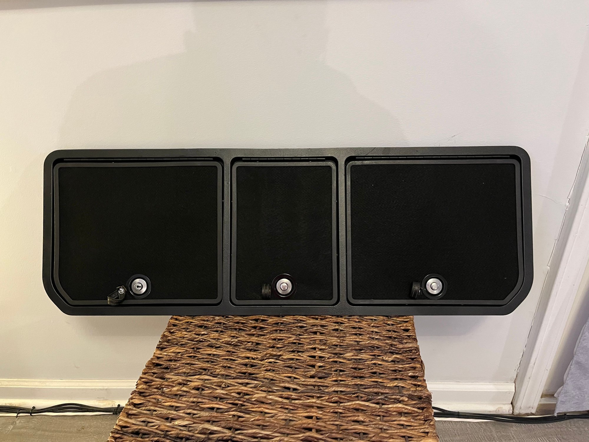

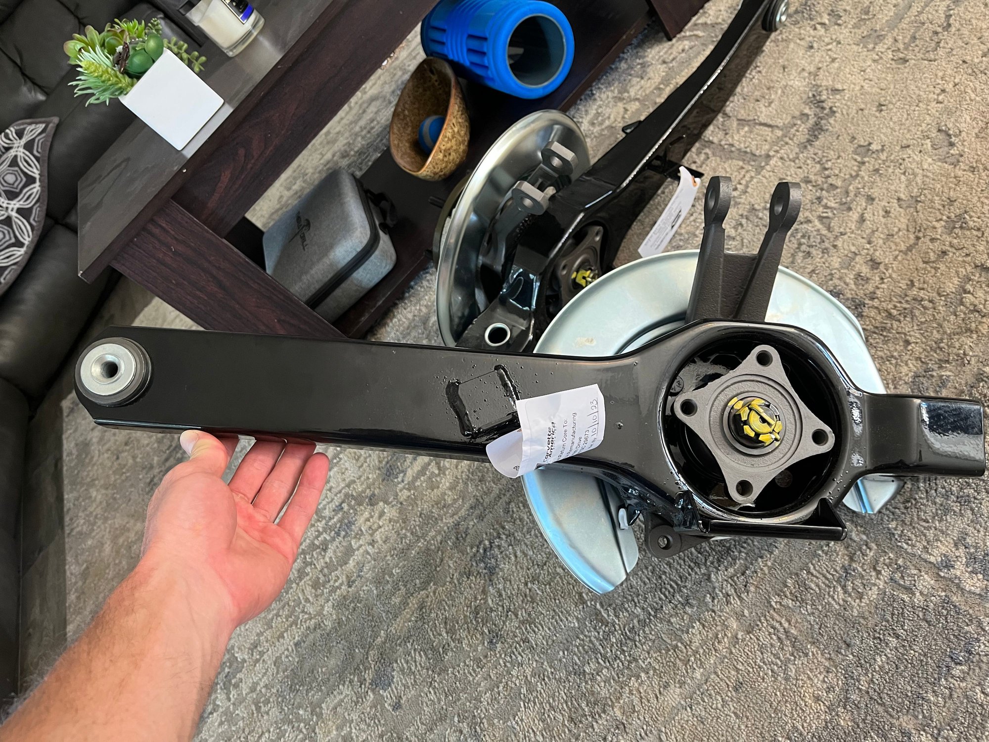

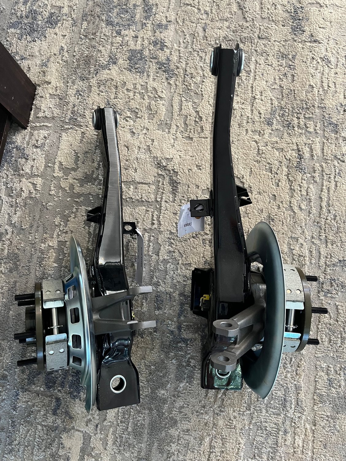

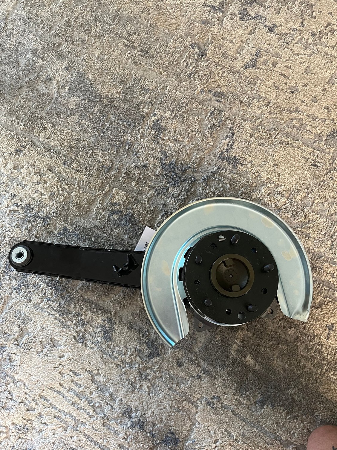

I finally completed the refinishing of the storage hatch. Wish I would have documented the process.
Also, new trailing arms arrived from Millikin’s Corvette Specialists!

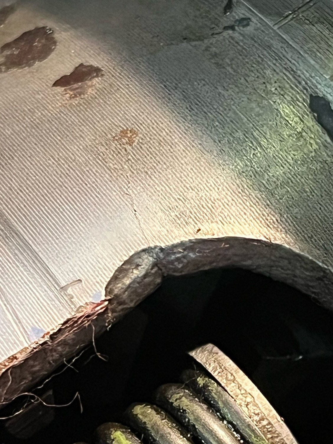

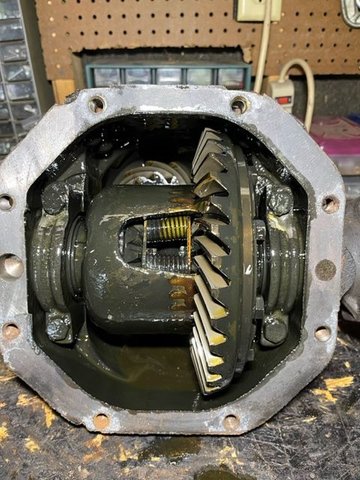

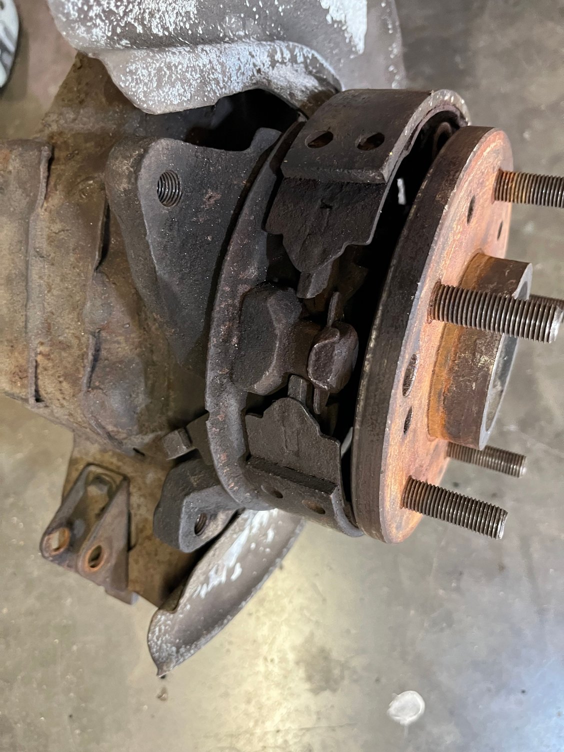

Got bad news on my differential build and have a cracked carrier.
But at least I had my main dude seriously helping in the garage today. Parts washer, sway bar remover and engine stand builder!
