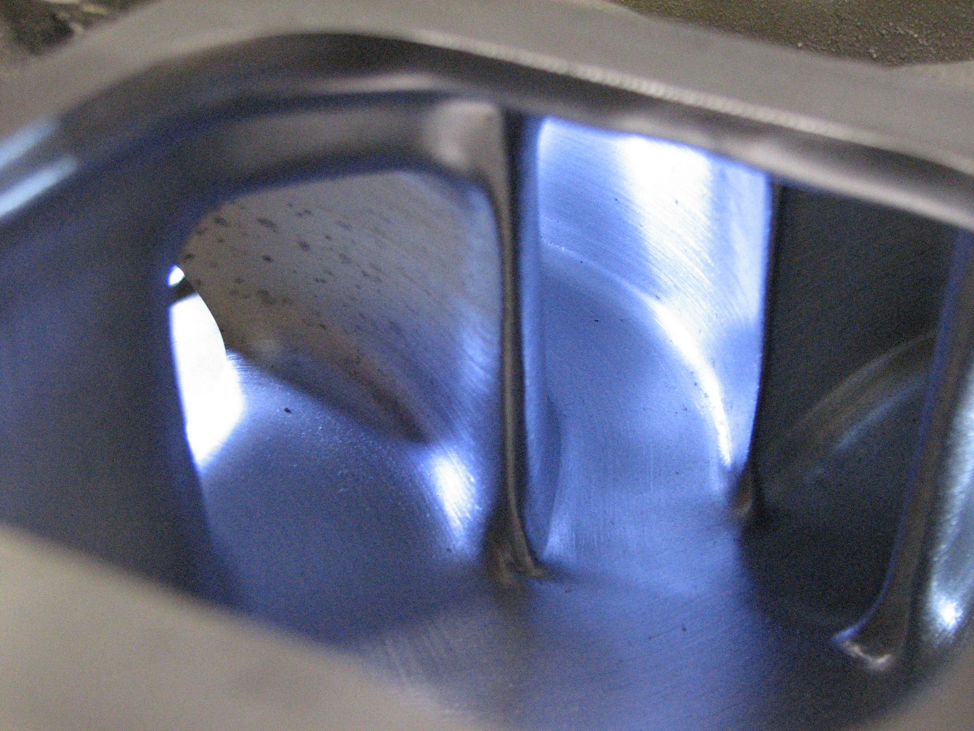

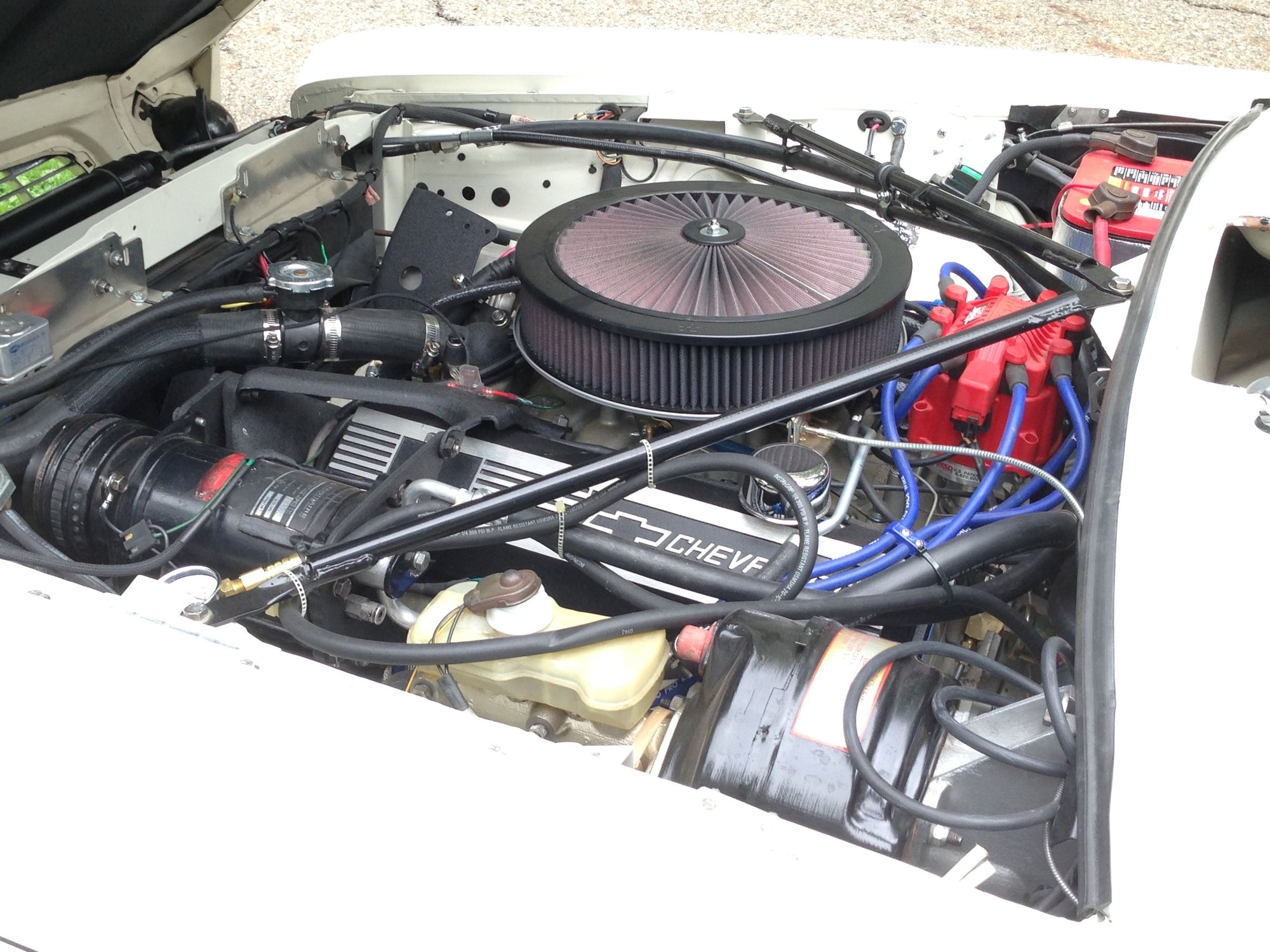

Default Trashing the Torker II - Don't
I've got a Torker on a 462 BBC in a 4200# '77 XJ12L. Short story is it works. The low manifold profile and a '69 Corvette drop base air cleaner solved my hood clearance issues. A lot comes into play: Engine Dyno Tune, Roller cam, roller rockers, ported iron heads, 750 double pumper, 1/2" carb spacer (wish I had room for a 1" spacer), 700R4 with a 2.78 first and 2800 stall convertor with 3.54 gears. I can light the tires up at will. Throttle response is crisp at any RPM. 485 HP at 6250 RPM, 550 ft/lb of torque. I also sent the intake to Extrude Hone in Irwin, PA.
Gearing and torque converter slip keeps the engine in the power band of the cam and manifold.
Enjoy your build process!!!
Extrude Hone of intake passages
Installed Torker
'69 Corvette drop base and K & N Filter

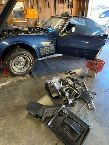

Spent the weekend in the woods so not much time to wrench but I did manage to replace the missing drivers side door spring. Now my door stays open! Here's the rig we devised to hold the weight of the door while removing. Redneck ingenuity at its finest!
