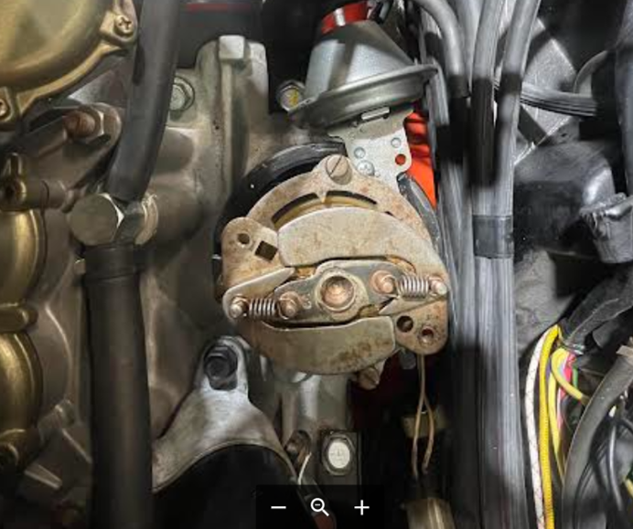

the advance weight are tighten...they can not move with the rotation.
But they most certainly need to move…..the rotor needs to be able turn some and the springs pull it back….
Jebby
what springs are you using?
Can you get a Mr. Gasket 928G spring kit?

Can you take a picture inside your distributor showing your springs? Sometimes the weights are put in backwards, and that leads to other problems.
I'm guessing English isn't your first language? That's fine, we are still here to help. When you say the springs are "tighten", does that mean they are too stiff? The spring wire is too thick, and it will not release the weights to advance at a reasonable RPM?
Sometimes distributors need to be rebuilt, or replaced (I did to one that was nearly stuck). Pictures help!
Feel free to post in French, too, if that helps get your point across. Sometimes specific terms don't quite translate.
good question. I don't know to be honest. yes, I ordered yesterday the ref you mention plus MSD 8464....i may find the right blend.
Use the two gold springs from the 928G and you probably should look at the advance stop bushing which requires distributor removal. If the bushing is missing or cracked replace it with the bushing in the 928g kit. Do not use the weights in the 928g kit.
indeed....I'm french.. Springs seem to be too loose...need probably to shift for others (ordered Mr G 928G & MSD 8464). for the time being, weights are "attached" and limit the centrifugal advance. and honestly, the engine is working well....of course with less hp but this will be tackled later on, once springs replaced and potentially my distributor refreshed.
this is the pic of my distributor.
OK. will check.
