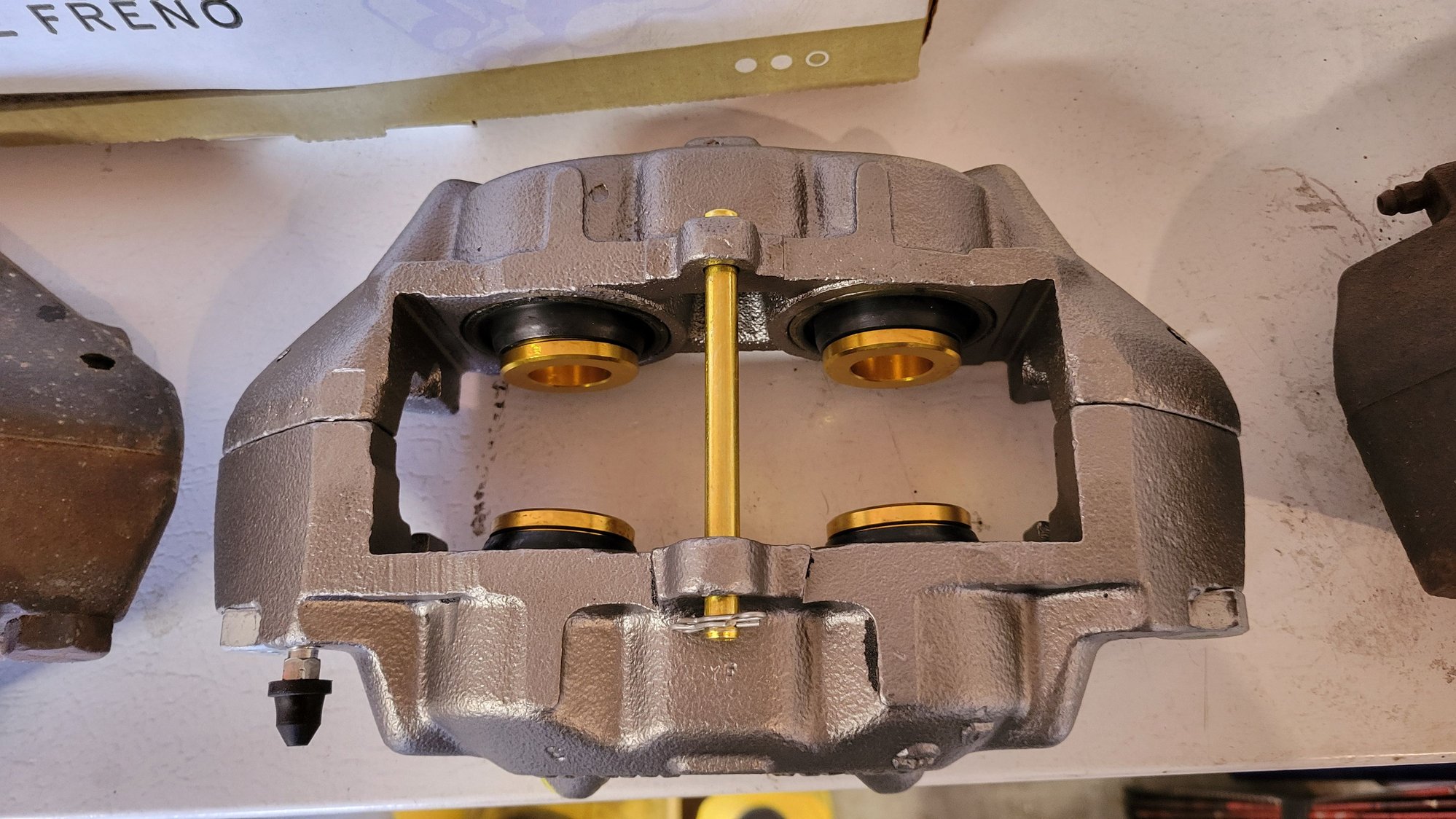

The calipers arrived the other day. This is a bit of unboxing. I ordered them from PartsGeek simply because I could get all 4 at once. They look good, but the real test will be if they leak, I guess. They won't get installed until I get the hardlines in.
One of the 4 came in the blue AC Delco box. The castings look the same.
They look good. The pistons move easily. I hear air moving in and out of the ports.
Hope they work.
Hope they work.
Used G2 Brake Caliper Paint. Plenty of paint in the can for all 4 calipers.
Turned out nice. I like the gold colored bits.

Old Dec 15, 2024 | 03:08 PM
Hope they work.
I'm quite optimistic for you. They look good and promise to be a massive improvement. Perhaps spray them with an anti-rust paint?
