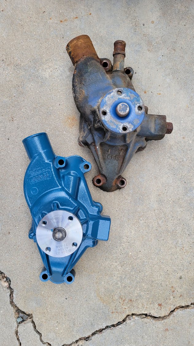

Old May 2, 2024 | 12:13 PM
  #107
MarkW68's Avatar
MarkW68
Joined: Nov 2023
Posts: 67
Likes: 40
Originally Posted by Jon Hekking
Very nice, I see a lot of my 79 L82 car with 17,000 miles in it. The one component I can't find is the original distributor shield, it was missing when I bought it.
I am going to replace the water pump, because it looked like it would be easier to replace the lower house if the pump is out. The existing pump is natural grey, I think. Should I paint it blue with this opportunity?
Old May 2, 2024 | 12:43 PM

Old May 2, 2024 | 01:31 PM
  #110
C3Highway's Avatar
C3Highway
Joined: Nov 2017
Posts: 319
Likes: 125
From: Midwest
It's a good idea to replace the water pump and radiator hoses as rubber deteriorates with age. The engines and water pumps were sprayed Corporate Blue at the factory from '77E thru '81, along with many other external engine components. Aluminum intake manifolds remained gray.
For what it's worth, when my harmonic balancer, timing chain and cover and water pump were replaced, they and much of the engine were painted the original color.
Old May 17, 2024 | 10:45 AM
  #111
MarkW68's Avatar
MarkW68
Joined: Nov 2023
Posts: 67
Likes: 40
This is the second try at the color. Close enough! It's better than the first try. Going to get on with it.
That'll work. I should get a new inlet...
