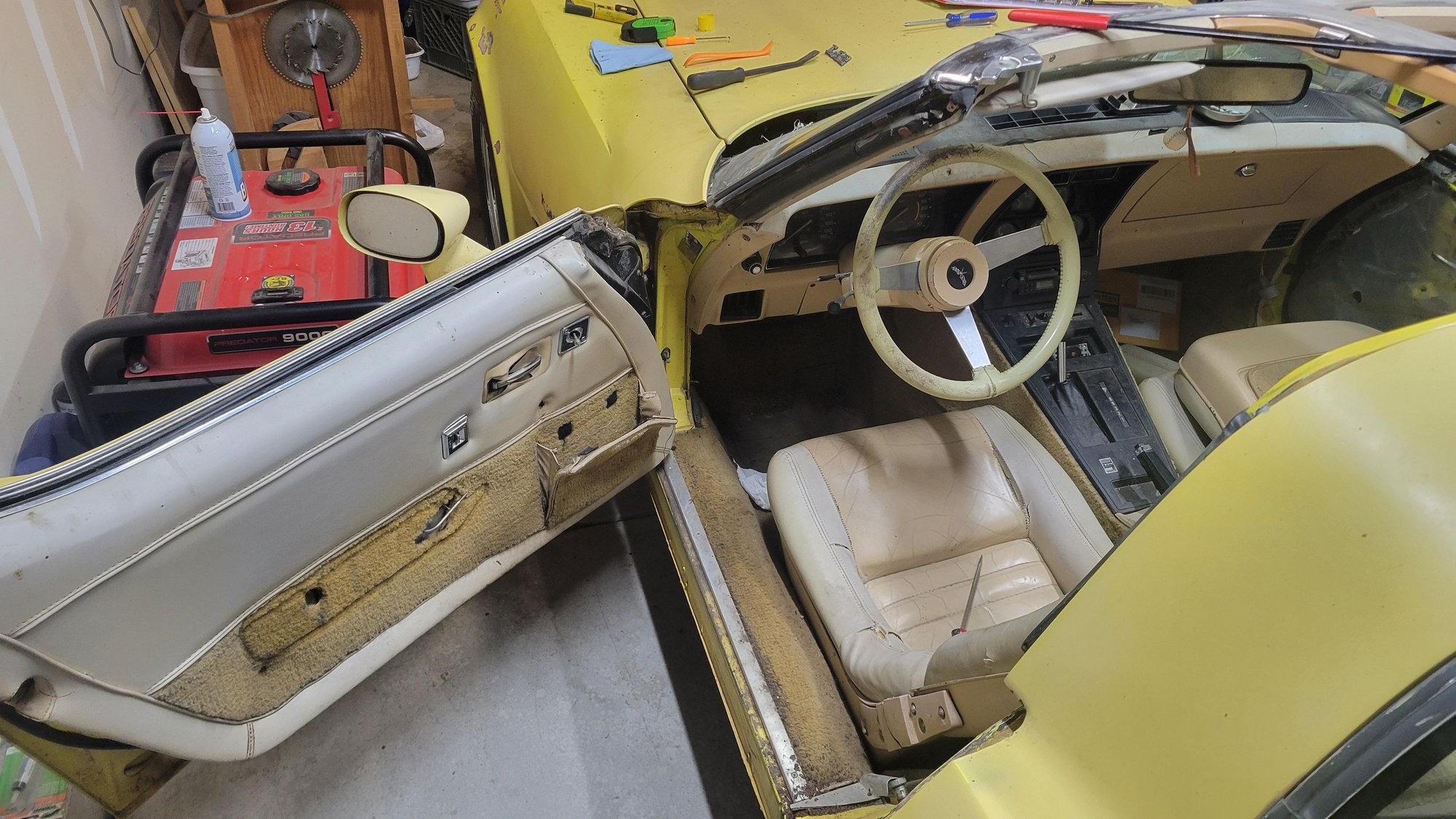

Since I finally have tires, decent steering and brakes, it is time to replace the windshield. The couple test drives have been either 'tank commander' style peeking through a cracked and taped windshield or with my head up above the roof. To do that I had to get the driver's side door to open so the glass guys could remove the windshield trims.
What the windshield looked like.
Finally opened the driver's side door.

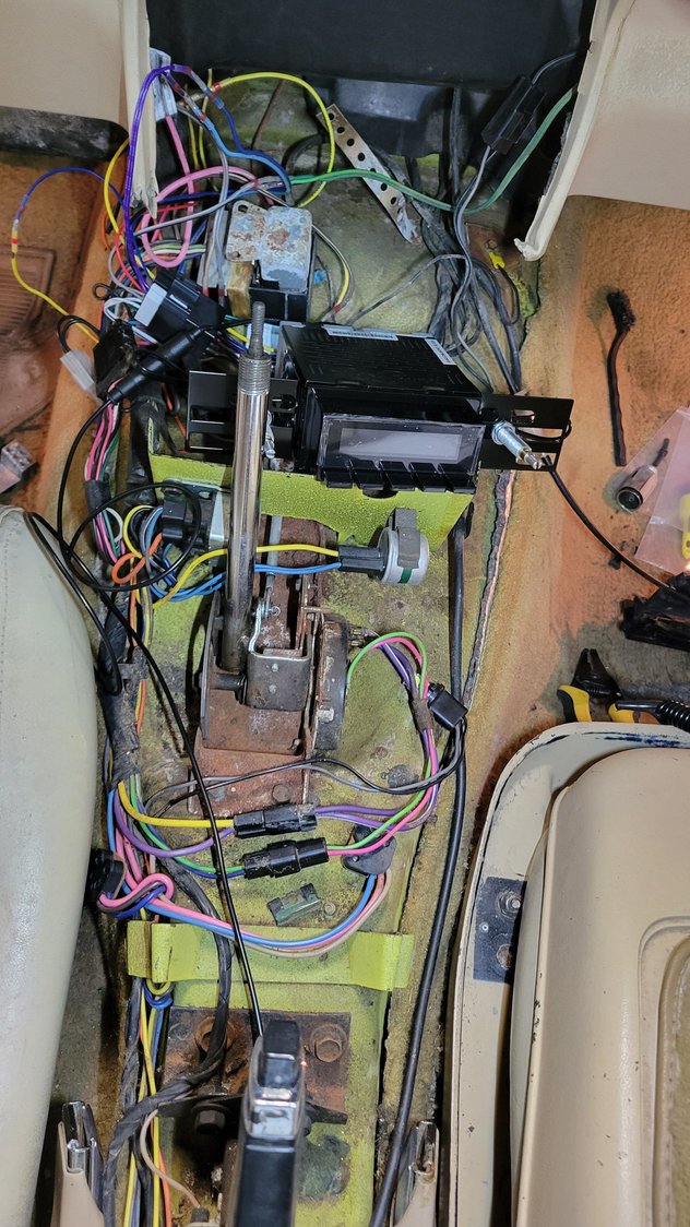

I started cleaning and fixing the center console. That lead me to learn that the left channel on the stereo didn't work, so I decided to replace the radio and power antenna. The antenna seems secure and my test wiring works. The antenna wires sort of plugged into the original plug seem sketchy at best, so I plan to cut the wires that go into the relay leaving tails. The tails will be long enough to reconnect if someone wants to in the future, and the relay will be left in place.
Aftermarket power antenna installed.
Yellow wire is signal. Orange is power.
Current state of the center console.

Power antenna is hooked up, and it works as it should. I left the original relay and the connectors in place. Maybe someone will want the original parts in place some day.
Red to orange power, blue continues to the radios signal wire, the thin black is the antenna extension wire.
Red to orange power, blue continues to the radio's signal wire, the thin black is the antenna extension wire.

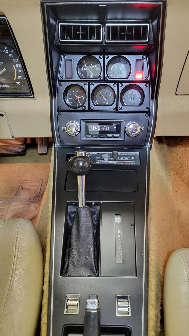

The center console is back together. All of the lights work, and a new stereo has been installed. It looks like it belongs. Unfortunately, the plastic is extremely fragile. The defrost switch broke when I was reassembling the console, and the passenger window switch snapped when I was testing it. I'm wondering how to fix that. JB weld? Epoxy? I'd like to be able to undo the screws in the future if needed.
Back together!
Back together!
