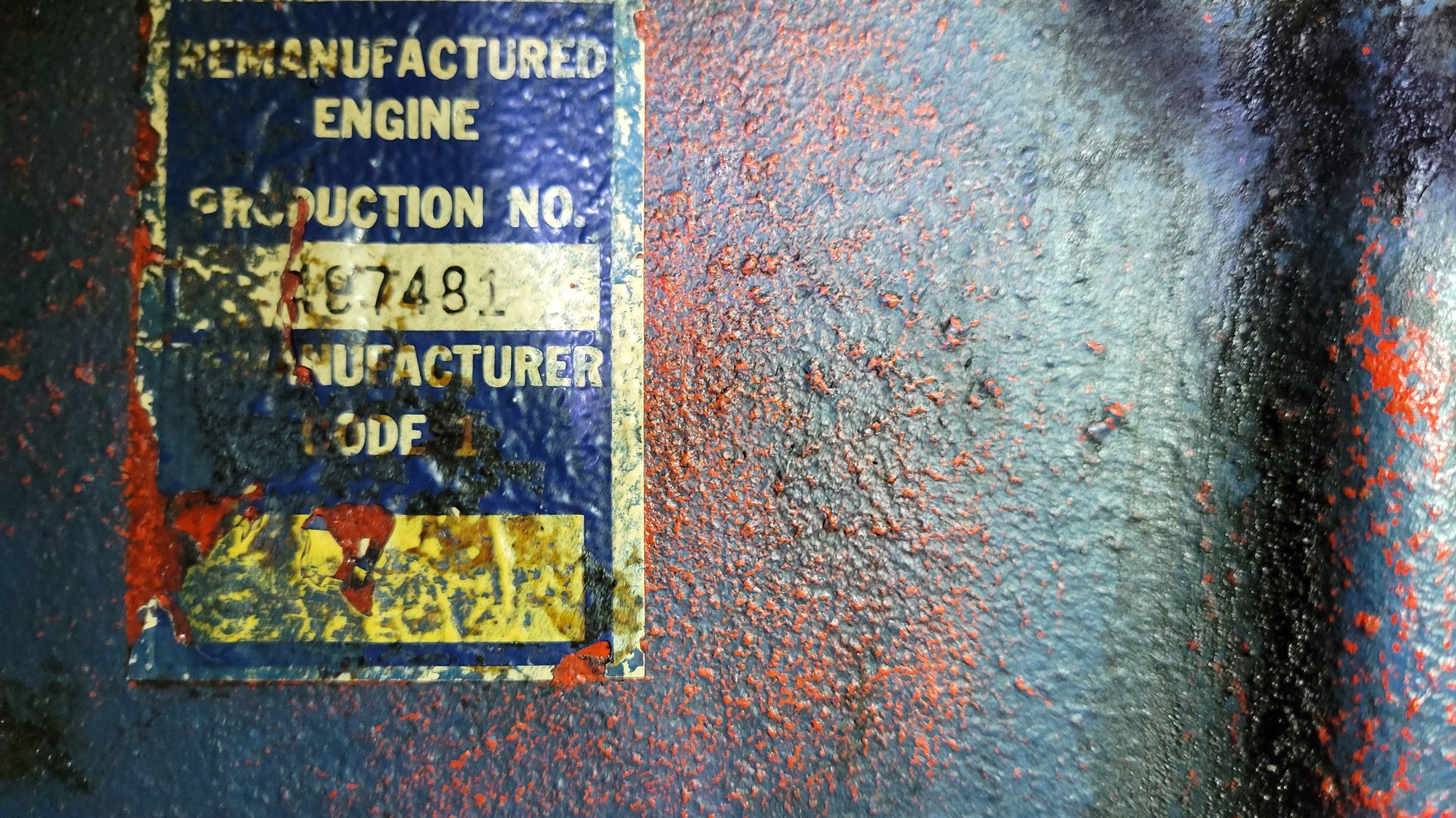

I found this today. Is this why it appears that the orange paint has been painted over with blue? And are there any suggestions for cleaning the oil/dirt build-up under the engine?
Found under the crud.
All C3 engines were painted Corporate Blue from the factory starting in very early '77 production thru '81 cars. '82 cars, I believe, had engines painted black from the factory. All C3 engines were painted orange prior to '77. You will need a good degreaser to remove the oil and grease gunk. My engine was a gunk mess when I bought the car, however, my classic car shop cleaned my engine and undercarriage up very nicely, so I don't know which degreaser they used. I have used various degreasers to clean up a multitude of components on my '79.

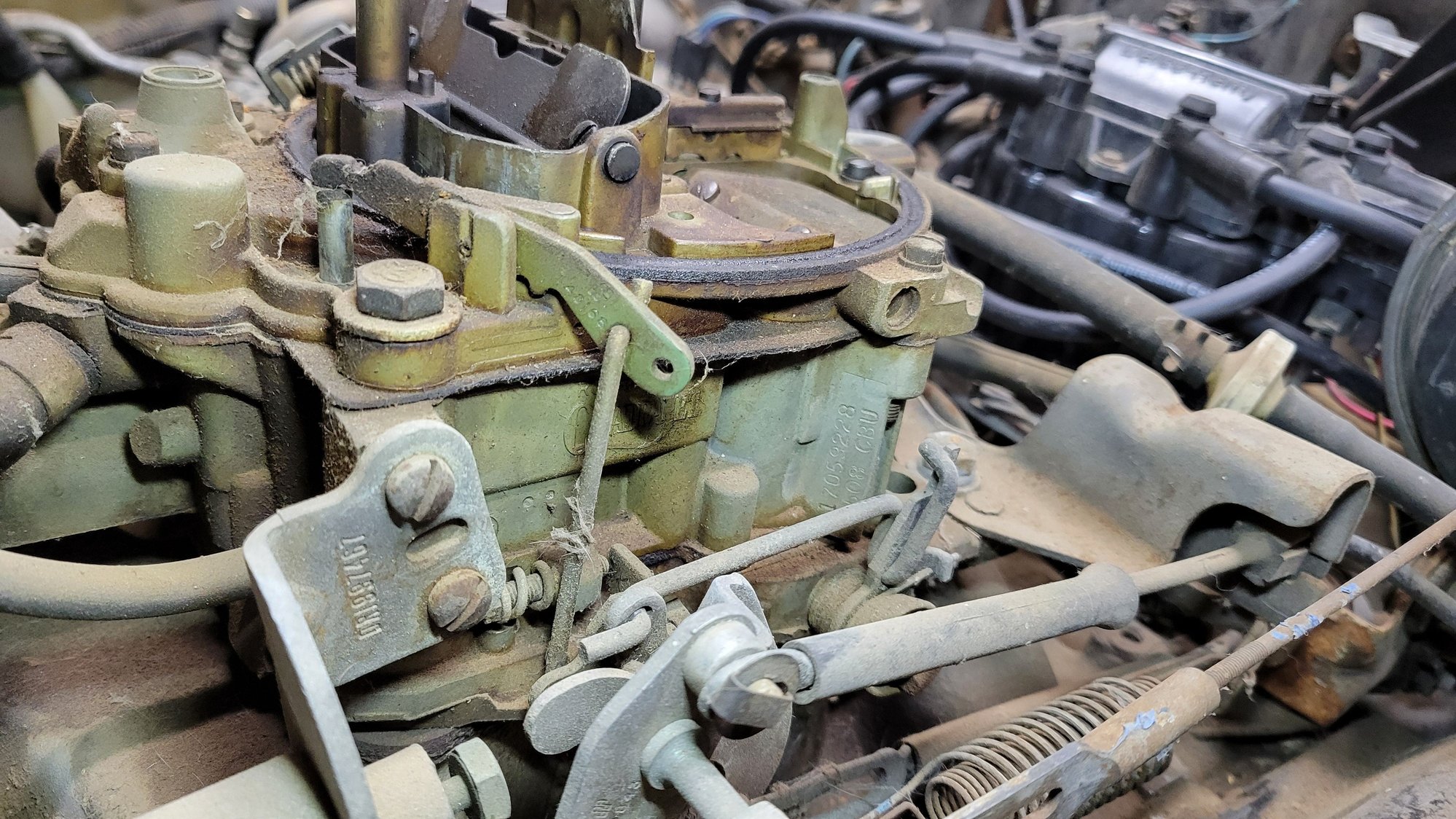

This is what I found on the carb #17059228. I looked it up and a site mentioned trucks and corvettes.
#17059228

I stand corrected. You have the correct original carb. I wasn't looking carefully enough at the NCRS Specifications Guide (1968-1982). I apologize for the oversight.
Evidently, Chevrolet fitted two different QJets on L82 THM cars; one for factory A/C, which you have. And one for cars without factory A/C.
So, according to NCRS...
1979 L82 THM w/A/C should be 17059228.
Therefore, you still have the original carb after four decades. Mine does as well. You and I are blessed.

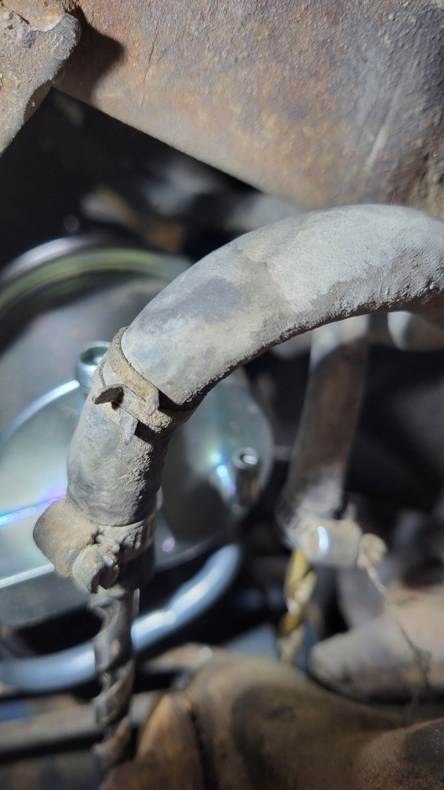

The inline filter has been replaced by a new pump to carb fuel pipe. It seems the old pipe had been cut to add the inline filter using rubber fuel lines and clamps.
With that filter out of the mix, I am trying to find the replacement that goes inside the fuel inlet. What filter goes inside the carburetor? I find 33052 for a part number, but that is the long filter in the pic. I bought the short one to see if I simply didn't notice something. Of course it doesn't fit either. The manual shows the filter, a spring and a gasket but no part numbers. The filter has to be a skinny little thing.
Doesn't fit.

Virtually all C3 vendors have the proper fuel filter. Corvette Central carries it as part #353058, which is listed as the fuel filter for all '76-'81 C3 cars. I purchased that very filter and replaced mine in my '79. This assumes no one has modified your carb inlet. Hopefully, your QJet is totally unmolested.

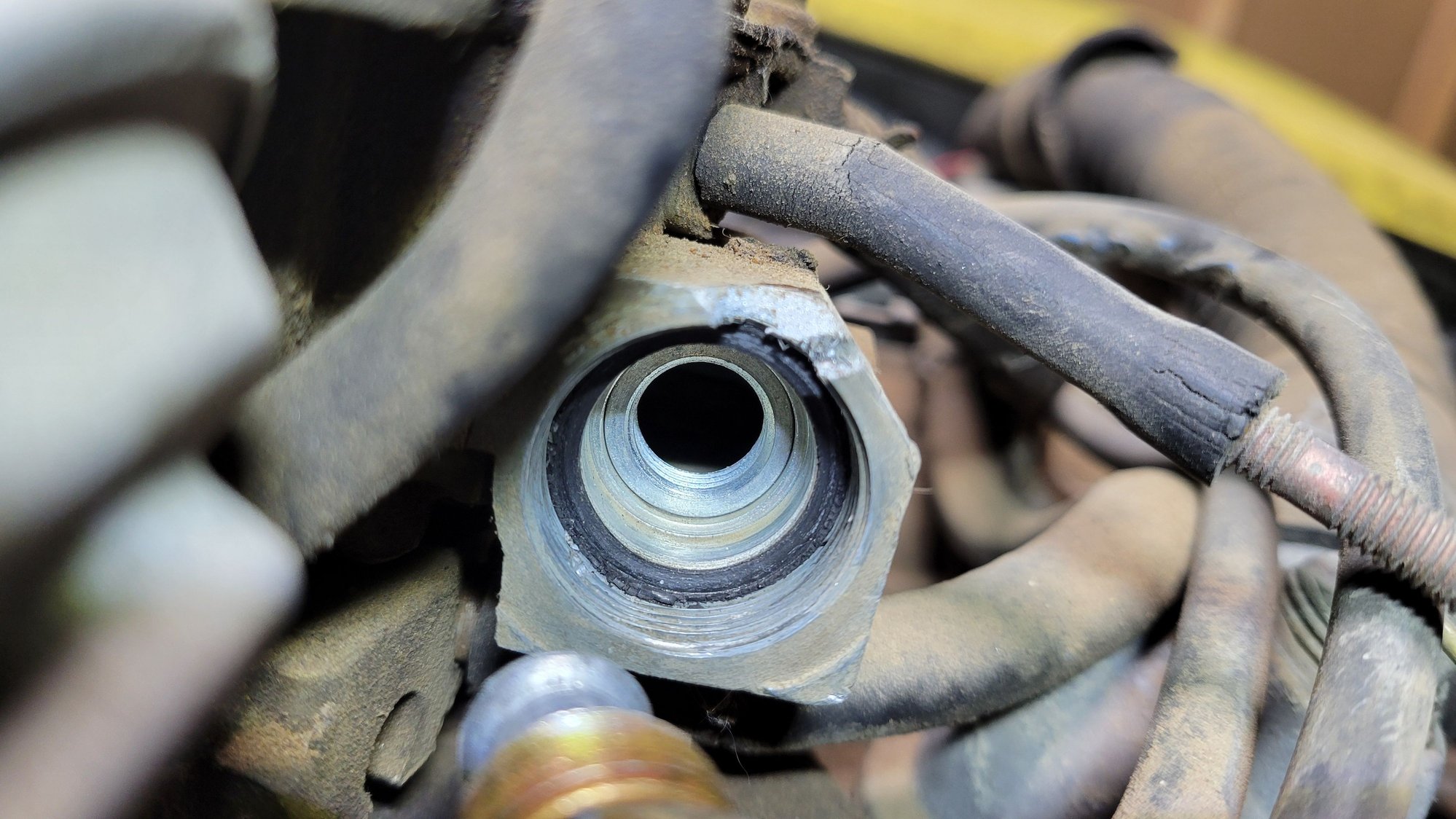

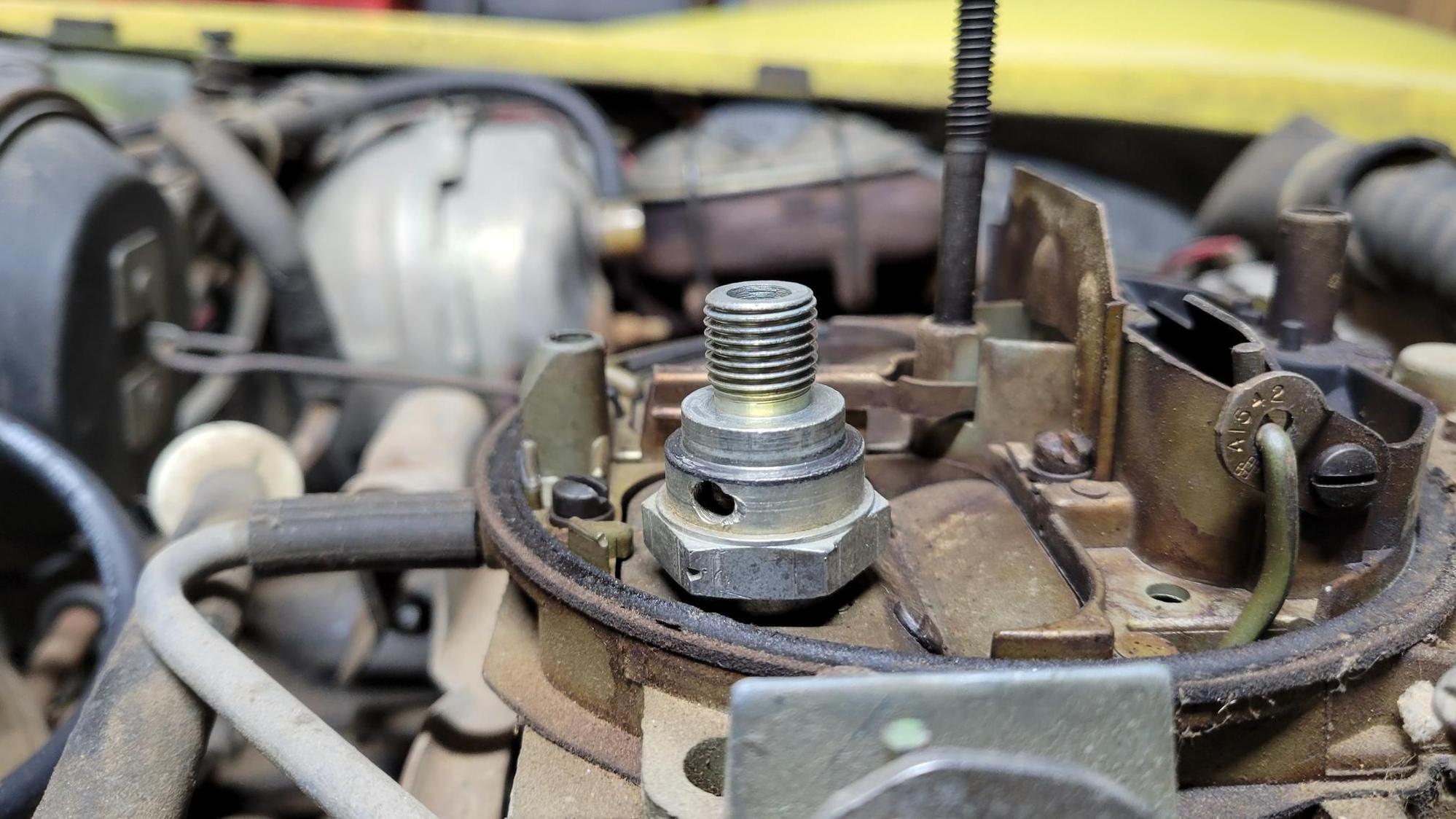

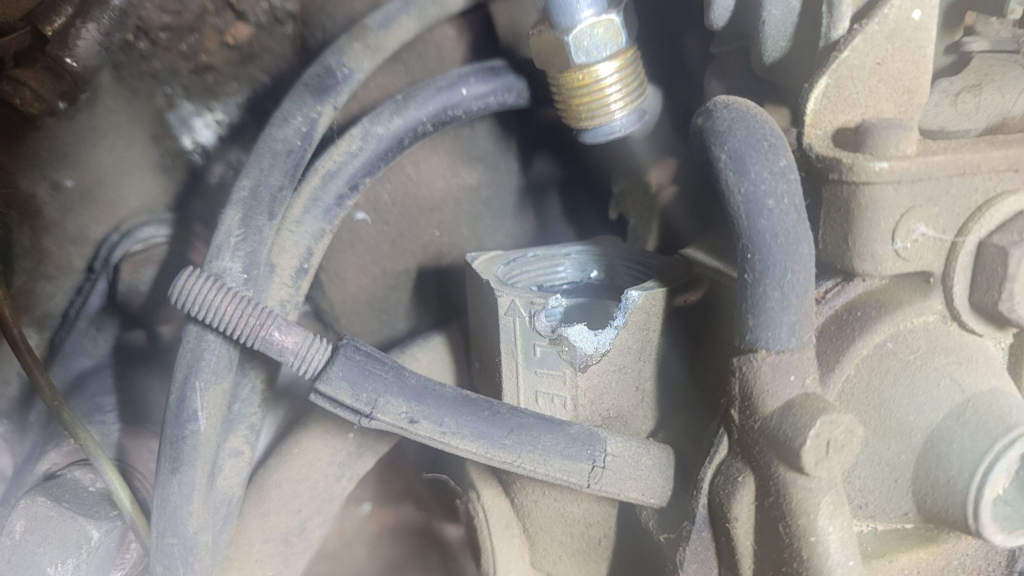

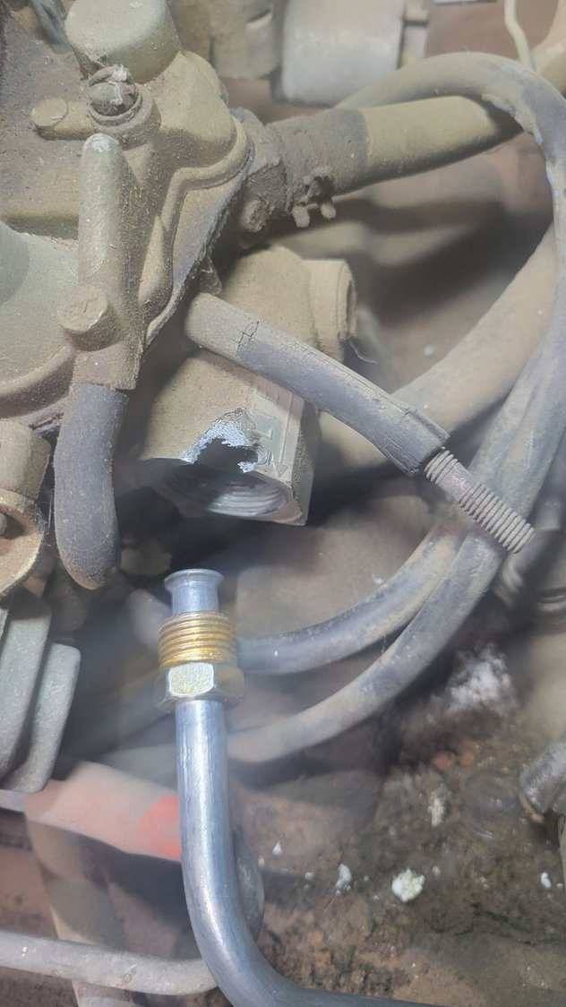

I think it has been modified for some reason. That would explain why I'm so confused about the fuel filter. It looks like there is a threaded fitting inside the inlet. I finally noticed there are threads just inside the inlet that would fit the normal, cup shaped fuel line fitting. Is there an alternative location for a fuel filter?
The internal fitting. It looks like a smaller threaded insert has been added. The break is from me not noticing a set screw that had been added to the inlet. Gah!
More of a plug shape. The hole is where a set screw went.
Old Feb 16, 2024 | 09:08 AM
  #71
Bikespace's Avatar
Bikespace
Joined: Mar 2017
Posts: 11,970
Likes: 4,522
Wow, that's creative! The outside threads are wrecked, so someone added an inner thread. Is the "gasket" just that ring of goop? I don't see a sealing surface I'd be comfortable with.
It's probably time for a new carb.
That vacuum port plug is suspicious, too. Your nearest FLAPS will sell you a box of vacuum port caps for $5-. No reason to use vacuum hose and a screw.
Email @lars and ask for his fuel line paper. There is a way to safely add a filter to the steel line between your fuel pump and carb. Send him a link to this thread, too, and be ready for some very honest advice.

I absolutely agree with Bikespace. Lars would know if this carb can be saved and exactly how to proceed. Perhaps he will advise you to send the carb to him for a complete restoration. If so, that is exactly what I would do!

That's a helluva' hack job on the carb. Luckily, it appears they did all the damage outside the pressure boundary of the carb, so the carb can be repaired, less the cosmetic damage they did by breaking the casting with that POS set screw and O-ring repair fitting. (You don't have a good photo of the extent of the broken-out damage area, so I can't say for sure) You're lucky you haven't burned the car to the ground with that repair fitting. You don't need an in-line filter - you need to properly repair your carb and and install a good fuel line before you burn your car and house down. If the carb float bowl casting is broken out all the way down to the gasket sealing surface, you have lost the carb and need to replace it.
Lars
Old Feb 18, 2024 | 03:49 PM
  #74
lars's Avatar
lars
Joined: Aug 1999
Posts: 14,384
Likes: 6,408
We're going to do a repair on Mark's carb that I think will work. The tricky part is caused by the loss of a significant arc length of the wall in the threaded area:
On the M4M carbs, the threads are outside of the pressure boundary of the fuel system, so we don't need to have a fuel-tight seal on the threads. But the missing section of the wall will make it a little trickier to to get the tooling to machine the inlet perfectly concentric to the centerline. This will require a temporary epoxy reinforcing wall to be created, with a hard backing, while the inlet is re-machined and threaded. This carb is an 800 cfm L82 carb, so we're going to do everything possible to save it... I'll post up the process and results in a new thread in the C3 Tech section once I receive the carb...

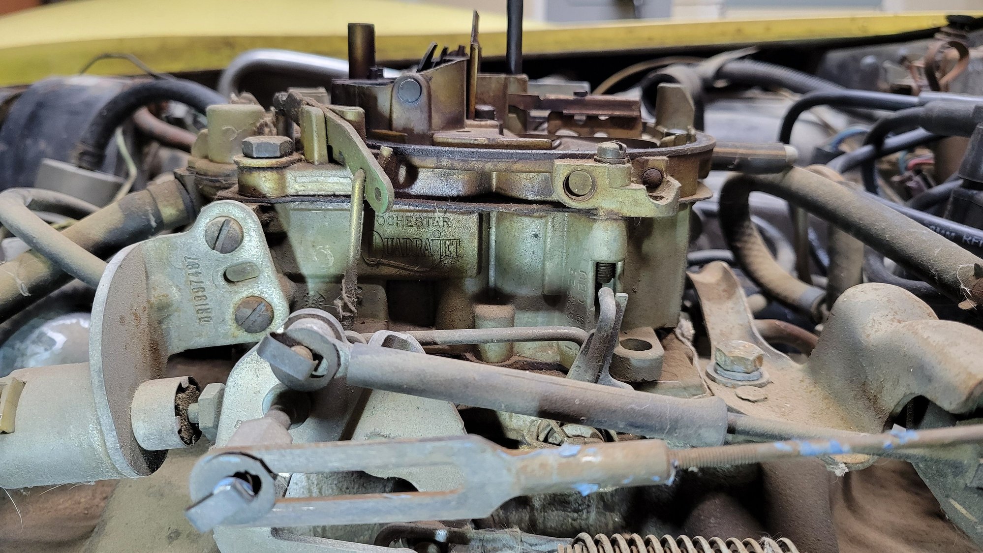

Last weekend I installed the newly refurbished "Tuned by Lars Corvettes & Musclecars" carburetor, dribbled a little gas into it and turned the key. It popped and fired! Today the car was actually hooked up to a fuel source (gas can) and it started! First time in 25 years that engine has run. It seems to run nicely and it easily restarts. I don't want to let it run long because the gas can setup is less than ideal and it doesn't have much coolant.
Next on the docket is to look closer at the gas tank. I'm thinking to clean and maybe treat it with the gas tank sealer products I've seen. I'll also replace any rubber lines I find. At that point I think the fuel system will be done.
You can see the plate Lars added to address my careless mistake. Works well.
