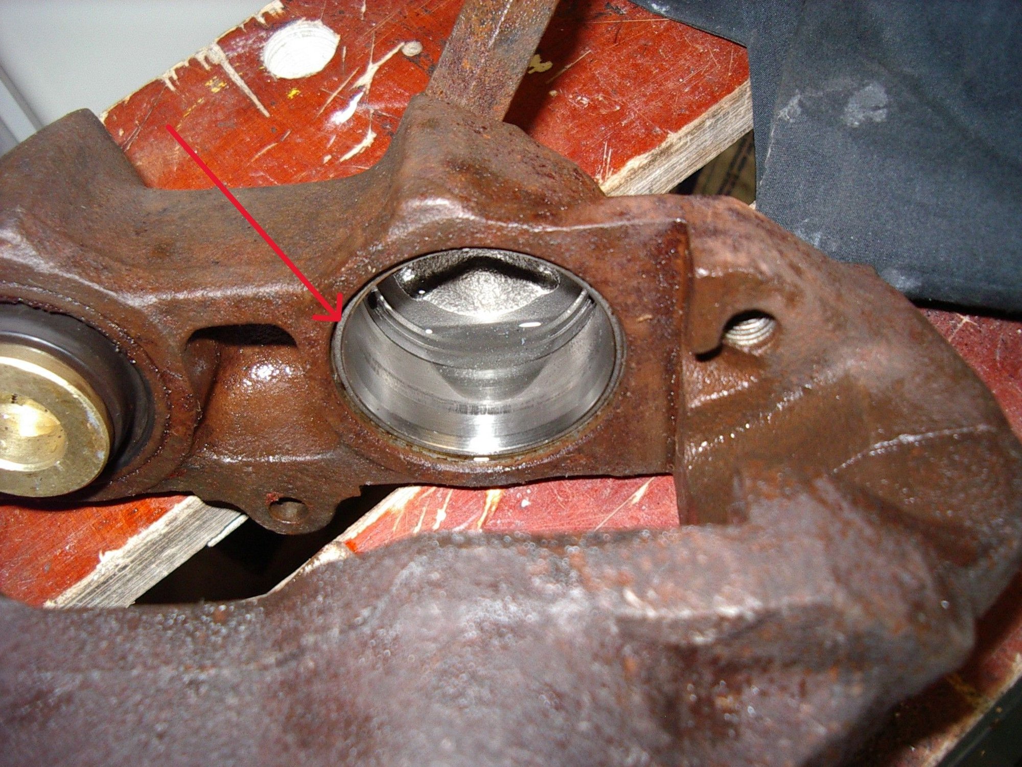

I rebuilt my calipers 4 years ago with the standard lip seals (that many people say don't last) and they are still leak free now. If they have the stainless sleeves it's easy enough to see as per this photo.
My calipers looked pretty much like yours when I got the car, but a good cleanup and a coat of paint made a big improvement. It is a pretty easy job.

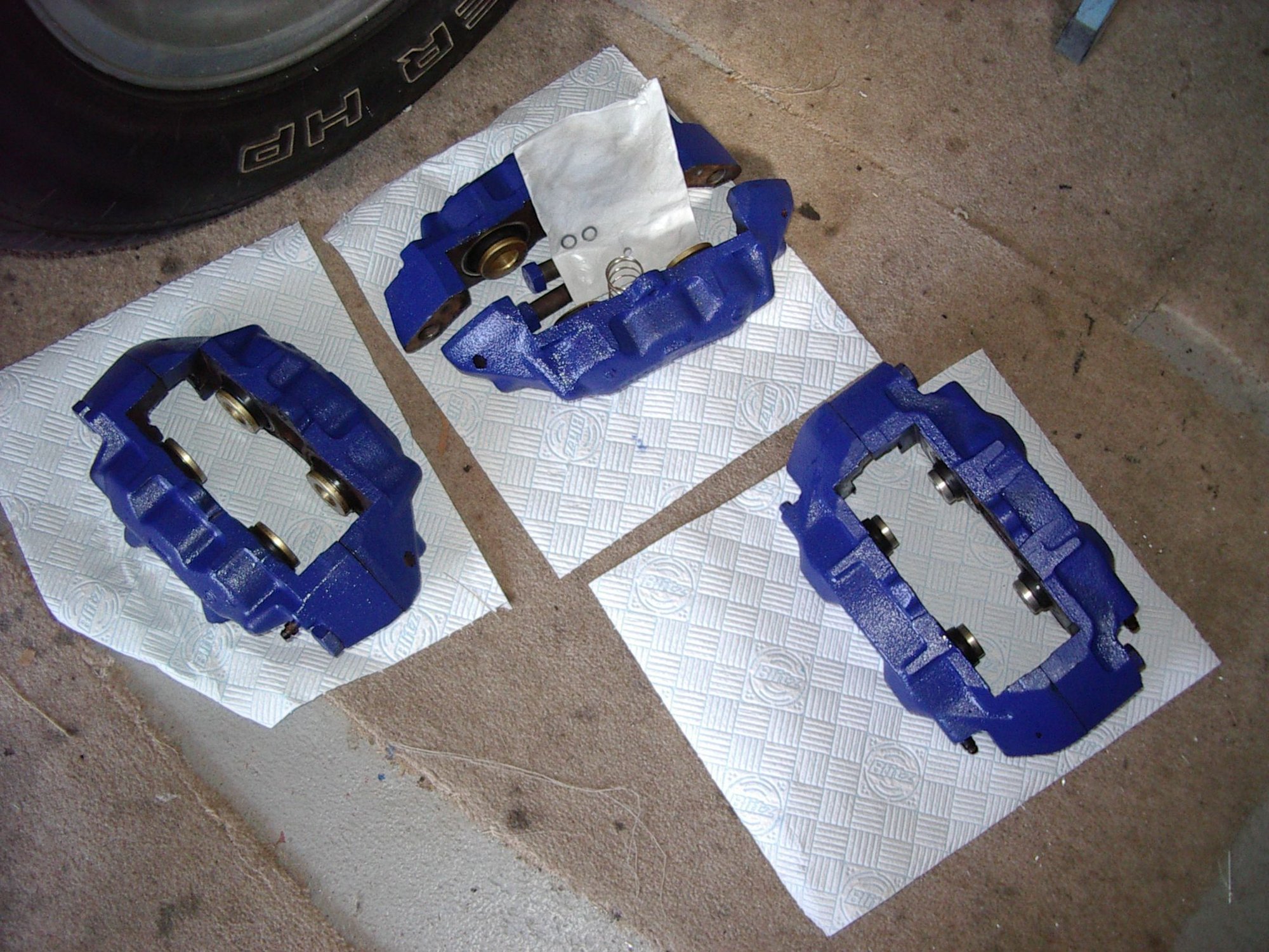

So you're committed to getting your brakes fixed? Here's what I'd do:
With the car on jackstands, take off the wheels. With golf tees, or clamps, ready, cut the flexible brake lines. Remove the steel line in the rear calipers and throw them away. Then remove all 4 calipers. Place them somewhere that the brake fluid won't damage paint, to include not on a painted garage floor, or on your nice workbench.
Pull the pins, and toss the brake pads. Then pry off one over one of the 4 pistons on each caliper. Then decide what to do.
If you have 4 calpers with stainless sleeves in good condition (including the bleeder valve), buy a high-heat O-ring rebuild kit from CSSB Inc, and do it yourself.
Otherwise, decide if you want Lonestar rebuilt calipers, or if you want to save a bunch of unsprung weight and (laterally) upgrade to Wilwood direct-replacement calipers. If you are going to track the car, you'll likely want bigger front brakes eventually, so don't buy the wrong expensive thing as a stopgap.
Buy new plain-steel short brake lines for the trailing arms (and anywhere else you need), and buy teflon-lined flexible stainless hoses for the 4 corners. Some vendor kits come this way.

So the sleeve would be a thin line after the piston is removed. What if they aren't sleeved?

If they aren't sleeved already (and you won't know until you get the calipers mostly apart), buy Lonestar rebuilds and send what you have back as cores.
Or buy new Wilwood, Brembo or AP Racing calipers, depending on your car's expected use.

The stainless sleeves are not super thin - probably about 1/16" wall thickness. The bore of a sleeve is bright silver, smooth, and polished looking (surface staining is OK). An unsleeved bore will appear a medium gray (cast iron) coloration and not be as smooth or have much of a polish.
The problem with the cast iron bores, as they came from GM, is that any moisture will rust the bore which compromises the sealing so that the calipers begin leaking brake fluid. The problem starts in the section of the bore between the outer bore seal and the inner piston seal. This area does not have any protection of brake fluid (as minimal as DOT 3 & 4 offers) so any moisture that gets past the outer bore seal quickly corrodes that section of the bore, causing an extremely poor surface for the piston's seal to ride against as the pads wear. Any moisture in this area is transported inward by the back and forth movement of the piston during regular use which introduces an easy route for moisture to get into the fluid where it rusts the deepest part of the bore. It's a nasty self-deteriorating situation that stainless sleeves all but eliminated.
