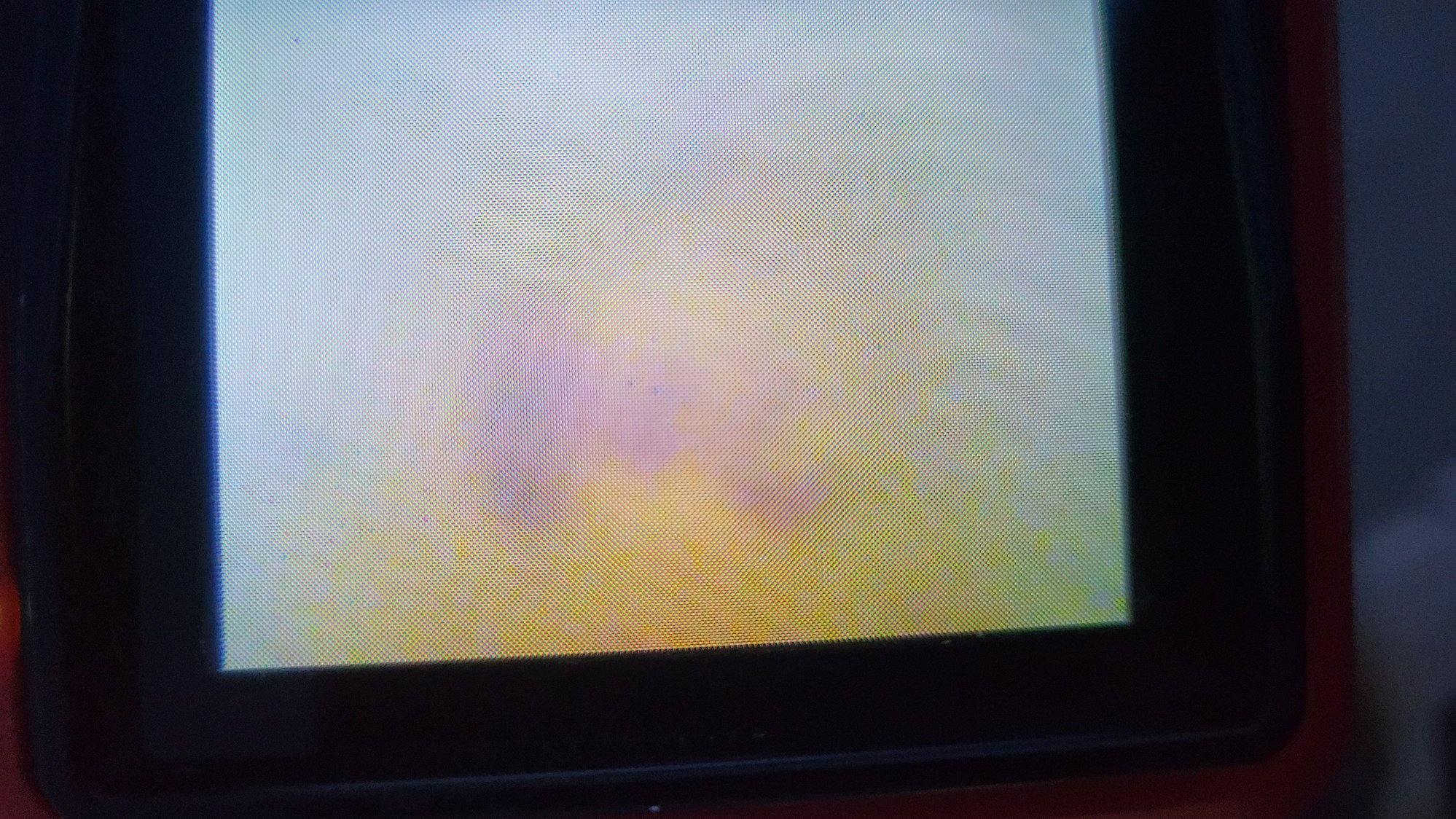

This is a blurry shot of the inside of the tank. Is it ruined? I'll drain/remove the "gas" that's left of course.

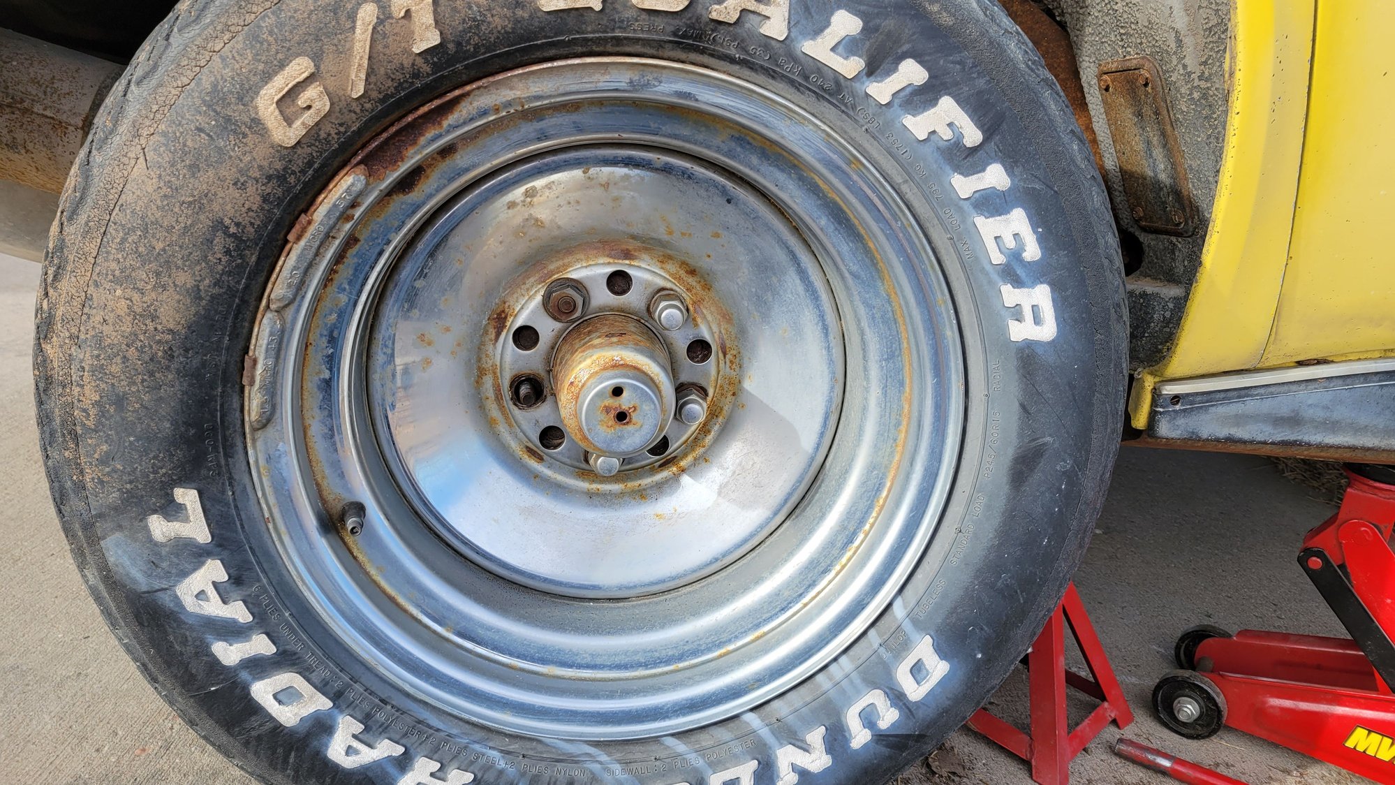

And can we talk about those smoothie wheels? Never seen that on a c3, it looks pretty cool!
This is a closer shot of the wheels. They are supposed to have some kind of wire basket hub cover. The current plan is to clean the rust and flaky plating as best as I can. Maybe paint the center cone black. Should be nice enough for the time being.
That's exactly what yours are. There would have been a wire wheel portion to these - thick wire wheels that were popular back in the day. Have you ever thought about the AR Torq Thrust VN1055861's (VN105D)? They are very reasonably priced and look awesome. I bought some for my '69 (haven't mounted them yet), but GolfObsessed recently mounted them on his '80, which is closer to your body style than mine, and they look great.

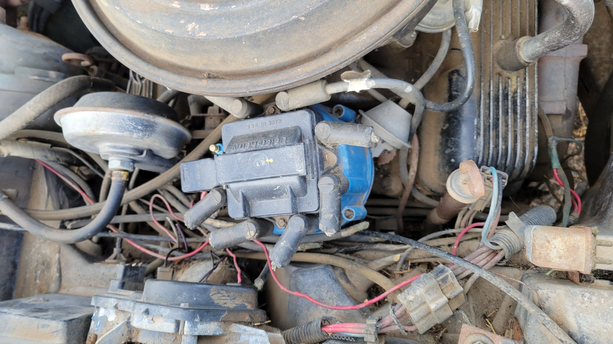

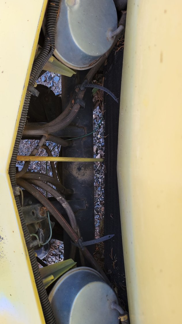

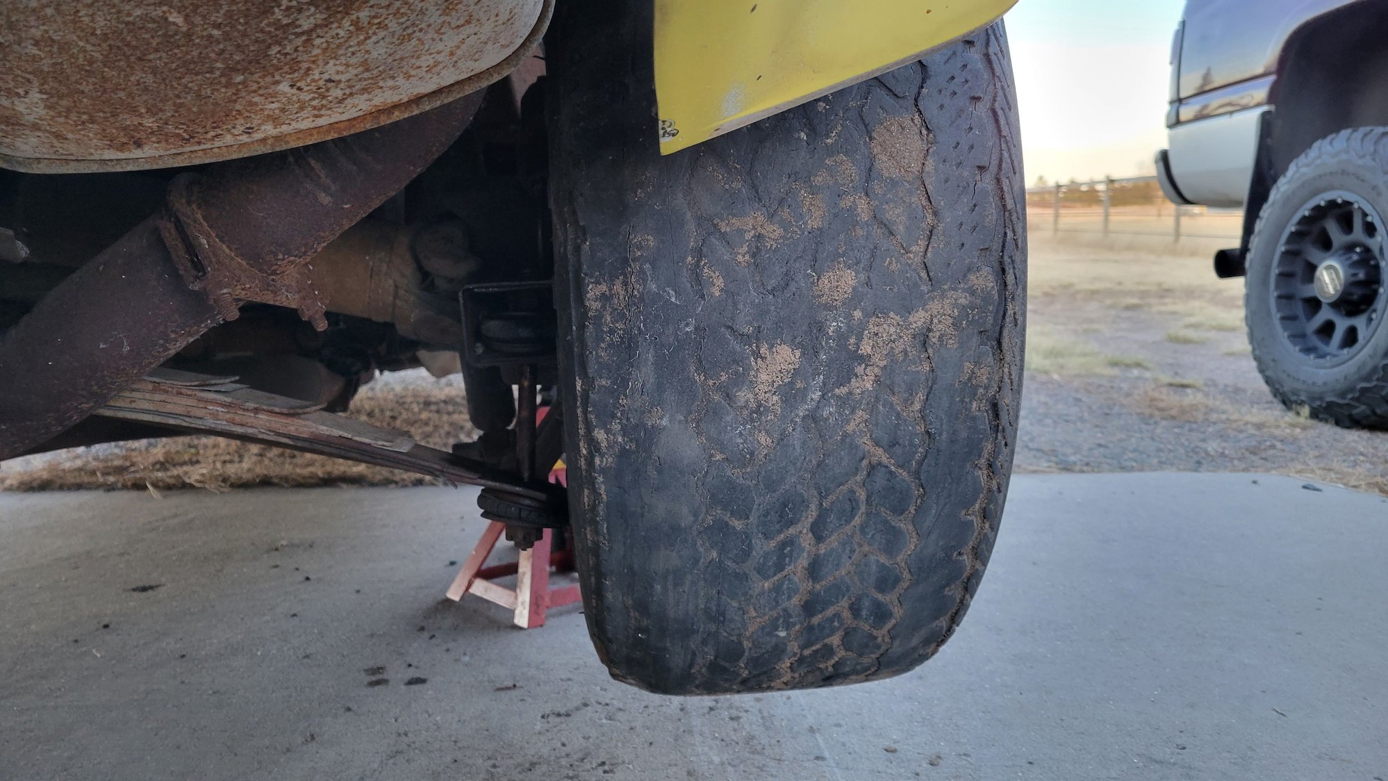

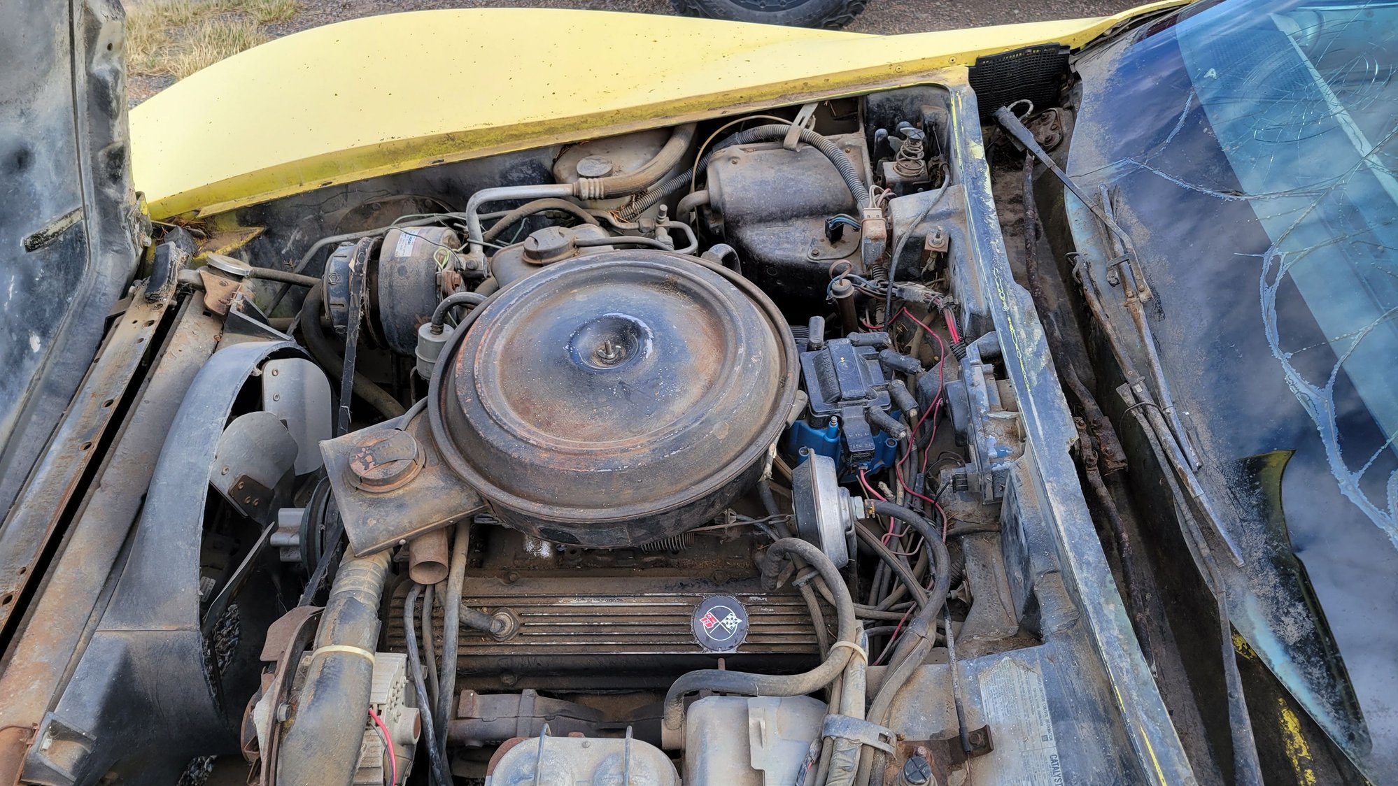

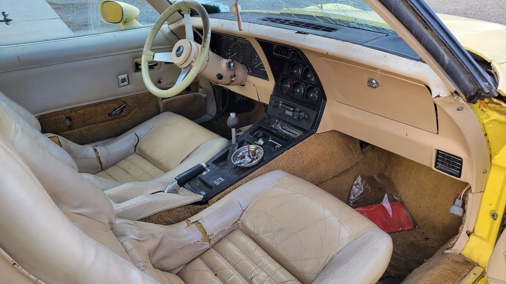

Here's a few shots:
Both rears have this inside wear pattern.
Pretty much rust free.
Spark plug wires must be tasty.

Padding eaten under the driver's seat and I'm still trying to get the driver's door opened.
Passenger side. Metal feels solid.

Car is missing the distributor shielding and air cleaner dual ducting, but it looks like the original L82 valve covers are present. Also, you have an in-line fuel filter that needs to go. Not safe. Hopefully you still have the QJet carb.
Based on these latest photos, this car is loaded with 1979 options. L82, power windows, power locks, rear window defog, A/C, cruise control, tilt/tele column, sport mirrors. I like the yellow paint / doeskin color combo. My guess is this car rolled off the line in the first seven or so months of production.
A rust-free frame and birdcage signal great potential for this Wyoming C3 that you rescued from the abyss.
