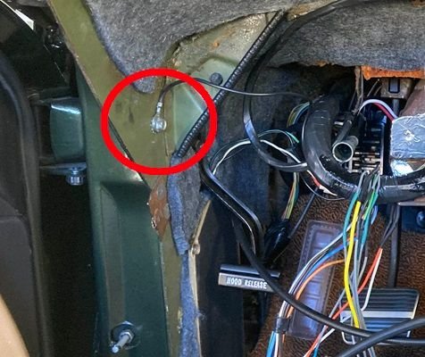

If you are missing a ground to the gauges the lights will not function as there is only one wire to each bulb. There should be a ground lug on each piece of the gauges. They might not be in the same location as the photo, but as long as they are there you should be good.
There also should be a ground wire attached to the birdcage frame with a star washer. These would be the first two things that I would check. The headlight switch also has a ground strap attached to it.
