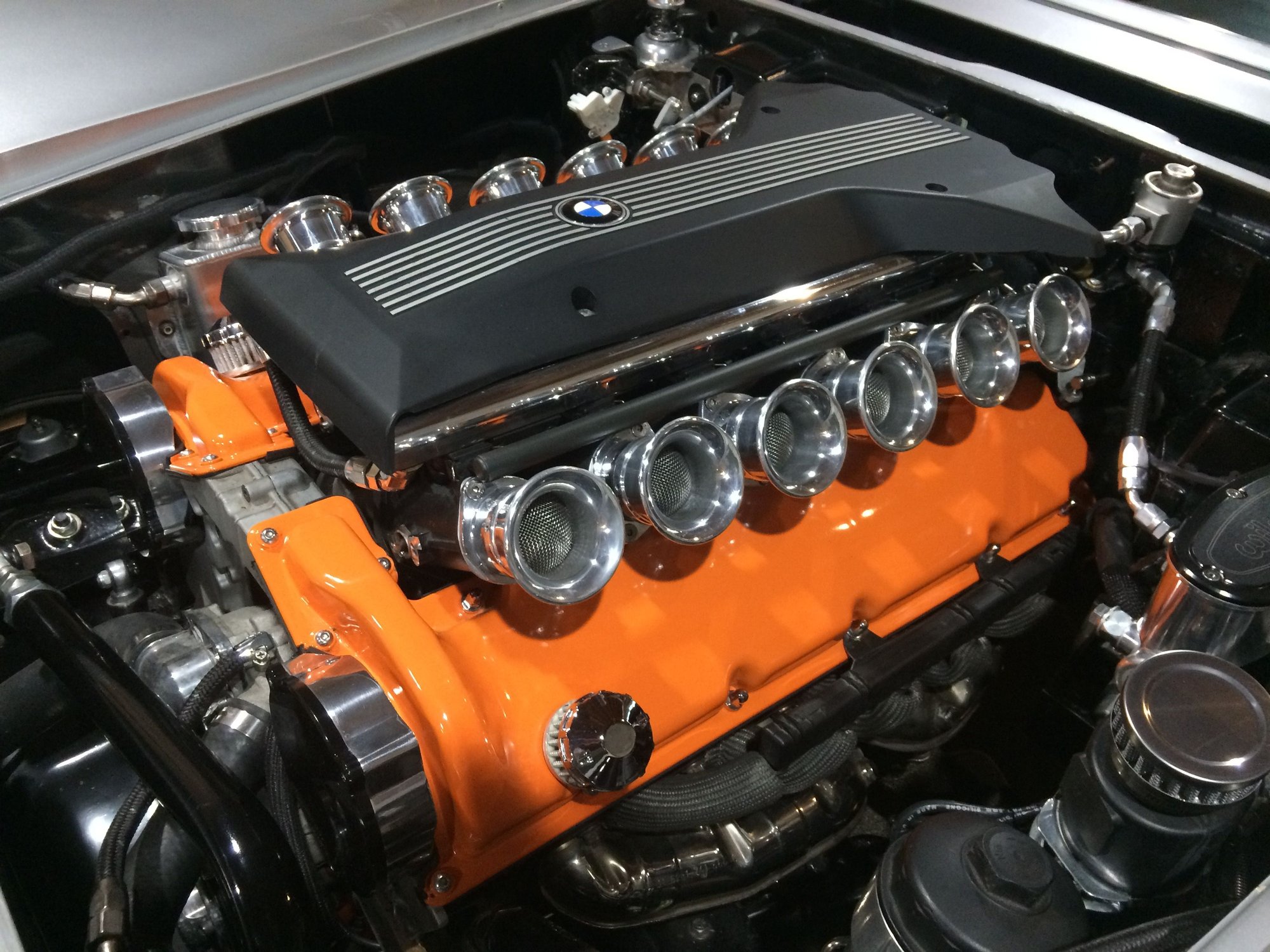

Originally Posted by Fly skids up!
Why did you delete the PVC? PVC is actually beneficial.
Running a PVC is not a "one size fits all." I'm running ITBs and it will act like a really bad vacuum leak- plus I have a 3 stage dry sump pump with an AOS (Air Oil Separator)
Ok, but what's all that got to do with a BBC?

Crankcase ventilation is crankcase and it doesn’t care what type of engine crankcase you are venting.
I’ve run performance engines for decades without a PCV valve and don’t plan to start now, just because someone says it’s better.
I’ll set my engine up with two filtered catch cans and it will be just fine.
This engine will see 2000 - 3000 miles per year maximum with annual oil changes so I’m not worried.

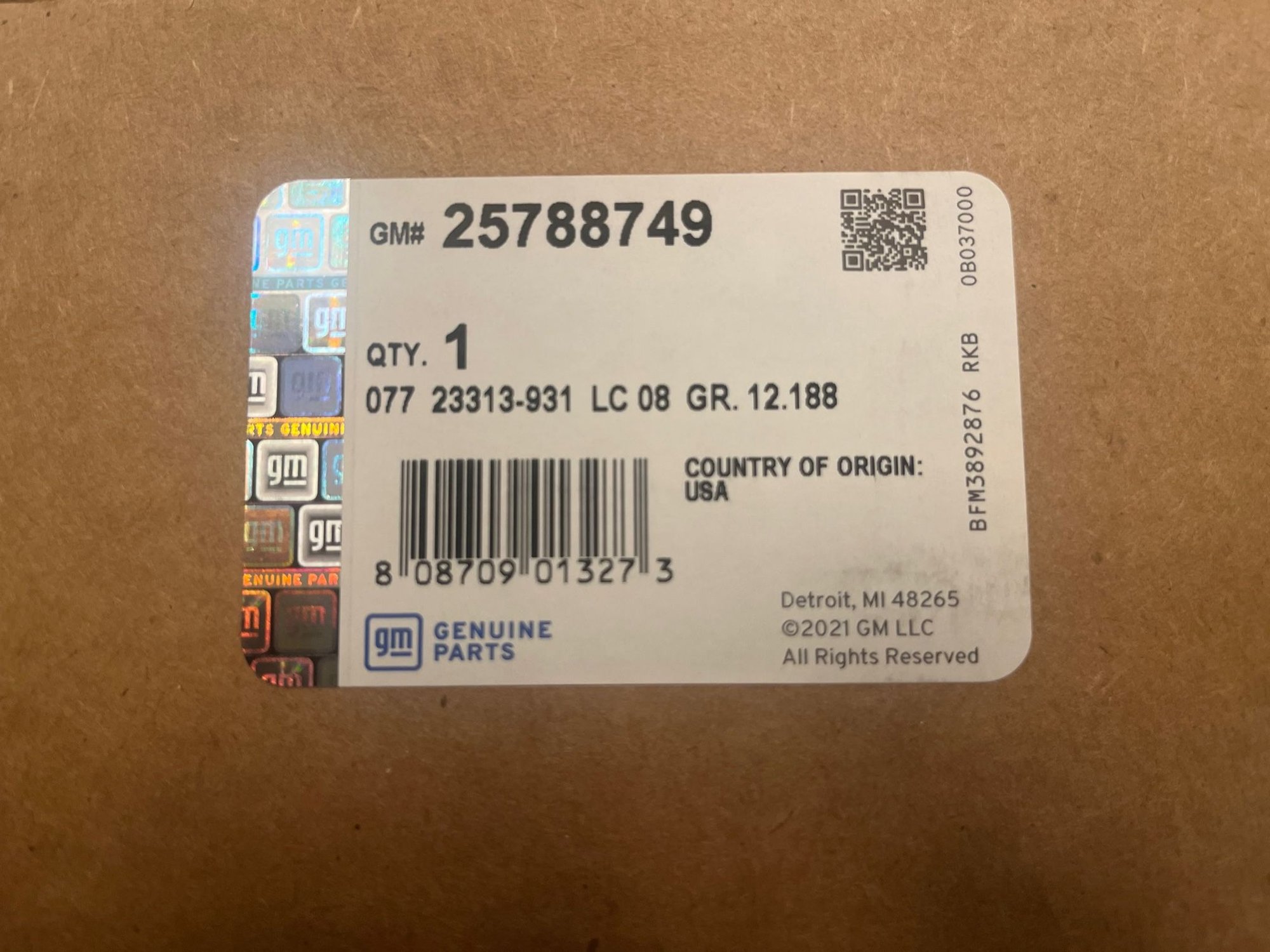

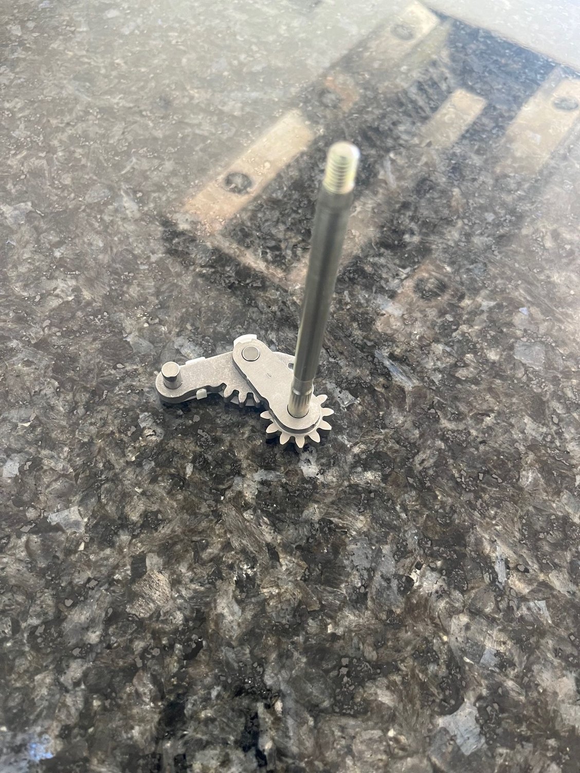

Well those motors he uses are originally designed for rear wiper use. Now that in itself doesn't make it a bad thing but it it does lack the manual raise **** and the long output shaft that's not supported in our application gives me concern. Those motors in Richard's kits are manufactured by Mitsuba with main headquarters in japan with a global presence and manufacturing around the world. While they do have several manufacturing plants in the USA, it's actually unclear where those motors are actually manufactured.
Hey come on up to Fernandina Beach-it's what-an hour away. I'll buy lunch. Be glad to show you how it's built. Oh the shaft is hardened steel- I let you put it in a vice with a sledge hammer and you'll see how tough the metal shaft/ gears are. Seriously- head on up this way- or if you head up for the Amelia Concours d'Elegance next weekend.
It's not unclear-

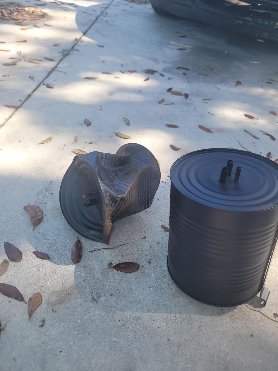

I think I am about ready to pull the trigger on Richard's replacement system. My old vacuum can on the left and the new one did not fix anything.

Darla, I am not a change things for the sake of change kind of guy, but the electric headlight conversion is just a great change. Richards kits are excellent and how nice it was to get rid of all the vacuum stuff.
