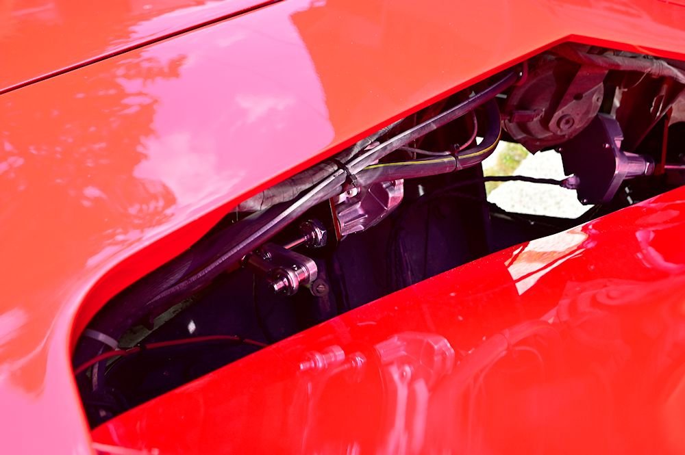

Another vote for Richard's Kit (Richard Hayes, Richard454). The best there is, and best engineered. Everyone else tries to copy his. I have this and also his electric wiper conversion kit. Hard to get a good pic, but .........

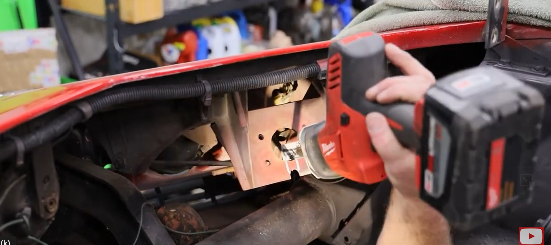

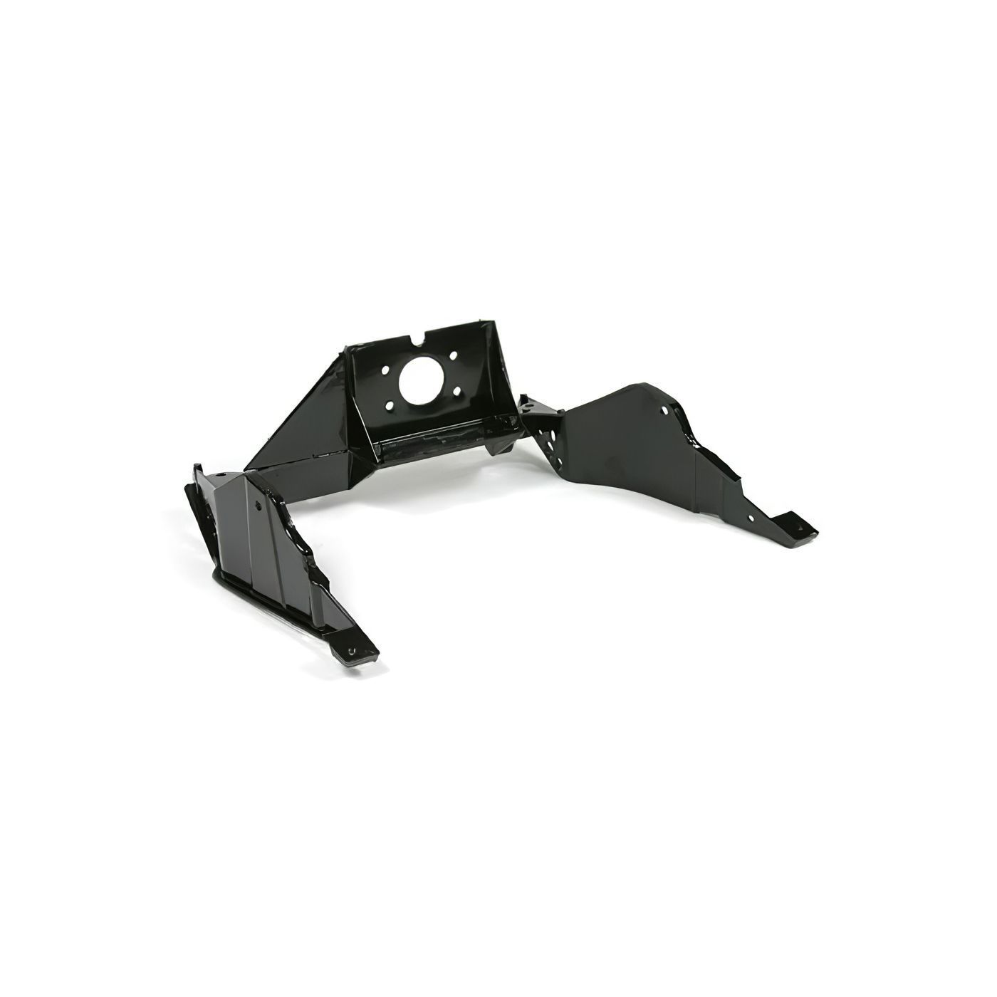

You still have to cut up your headlight actuator support frames- and those are $250/each.....

Originally Posted by Richard454
You still have to cut up your headlight actuator support frames- and those are $250/each.....​​
Trust me, those two small cuts won't missed, along with the 10 yards of vacuum hoses.
