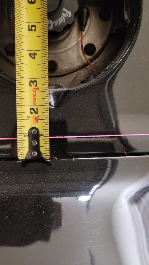

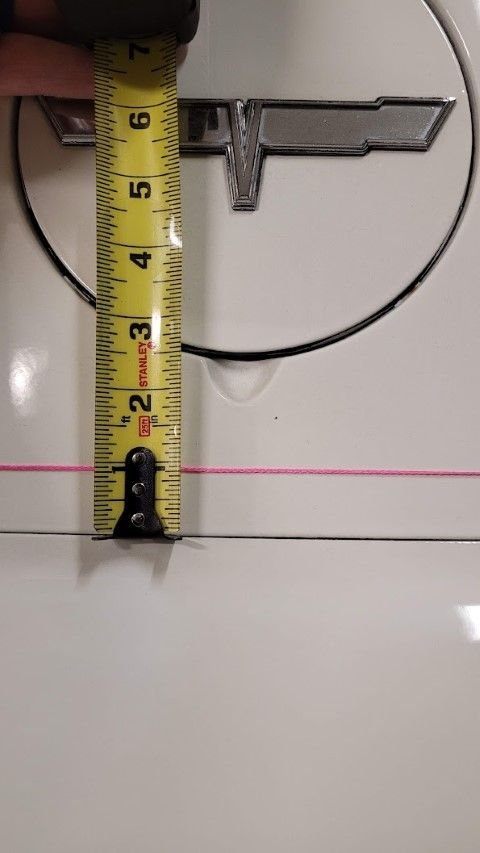

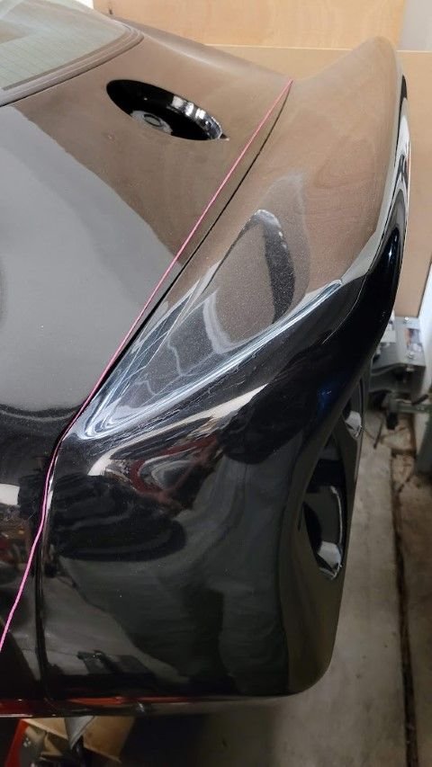

Thanks, I would like to ask if someone with a 80-82 corvette would draw a string across the tail of there car and see how many inches there curve is. Then I will compare it to mine.
Old Feb 19, 2024 | 07:48 PM
Bikespace's Avatar
Bikespace
Joined: Mar 2017
Posts: 11,923
Likes: 4,495
Easy!
On my 80, there was a 15/16" offset from straight at the center. On my 79, there was a 7/8" offset from straight at the center. Note that the 79 actually has that exact bumper already installed (or one just like it), so it may have been shaved a bit when the car was first restored 20 years ago.
I'll post photos when my phone finishes downloading them. If there is a difference between my cars and yours, I'd expect the change to have occured between 77 and 78, when the rear switched from sugar scoop to bubble window.

The white car is my 80, black is my 79.

You realise that's just a tiny bit of difference don't you?
you are also aware if you messured 20 1979 cars none would be precisely the same don't you?
you can clearly see that sanding down the inside of that bumper cover on the outer sides will get it to fit, right?
you are aware that any replacement bumper will need fitting on these cars, right??

I bet it would take less time to measure your 77 than to speculate.
I don't think there's a difference either, but if there is, your car would show it.
