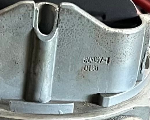

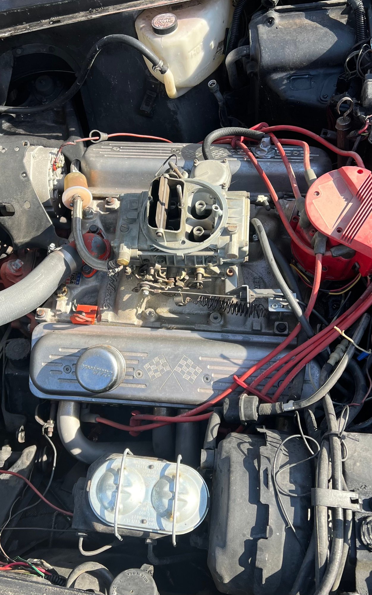

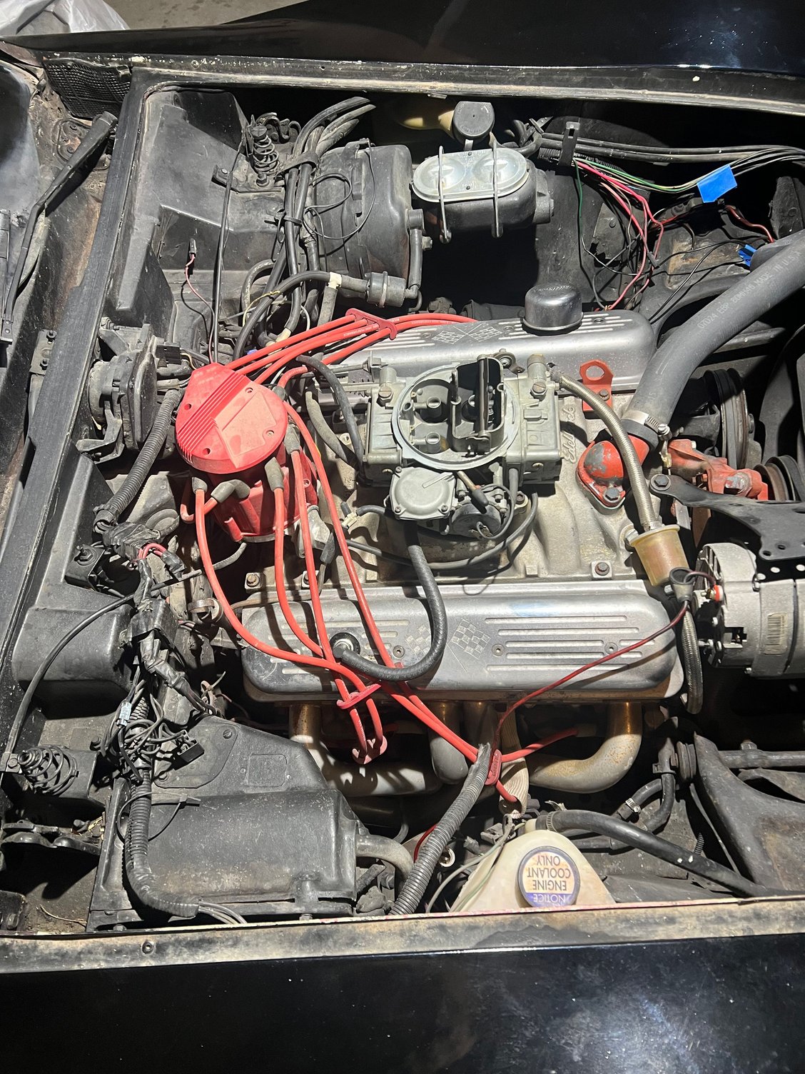

So after doing some research on my engine, it’s a 350 crate motor with 12558062 vortec heads, a performer 2116 intake and a Holley 600 carb, my question is roughly how much horsepower this setup could produce? I realize there are other factors that would determine how much horsepower, but I just wanted a rough idea, also is that Holley carb good or should I change or upgrade it? Not looking to take this to the strip, just want a quick driver. I will post a couple of pictures. Thanks for your advice!

Without knowing the compression or cam specs, I’d say anywhere from 200 to 450.

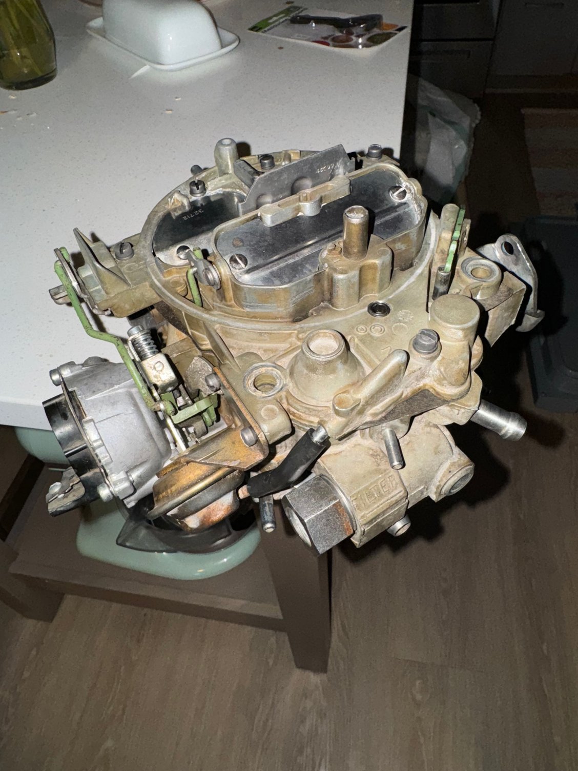

Your intake manifold has a mounting pattern for both square bore and spread bore carbs. The correct Quadrajet carb number for your car is 17059216 and is good for 750 CFM if you’re looking for an upgrade.
10W-30 is a good oil to use unless you’re in an extremely hot or cold climate. You might be able to use 87 octane too. If you’re getting pinging with it though I would go up to premium.
Edit: Just read the part number of the crate engine you have installed. I would expect that you’re getting close to the advertised power of 250.

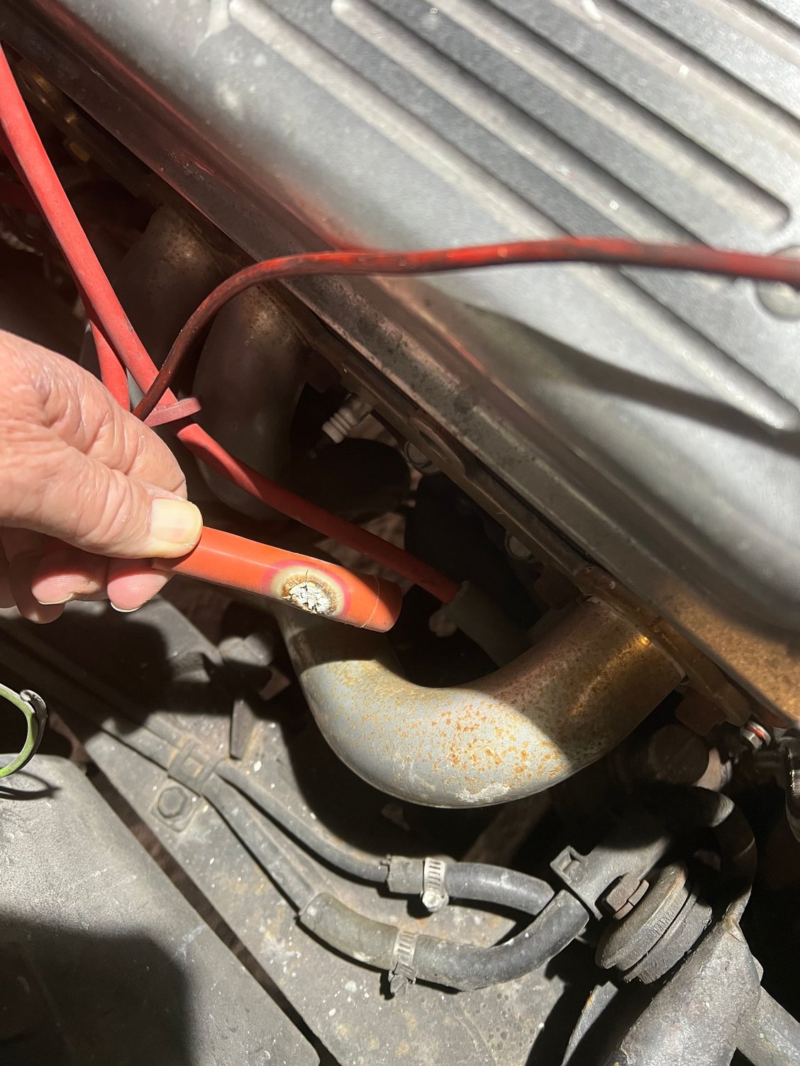

Thanks for the information guys! The reason I’m replacing the wires is one of them was burnt by the headers, I don’t want to just replace one. I thought about replacing the plugs with shorty plugs, hopefully that will help with clearance from the headers. Jegs has a set of wires 8mm wires for around $40 I may purchase.
Burned through the “protective” sleeve.
