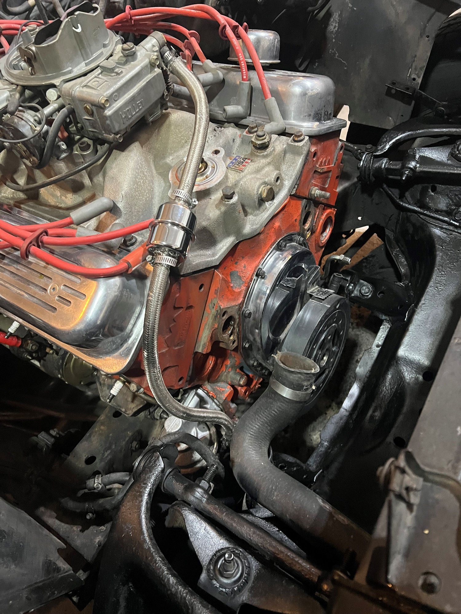

I have a question, I have Vortec heads on this block, given the information above it has a flat tappet cam, however, I have seen where Vortec heads are usually set up with a roller cam, Is there a way to tell whether it has a roller or flat tappet cam without tearing into the engine?
Thank you,

Likes: 2,165
From: Minnesota
People put vortec heads of flat tappet short blocks all the time. The easiest/least obtrusive way would probably be to pull a rocker arm and pushrod and look down into the lifter valley for tie bars on the lifters, or better yet try fishing one out with a magnet to see if it has a roller. Either that or pulling the distributor and seeing if it has a melonized gear, assuming whoever did the roller conversion did it correctly.
If you’re not sure when you’re changing your oil I would error on the side of caution and use an oil with a high ZDDP content or a supplement.
Old Apr 9, 2025 | 11:34 AM
  #76
Bikespace's Avatar
Bikespace
Joined: Mar 2017
Posts: 11,953
Likes: 4,510
Thank you,
Post a photo of the timing cover. There might be a clue behind the water pump (may be hard to see, though).
FWIW, Vortec heads mean limited intake selections. They are not direcly swappable with C3 contemporary heads.

Thanks Piersonpie! I probably won't go to that extent, i'm glad you mentioned the type of oil to use, that was going to be my next question about the oil.
Bikespace...post #63 of this thread I have a picture of the front of engine.
To L-48 or not?
Old Apr 9, 2025 | 01:11 PM
  #78
Bikespace's Avatar
Bikespace
Joined: Mar 2017
Posts: 11,953
Likes: 4,510
Thanks! My VPN was doing the "no photos for you!" thing again.
That looks like a smooth timing cover, with no indication of a cam button, so it likely does not have a retro-roller cam. It also has the pre-77 wide-style engine stamp pad. Were you ever able to get the numbers off of that pad? I'm not questioning the GM Goodwrench replacement ID, but that would help confirm it. I think roller lifters started in 87 or 88, which is past the likely build date of your engine. But your heads are later than that.
All I'm saying is, your engine seems to have a mix of parts, so I'd question everything. The only way to be sure is to pull a lifter, or the timing cover.
If I missed it in the thread, my apologies. But the numbers here might provide another clue.
