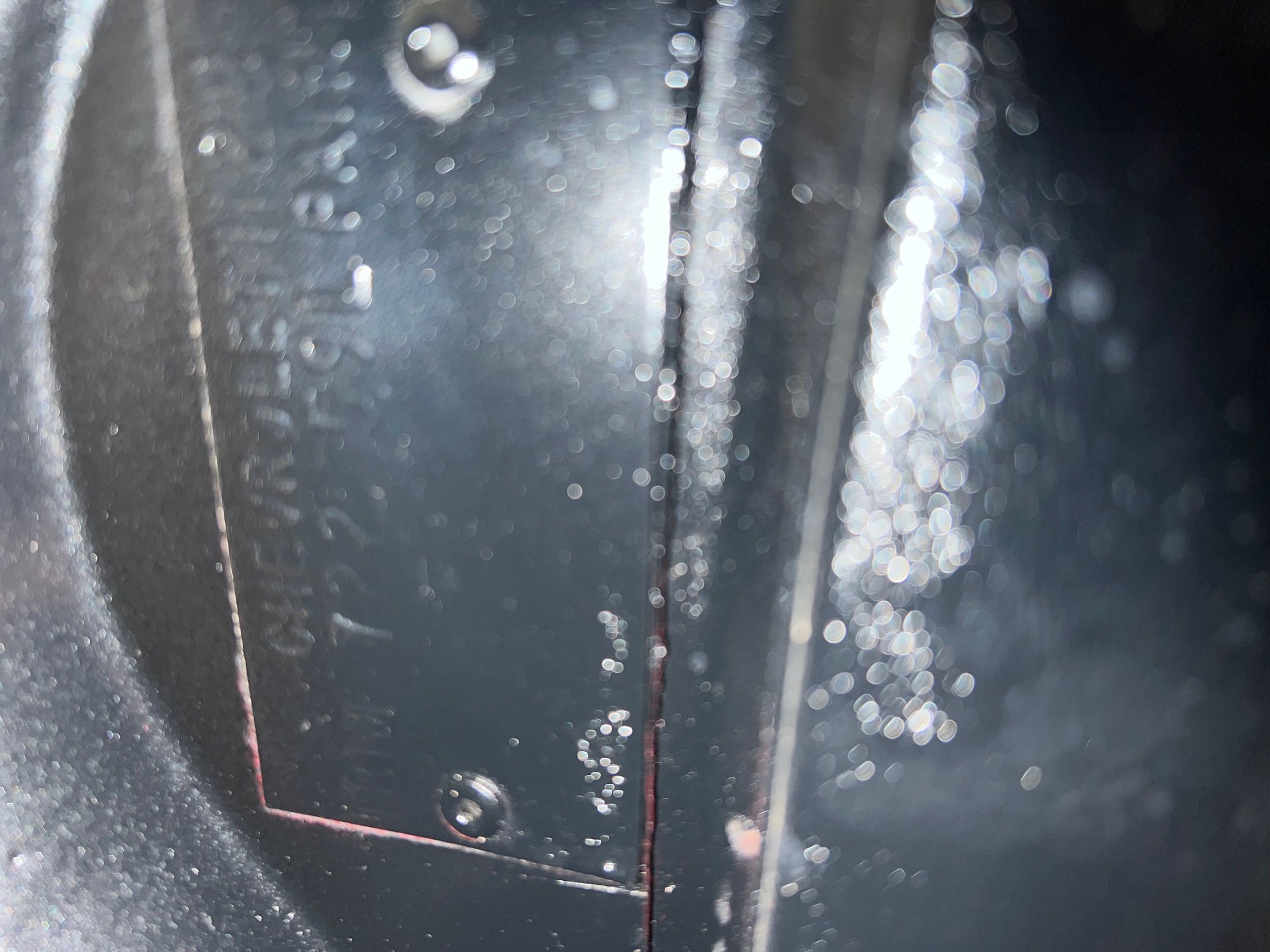

Frost Beige exterior, Medium Red leather interior.
Trim tag codes are here:
https://corvettec3.ca/interior.htm
(go up one level for lots of other useful codes).
Your car's birthday is also on that trim tag, but I can't read it:
https://corvettec3.ca/numbers.htm

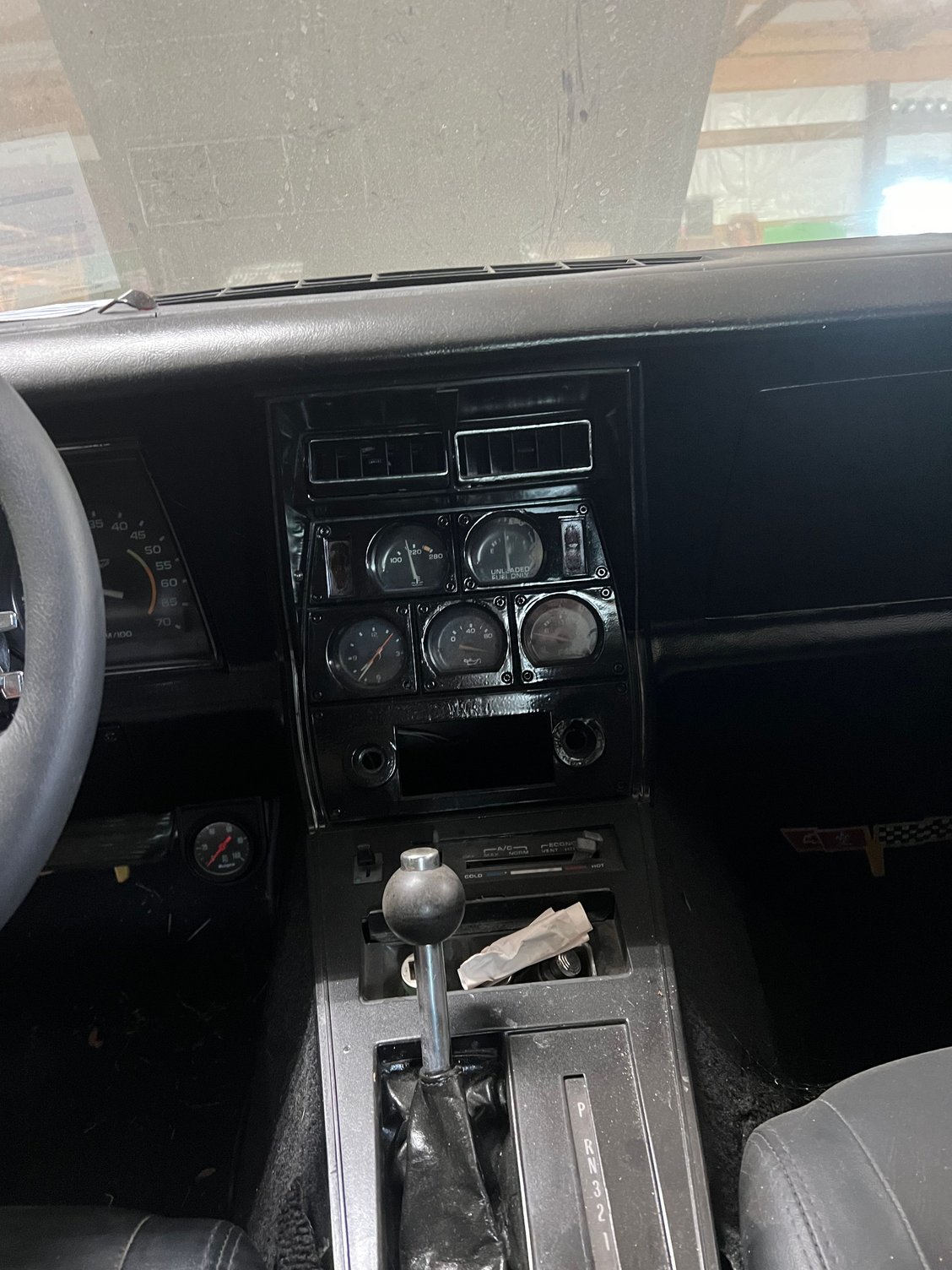

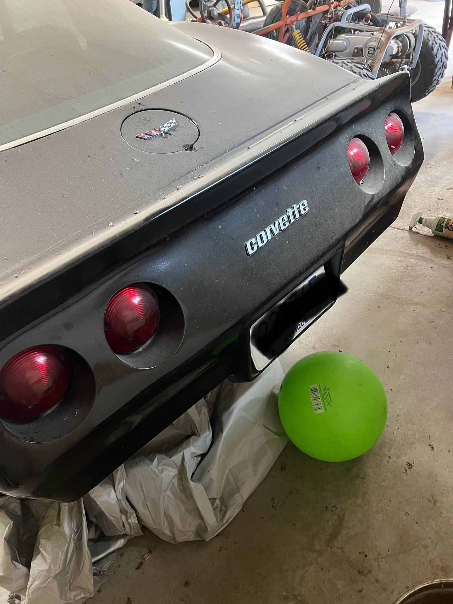

Thank you for this information! It will help me on my journey on being the new owner of this car, not real happy with the previous owner, they repainted it black and repainted the interior black. Why would anyone change the original factory paint and interior??? They did a **** poor job in my opinion. Also they the wrong tail lights….as you can see in the picture….no reverse lights…

You can add a lighted license plate bezel for backup lights, or do what I did and add some LEDs below the bumper (see link below). Having 4 bright brake lights is crucial in these cars. My black 79 is, apparently, invisible, and has nearly been hit several times by inattentive drivers.
The interior of my 80 was changed from red to black by a PO. I've mostly changed it back.
Those are 68-style rear lenses, in an 80-82 bumper.

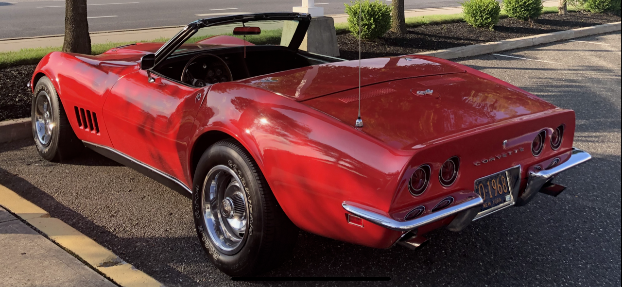

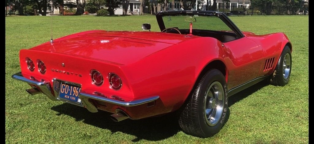

Those are NOT 68 style lenses. Not even close. They appear to be aftermarket custom made in China junk ! They are bubbled / factory are almost flat with a silver ring & a mild point in the center

In your images, you can see that the lights work in pairs, and the backup lights are separate lenses in the rear panel. You are correct, of course, that the OP's lenses are a common aftermarket mod. But that 68-only configuration of light bulbs is superior to anything stock from 69-82.

How can you tell if its an 80-82 bumper? Btw, I will be swapping out those taillights back to original.
Because it is shaped that way, like the bumper on my 80. 74, 75-69, 75-79, and 80-82 bumpers are more or less interchangeable, and the 80-82 bumper is a common appearance mod.
An OEM bumper cover will likely have waves in the top. An aftermarket fiberglass bumper will be stiff, and you can see the difference underneath.
You might need spacers to make your original lenses work. 80-82 lenses have standoffs molded in.

you didn't mention 76-79...if they are not interchangeable, how could that be an 80-82 bumper? not doubting you, just trying to understand what's going on with it and when I order tailights...what year i should get.

Sorry, typo. 75-79 are the same. 74-82 are interchangeable.
I'd remove the current lenses, and take pictures.
