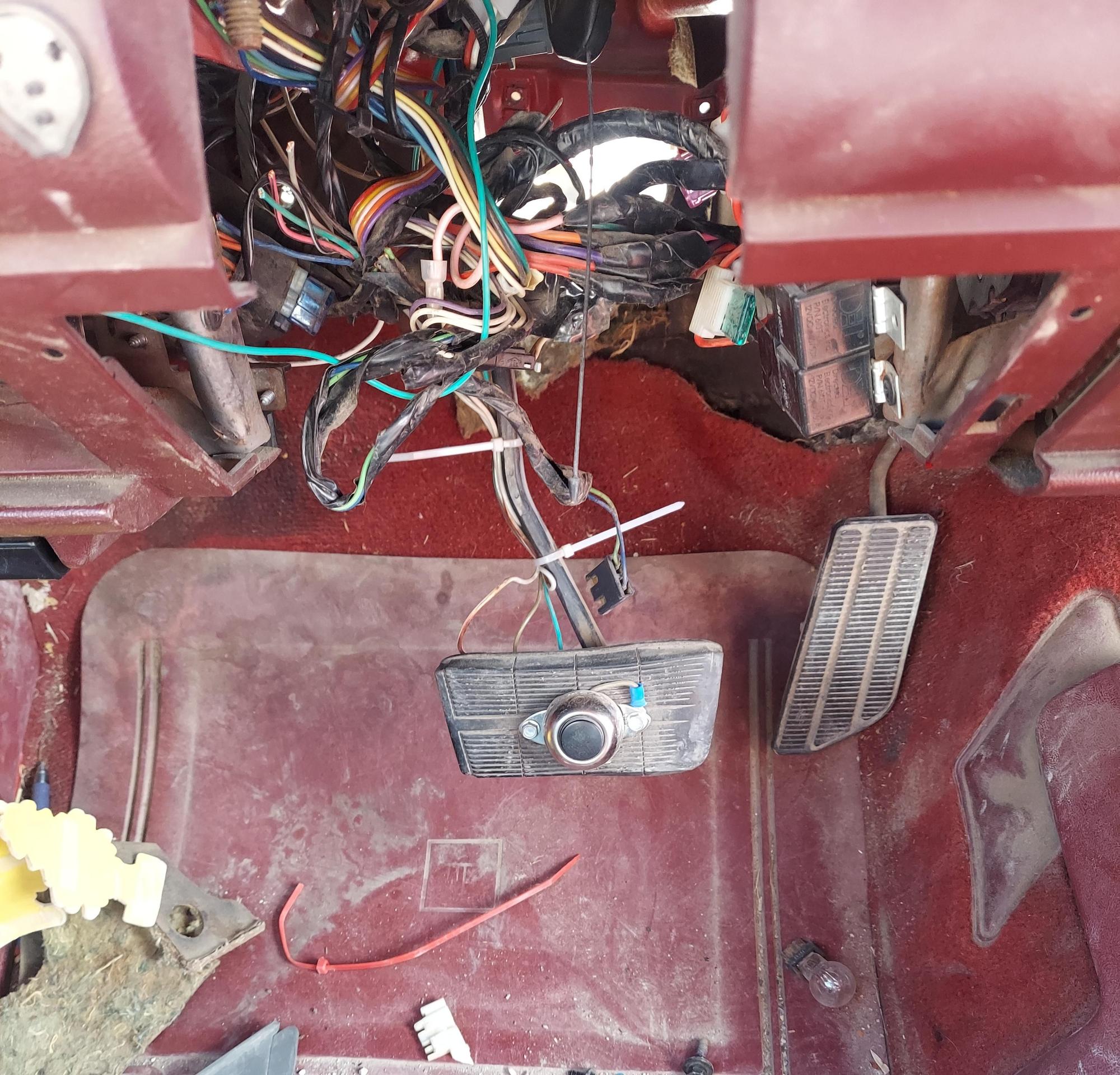

Don't forget the brake light switch. You for sure won't, if you ever change one.

Oh yeah, don't know how I forgot that one ...............my back still hurts from years ago !!
There's an easy fix for that. Less than $10.

That's about as bubba as I have ever seen !! I would NEVER ............Horrible ...................... !!!
